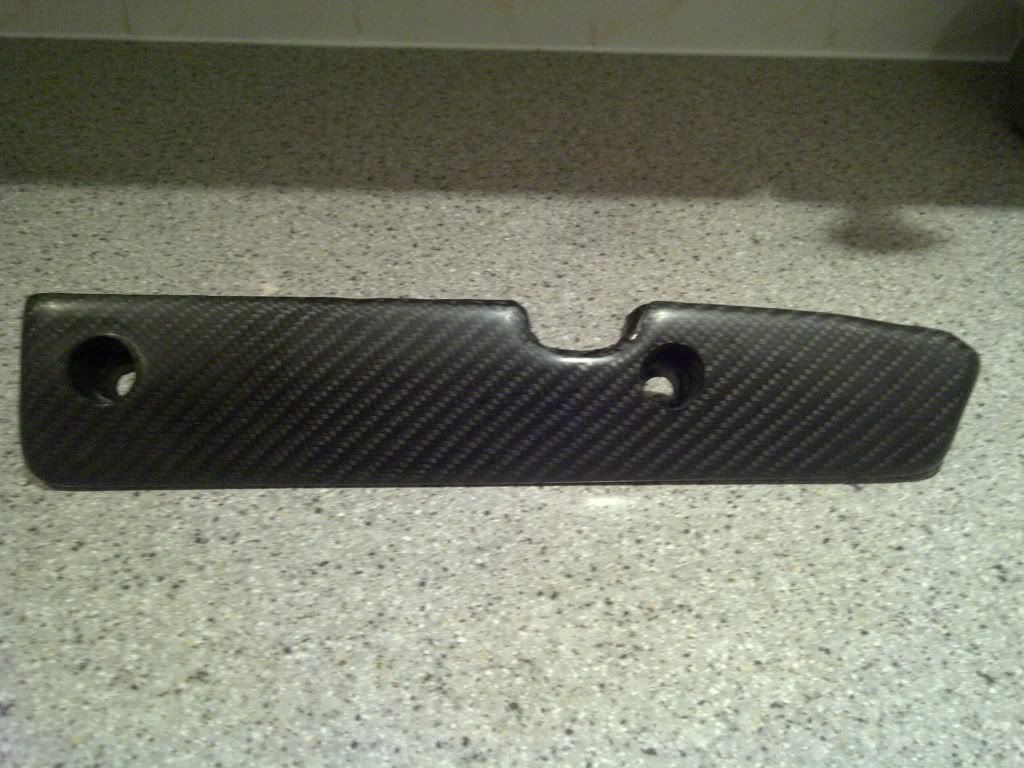

Got my mani cover back from our good man D.K today.. Hes worked his magic again, cheers mate :)
