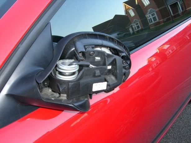

First i folded the mirrors back, and from the section that was revealed started peeling it off. I used a thin bit of leather between the unit and the removable plastic section, inserted a thin metal thing to
help jimmmy the plastic covers away from the unit.
I took the red covers and placed them where the originals used to be, and just pushed them so they clicked into place, and the result:

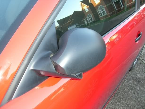

BEFORE:

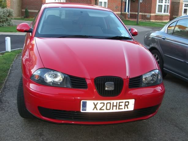

AFTER
The total cost was £17.68 (Mirrors + P&P + Paypal fee), and they were actually advertised as Leon 2003 Mirror covers. I found taking the mirrors off orite, they take quite alot of force and pop out quite easily.
Only thing to be careful is when putting the new ones on, just line them up correctly. This is because on the new mirrrs there are long bits sticking out that to clip into the unit, if not aligned properly they will snap.
What do you all think? looks right?
