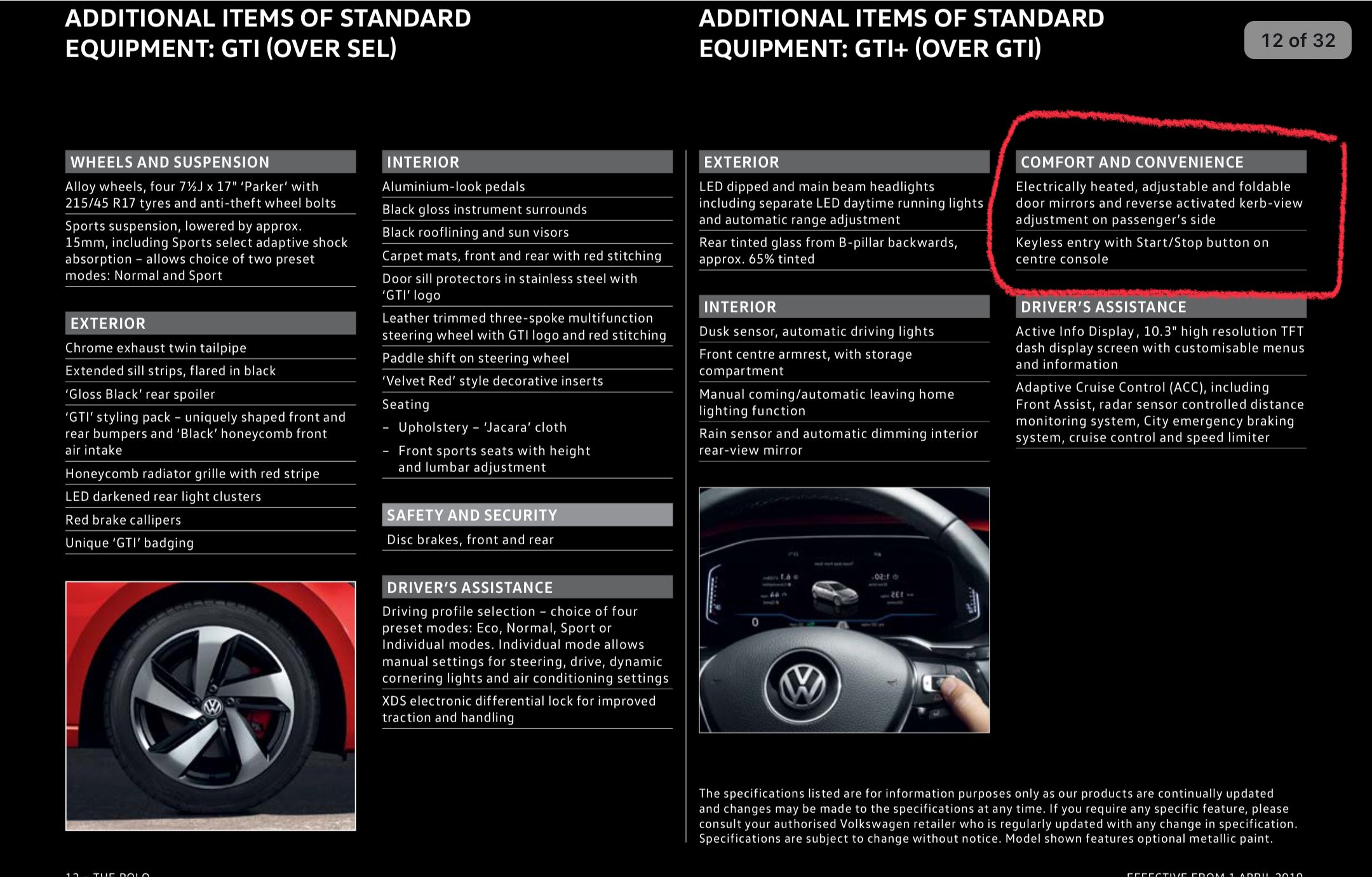

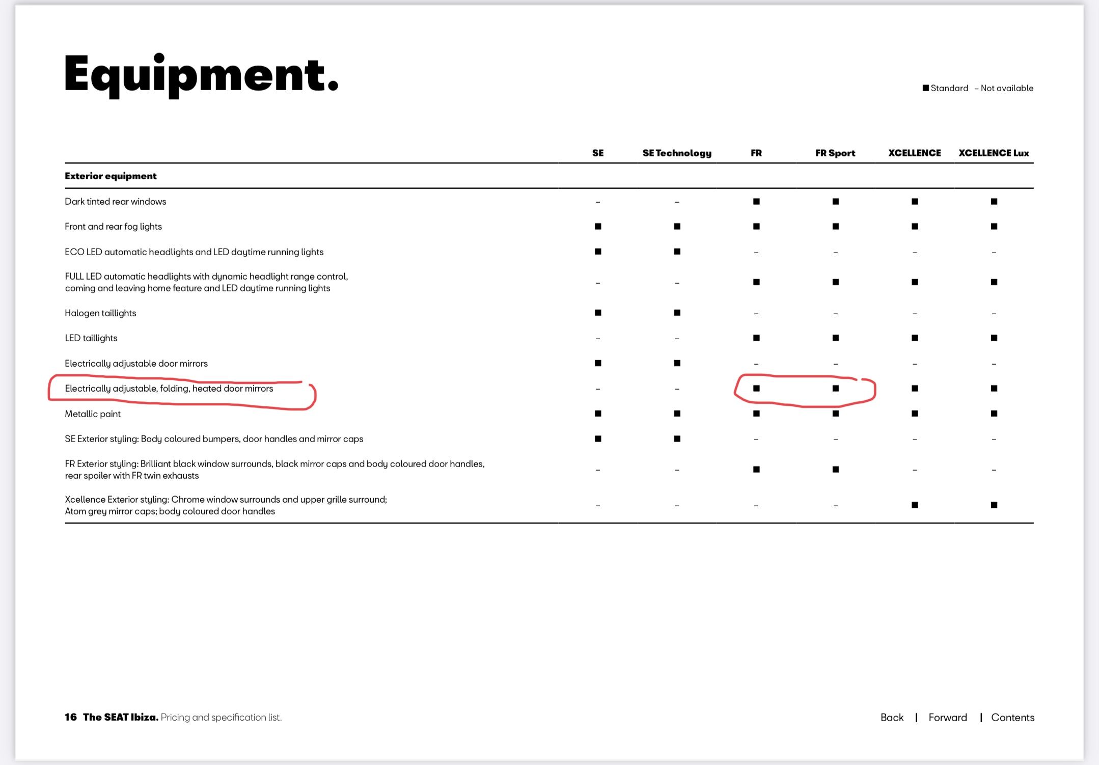

In the June 2023 brochure for the UK spec Seat Ibiza, it lists electrically adjustable, folding, heated door mirrors as part of the UK spec Ibiza FR or FR Sport models (see screenshot below) but there’s no mention of tilt function for the passenger side mirror. However, if Seat is anything like VW (my car’s a VW), then product literature often contains errors and omissions so there‘s a chance the brochure content may not be correct.
For my car, VW did specifically make reference to the tilt mirror function (referred to as reverse activated kerb view adjustment) - see below - so I would have expected Seat to also mention this in their product literature for models that have the function.
Hopefully other forum members with a current model Ibiza FR will add to this discussion thread and confirm whether their car has the tilt mirror function. Failing that, it might be worth checking with your local Seat dealership or Seat Customer Services.
