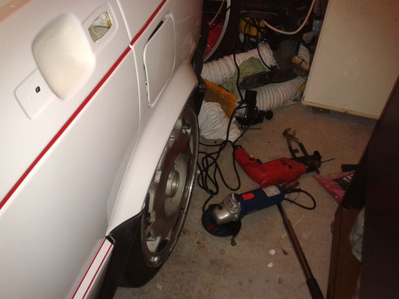

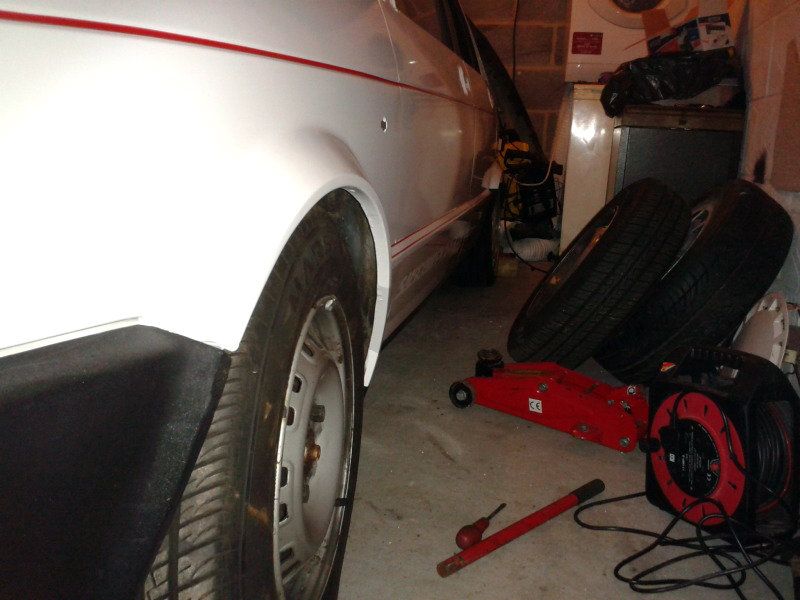

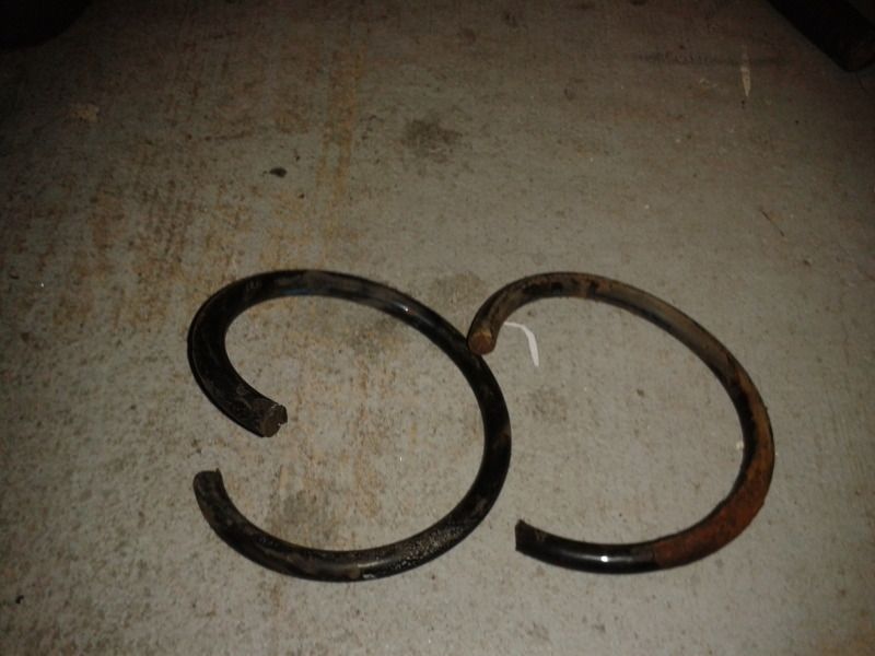

Now the petrol has stopped leaking, and the fumes have vanished I've had half an hour with the angle grinder. Cut 1 coil out of the spring to start with, but it didnt drop it that much, so off came another coil.

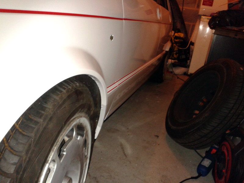

Before and after shot
I think 1 more coil will have to be cut out, for it to sit level with the rear end. But I'm gonna leave it like this for now, untill I get 2 more tyres on the P-slots, then I can judge the height better.

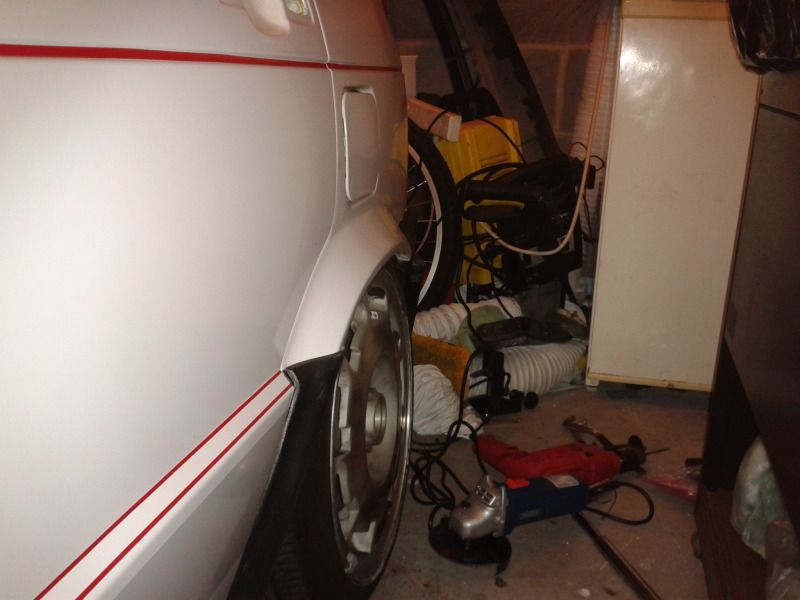

Just turned the old girl round so I can chop the other front spring down. Pretty sure Im gonna end up chopping 4 coils from each side, front still looks too high with 2 cut out
Couple more pics of how the back looks

Well 3 coils cut from the spring and I still think its gonna be sitting too high on the front
Will see what its like when I get a P-Slot on there, as they stick out more than the standard wheel, but think it might need a 4th coil cutting out, but thats gonna give me feck all ground clearance

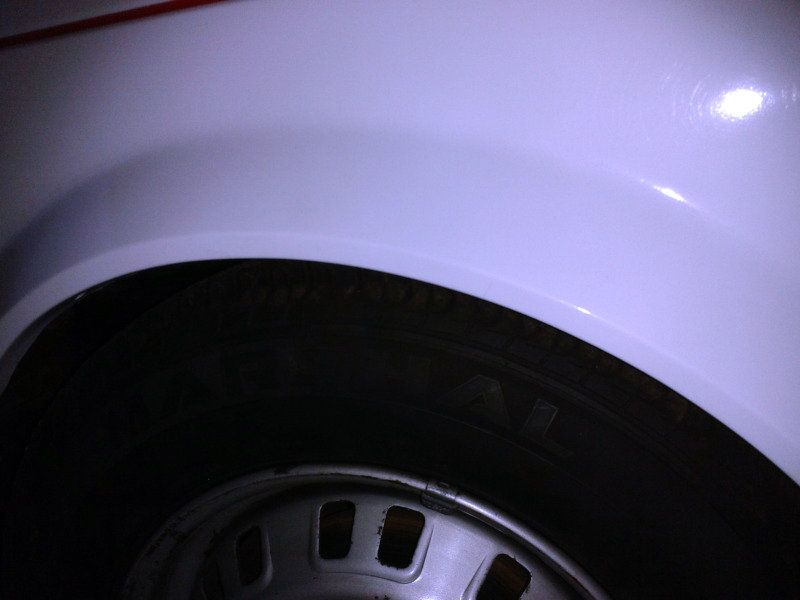

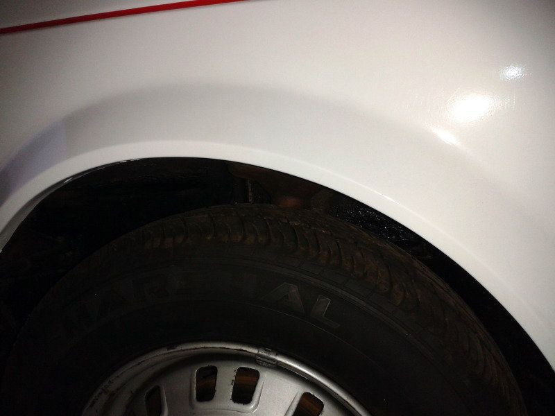

Before
After

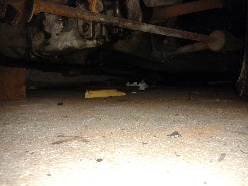

Not much room under there!

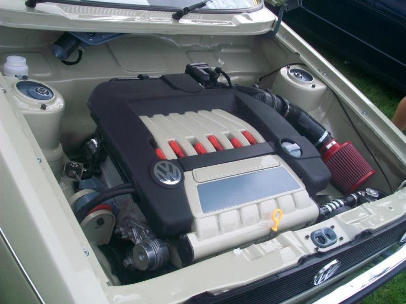

A friend of a freind put 1 in his mk1 golf this year, some of you may have seen it at edition and a few other shows.
Engine bay is pretty much the same in the ibiza as the golf, so should fit just as well as this
