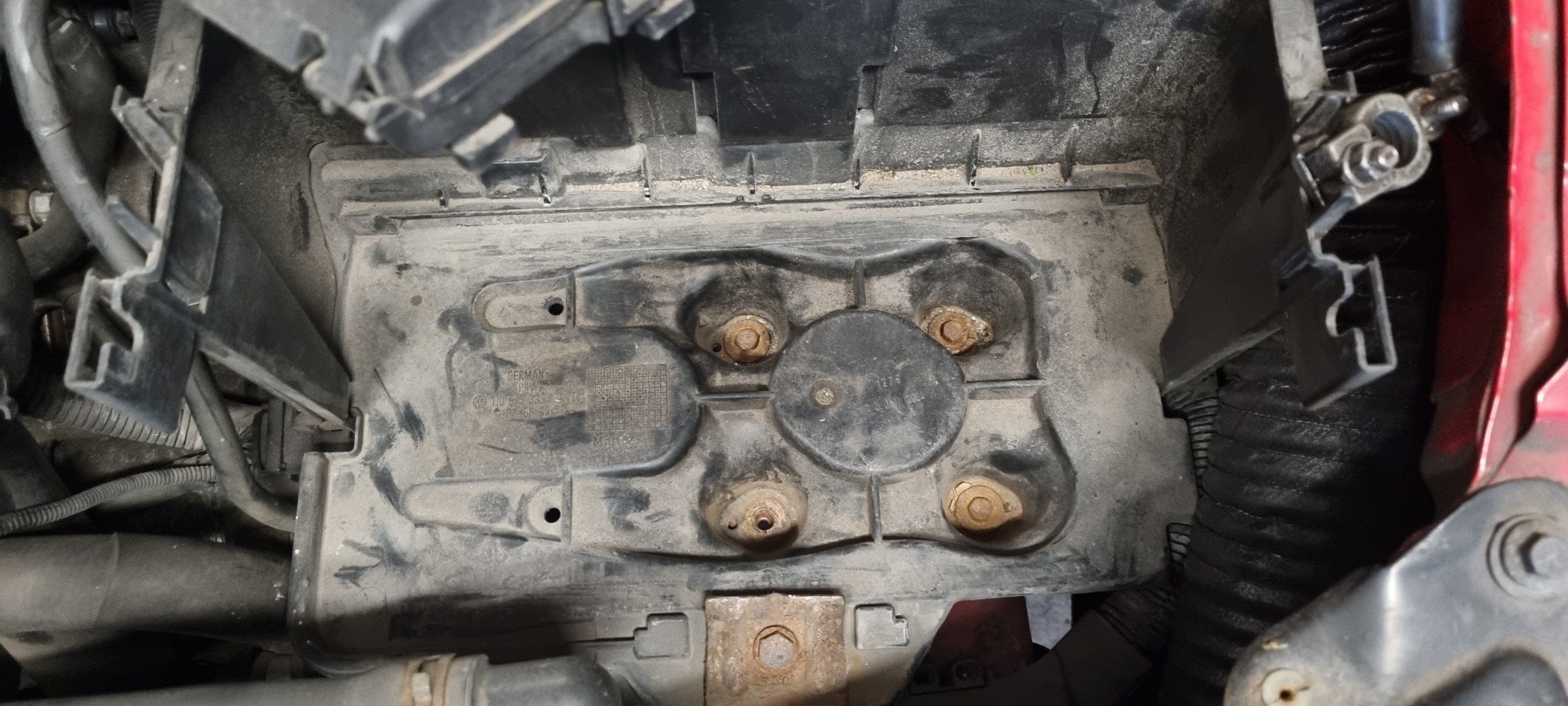

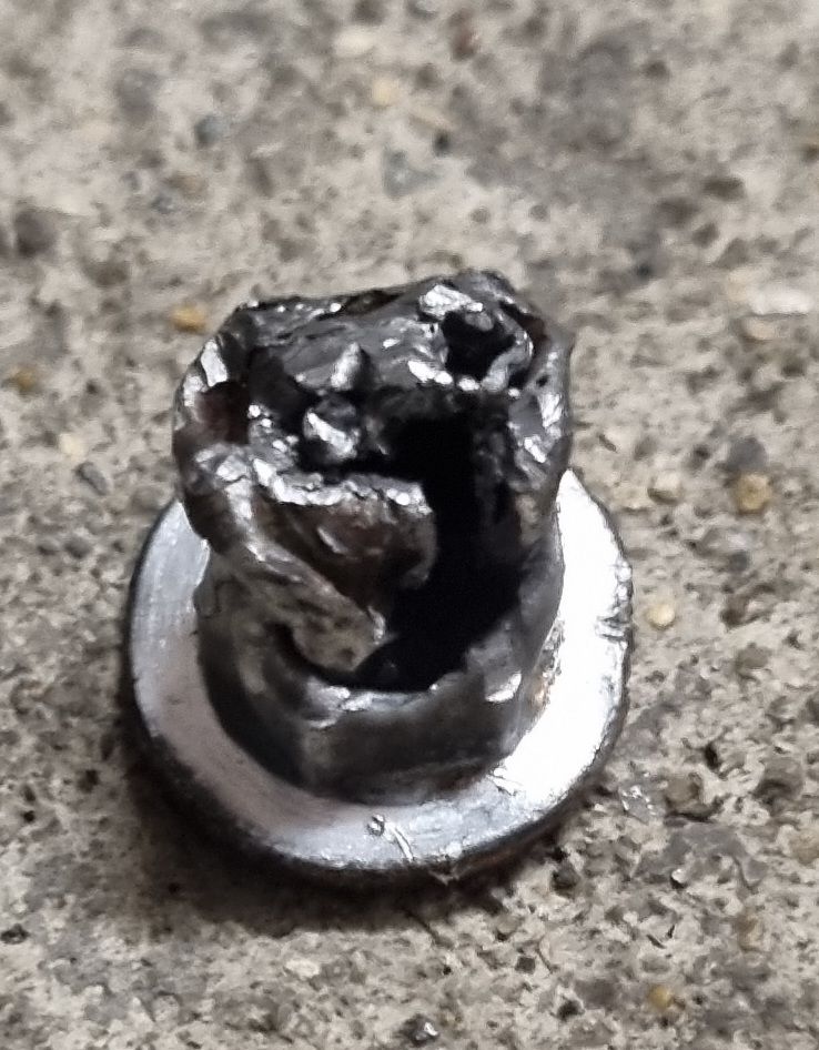

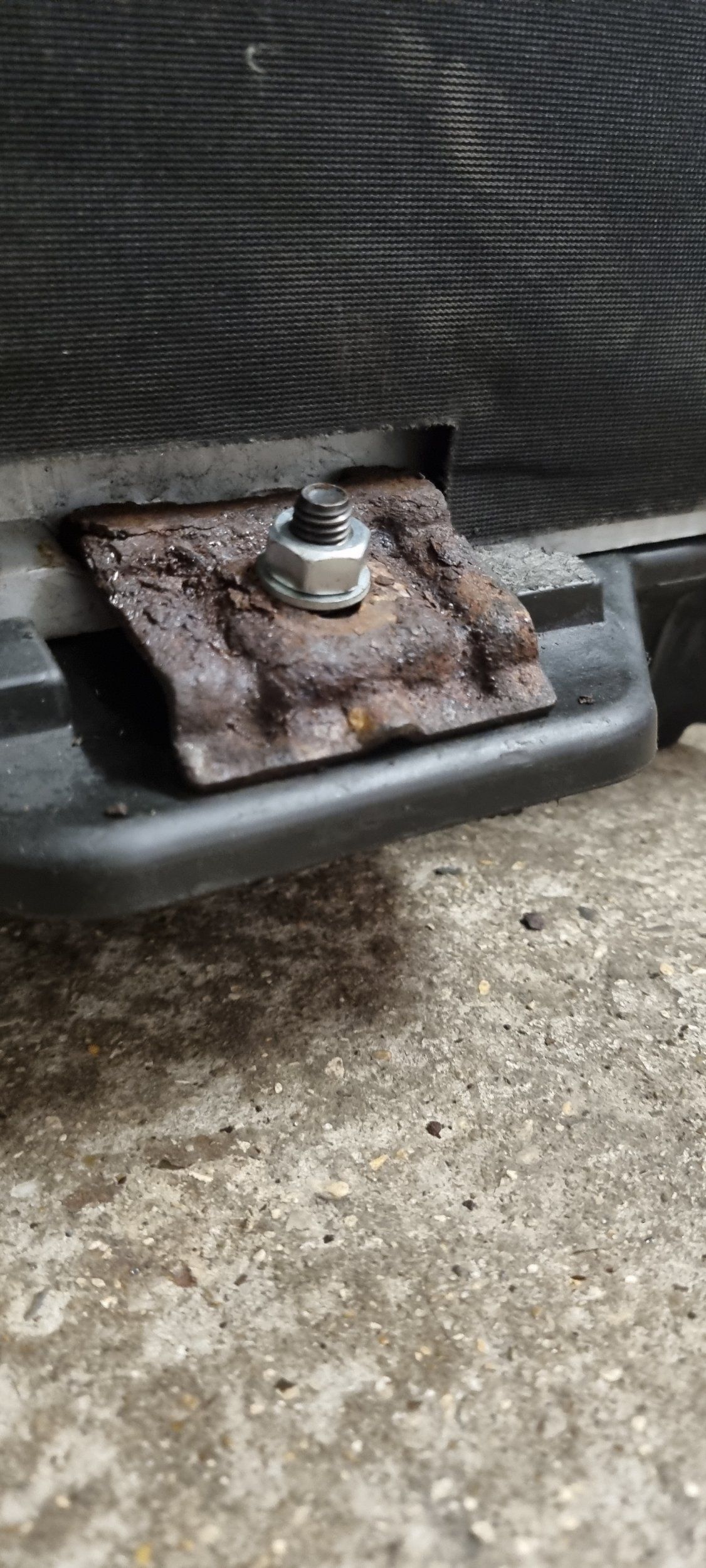

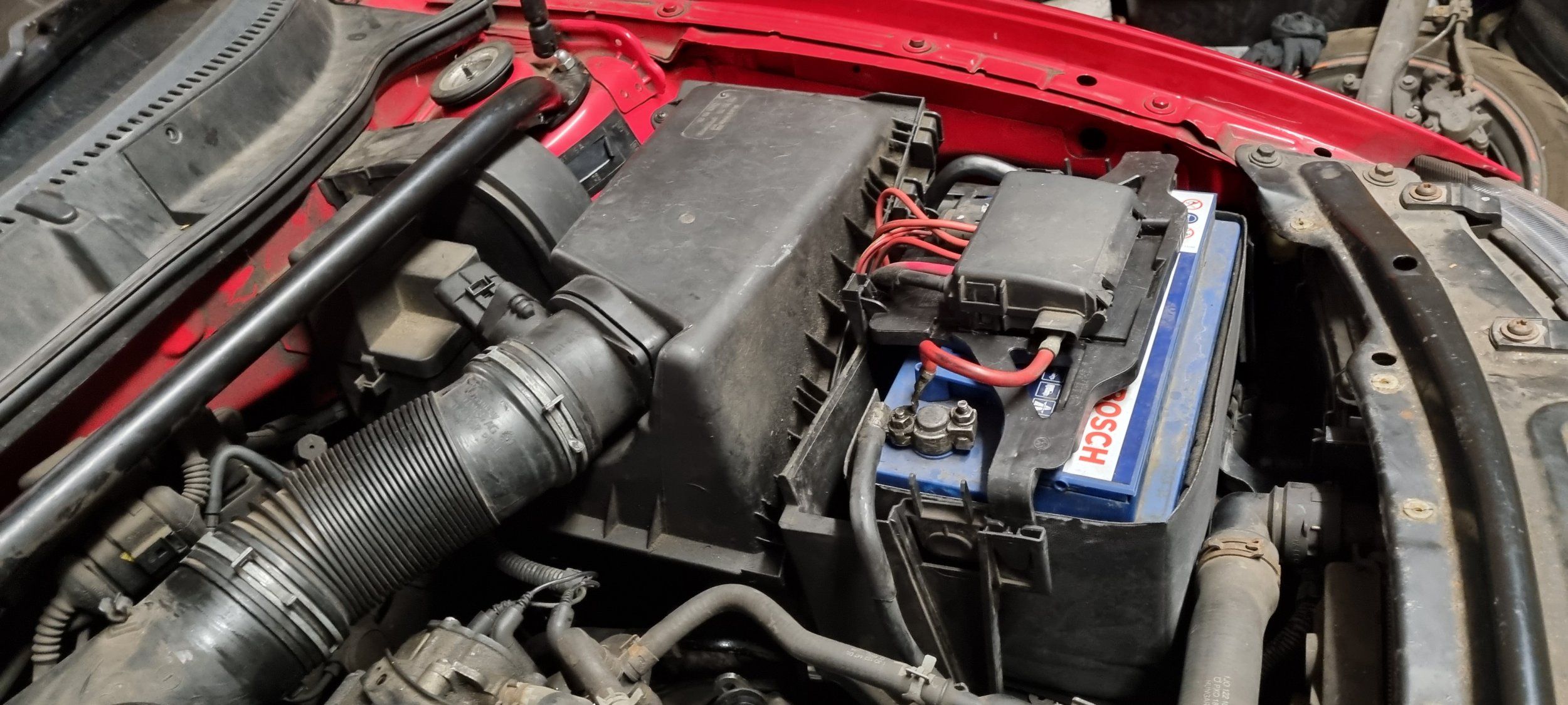

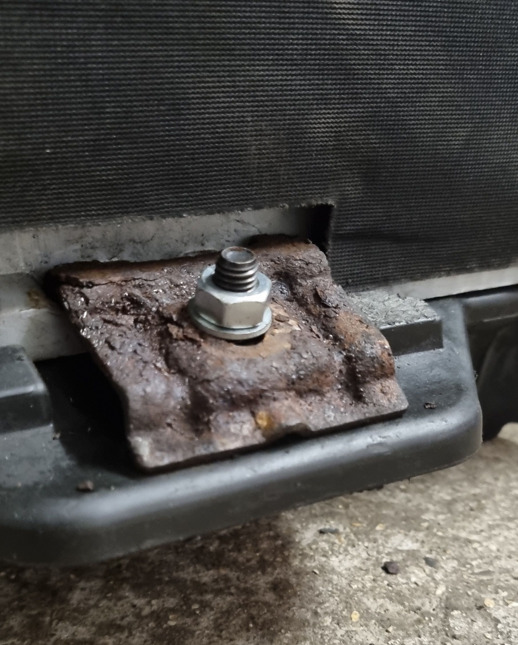

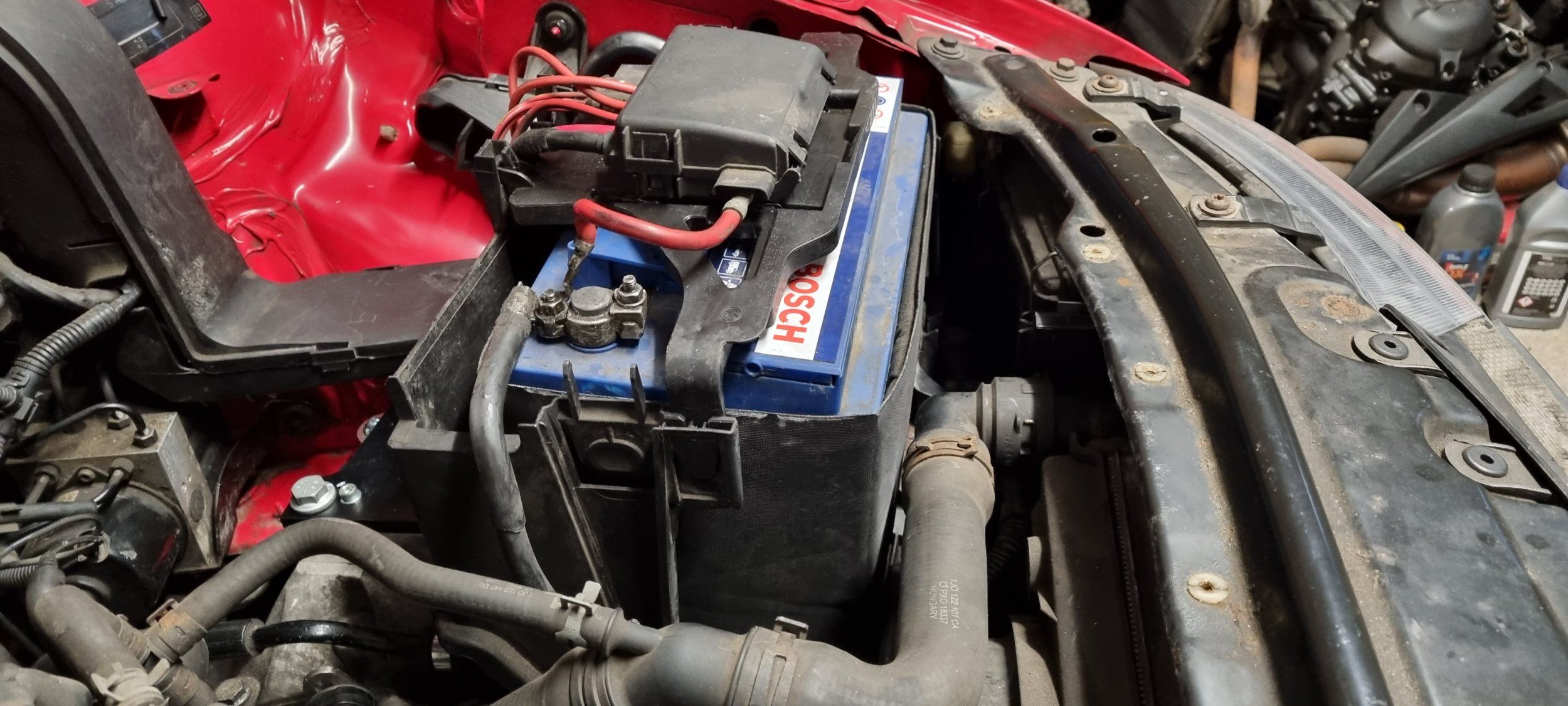

Next job was the battery tray. The bolt and clamp were welded together, able to lever the battery past it but not a great situation.
So applied mole grips and impact driver, out came the bolt, unfortunately the nut was pretty much toast so some drilling and chiselling later, it was no longer a problem
In it's place is a bolt held in with a nyloc nut, the clamp sits on top then a normal nut on top. Not the best fix, but it'll do for now.

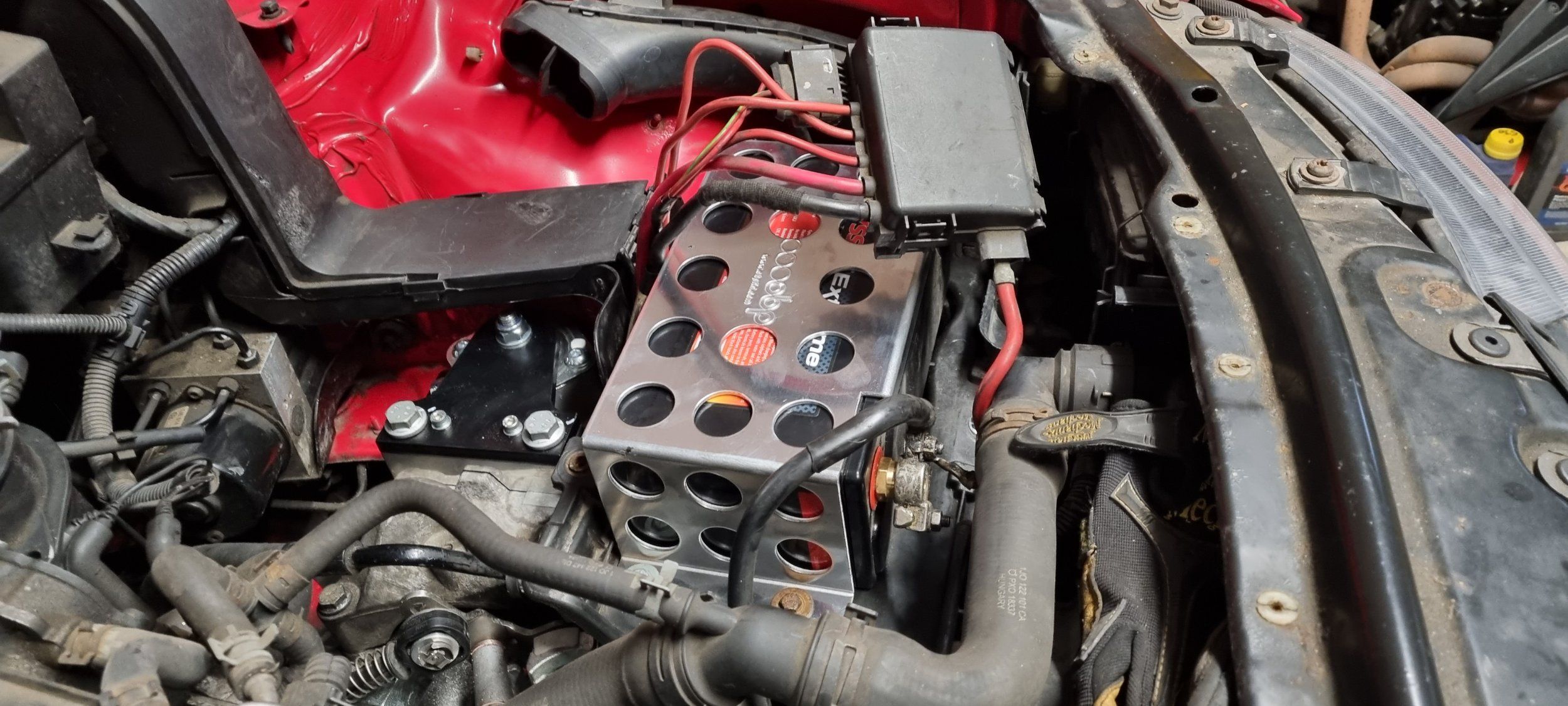

Cleaned up the tray and then fitted some rubber rivnuts to it, didn't take pictures but the reason was so I can choose which battery to run Standard:
Or Odyssey race battery

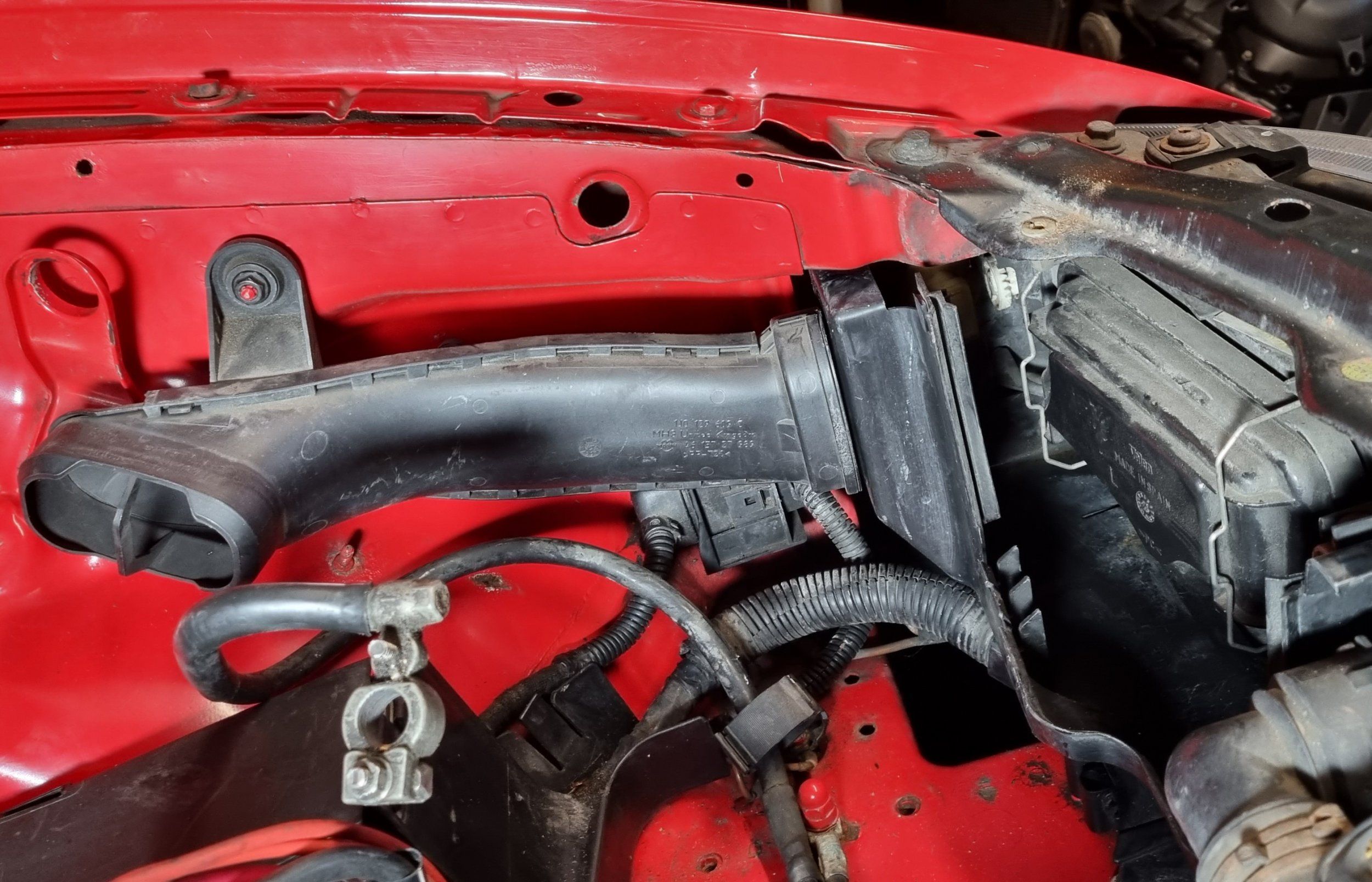

Final job of the day was refitting the OEM airbox because the ITG is going on something else.

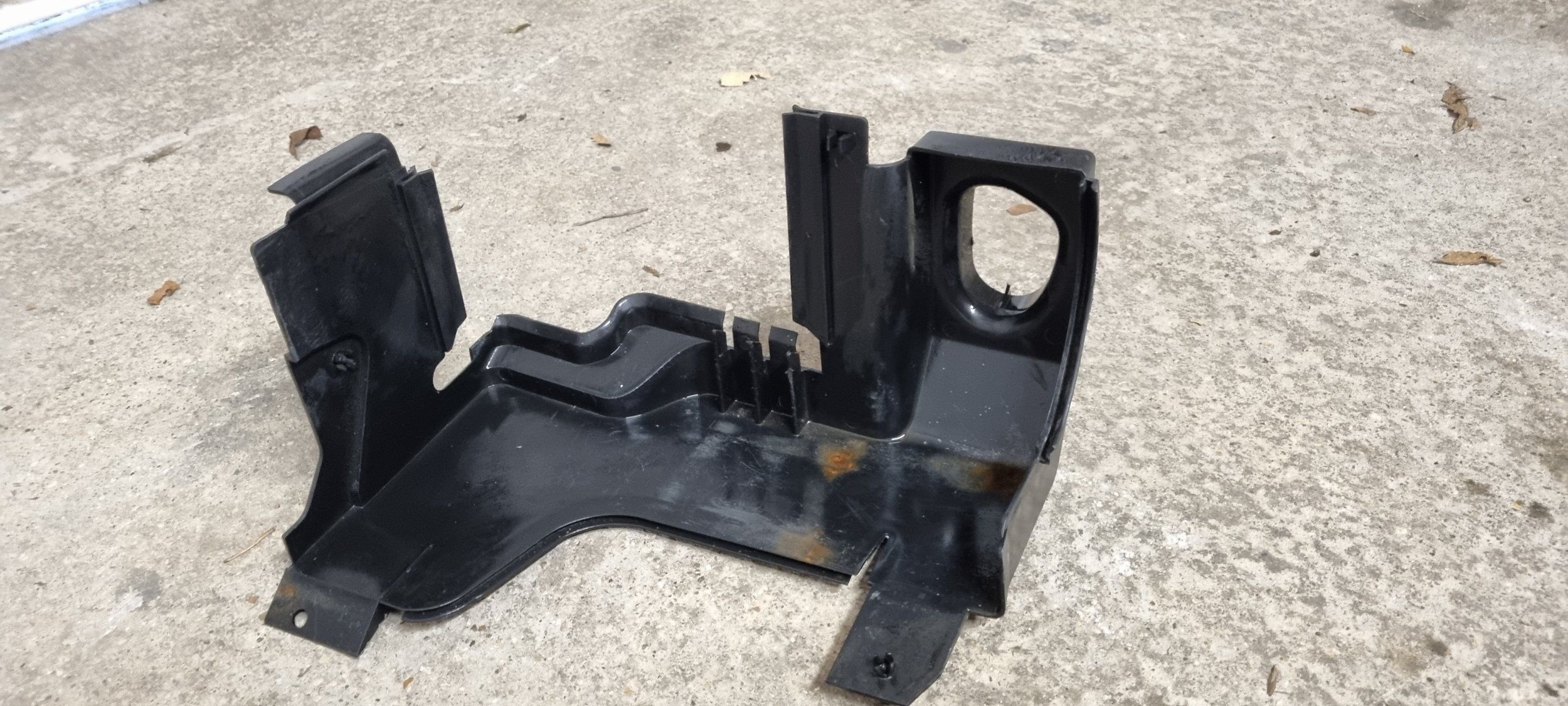

Now mine didn't have this bit fitted when I got it
So I thought as I have a spare one, I'd put it on
Not bad but didn't install the fittings because changing a bulb is hard enough without needing to pull a bit of plastic out the way.
Then the airbox itself which was a properly tight fit. Forgot how much of a pain in back end it was, but it's all sorted now

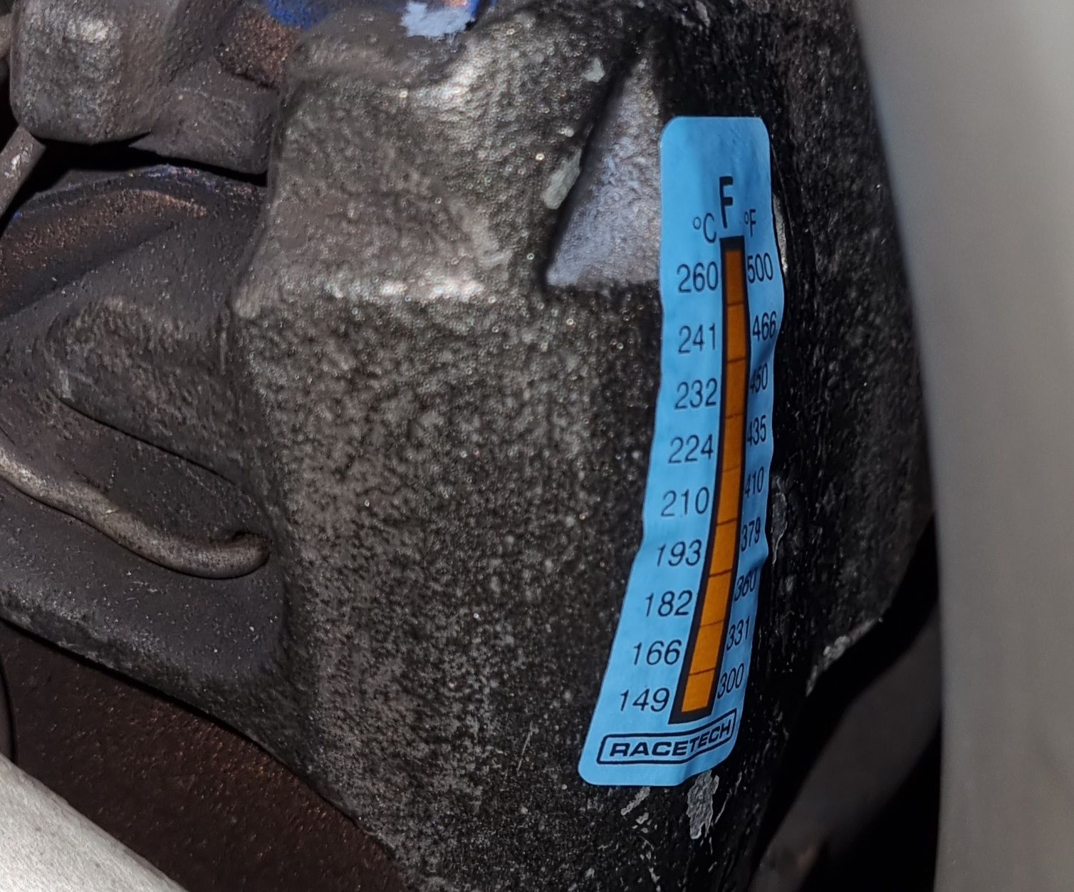

A little prep work for testing the brakes out and seeing if isolating the inlet is necessary
MoToJoJo
Mar 25, 2014
861
702
Northants

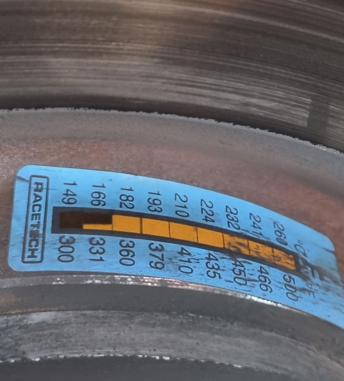

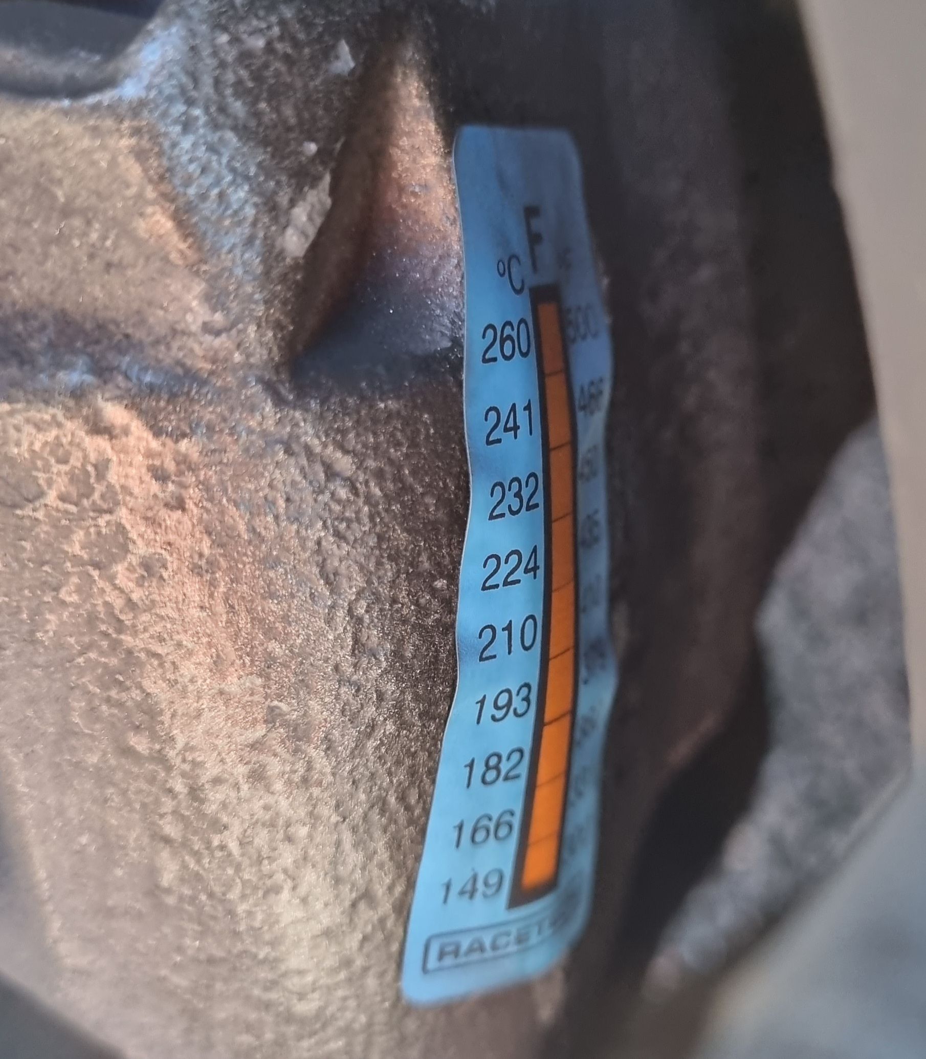

So, track day attended, testing done.
Results? Braking is pretty confidence inspiring, kept finding myself braking later and later. At the limit it tends to get a bit squirrely. As for temps
Discs were uniform in their temperature, might be worth investing in a bit of ducting.
Calipers didn't even register so think they'll be fine as is.
Bedford Autodrome has hard braking zones but only got the pads smoking once.
Reactions: vwtrev

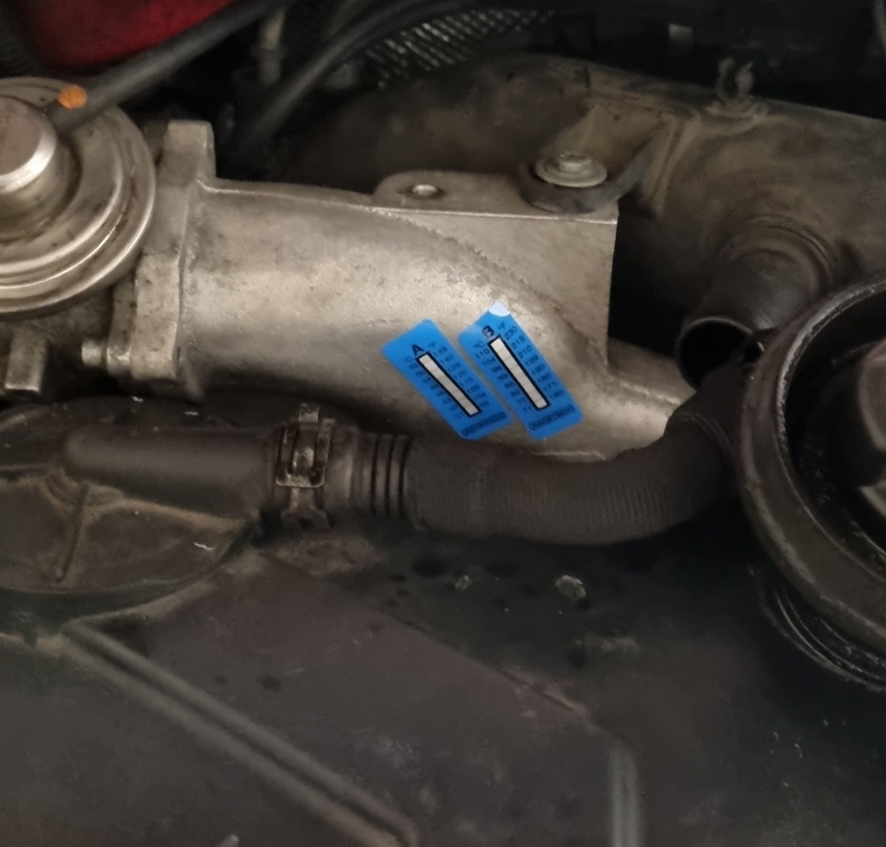

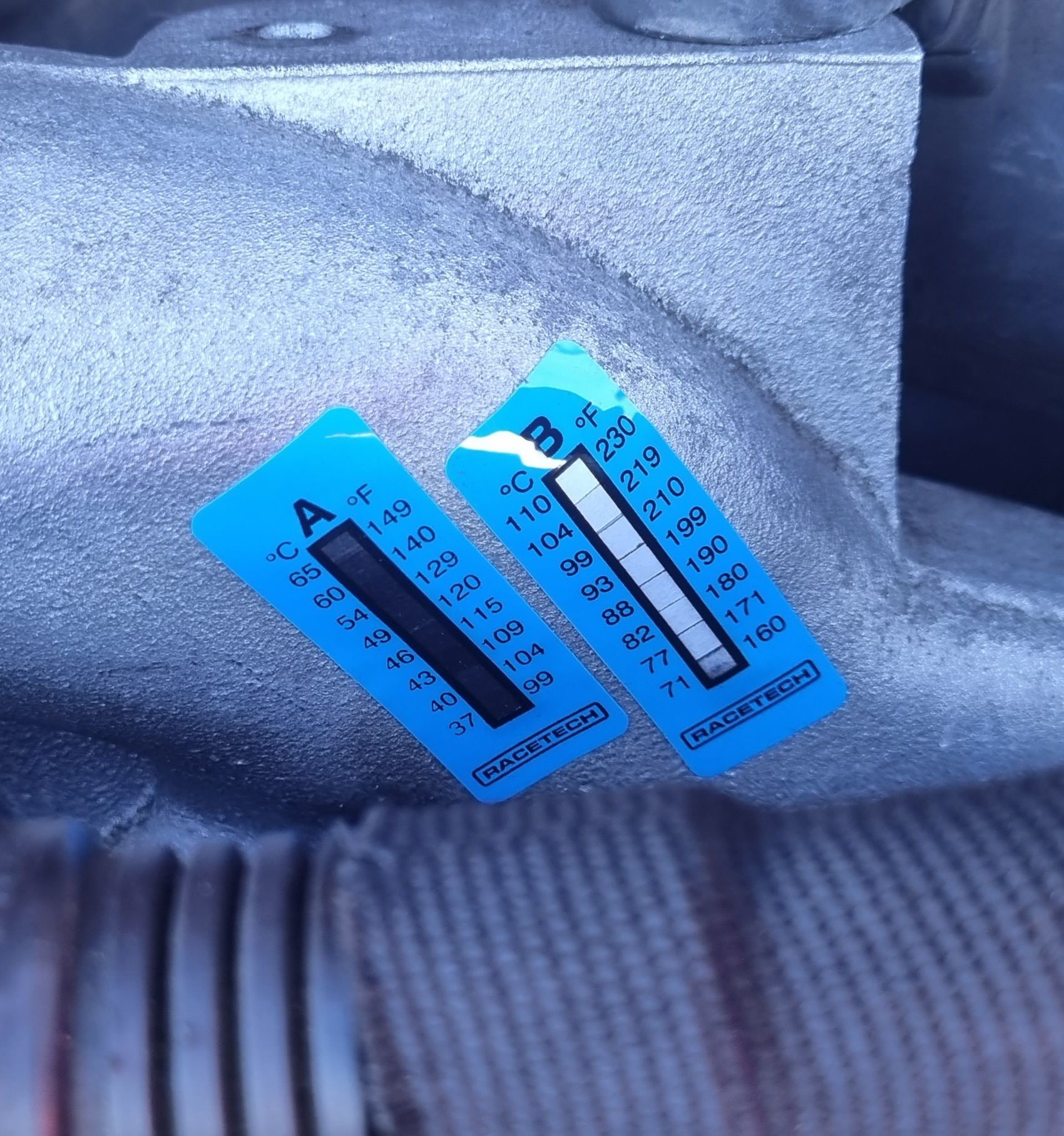

Under the bonnet?
Ok, that's quite toasty, looks like it might be worth thinking about heat management. On the way to the track it had already hit 60° so these things don't run terribly cool.
Race battery (Odyssey Extreme 925 or 920, I forget which) performed flawlessly, not quite confident enough to leave it in but it's definitely got the grunt to fire up a PD150 first try.

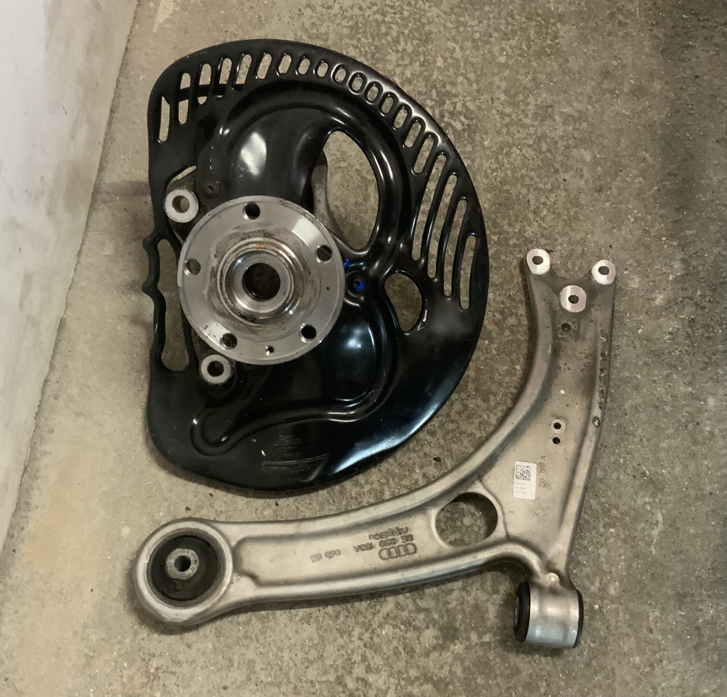

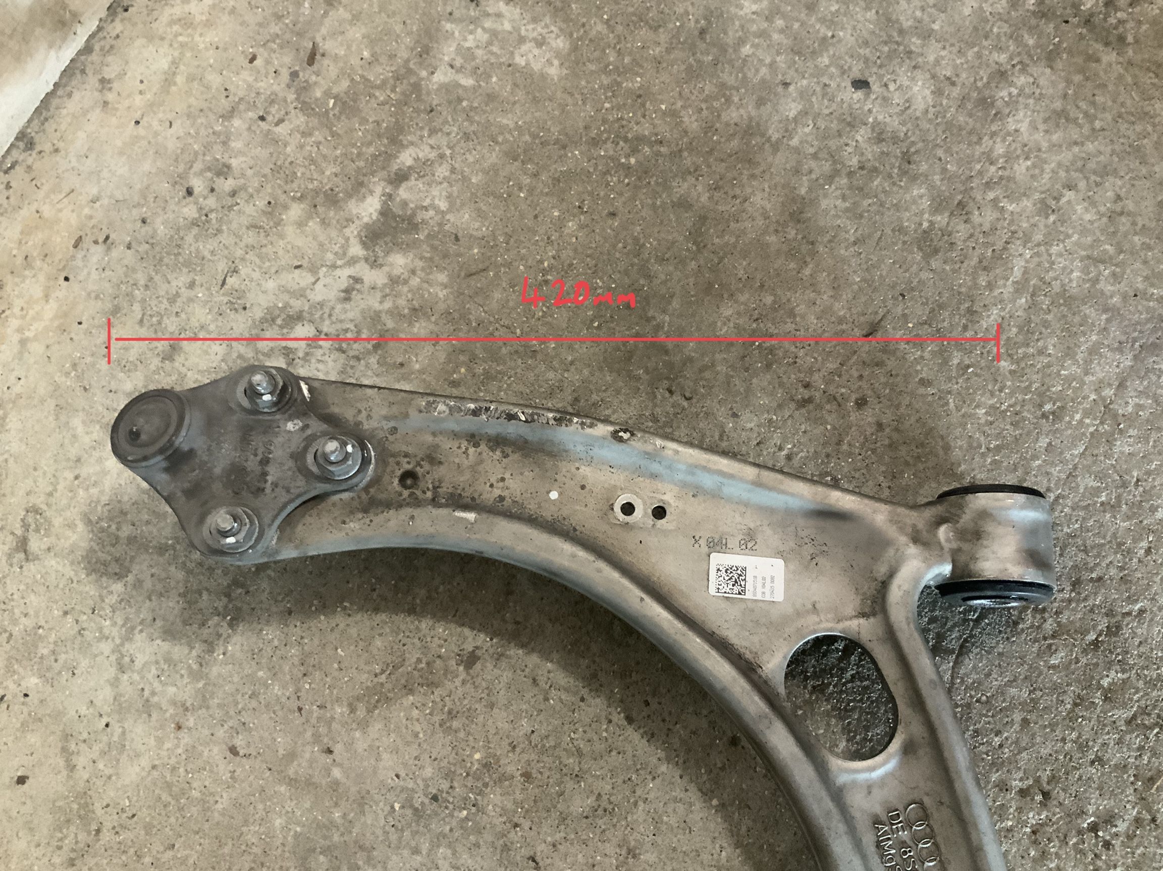

So… one night I fell down the usual internet rabbit hole and one thing led to another and that led to eBay and a pattern wishbone for a Mk7 Golf was winging its way to me. No, I don’t own a Mk7 Golf and the pattern wishbone is destined for the bin (unless someone wants it then it’s yours).
Now while cheap knock off parts for cars I don’t have is often the way these things go (although sometimes it isn’t so cheap), there was no regret. In fact I was back on the Bay of E(vil) and some haggling and cash later I ended up with…

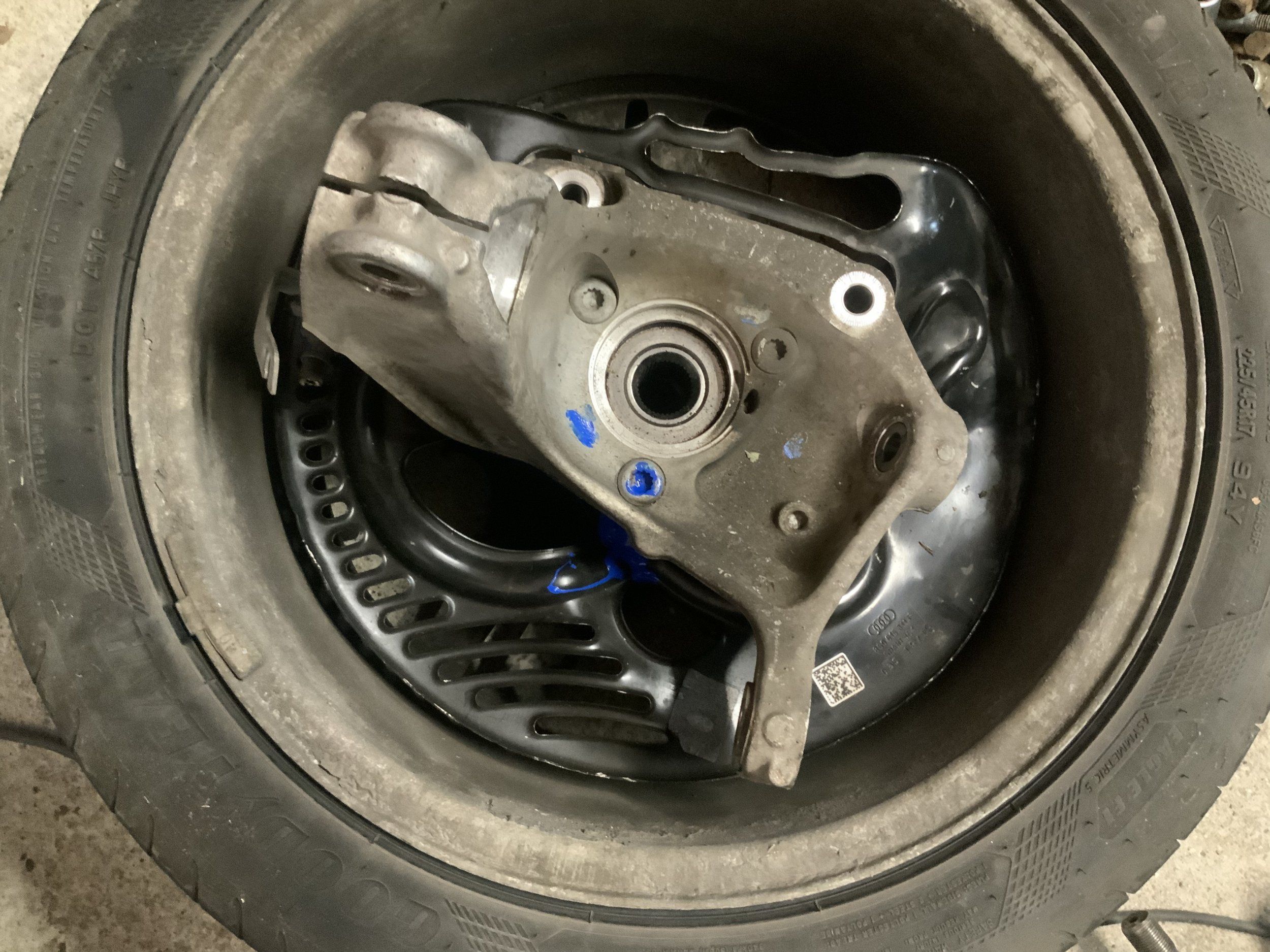

These are the front upright and lower control arm from an Audi TT…. a Mk3 Audi TT…. RS.
Just going to sit here and drool over the automotive sexiness this is.
Just for reference, the RS runs (I think) a 370mm disc and (once again, I think) 6 pots.
Will it fit inside the 17s I currently run and would like to stick to?
If it fits, it sits… very snuggly. Am I planning on running 370mm discs and 6 pots? That would be some severe overkill for how quick this car will be, especially as I don’t plan on running bigger than 225 tyres.

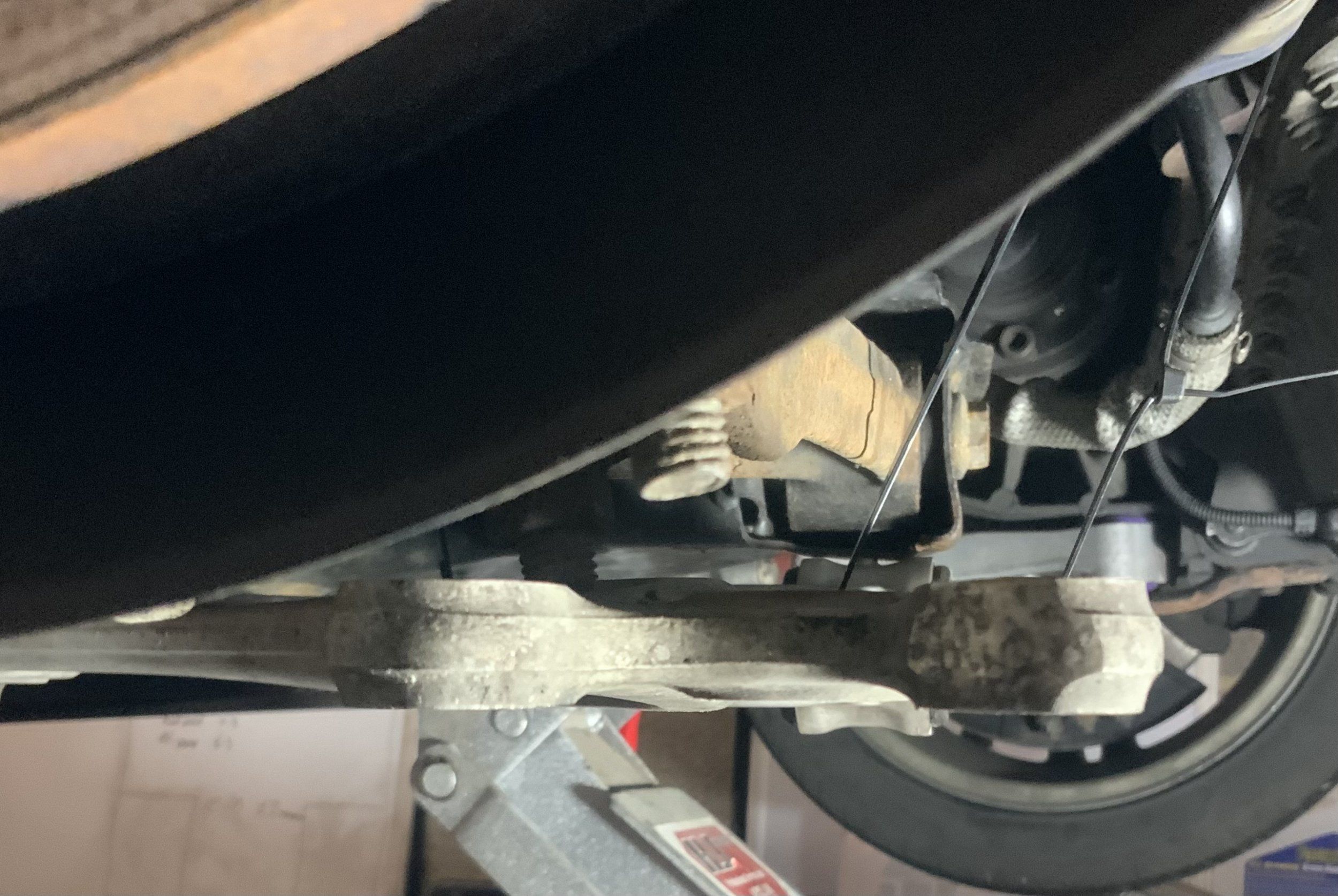

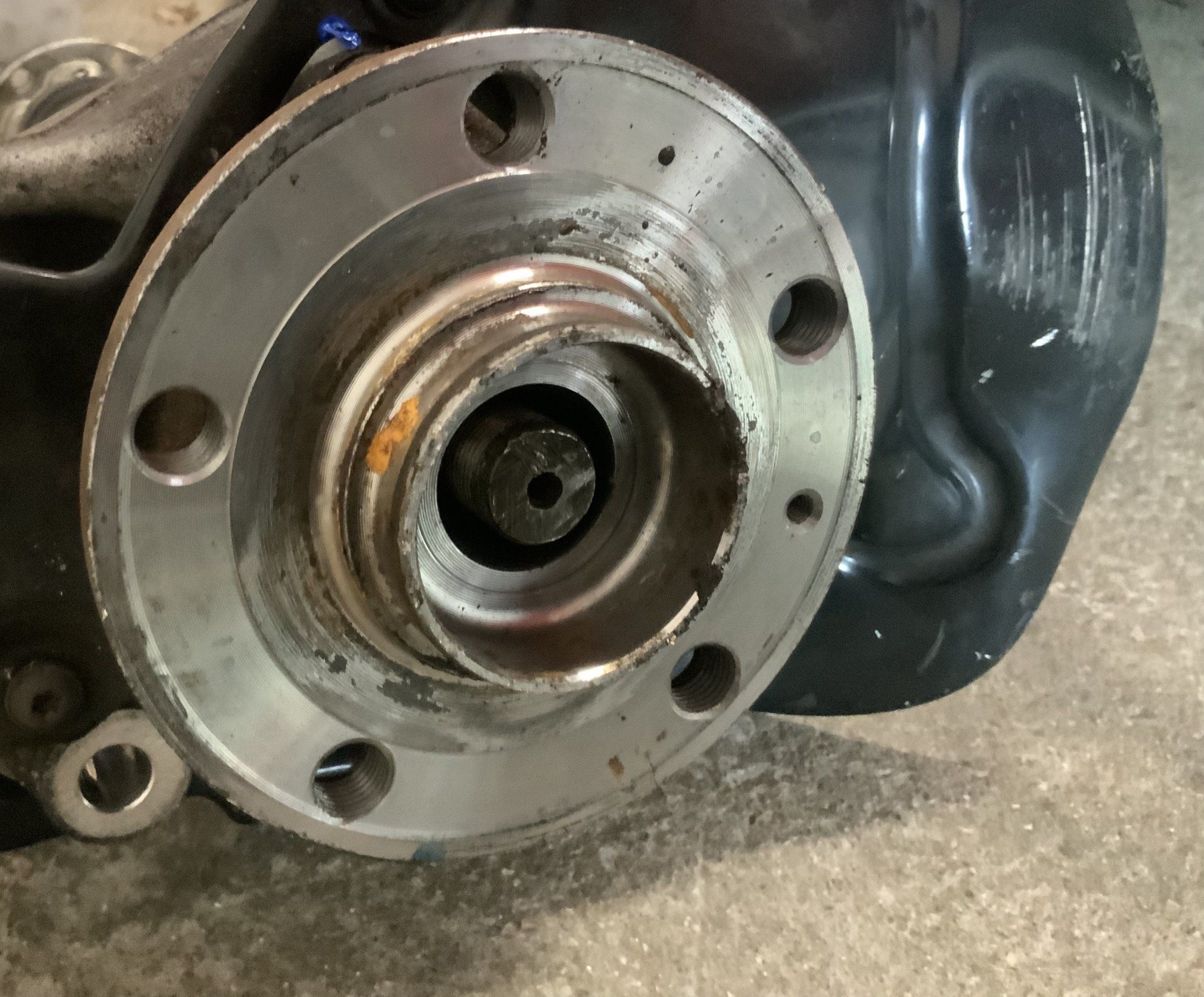

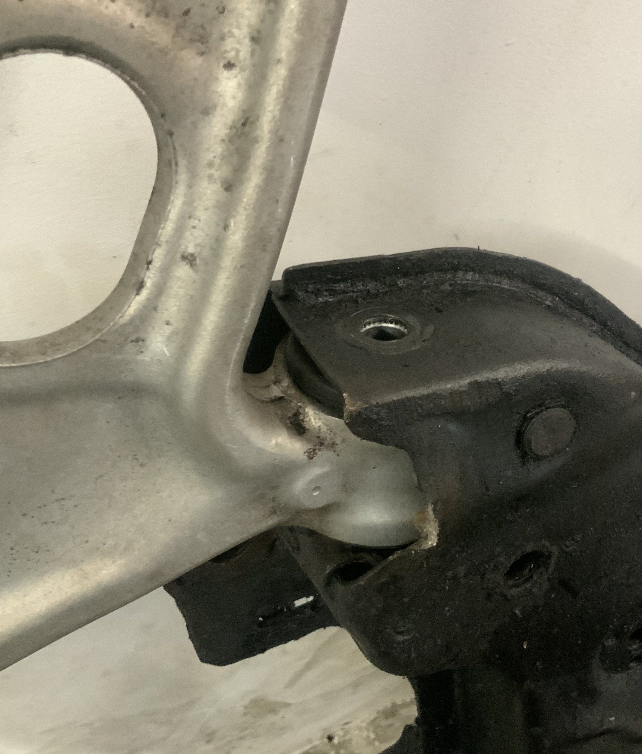

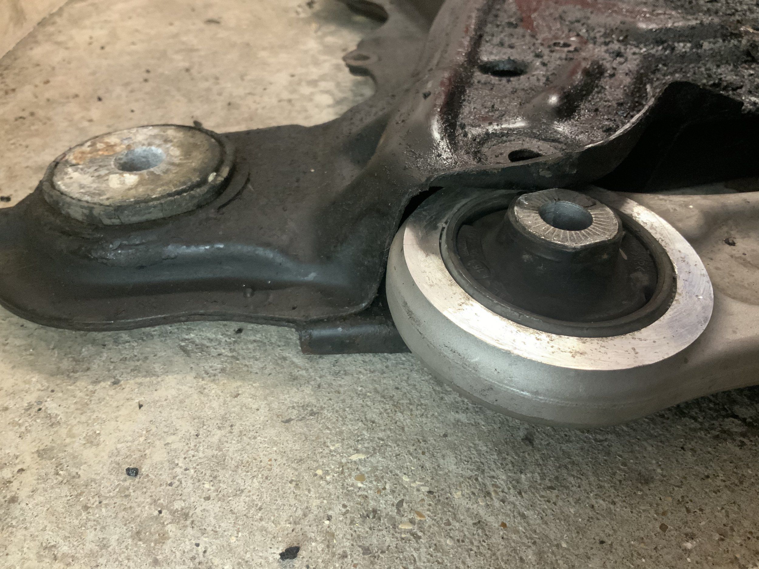

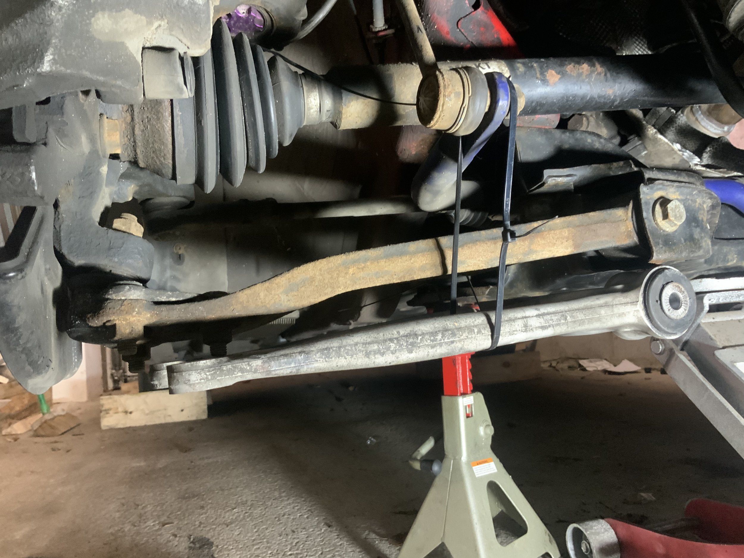

Ok, so the big question is, will it fit? And the answer is… kinda.
Got a spare subframe to see what the chances are
Front bush?
Like a glove! And yes, it takes an M12 bolt.
Rear bush?
Err… no. But, let’s see what it’d look like it I managed to get it to fit?
Hmm…
That’s not a deal breaker

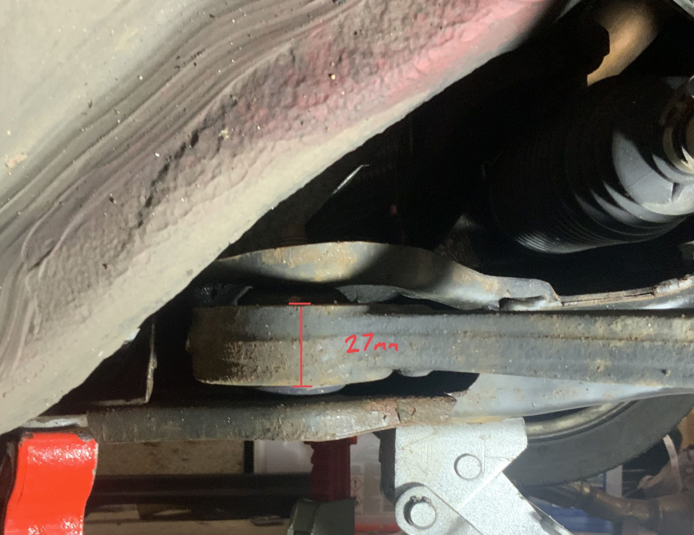

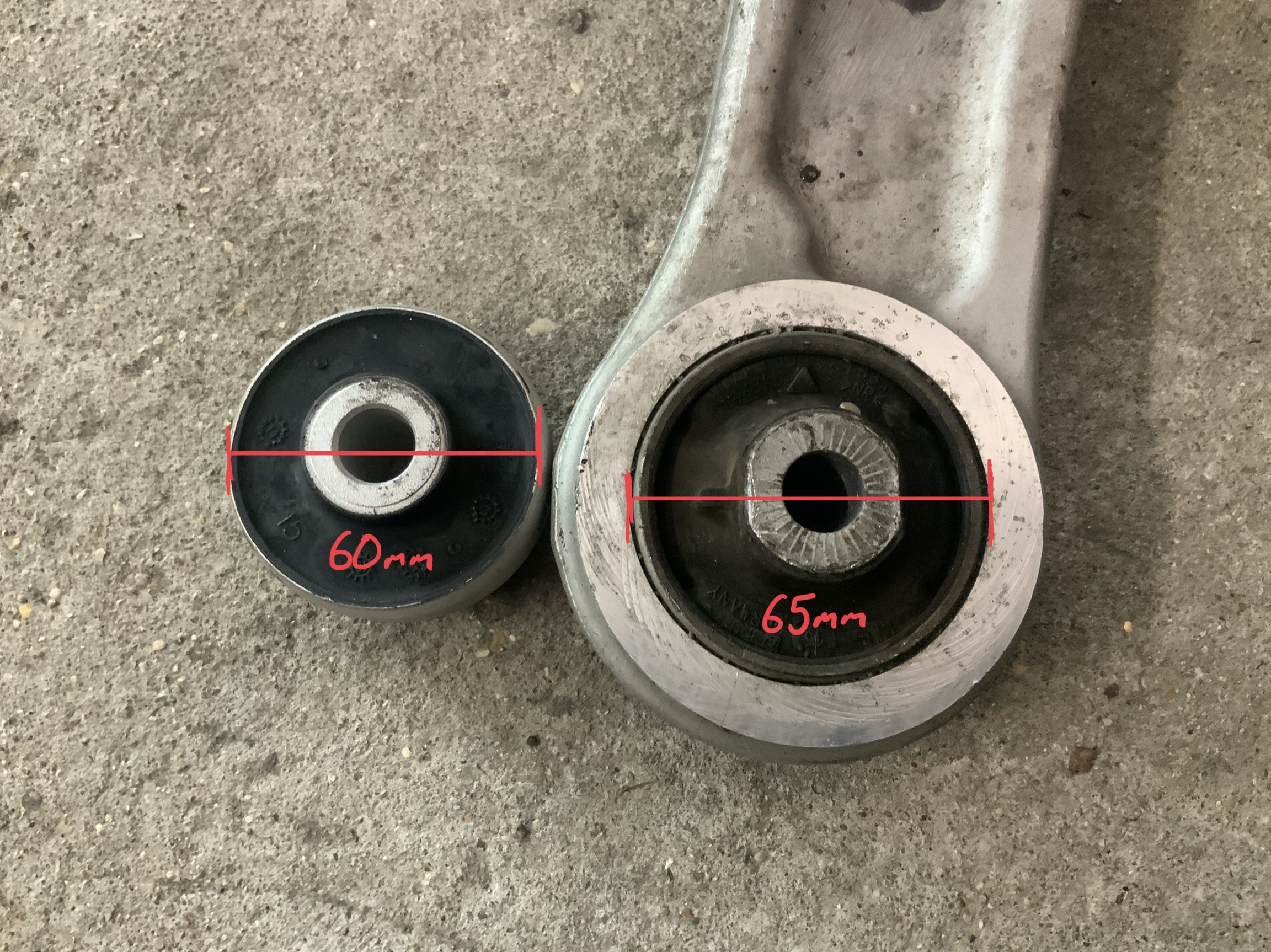

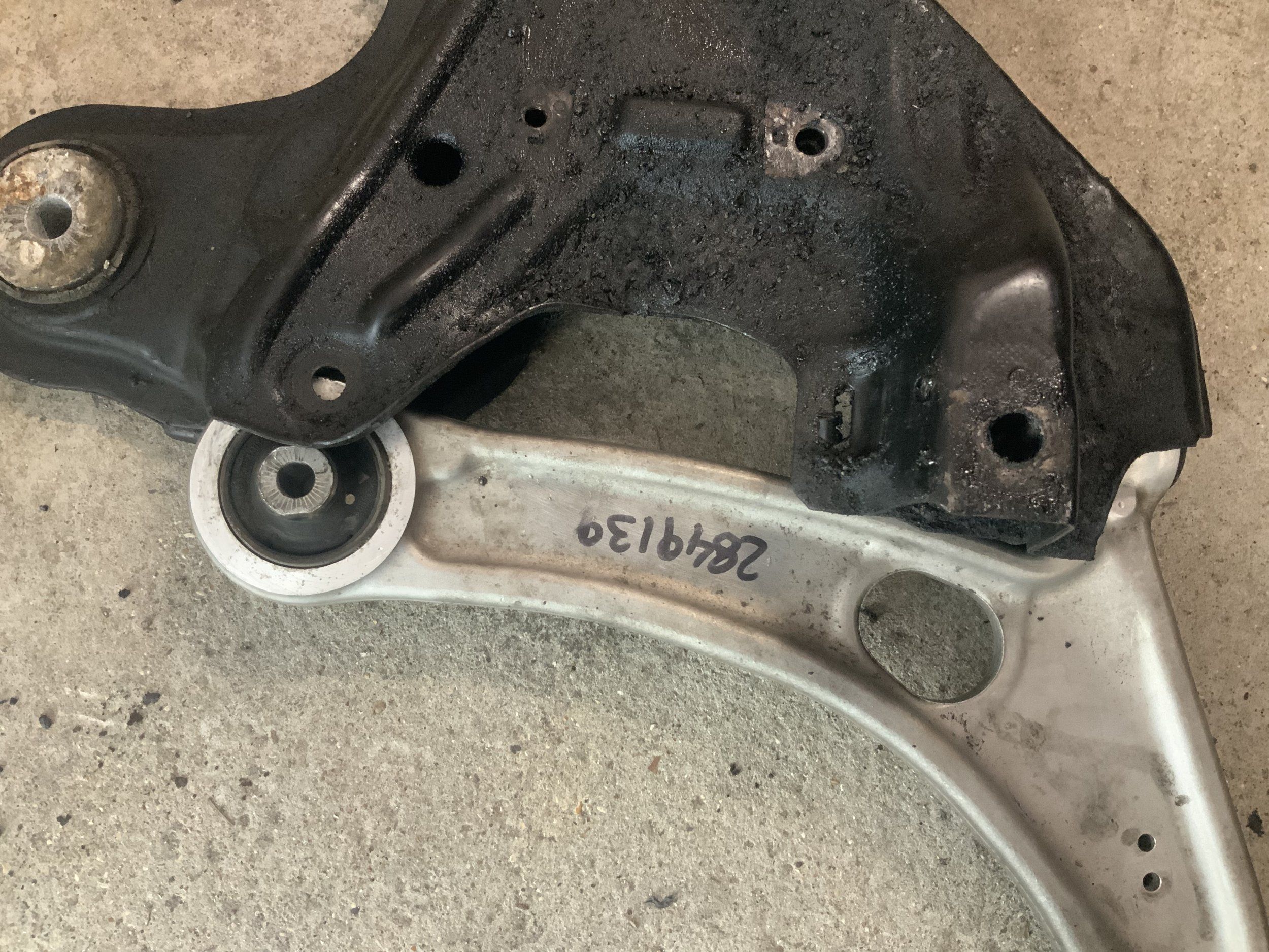

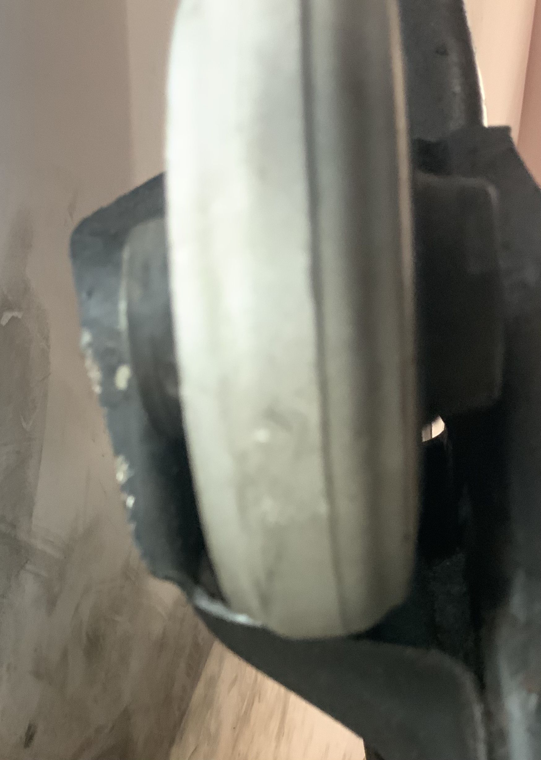

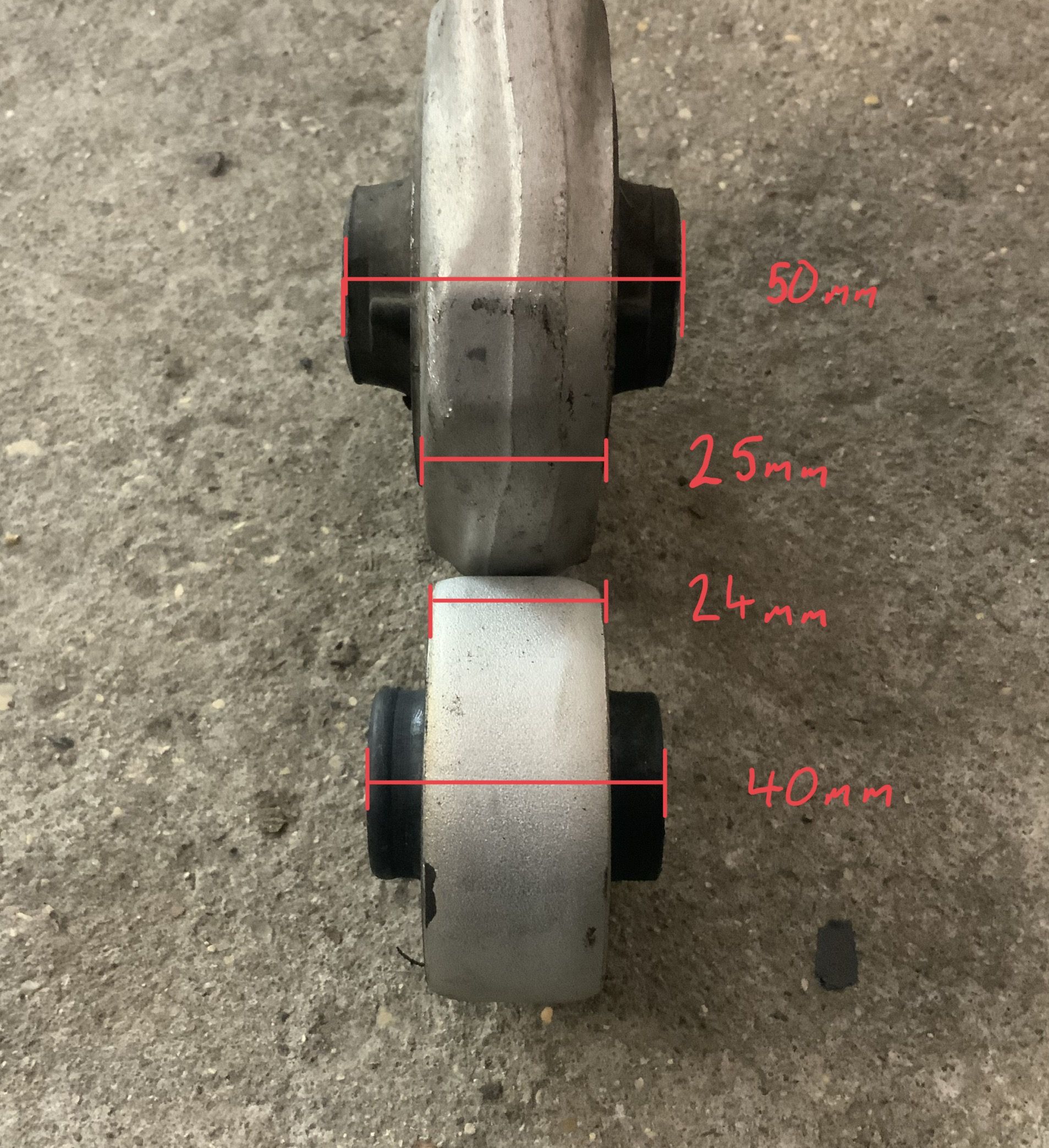

So let’s get a spare bush and do some measuring
Cast arm from Mk1 Audi TT/ Leon Cupra R
And the Mk3 Audi tt?
Ok, so it’s a little bit of the subframe and the bush stopping it
Confirmed. Would I be really lucky and the bushes are the same diameter?
Not that lucky… but you know what? It’s pretty damn close
And length of the whole thing? No point doing it if it doesn’t get close
Which is within tolerance of the stock stuff. Ok, doesn’t make for a wider track but that’s ok.

Subframe needs modifying at the back, I’ve already checked and there should be enough clearance to make that work (approx 60mm space which is more than enough).
Either the rear mounting for the LCA needs modifying or I need to install a sleeve for a castor adjustable Mk1 TT bush which should mean it lines up with the standard position.

So is it worth the hassle? Yeah, I think so.
The weight of the upright and LCA (inc bottom balljoint) is 10kg. Don’t know how much the Mk1 TT stuff weighed but I remember that the bare hub was noticeably heavier than the Mk3 hub shown. That means a significant saving unsprung mass (a good thing).

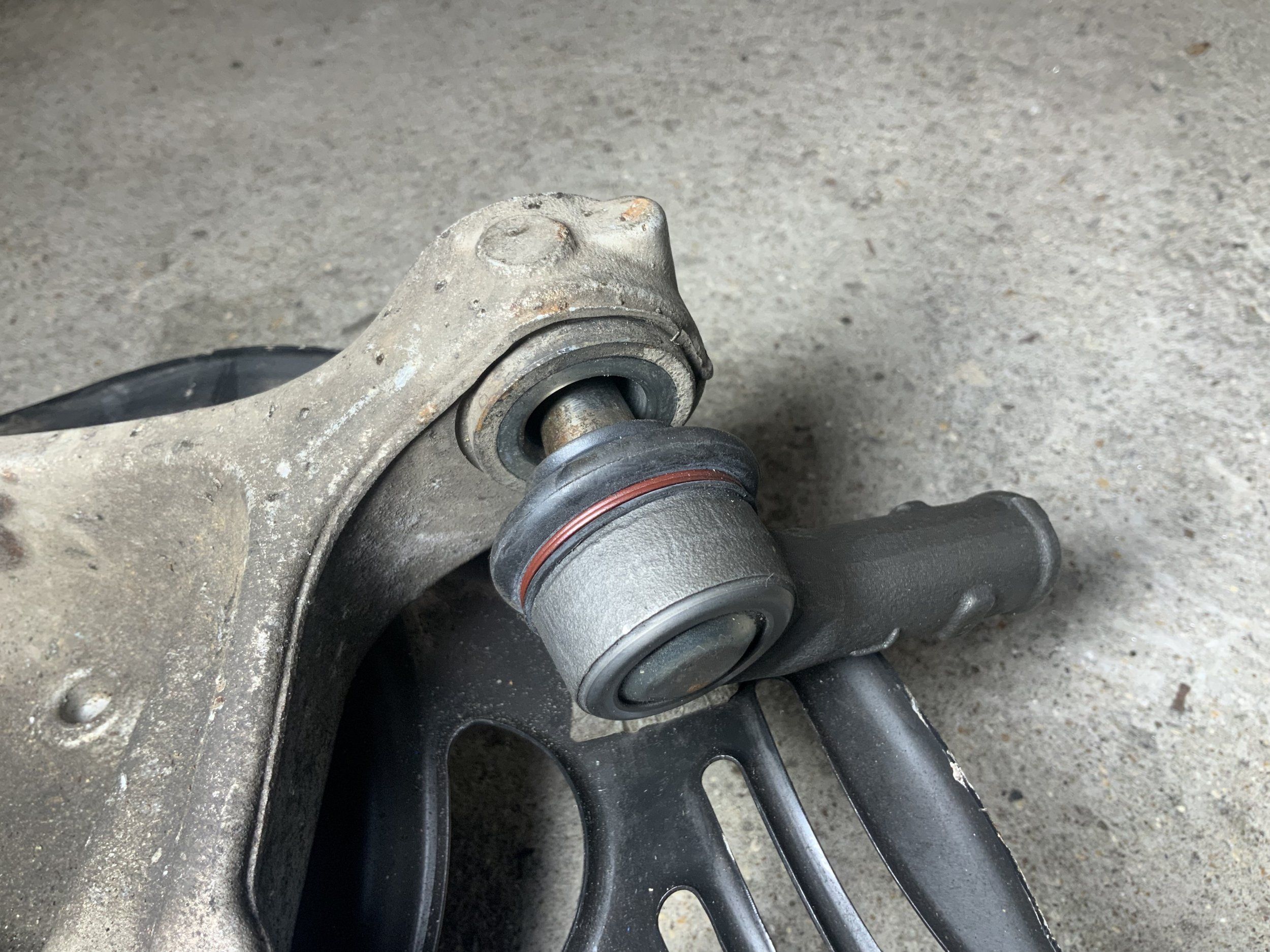

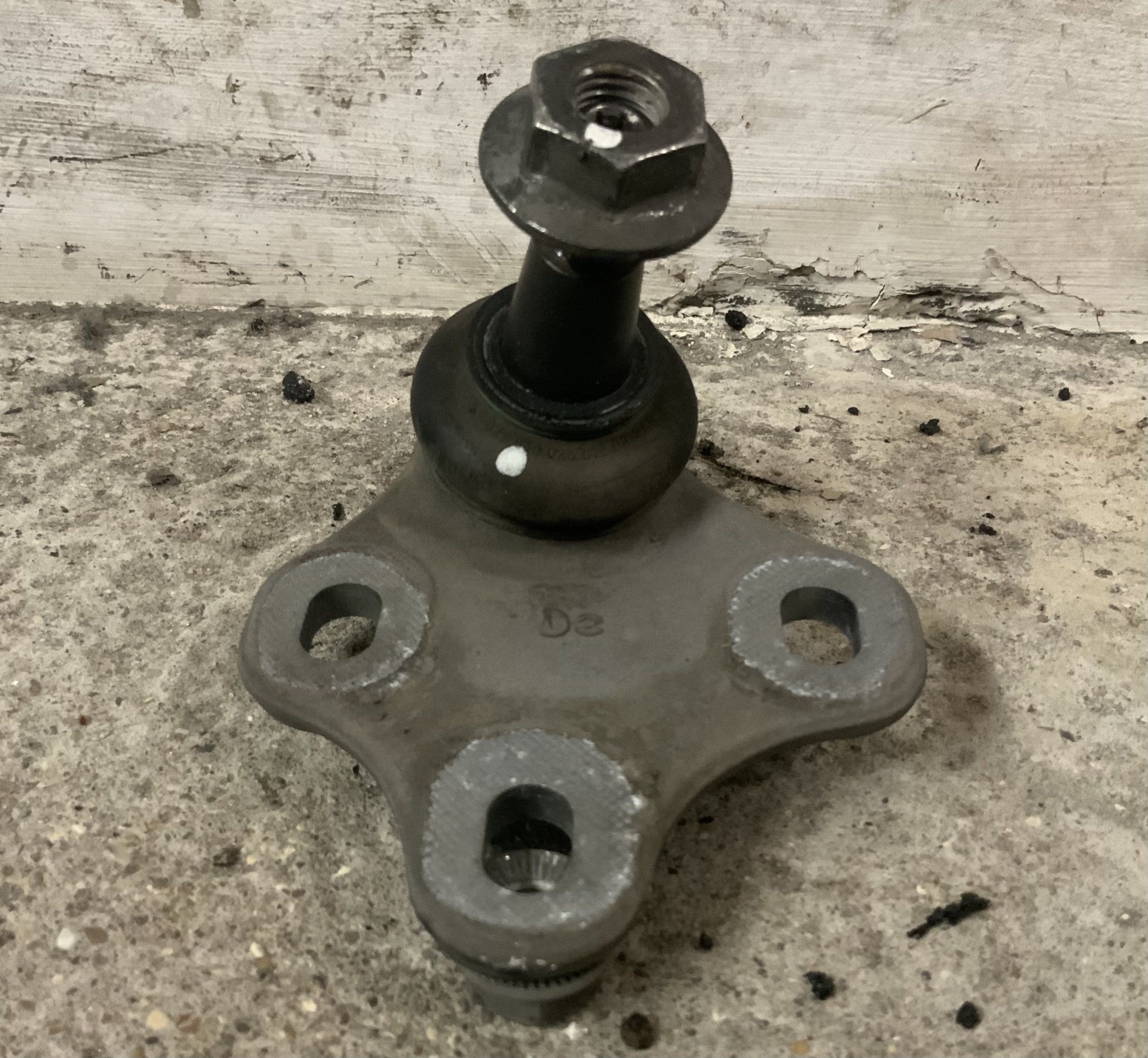

Next is the balljoint. As shown in this picture,
it’s offset which means the setup is going to have large amounts of caster which means less reliance on static camber.
Wheel bearings can now be achieved without a press
And last but not least, it’s alloy! That means that rust is much less of an issue and should mean longer serviceable life for the parts.

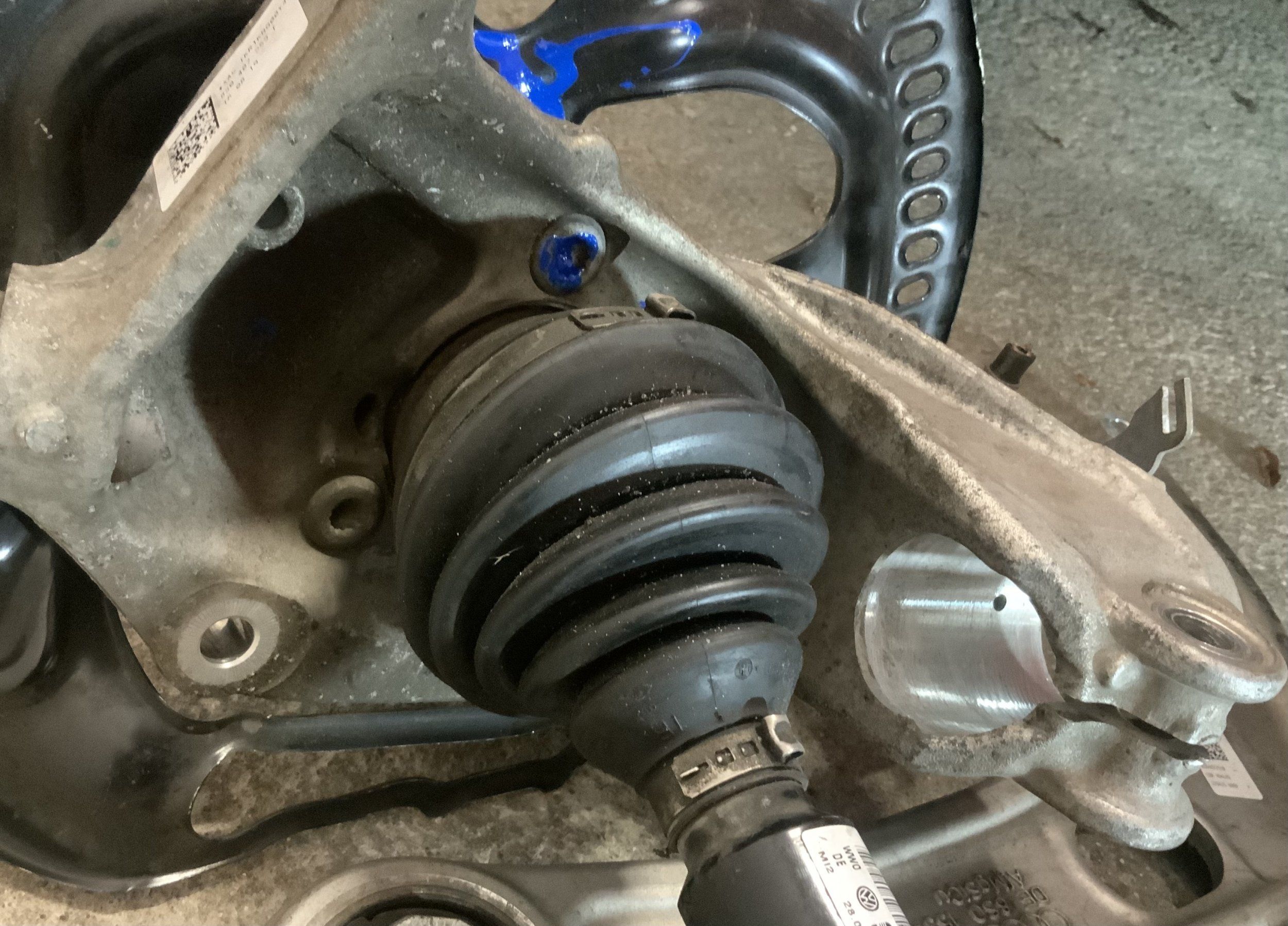

Just remembered, didn’t mention about driveshafts. Do they fit?
Sort of. Splines are perfect fit but are a bit short, say 10mm at most inside and then not long enough on the rest of it. Tried a Cupra R one and the same story, splines fit but the bolt hole sat inset so may try rebuilding my spare driveshafts with Audi TT ends… or see how much Audi TT ones are (guessing they’ll be “🤣 no” price)
