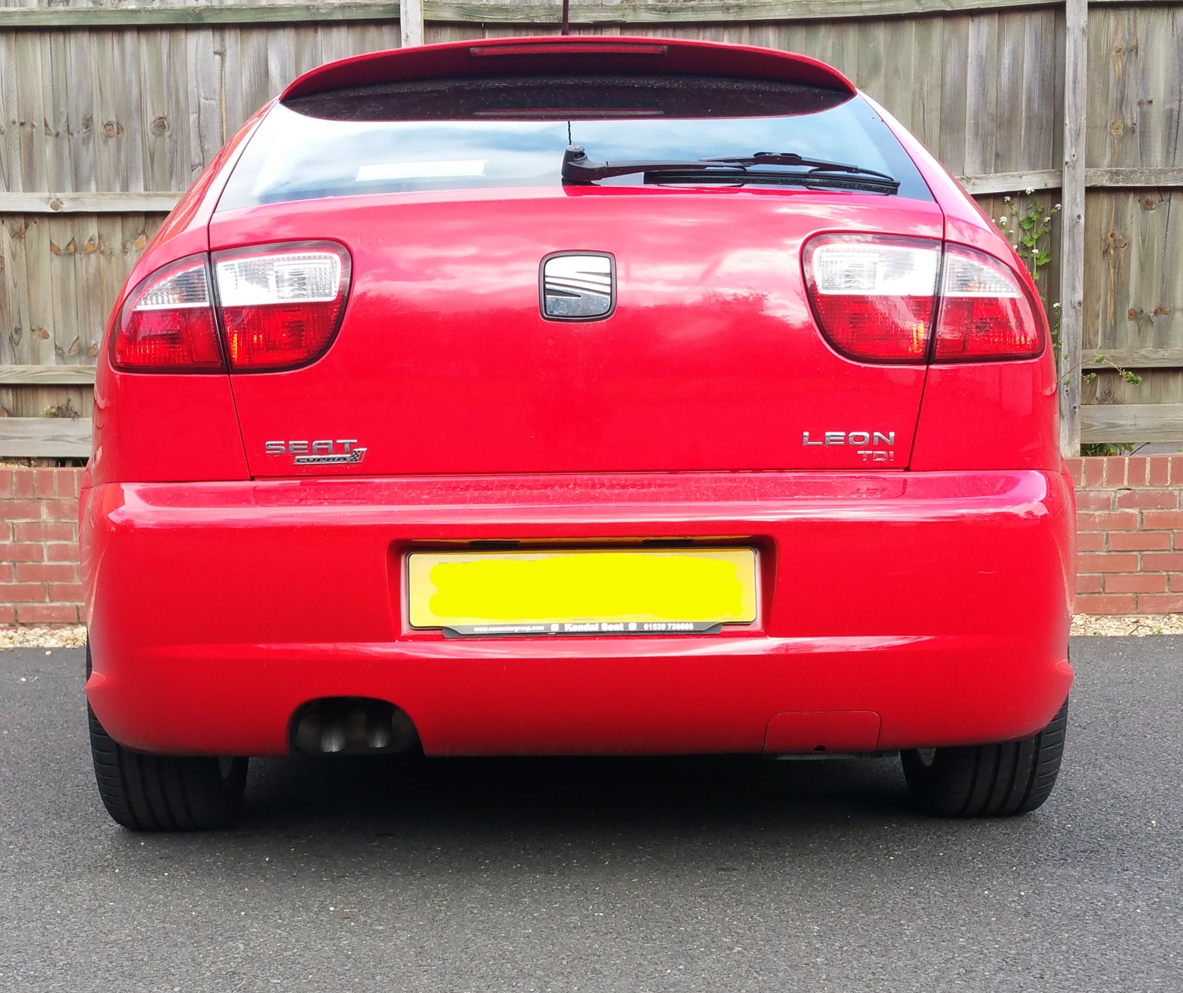

My last project didn't quite go to plan, a race car was a fun idea but the car in question probably wasn't the best choice. So I have my 'snow car' (usually ride a bike but snow is... interesting).
It was pretty standard (don't look at the exhaust) and I was thinking about getting shot of it, picking up something newer on PCP.
But it's now destined for upgrades because I figure I can play around with aero etc and if it breaks I can pick up another and swap the parts over. Also I have spares from the TDI I scrapped so I can test bits out if needs be.

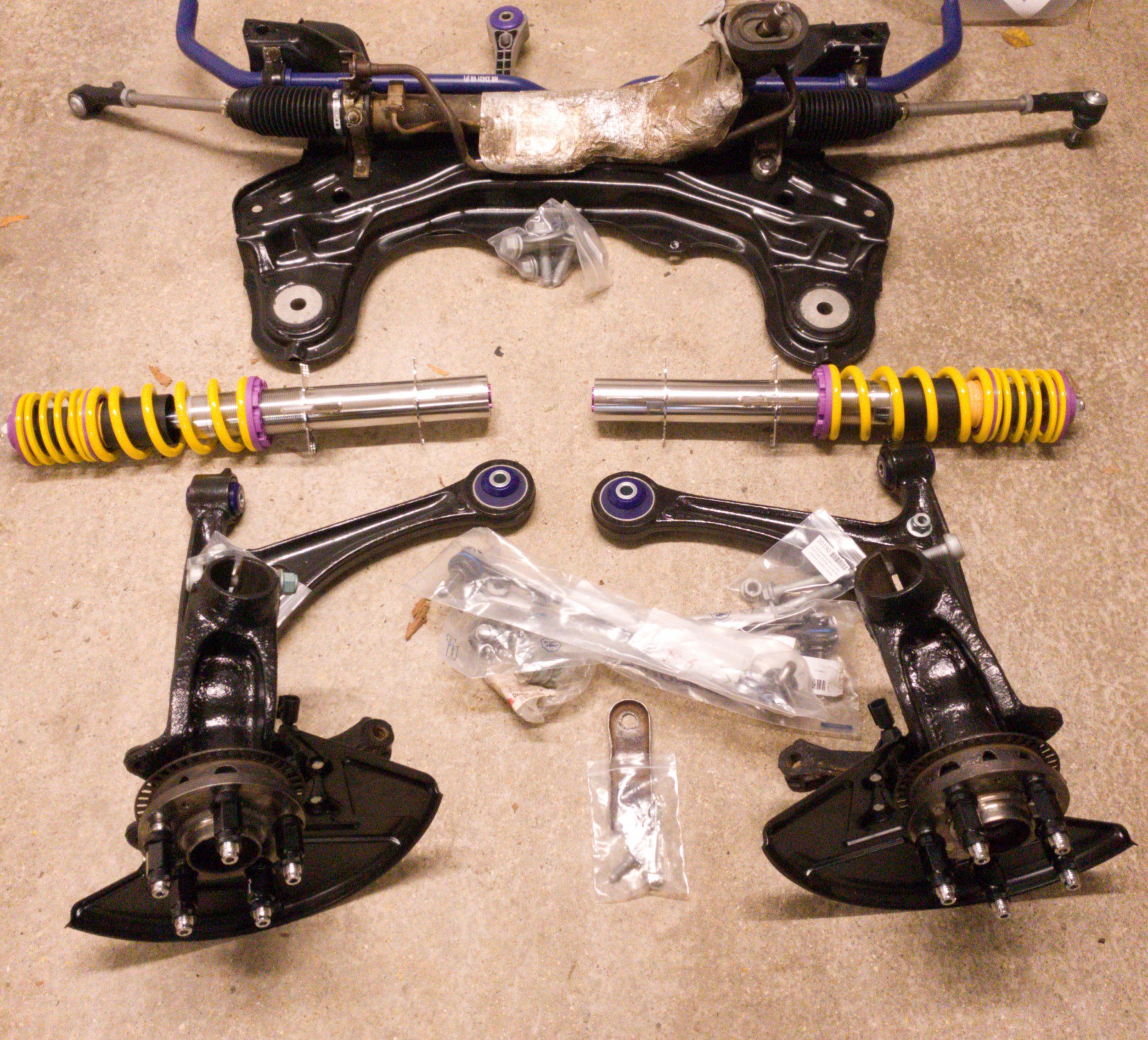

KW V3 coilover suspension
H&R 25mm adjustable front ARB

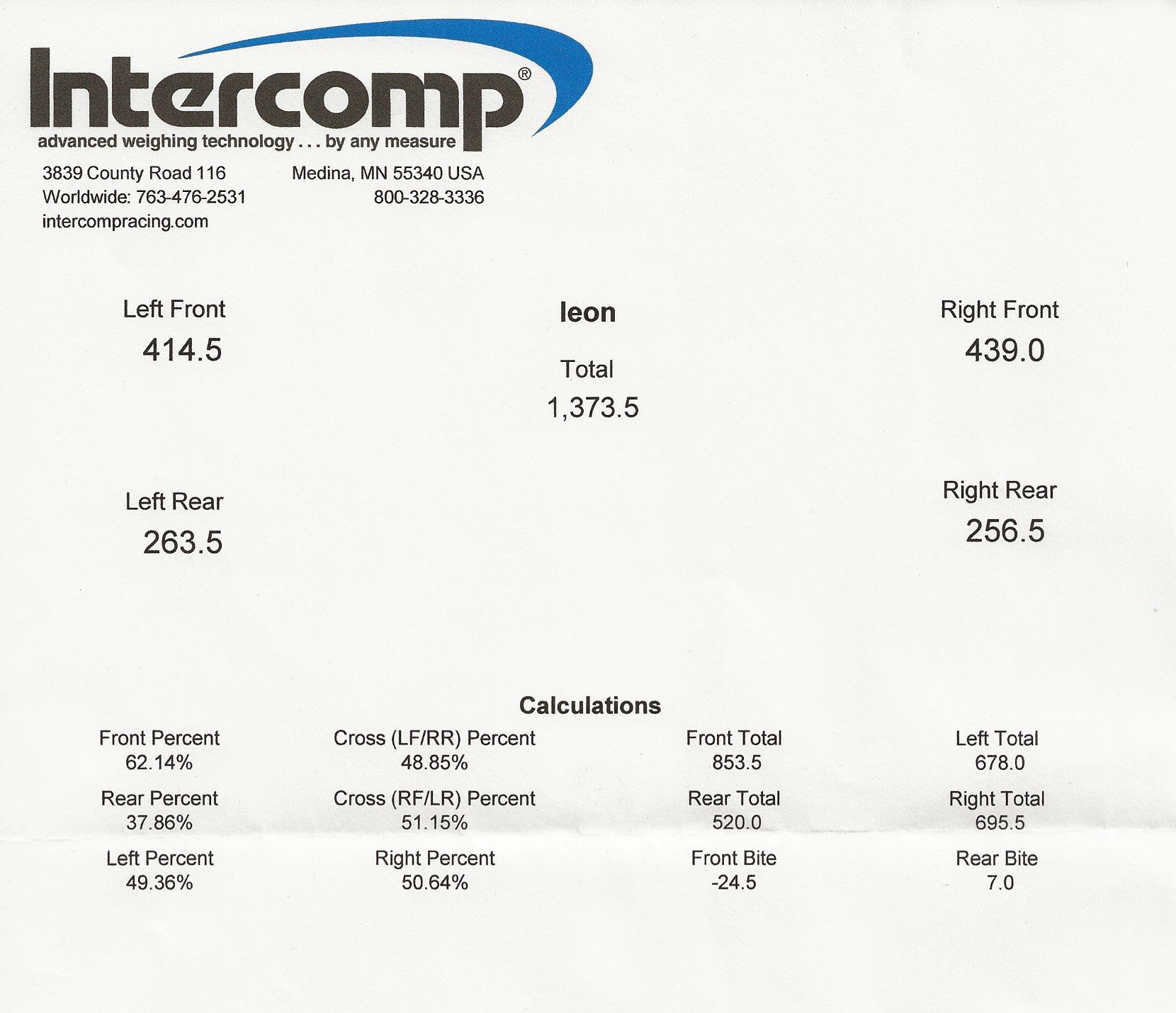

Thought I'd get a baseline figure for the weight of the car.
This is every fluid full, full leather electric seats etc, no driver.
Not bad balance but would like to get that weight down
Reactions: Manic172 and Syphon
Oof- quite some weight!
What are the standard ARB diameters? Shouldn’t the front be somewhat thinner than the rear to dial out any inherent understeer?
I’m sure that was the case from my tweaked mk2 Golf days
Yeah, it's not the lightest but will be getting stuff on the scales soon and see where weight can be offloaded/moved around.
Stock ARB is 23mm up front with no rear ARB so 25mm front and back makes a difference, it feels very planted in a neutral way, haven't really pushed it yet though

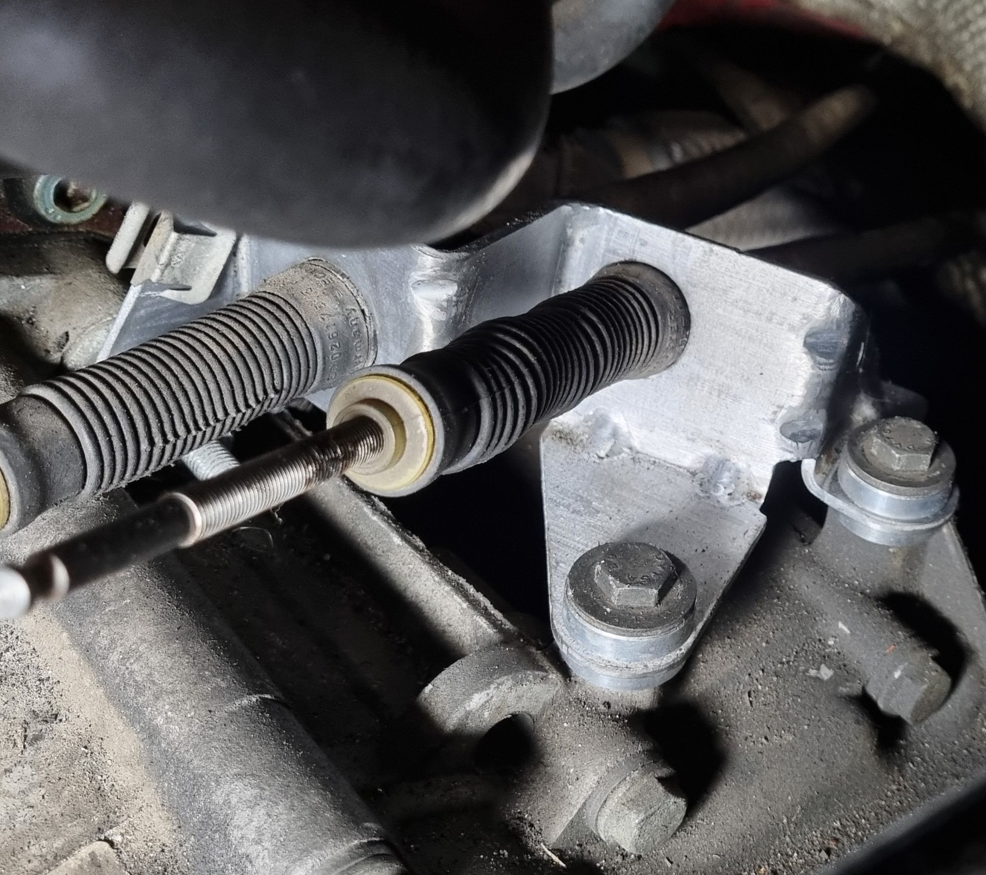

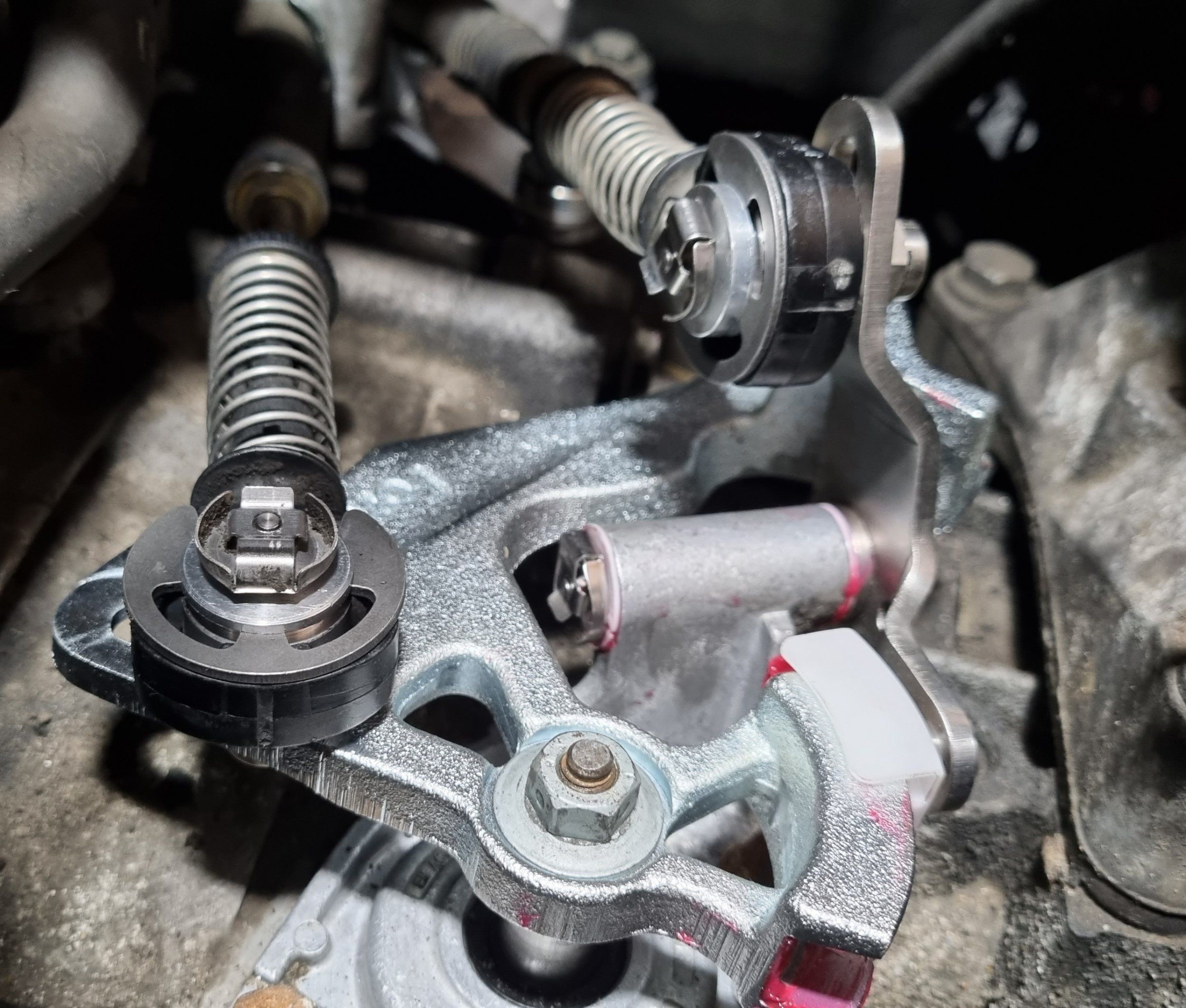

First change was the shifter
Forge short shift kit (both front/rear n side)
Darkside solid cable end bushings
A recon'd bracket fitted with 42Draft solid bushings
The test drive showed the downside which is that it's a very notchy feeling when shifting (it's set to almost 40% reduction in both planes).
On the upside it's extremely direct which means heel n toe has gone from being ill advised to an absolute joy, it really makes it worthwhile.

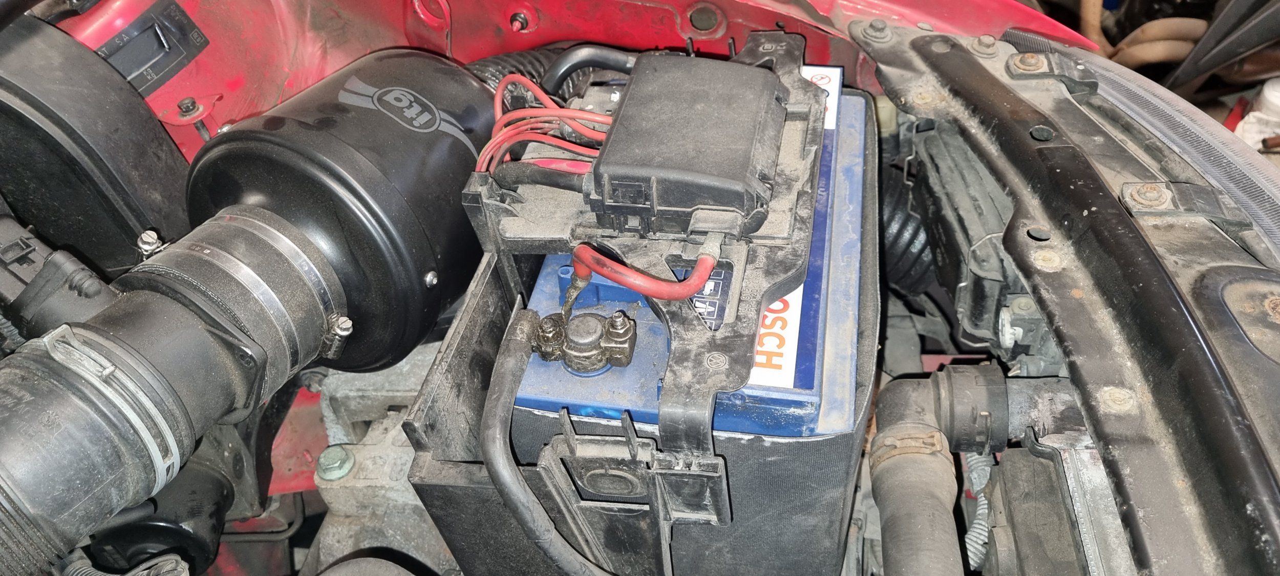

Next (and possibly the most controversial) bit is an ITG Maxogen induction kit
It's eye wateringly expensive (in my defence it was advertised as being made of carbon fibre on Awesome) and I know some will question its usefulness on a diesel but there's method to the madness, just have to wait for future updates to see why I went with it

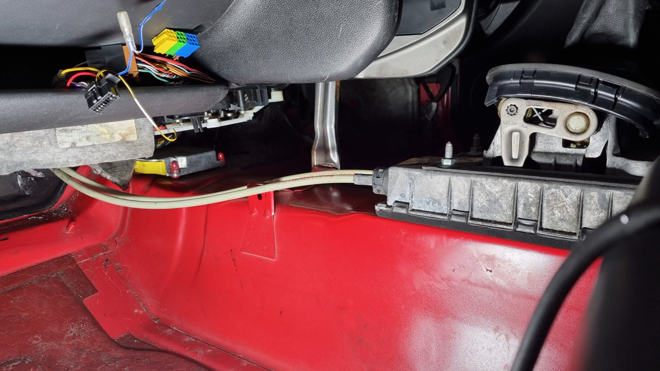

Genuinely can't believe how different changing gears is now thanks to the quickshift and now this
Mounting the lever higher has made the driving ergonomics so much better
Been a while so I thought I'd comment on the suspension setup before I say about the mods done.
Had the opportunity to take the car out on track (Silverstone National circuit) during Trax, this being its first in anger test since the suspension work. Set the shocks to full stiff at the front and not quite so much on the back, can't remember what the front ARB is set at.
So, car is in need of a power increase from a remap (fairly sure there's a boost leak as well) but the suspension is awesome.
Everything is much better, less body roll, better response to bumps. I usually run on the kerbs which previously meant a lot of noise and rattling inside the fully insulated cabin, but barely noticed them with the harder suspension and stripped out interior.
The thing that really impressed was throwing it through Copse at speed (3rd at high revs I think), back end leaning out as opposed to the understeer expected, and then being able to modulate that with the throttle. Wasn't expecting that and very happy.

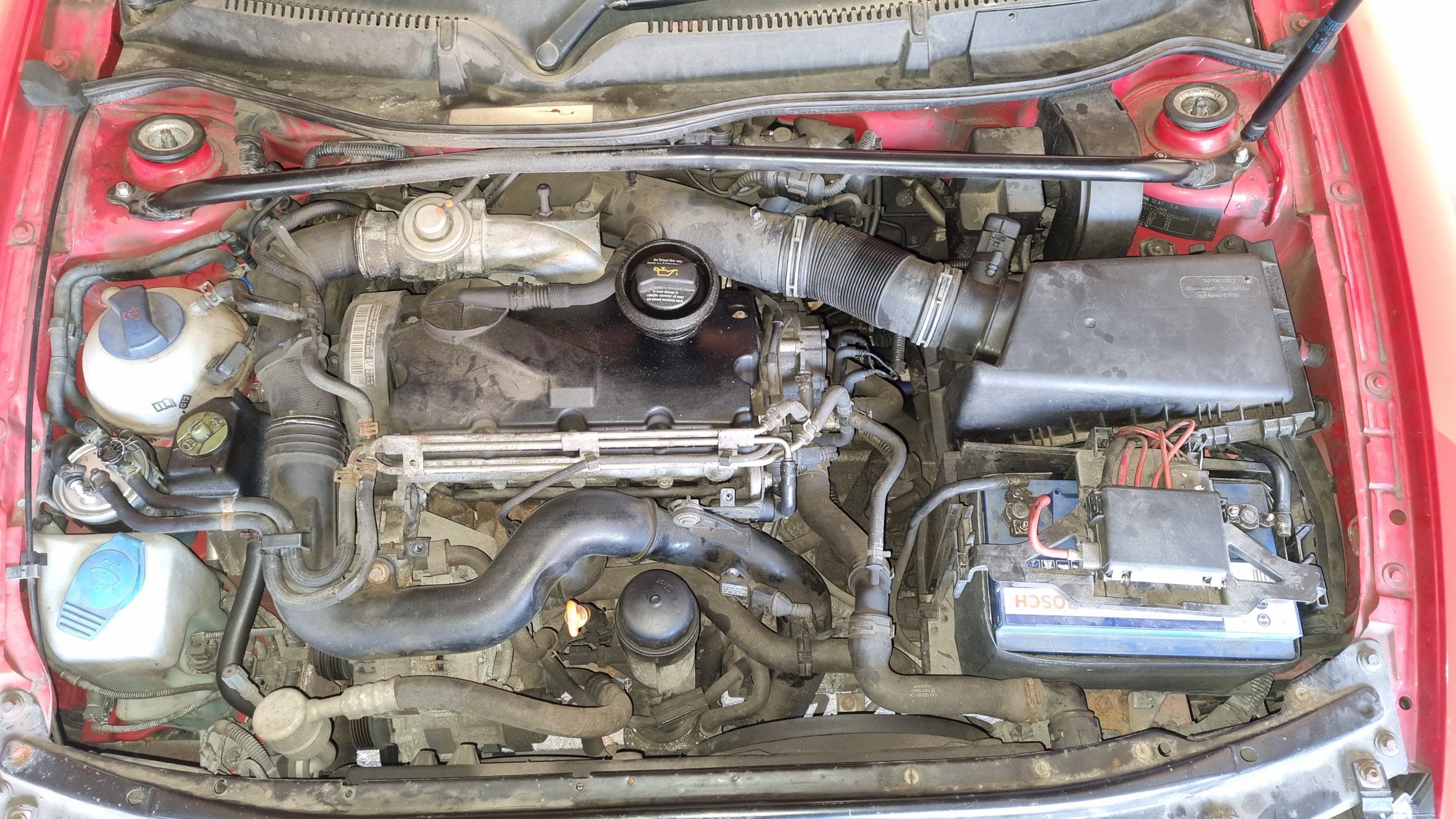

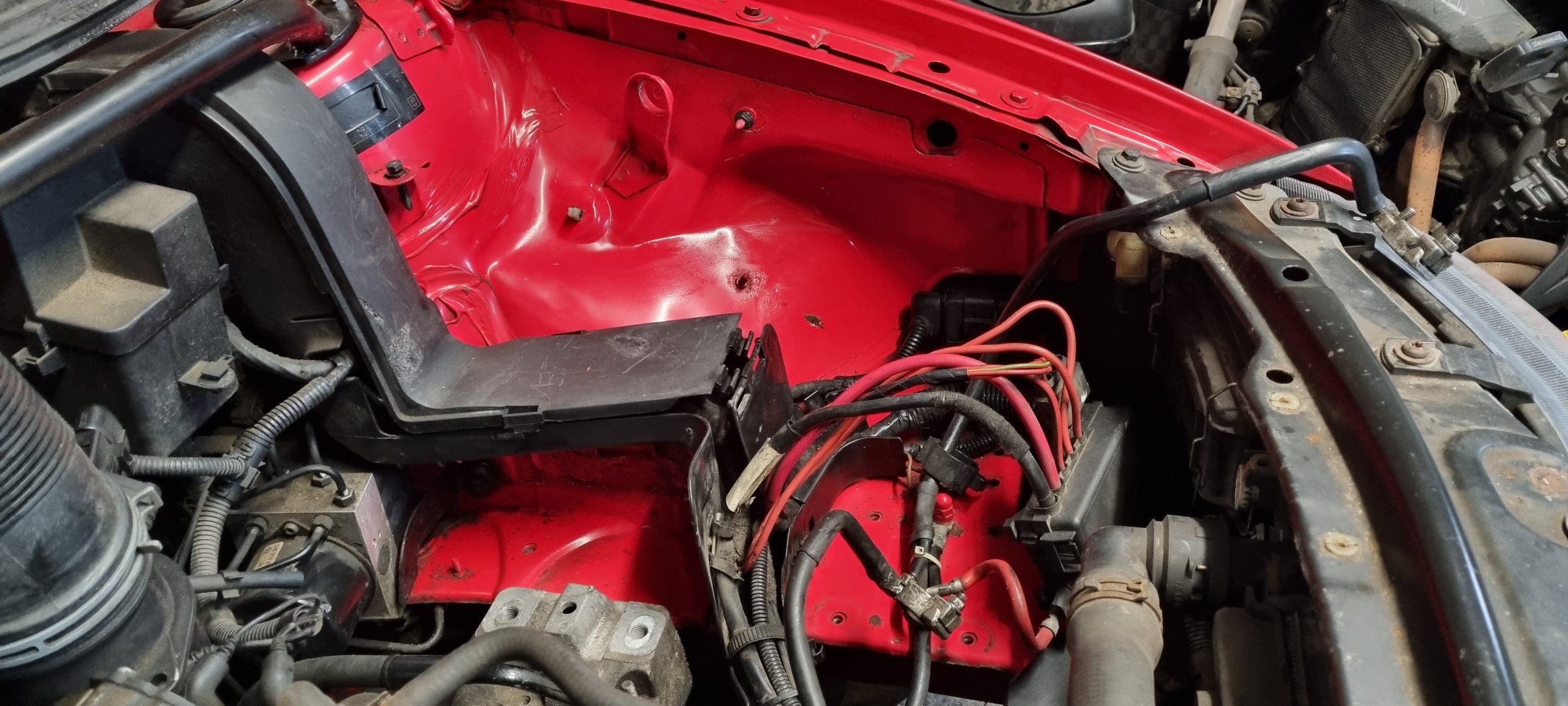

So it's winter again and that means it's time for some work on the Leon. Today was a relatively easy day, playing with things on the passenger side
Started out like this
Stripped things out and thought "Let's give it a wipe down"
That's better

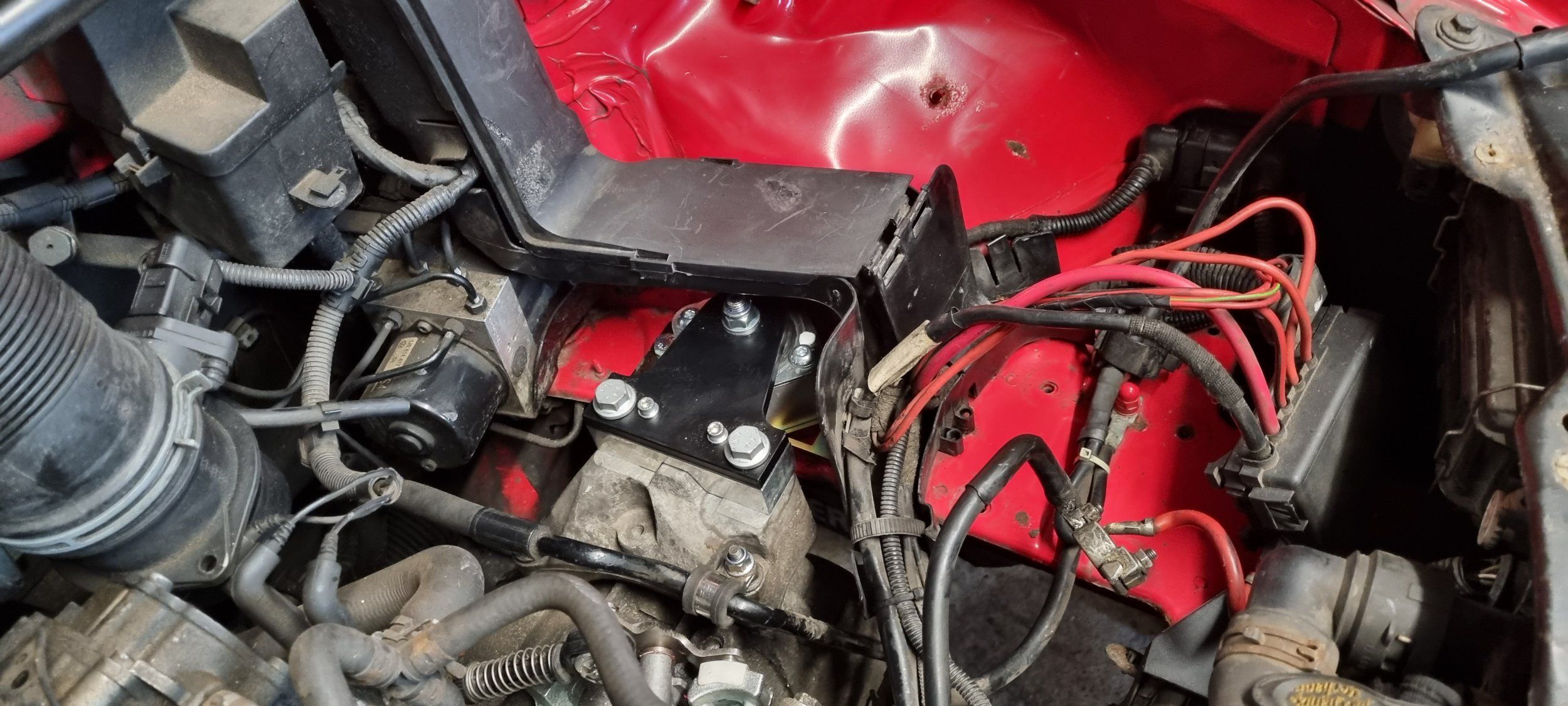

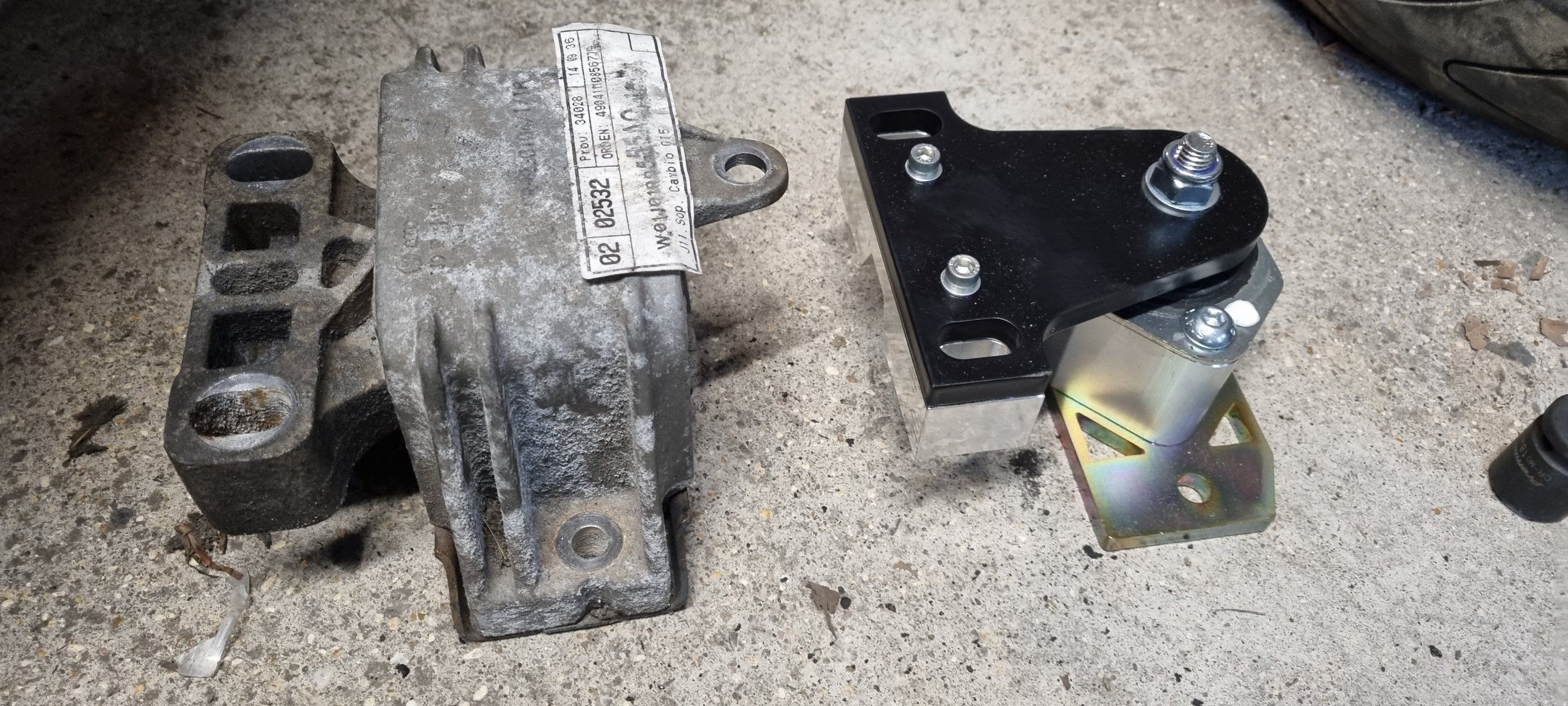

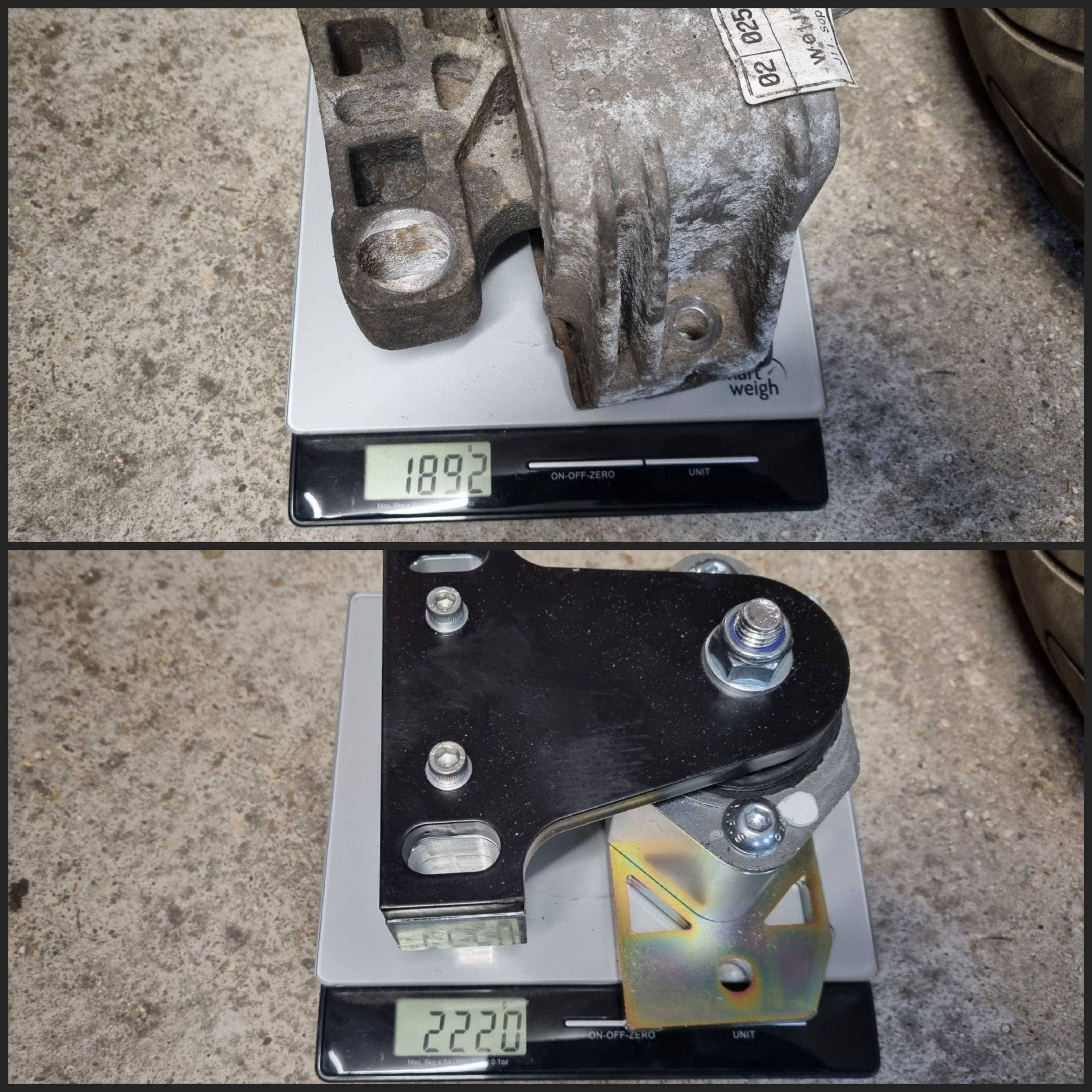

First job was swapping the gearbox mount, don't think the OEM was in bad shape but hey, upgrade
Gone for the Vibratechnics Street Density as I thought Track would be a little bit much.
Was surprised by the weight difference
Fitment was pretty easy really and it looks pretty good too
