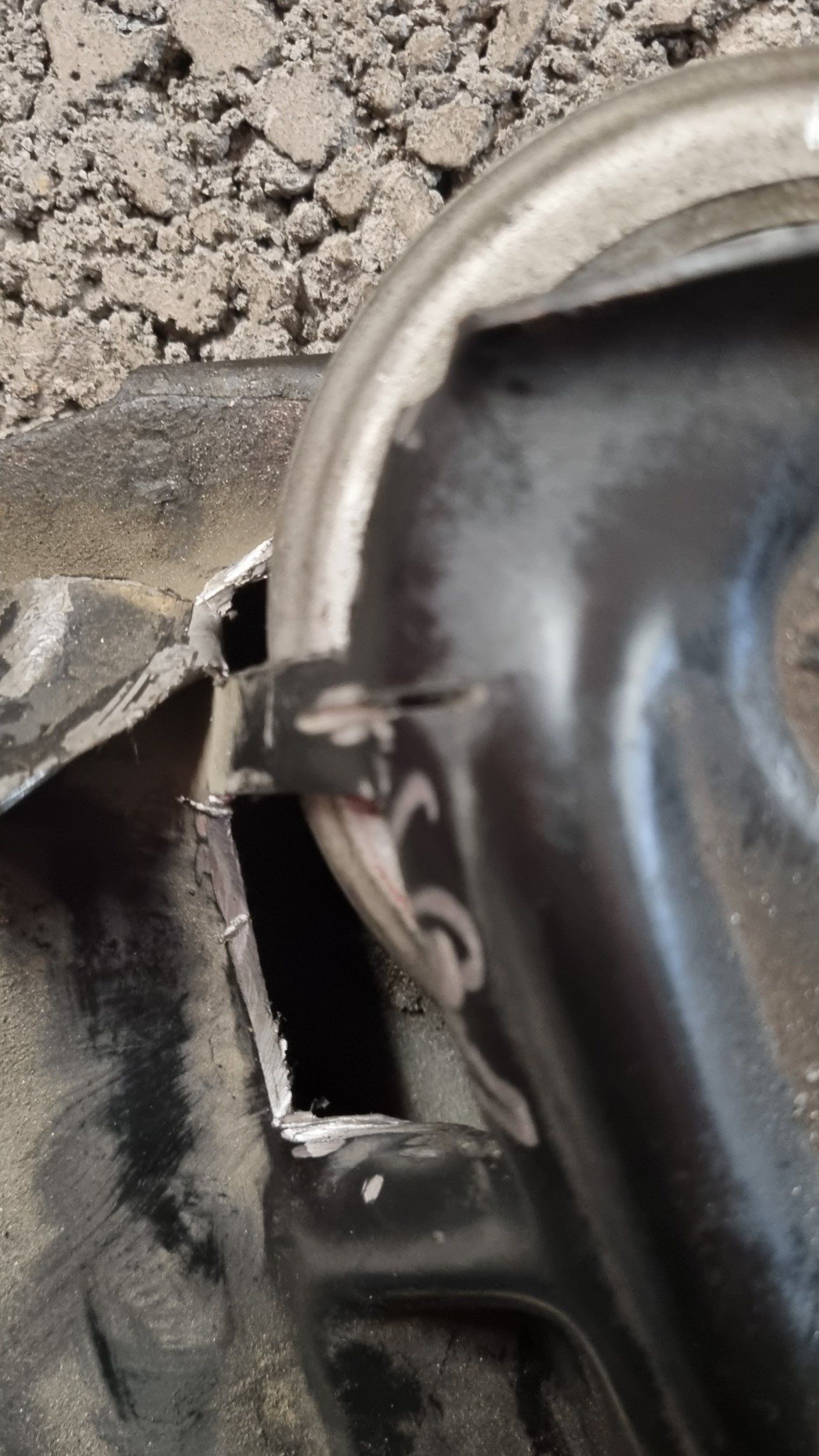

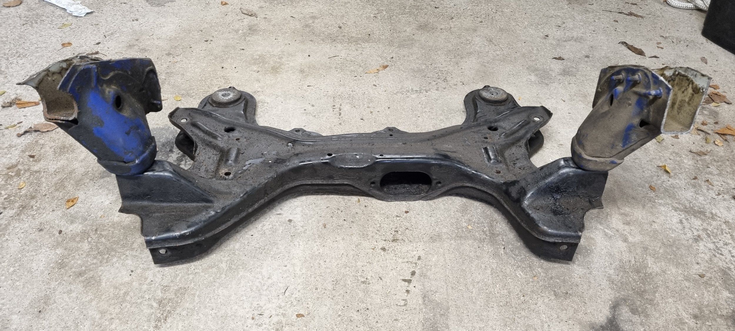

Little tests on the subframe. Trying to remove as little metal as possible and give enough to build off for reinforcement
That bridge piece needed some beating to move out of the way. My thinking is to plate over with 3mm to get back lost strength.

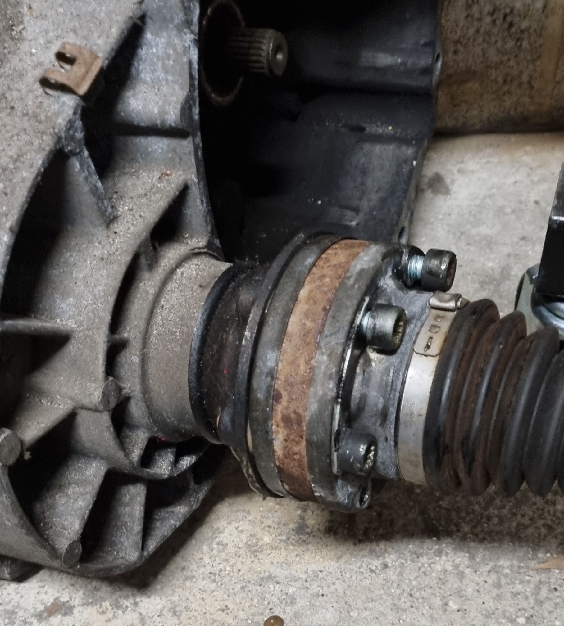

Ordered a Mk3 Leon Cupra N/S driveshaft to see how it measures up as the internet parts places reckon it's going to be close. We'll see

Driveshafts...bolt pattern looks to be about right but I can't find reliable info on lengths 😫 Some things says they are similar (depending on model) some say not, it's very confusing. May have to take the gamble on eBay again

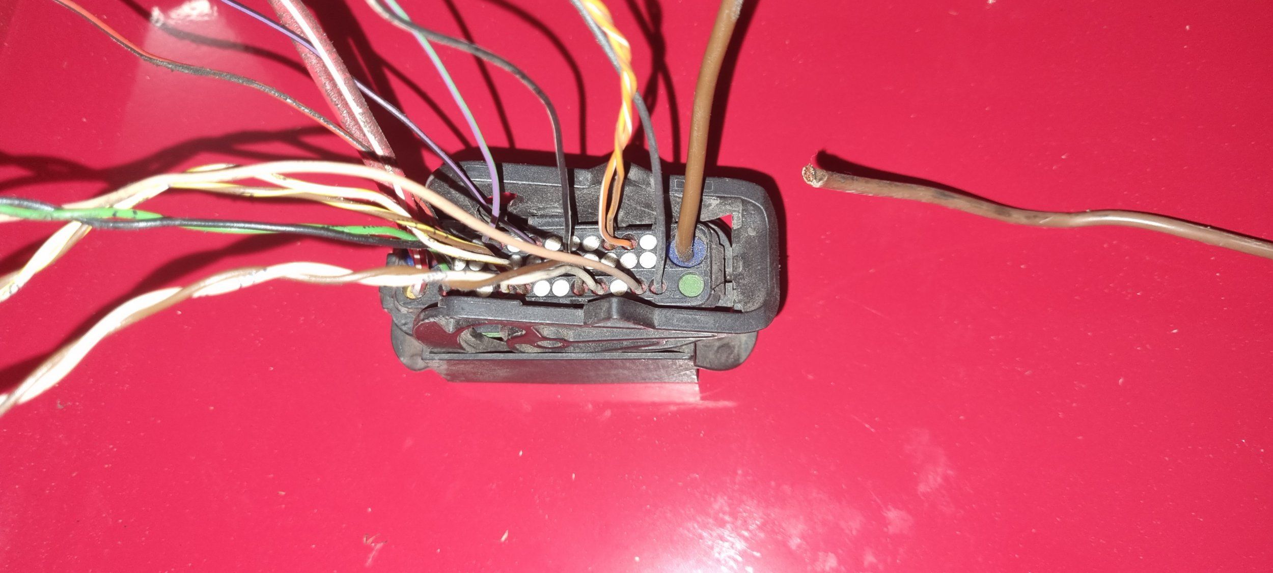

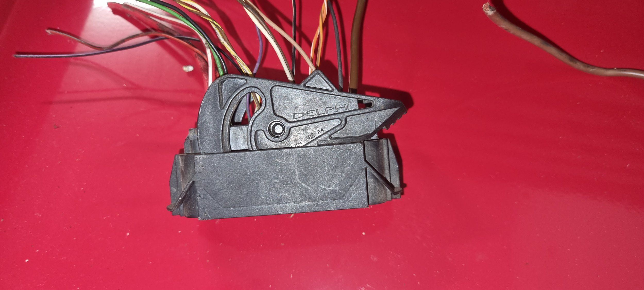

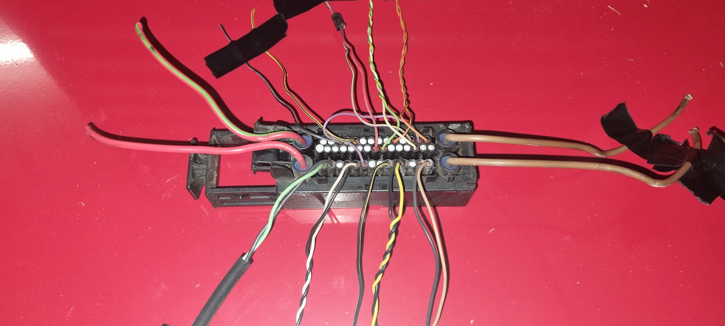

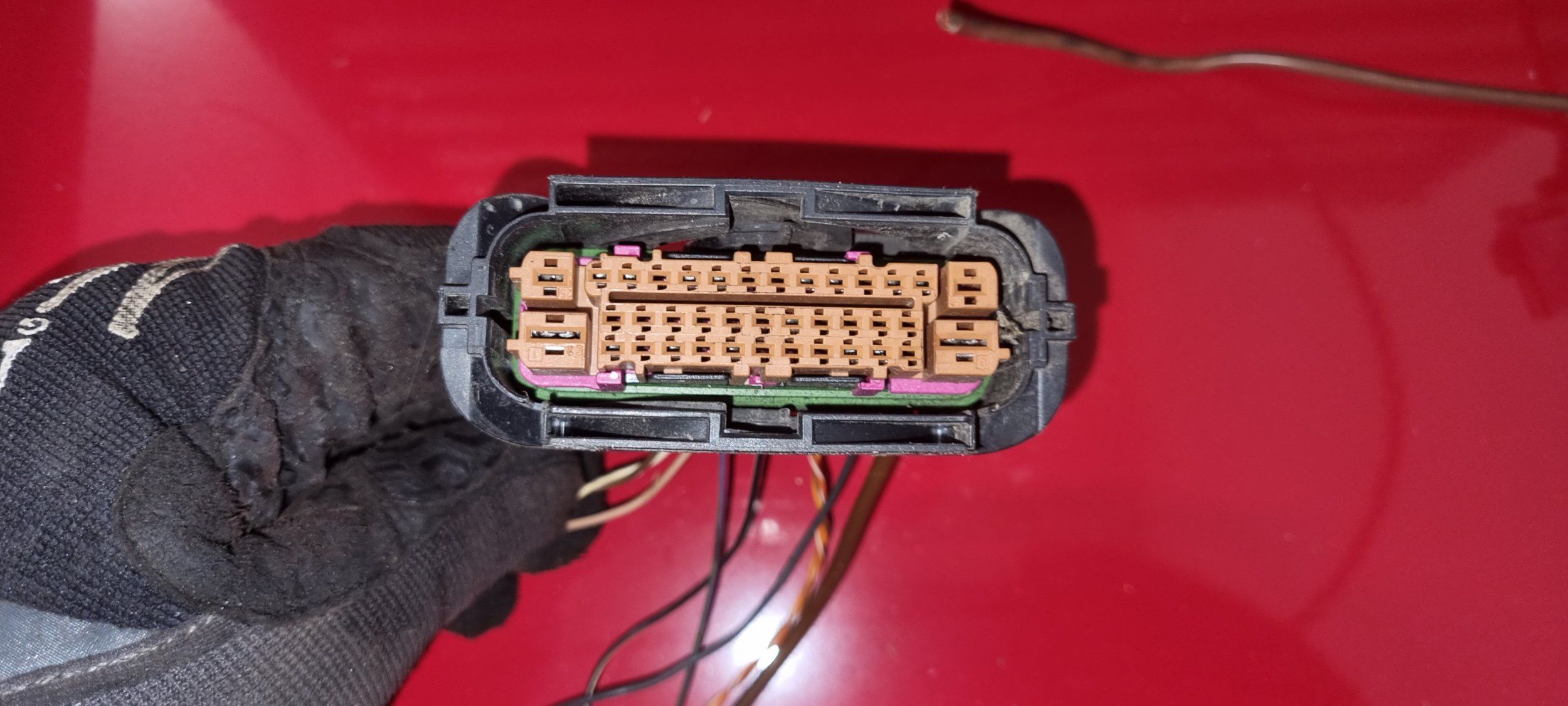

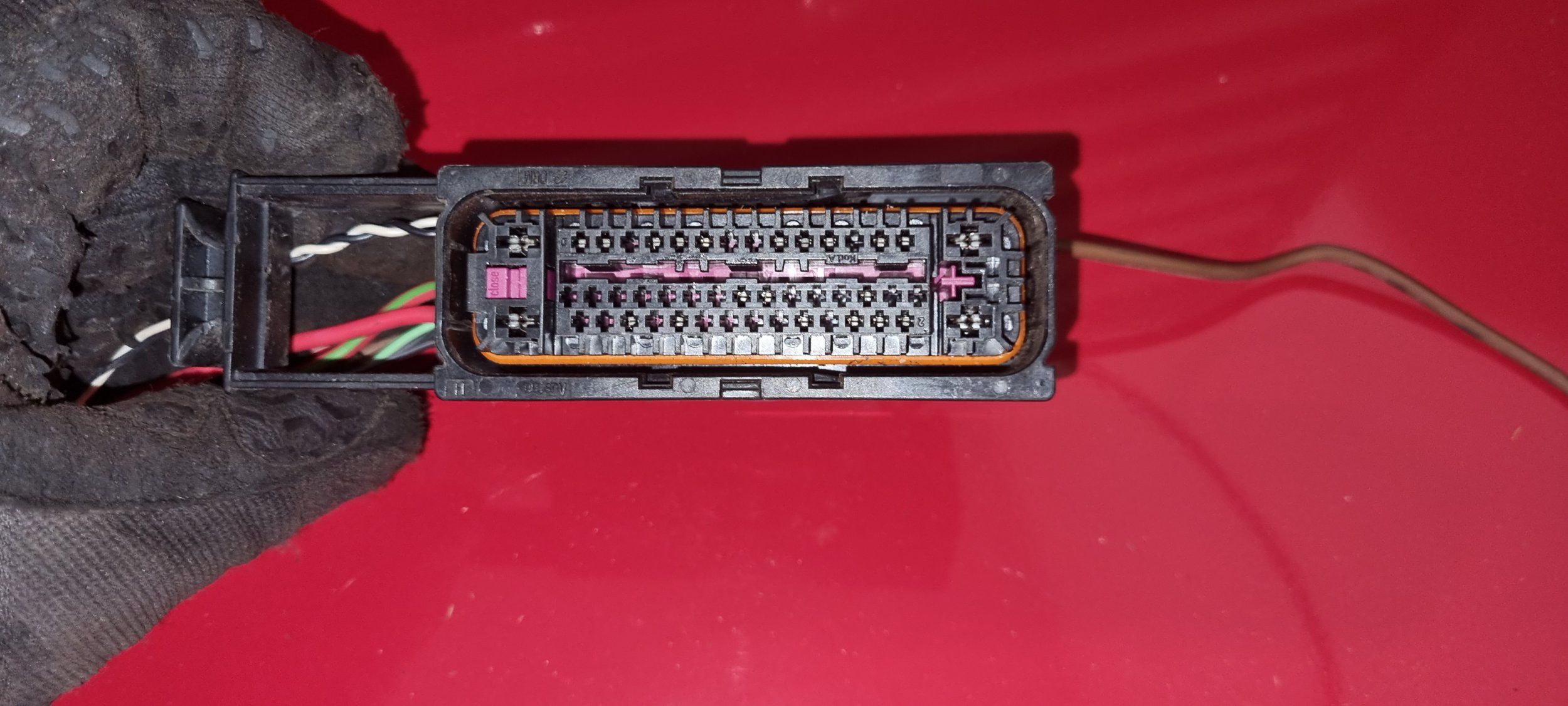

Been a while but have been chipping away at the project. Did a little research on ABS
Here's the connector from an MQB car (Mk3 Octavia)
Not even close to the one in the Leon. Now for one from a PQ35 car (Mk2 A3) which runs a more up to date version the the Mk60 ABS in the Leon.
As far as I can tell there are two extra wires and that's it. At a guess, these are probably the speed output for the dash but I'll need to do a little more research first.
The theory is that because it's Mk60 the wiring should be very straightforward and coding it into the car should also be simple (as far as coding anything in goes).

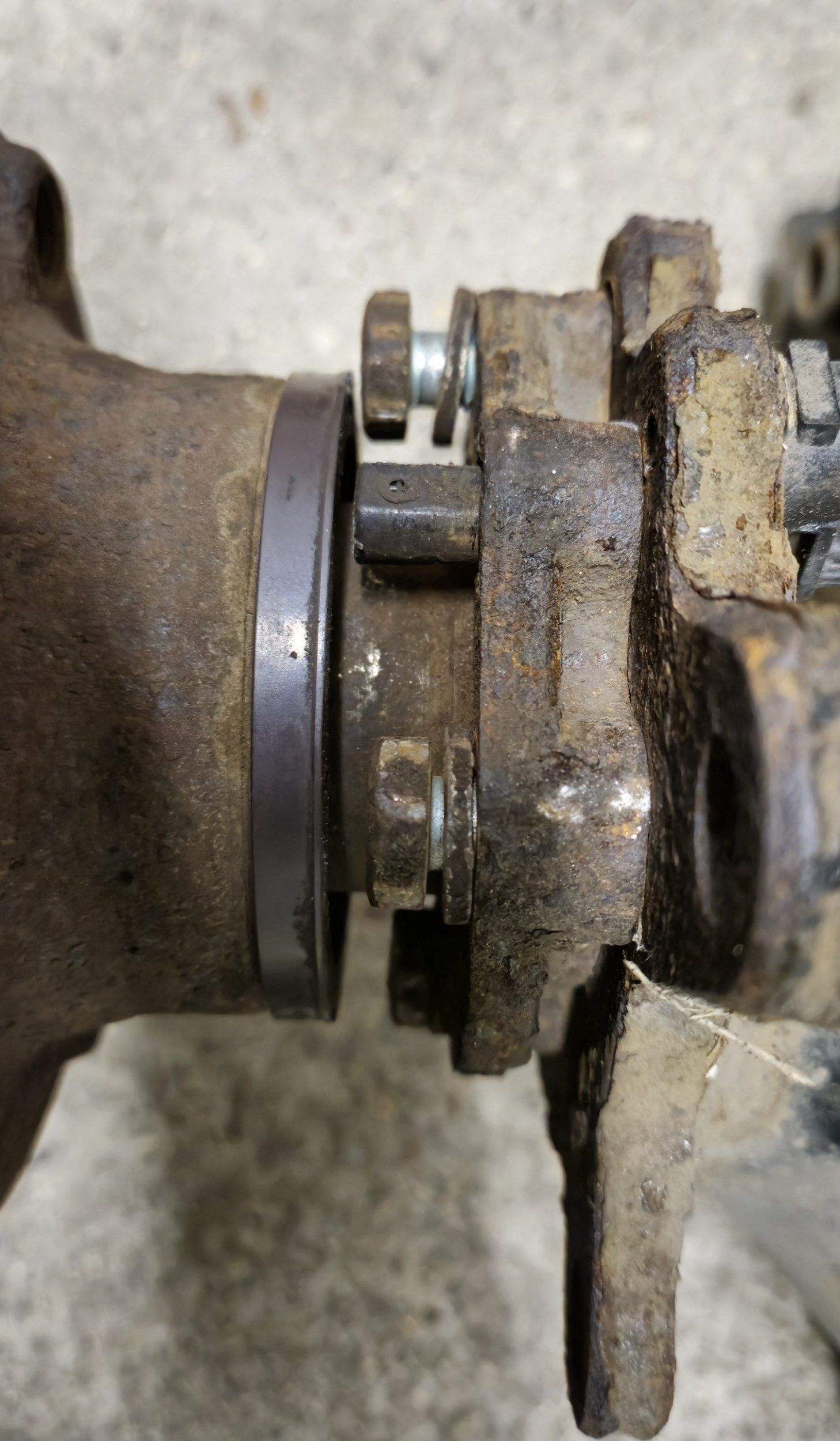

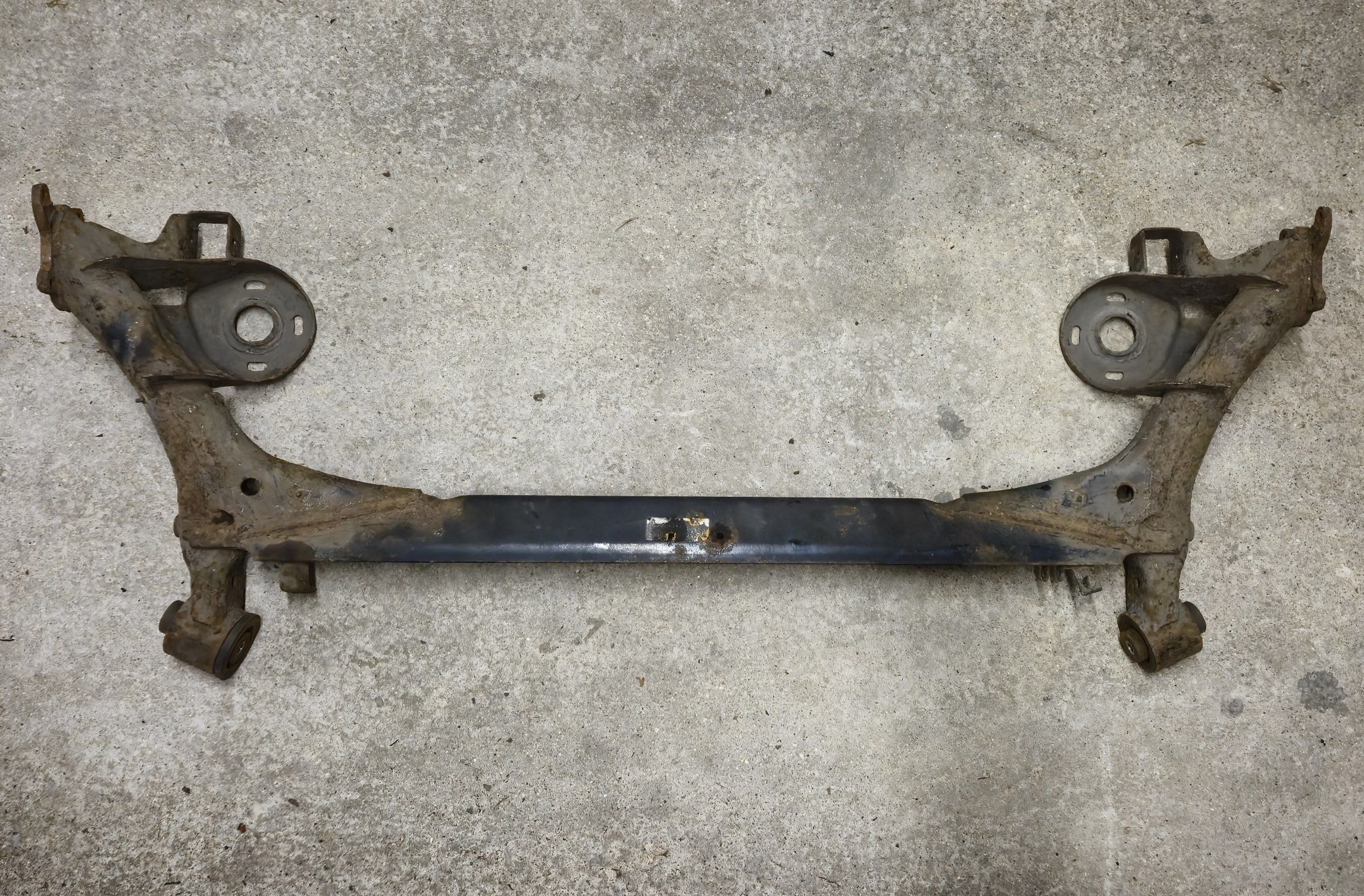

Got a rear axle and stripped it down
Also bought a rear axle from a Mk3 Leon but after sizing them up, getting the Mk3 axle to fit would've been a bit difficult.

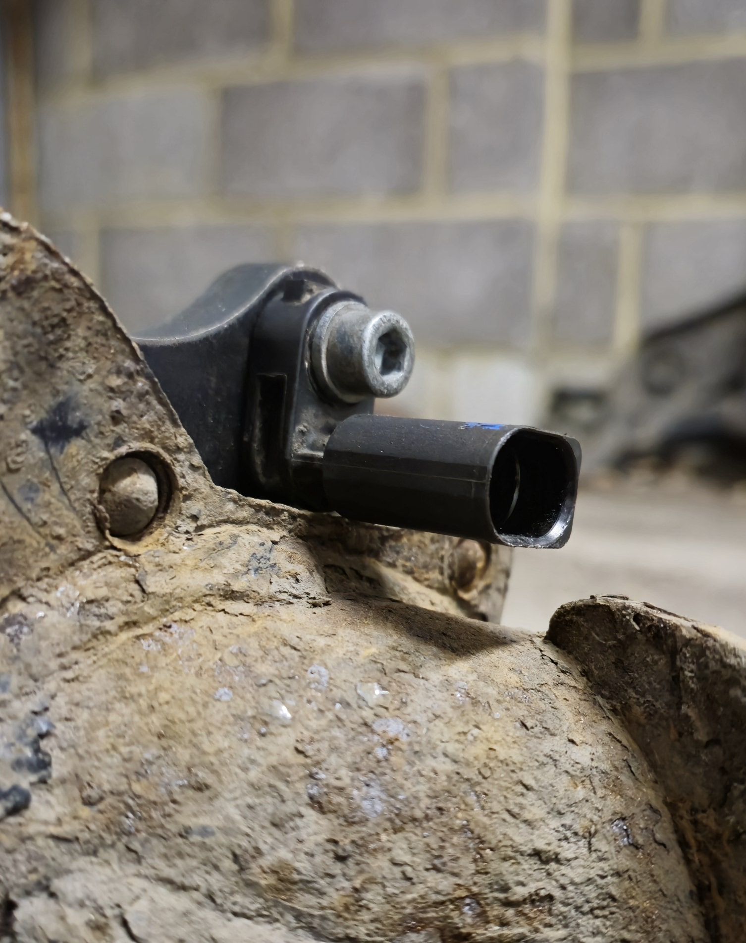

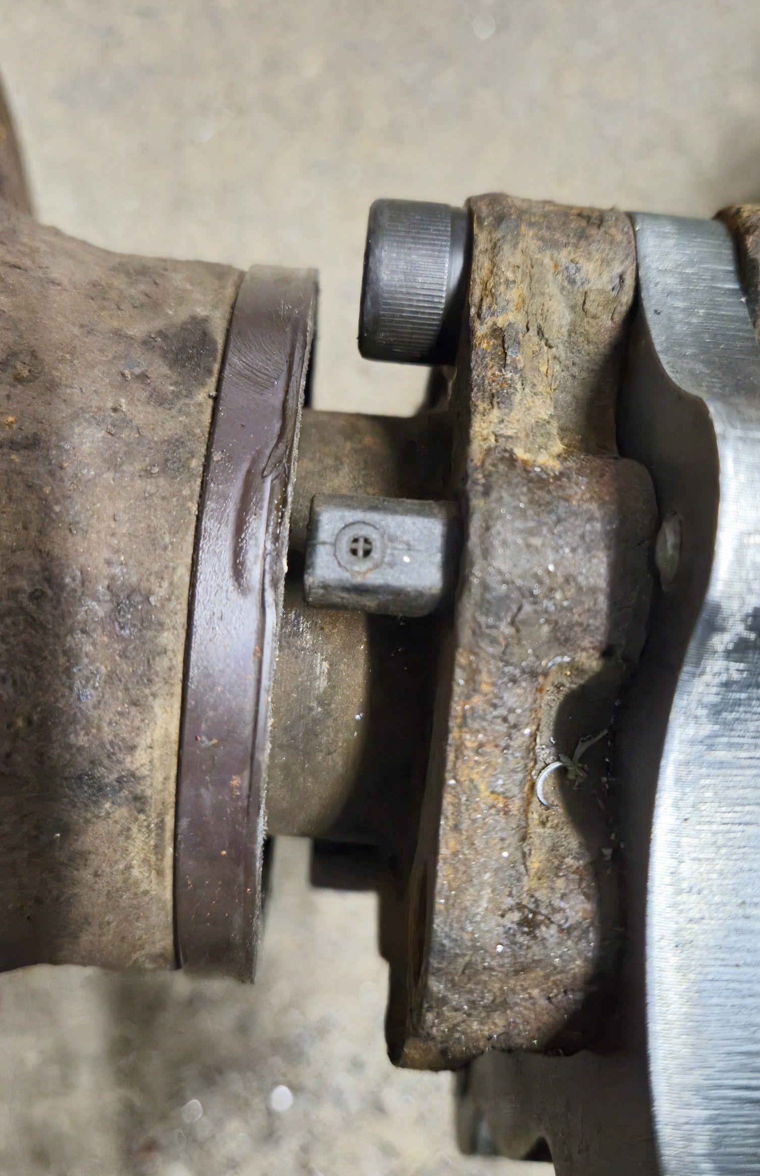

So I designed some adaptors for the ABS sensor and got them made up. Here's the test fit.
Looking good. The fit of the ABS sensor?
Snug. I'd say about 1mm between sensor body and axle, will probably clearance it a little bit as there's enough metal to do so. Don't need to but I'd rather err on the side of caution. On the important sensor to hub clearance?
vs what it's like on the Mk3 axle?
Close enough for me

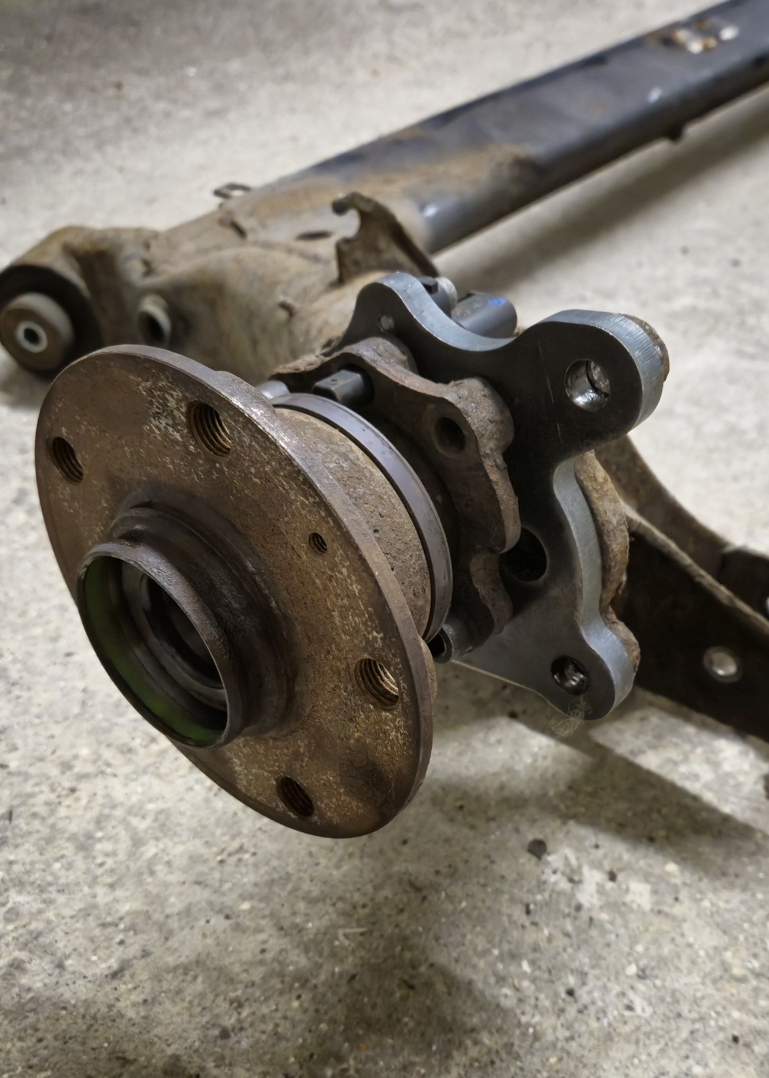

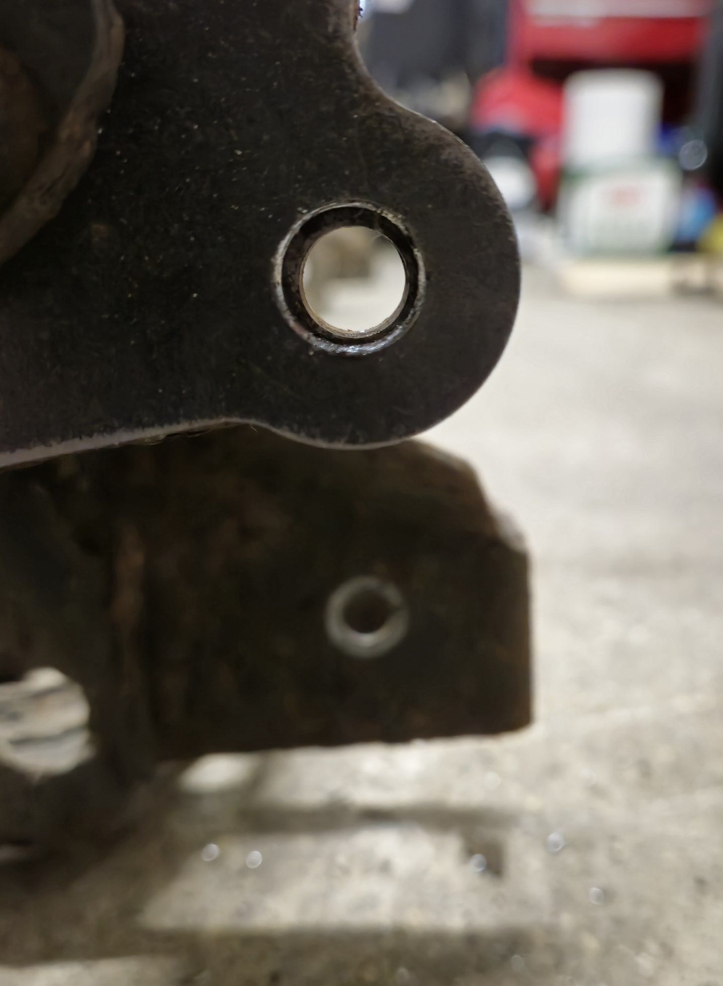

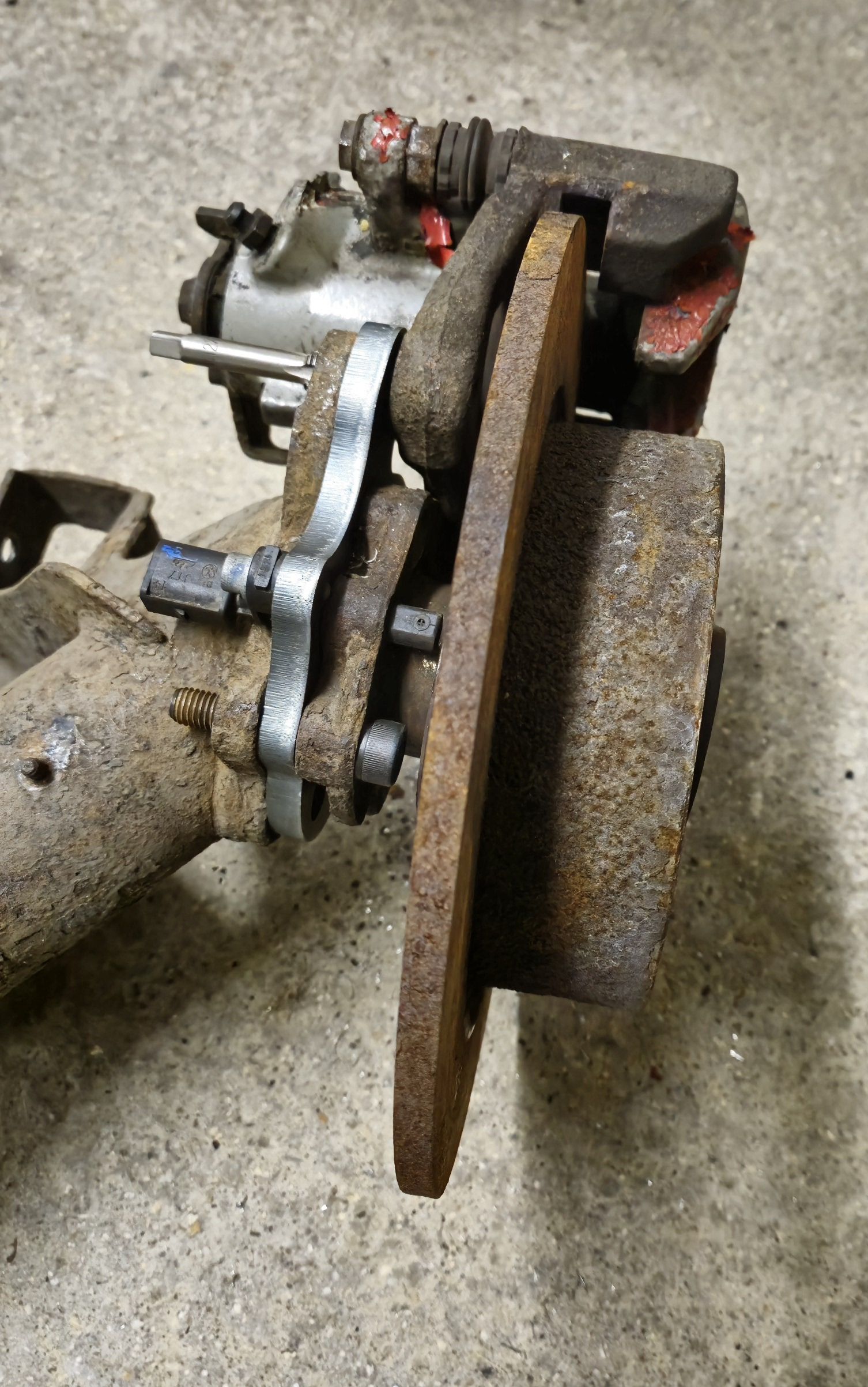

Whilst I was at it, I went for a full test fit. But first, the caliper carrier holes on the axle are for M10 whereas the Mk3 caliper carriers run an M12
A little judicious clearancing later and one rough fit ready to go
Looks good to me.
With regards to the brakes, I'm starting off with the 253mm 10mm disc (lightweight rear end) from the Mk3, but the caliper is from the Mk1 Leon. I measured them against each other and they are exactly the same, it's just where the handbrake mechanism sits.

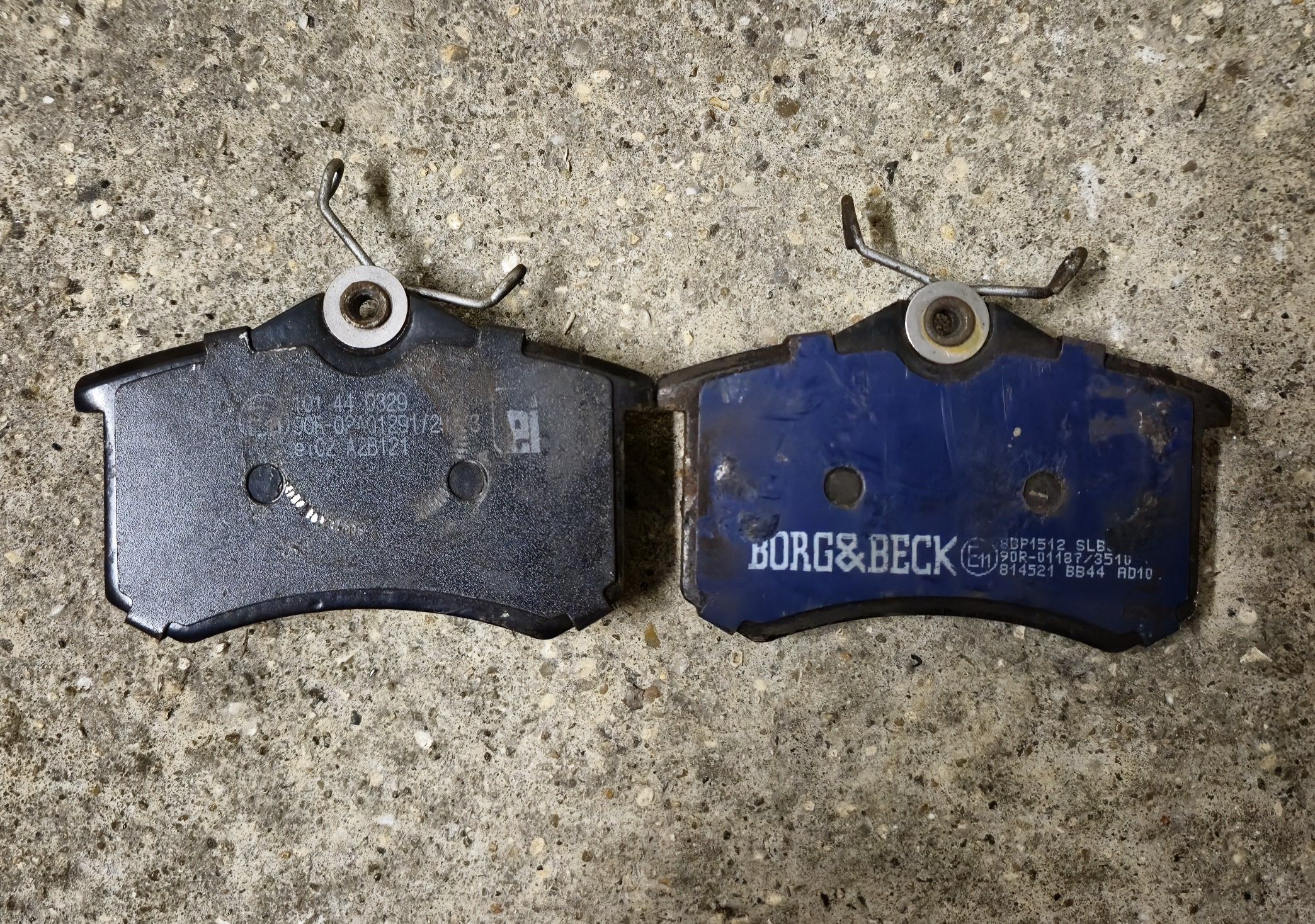

Brake pads?
No difference whatsoever between the Mk1 (left) and Mk3 (right). Other brake packages may differ, but this should work out the box
