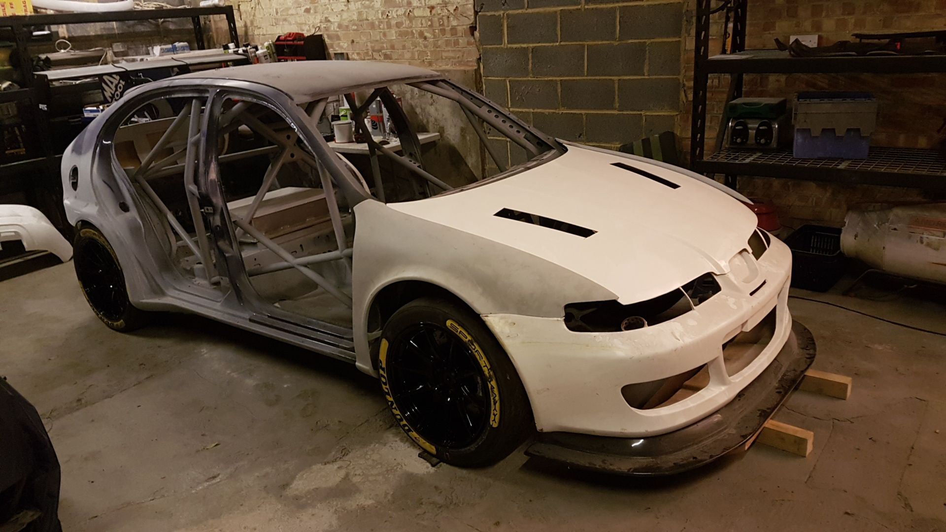

Done few more buts but nothing you really see. Every single thing has been played with or modified to make fit lol long process hahah

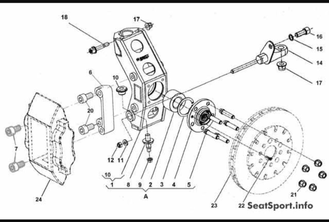

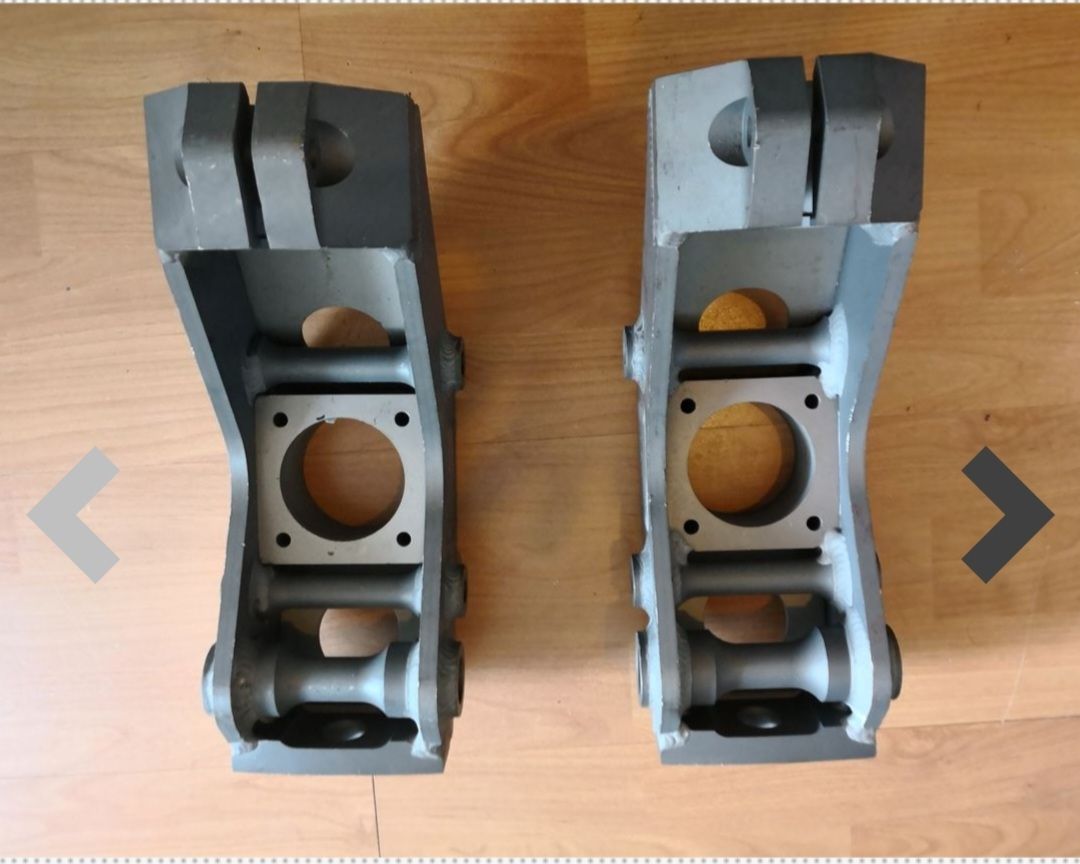

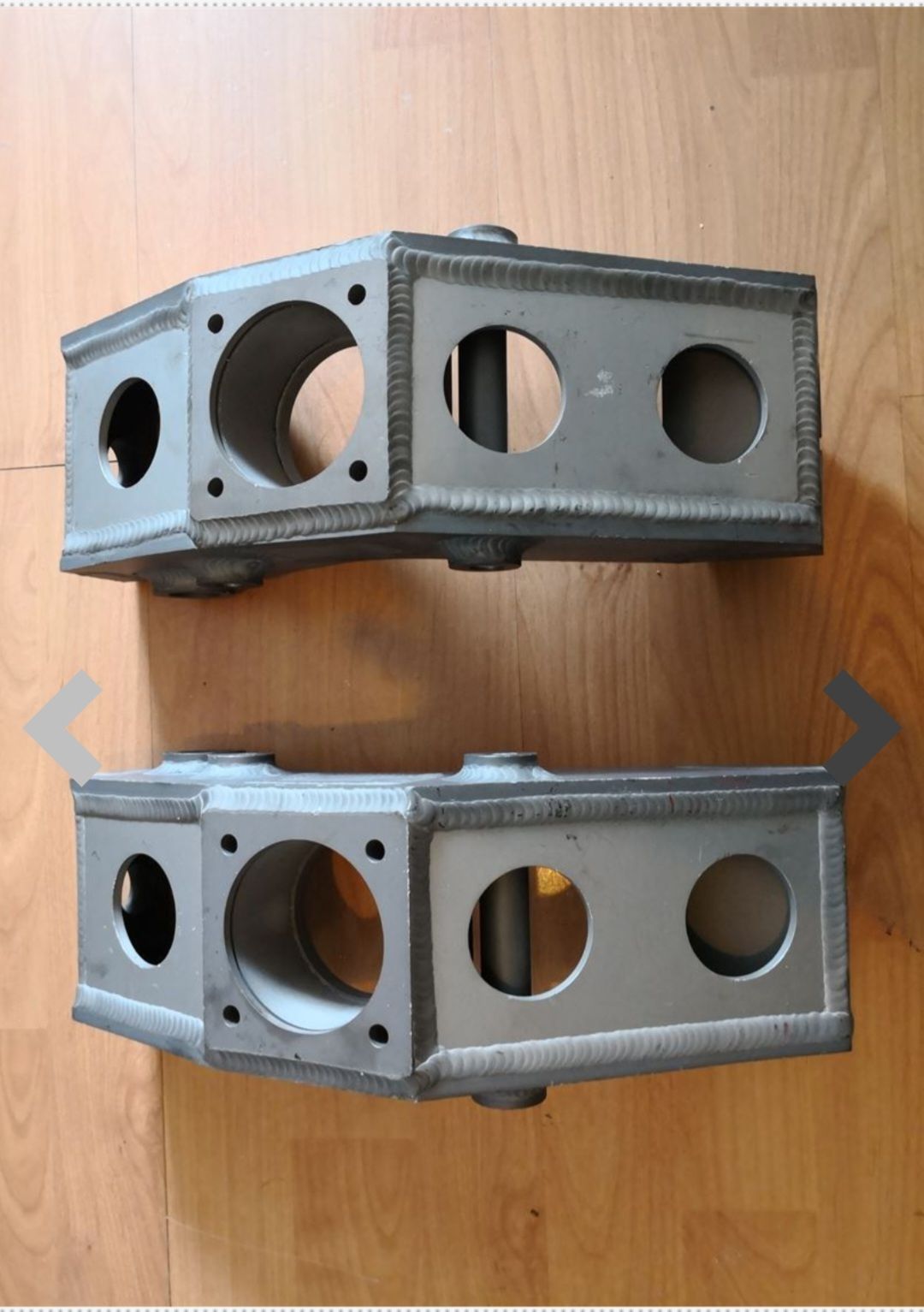

Been doing a little research over the past week and think I've found something out. The supercopa's seem to have ran these front hubs, this boxed style, im assuming it was for strengthening them, maybe the front hubs were a weak point?
