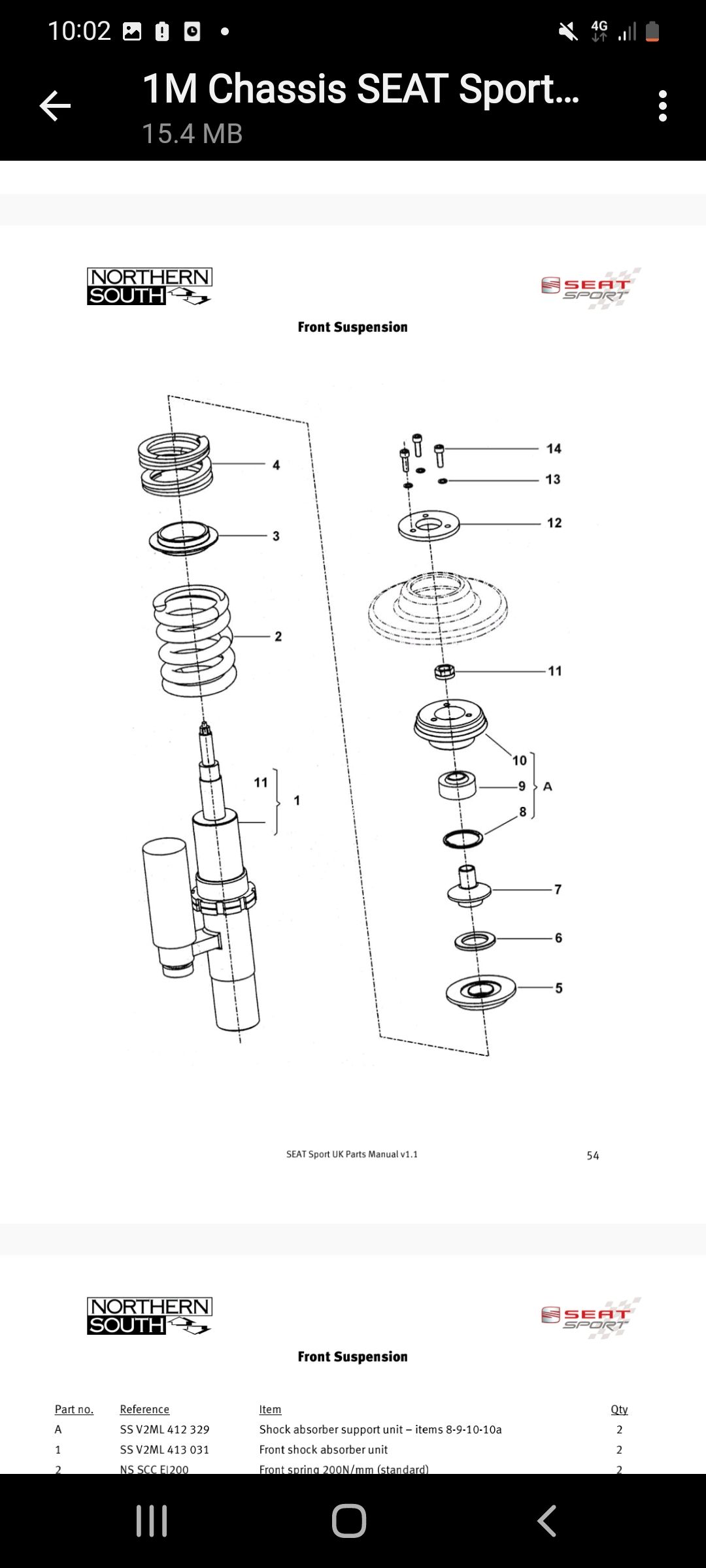

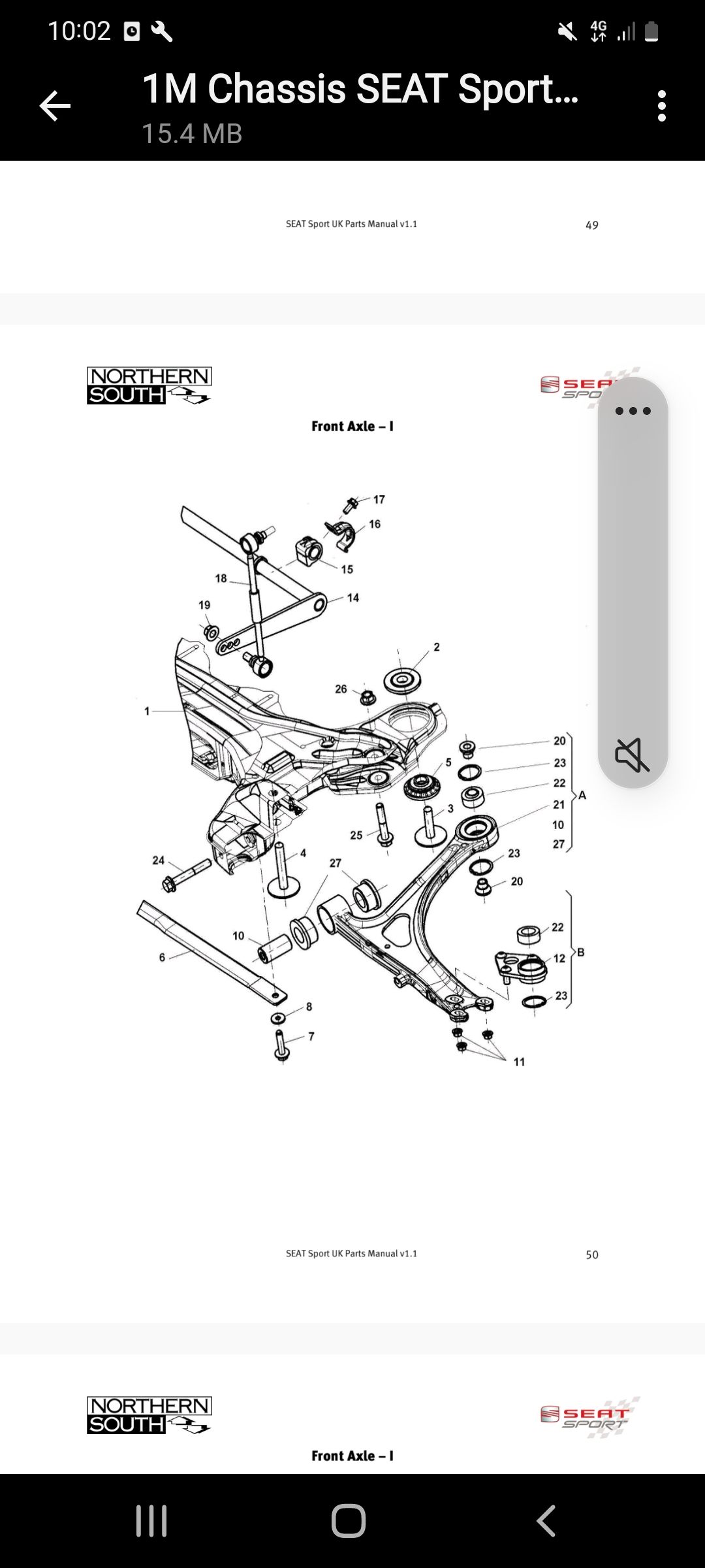

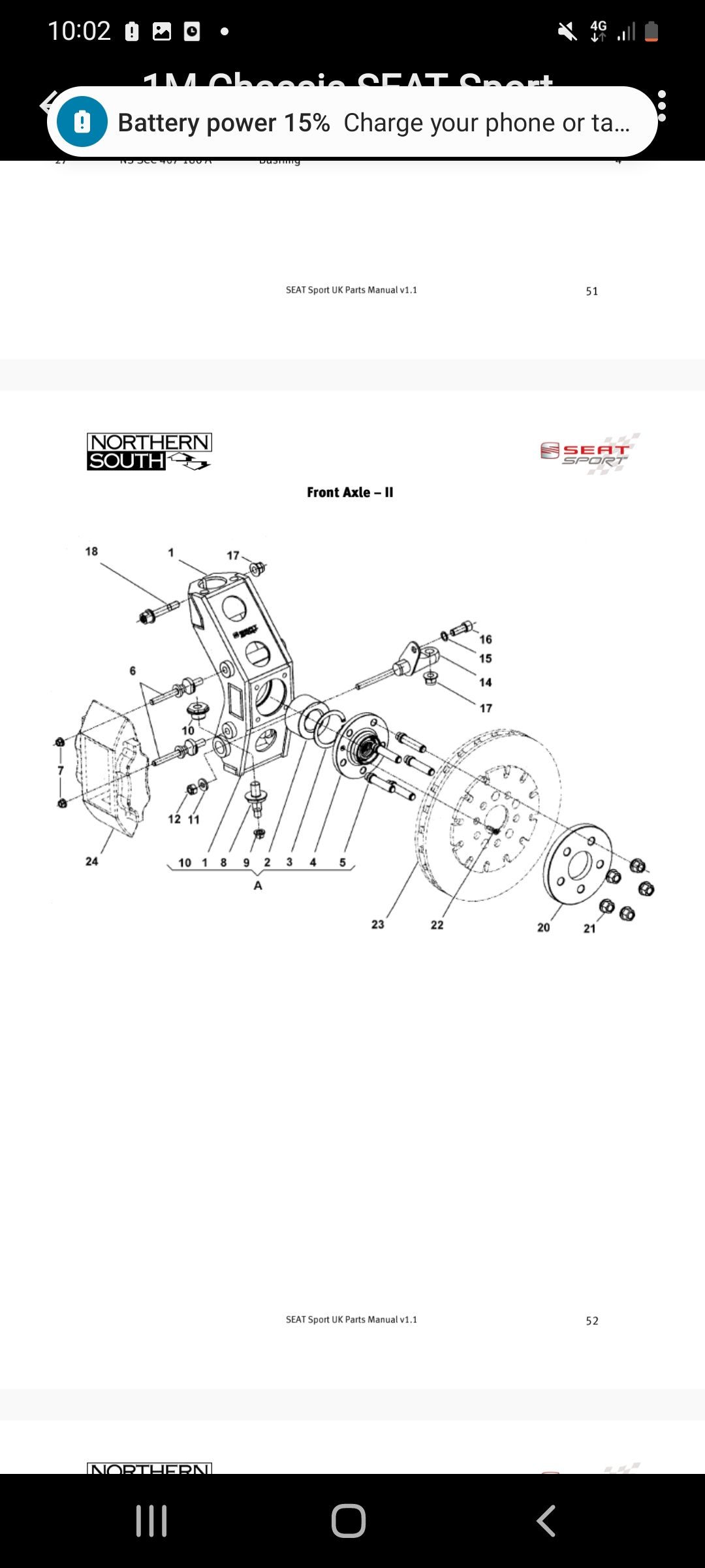

Some screen shots of front suspension set up from the mk1 supercopa
