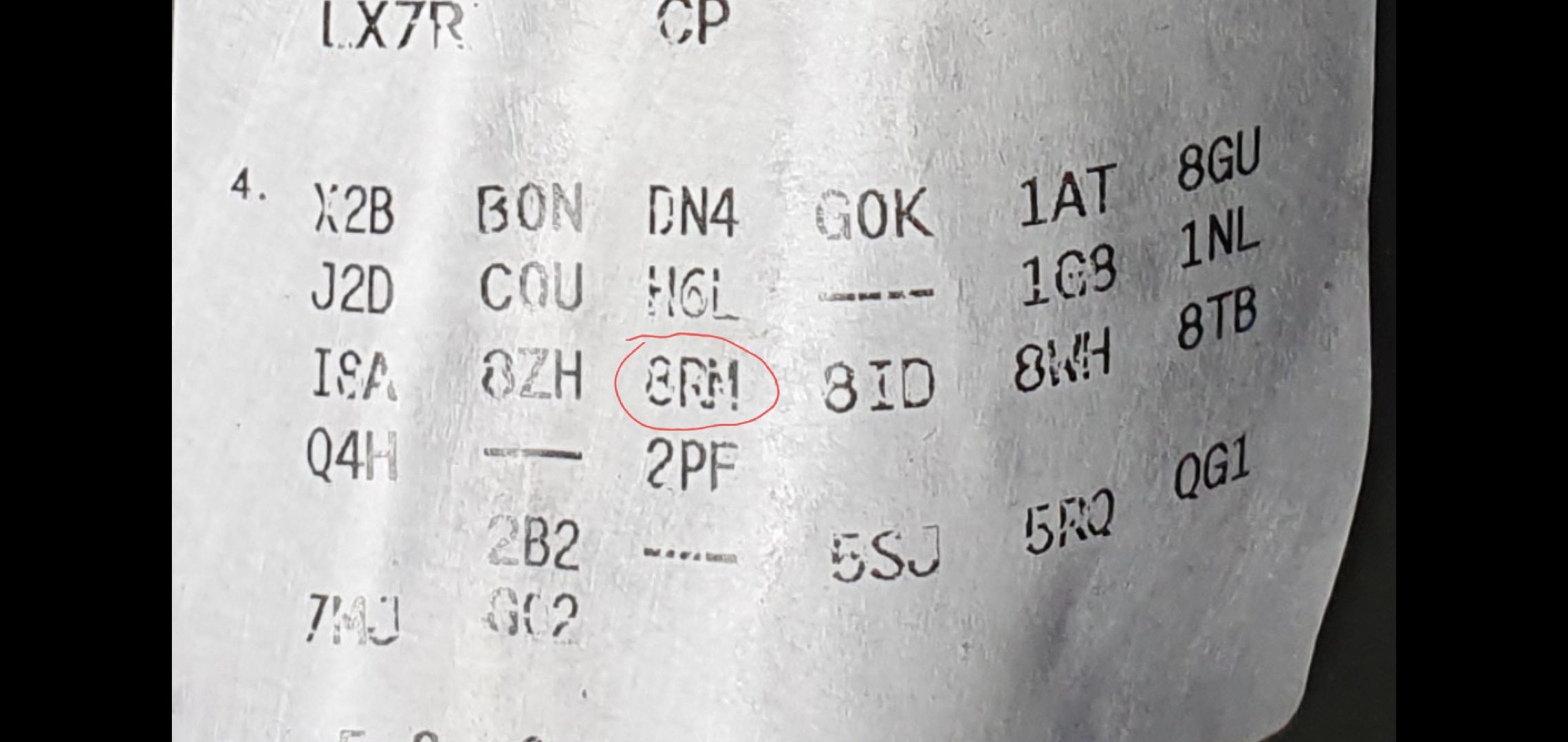

Can't sleep, LOL, no the highlighted codings are for cars with Seat Sound. Look at the PR codes in the front of your owners handbook or in the boot to see if there are any that match the PR codes shown on the first picture that I linked.

??? yes very windy outside last night. I checked for pr numbers in my boot under section 4 and I only have 8RM as shown in pictures. Does this mean it may work for my current cars speaker wiring?

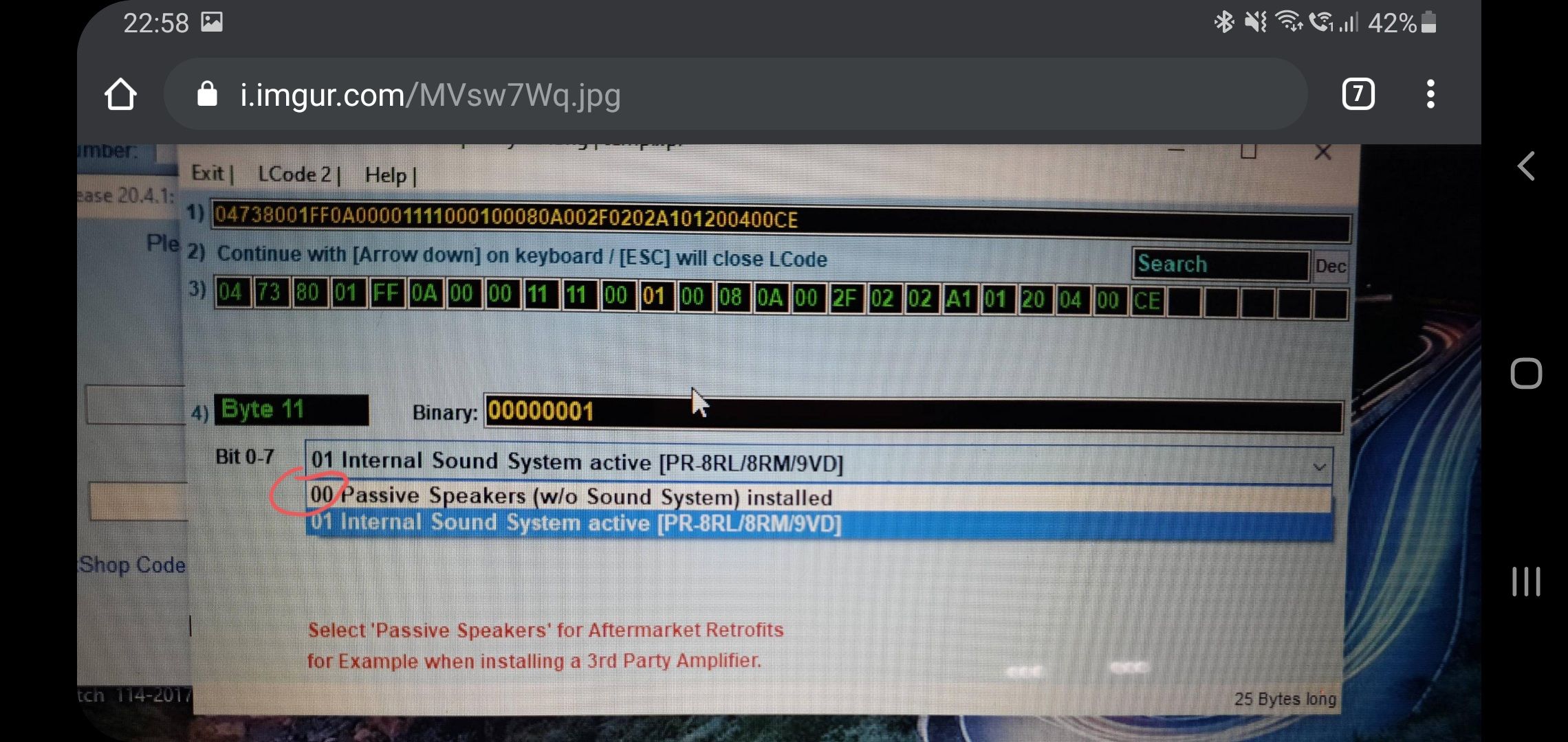

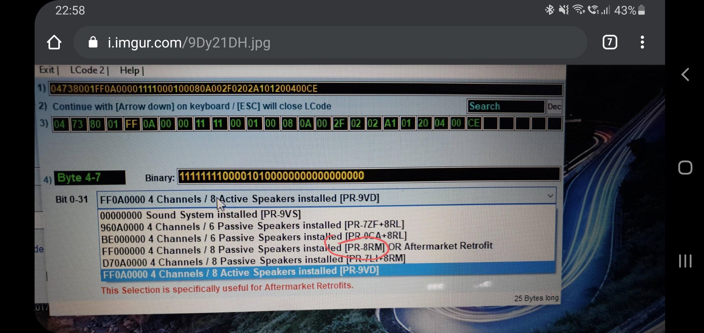

I would suggest selecting the codes just above the highlighted lines in both photos, so PR-7LI+8RM and 00 Passive speakers (w/o Sound system) installed.

Hopefully that will work, but can't be sure until you try it. Yes, do a scan on 5F first then save it, then go to 5F coding, you may need to enter the security access code, then use the long coding helper to select the Byte4-7 coding and Byte 11 coding options that I suggested then exit Long coding helper and select Do It.

Right, for your coding use the line just above the highlighted text in the first photo (byte 4-7), which you may already have done, and for byte 11 (second photo) use the highlighted line. When completed D7 should show in the byte 4-7 box and 01 should show in the byte 11 box.

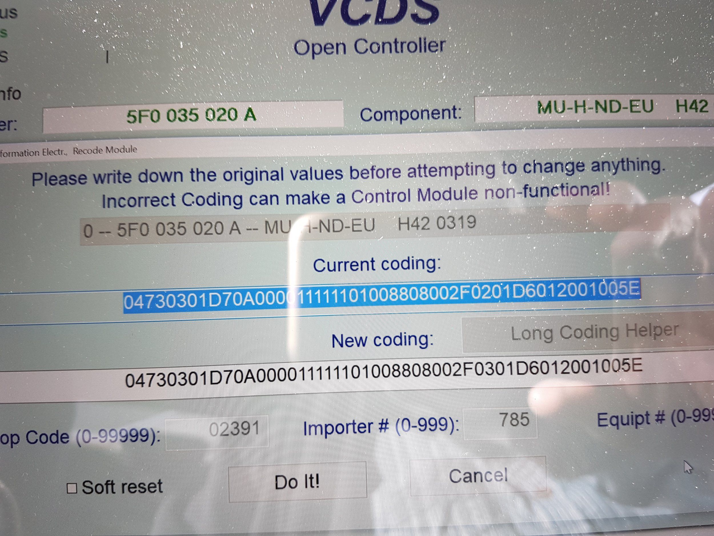

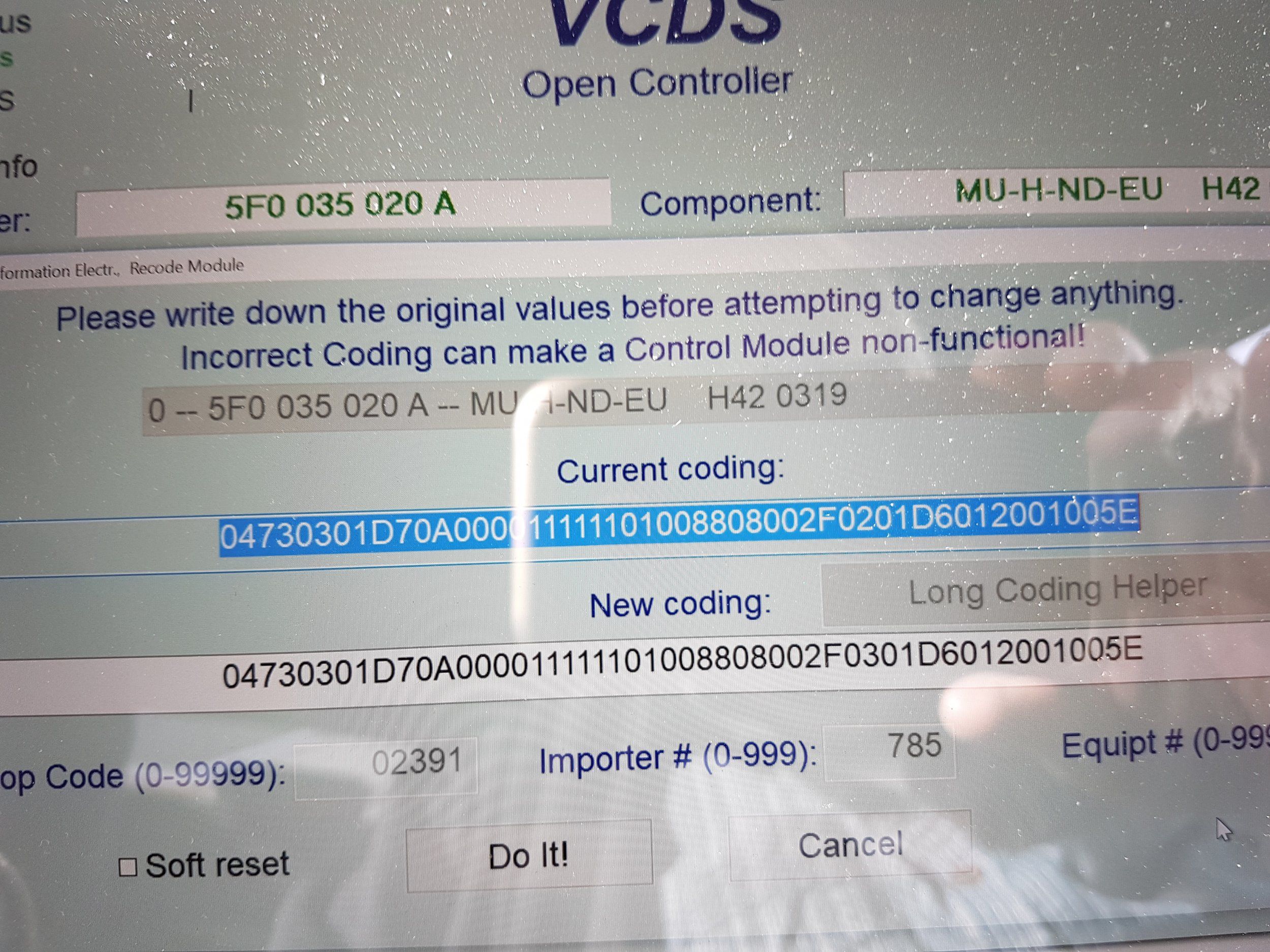

These are the 2 settings I'm on at moment that you mentioned to do in earlier post. so I just need to change 2 second setting to byte 11 with box 01?
I f you find the right one that would great, I've tried looking for terminals crimps but didn't find any as not sure what they are called.

Yes the first setting is correct, change the byte 11 setting to match the highlighted line on the second photo.
This is my coding (do not copy it!!!), so the 9th & 10th digits are byte 4-7 and the 23rd & 24th digits are byte 11.
If you look at the text file, I have numbered the byte positions up to byte 11.

I've set it to that now and pillar tweeters sound better with Bluetooth and android auto but the radio sounds awful. I'm now getting humming on my alpine subwoofer with build in amp when car is running. They are tapped off left and right front speakers
