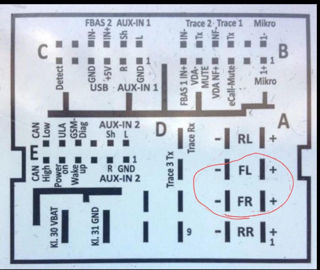

Thanks again for the pin identification... I managed to install one on my underseat subs during the week and all working great.. No issues, Inc unwanted noise, coming from sub...
What I will say now is I did have to hunt for the front door speaker wires to tap into for my speaker (high) level input...
This pic shows the 8 speaker pins....
Which is good but the middle 4 pins showing the front speakers are for the pillar tweeters...
The pins for the door speakers are these:
I found them using my phone with a cable out of headphone jack and just prodded and poked until sound came out of door speakers....

If you have the 8 speaker system (8RM) those pins are for the front pillar tweeters, you need to tap into the wires on pins 9+ (which should be brown/green) and pin 13-- (should be brown/blue) they are for drivers door bass/mid speaker, and pins 10+ (should be brown/black) and pin 14-- (should be brown/red) they are for passenger door bass/mid speaker. (speaker locations are assuming R/H/D)

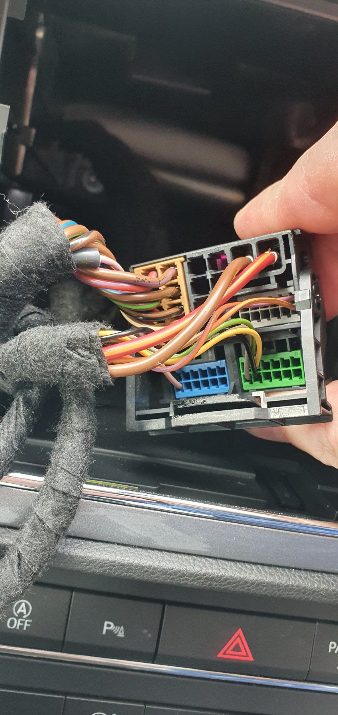

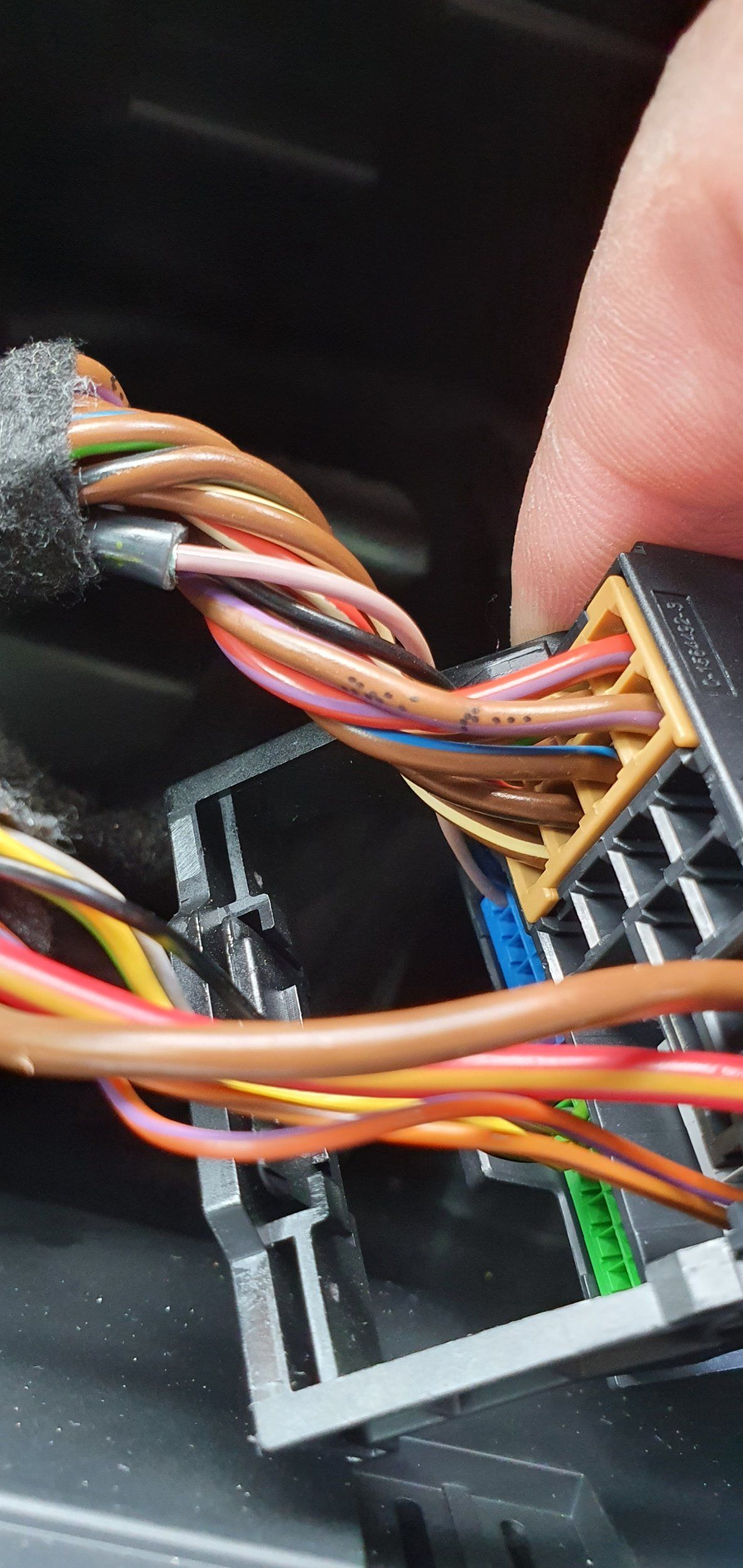

Clearly my old unit must have speakers and tweeters connected on the 8 wires on brown connector.

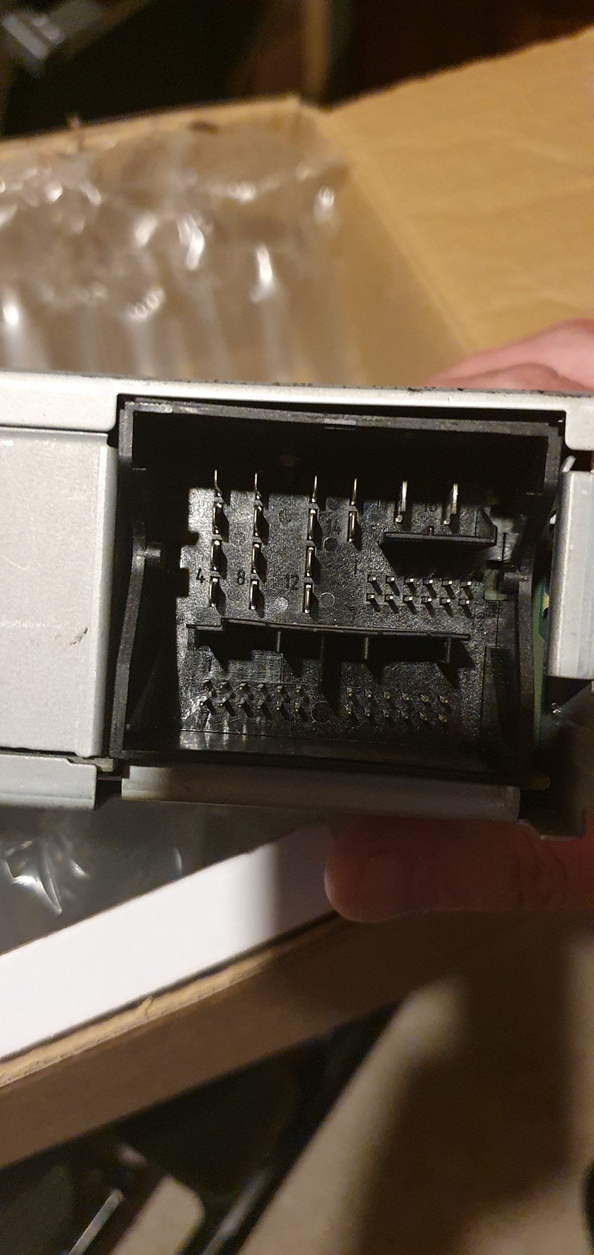

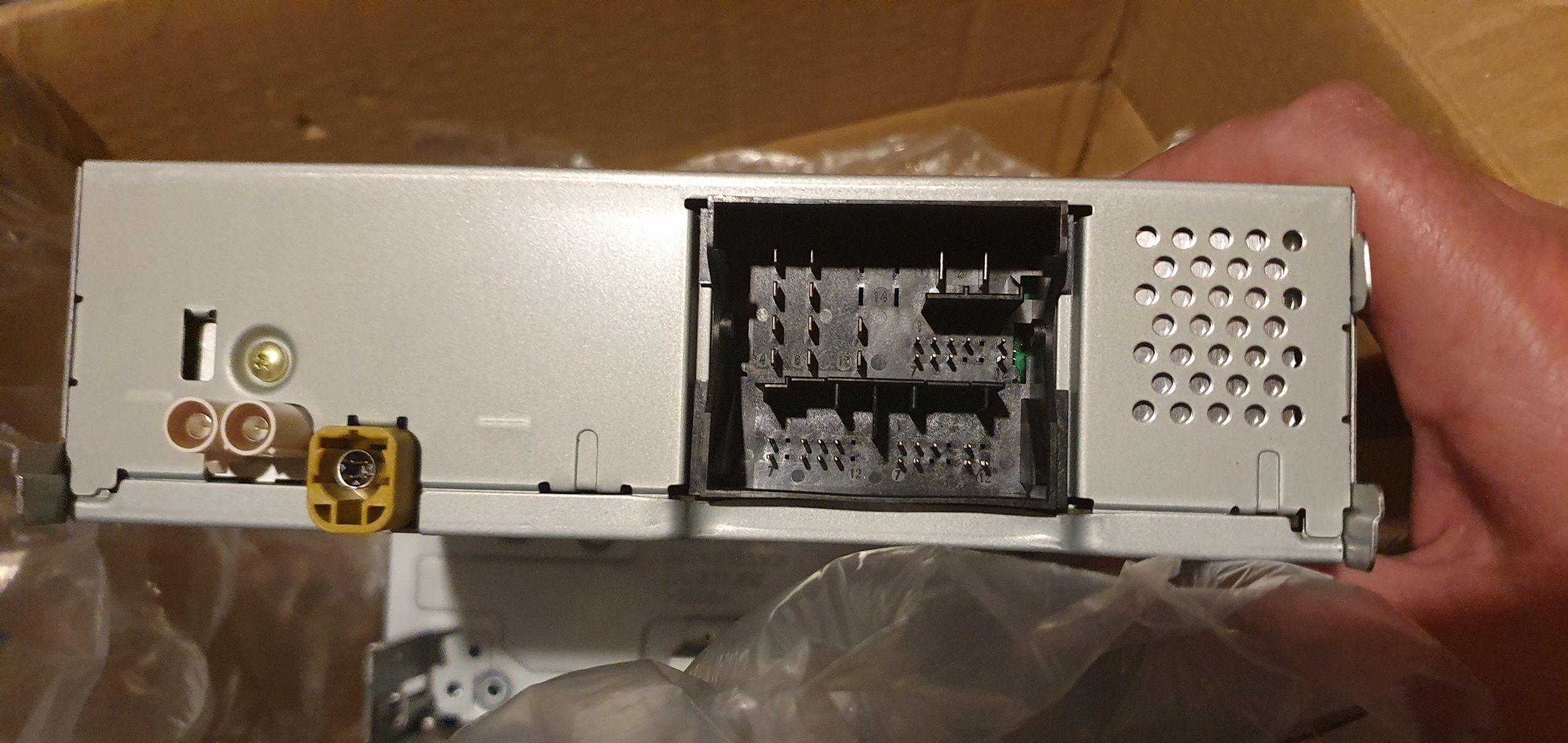

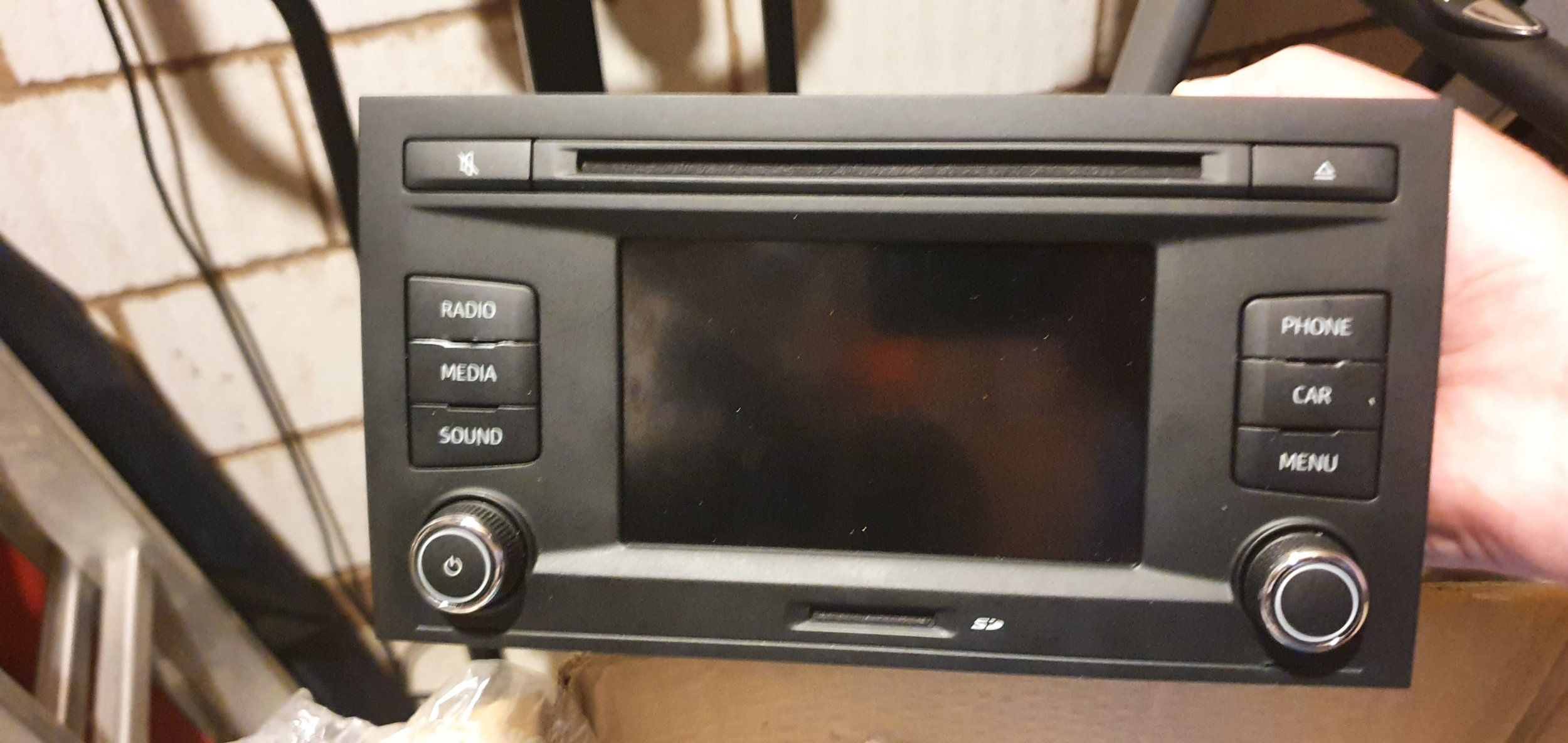

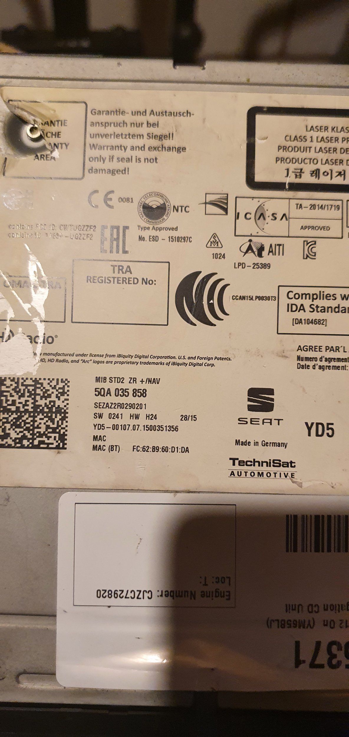

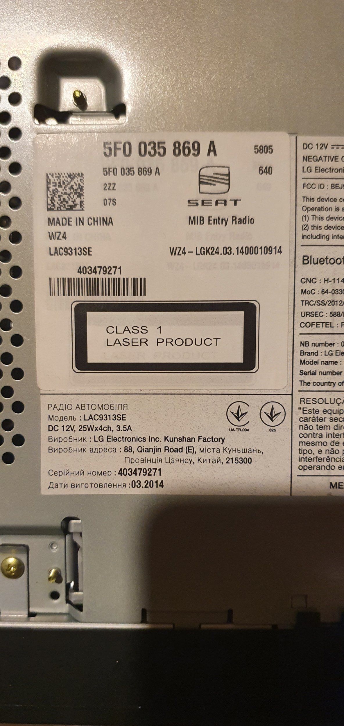

I upgraded from a 5f0035869a MIB 5 inch cd unit to 5QA035858 Mib2 STD Nav. (Retrofit)
From what I understand now my old unit had 4 channels and only the 8 wires on brown connector which looks like it connects to all 4 speakers and tweeters. pins 9,10,13,14 are missing on old unit hence 4 channels.
On the 5QA035858 Mib2 unit I see it has the pins 9,10,13,14. So this might explain why my front speakers don't have much bass on this unit as those 4 pins in middle are for front tweeters on Mib2 unit and front speakers/tweeters on my old unit are using same 4 wires.
So am I right in thinking if I move the 4 middle wires from brown connector to pins 9,10,13,14 this may solve my bass problems front speakers and sub may work properly? As I don't have the 4 wires (9,10,13,14) on my quadlock clearly my speaker wiring set up is different because of my original unit.
First photo is 5QA035858 unit and second photo is my original 5F0035869A unit showing pins 9,10,13,14 missing.

Oh OK, I too have the m1b (5f0) unit but mines slightly different....I have 8 speakers... Hence 8 pins...
I have 5qA035858 Mib2 unit now but my speakers/tweeters are on the 8pins. On this 5QA unit 4 middle pins on brown connector are front tweeter connection.
where my old unit 5F0 the same 4 middle pins shared front speakers/tweeters so this explains why my front speakers don't have much bass and sub not putting out hardly anything.
So from what I understand on 5QA mib2 unit the front speaker connections are pins 9,10,13,14 on the unit.

The car is 5 door seat leon tdi fr 2014. It has tweeters in the front pillars and separate tweeters in rear doors and hear sound from them.
What I believe is my old 5f0035869a only had 8 pins 1-8 and no actual pins on 9,10,13,14. So looks like 4 speakers and 4 tweeters all on the 8 wires on brown connector.
With this new 5qa035858 unit it has 9,10,13,14 pins which I think is front speakers. As you've said the 4 middle pins on brown connector are tweeters so with my wiring the front speakers and pillar tweeters are those 4 wires. Do you think if I was to move the 4 middle wire to pins 9,10,13,14 on quadlock it would resolve the issue? There's hardly much bass on front speakers and think it's because the middle pins are for tweeters only on this unit

The green/brown should go to pin 9+, the blue/brown to 13-- , the red/brown to 10+ and the black/brown to 14--, those positions should be correct for your car.
On cars fitted as standard with MIB2 (8RM) units with all the pins used the colours are swapped over on pins 10 and 14 but you should not do this.
