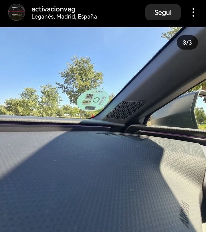

Hello everyone, I am the owner of a Leon 2021 with software version 1940. On Instagram I discovered this page which managed to put the purple LED on the dashboard with Obd. I wrote to him and it is possible to do it but he would need a car, I come from Italy, let's see if I can get him to tell me how and if so I will let you know.View attachment 39846
hi, I contacted the page but unfortunately it doesn't want to tell me how it did it.. have you been luckier?
