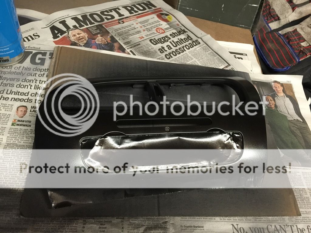

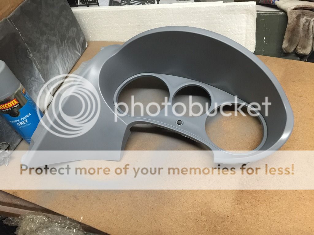

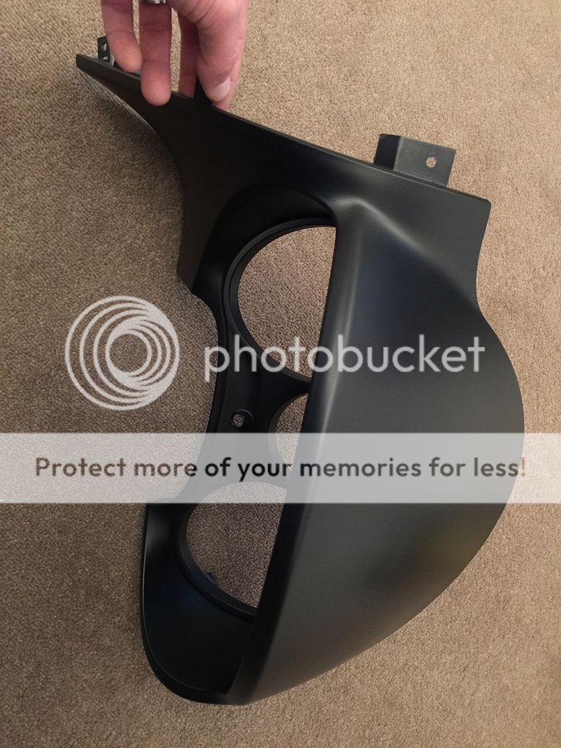

Then the tinkering begun lol and was time to start spraying everything satin black.
Purchased this speedo fascia so I can keep the original as it is. Got some more nanodrive also as its done 5k since last change so will do it soon.

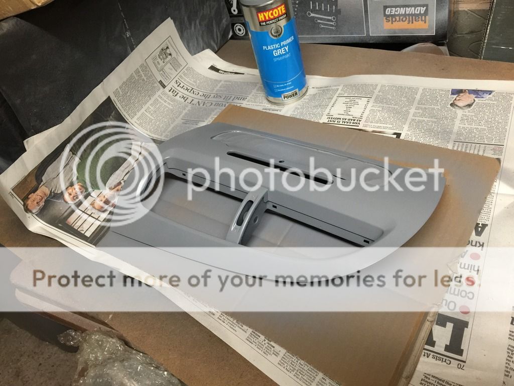

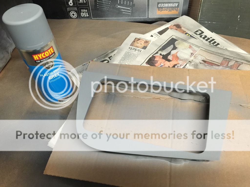

After the plastic primer was done:
Then for some colour:
Happy with how it turned out it looks spot on

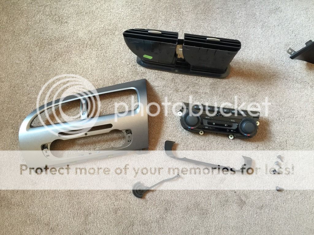

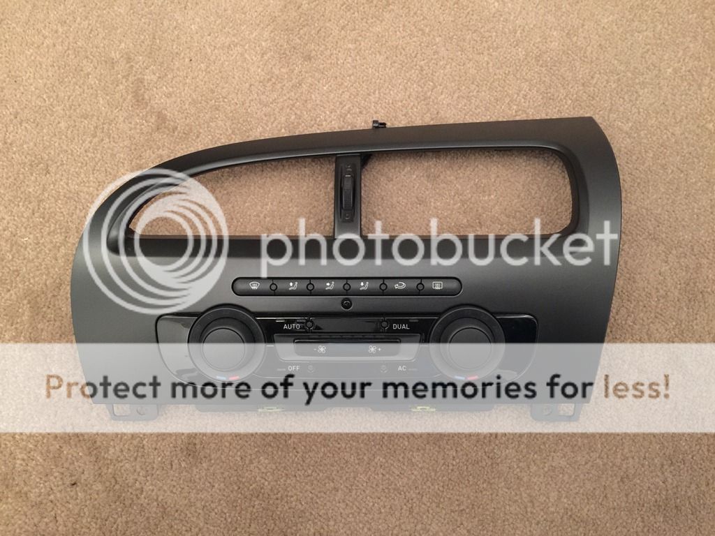

Then it was time to strip the climate control unit and fascia:
This was relatively straightforward but just fiddly and time consuming as I didn't want to break anything as that would have been a nightmare.
After primer:
Then some colour:

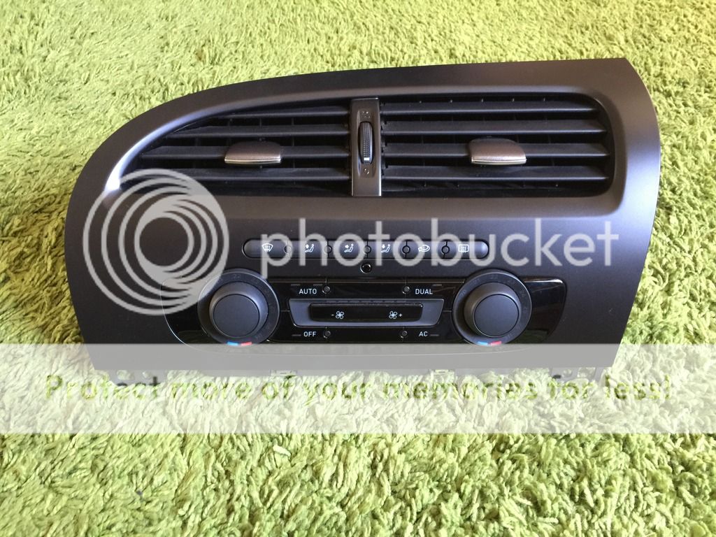

Then once dry it was time to rebuild it:
Again I'm chuffed with the result it was worth the time and effort. Putting it all back together was a pain in the arse if I'm honest.But had to take my time as again I didn't want to break anything.
Then it was a case of putting it all in]
IMO it looks so much better than before I love it :D

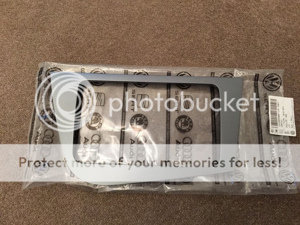

Another purchase was this brand new genuine double din fascia
Haven't finished it yet as it only arrived this evening.But once finished I will upload more pics.

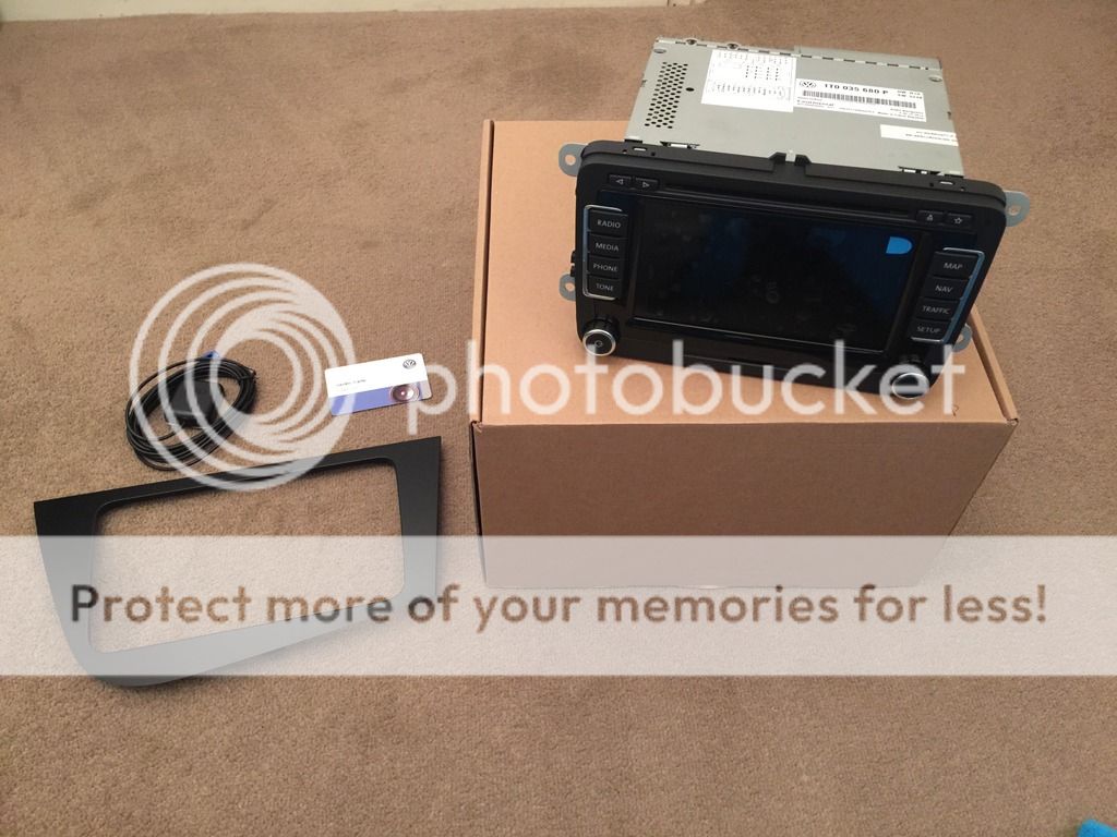

What am I putting in you ask?

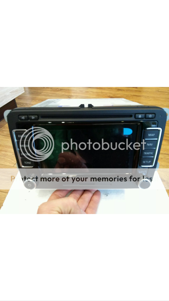

Well I've bagged a blooming bargain in the form of this bad boy :funk:
It's a brand new genuine Rns-510 2015 LED model with the latest maps and is something I've wanted for a long time and couldn't let the opportunity pass.
Once the unit arrives I'll get it straight in and update my thread.

Yes looks so much better than before I used Hycote plastic primer and satin black.Although I did three good coats of the satin black for all three fascia one can was just enough.

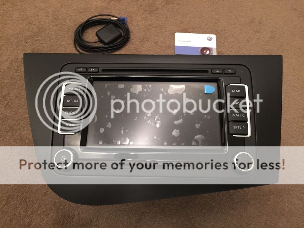

Finished off the double din fascia today.
It's come out great and matches the other panels perfectly.

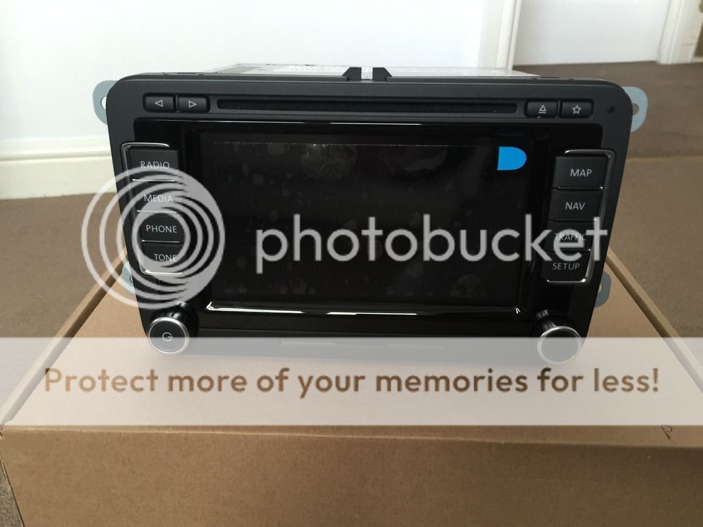

My Rns-510 arrived today :p
Very happy with it and can't wait to get it in, manufacturing date was December 2015 and has all the latest software and maps

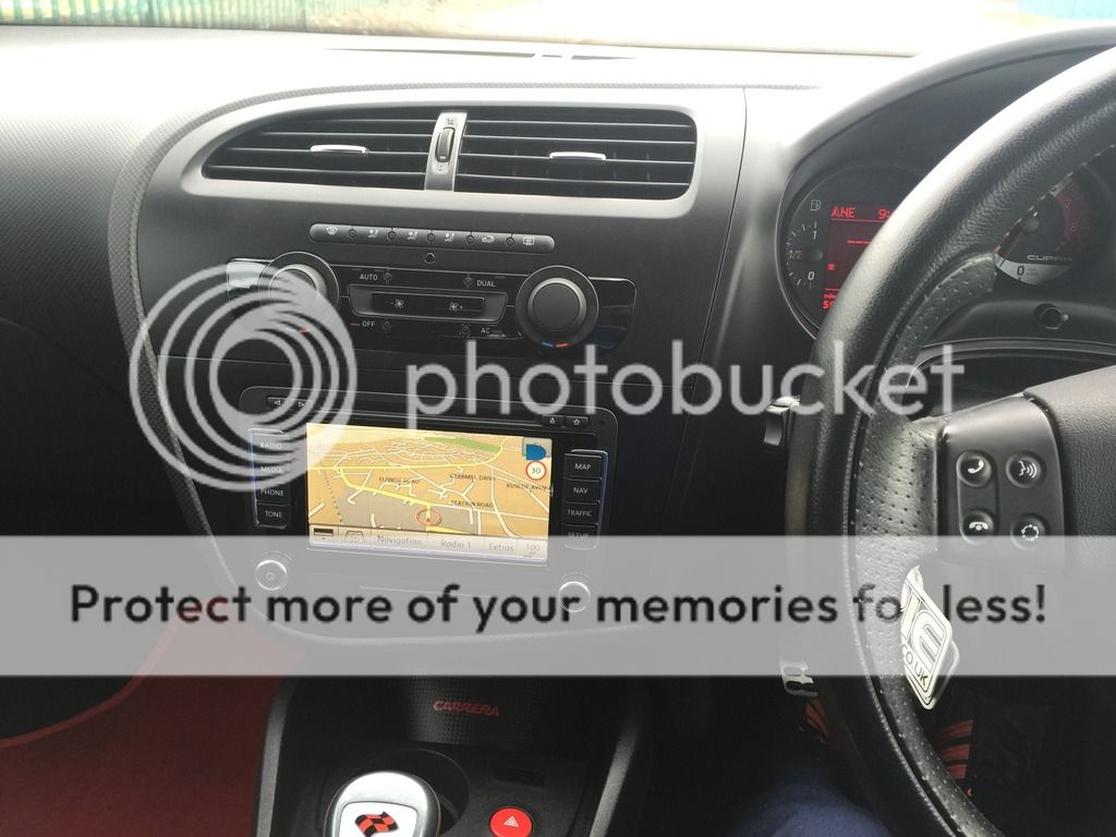

Fitted the head unit this morning :)
Very happy with it and has finished the look I set out for. Everything works perfectly as do all the steering wheel controls such as phone,volume ,skip etc etc
The sat nav is brilliant,I've fitted the gps antenna just above the head unit and picks up the satellites with ease so that's saved me the ball ache of routing it onto the windscreen.
Another bonus is on the mfd it shows you the heading in the top right corner
Then when you set it to a destination it does this on the mfd to give you another area to view what the next turn is and what road it is.
I've changed the boot up logo to a Seat one but haven't taken a pic yet but will update once I've done it.
Sound quality is spot on both for music and DVDs so overall would highly recommend this for anyone looking to upgrade.

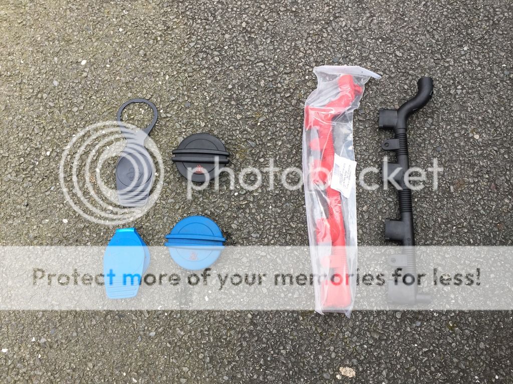

Purchased these recently and fitted today. Have gone from the blue washer and coolant caps to black and changed the coilpack harness from black to red.
Will add a fitted pic tomorrow.
