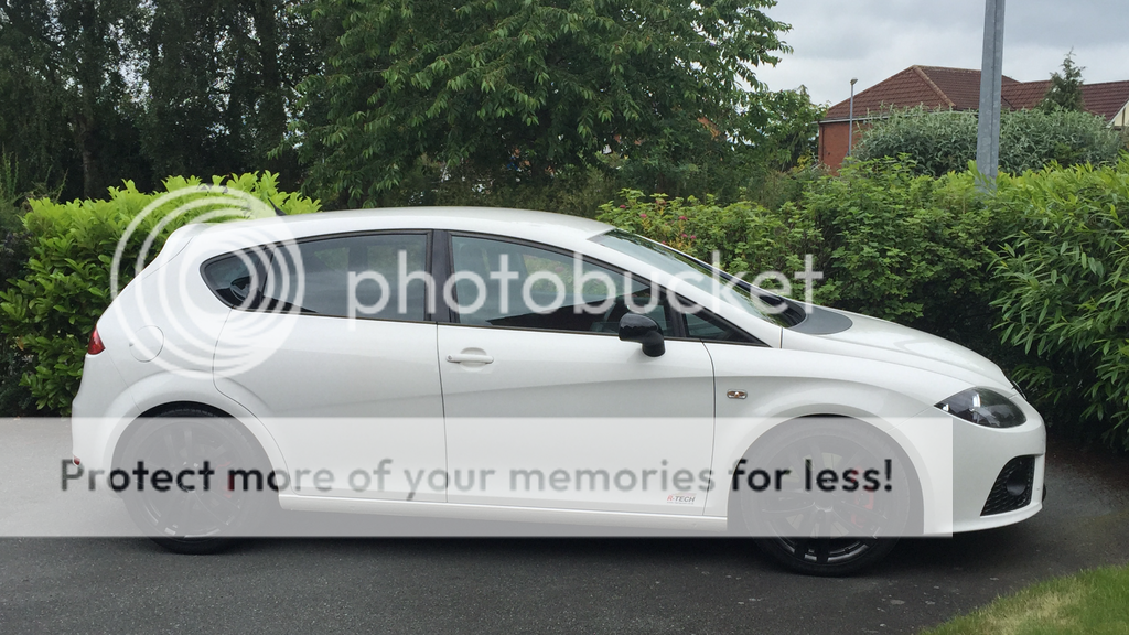

Looking good as always Craig, though I would go lower on the back ;)
Gloss black pillars?
Cheers Dan :)
Yes I thought the same the rear needs to be a little lower.

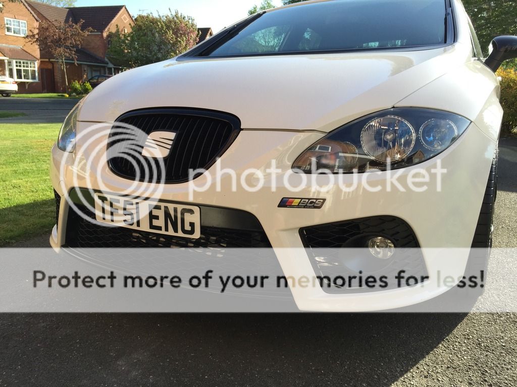

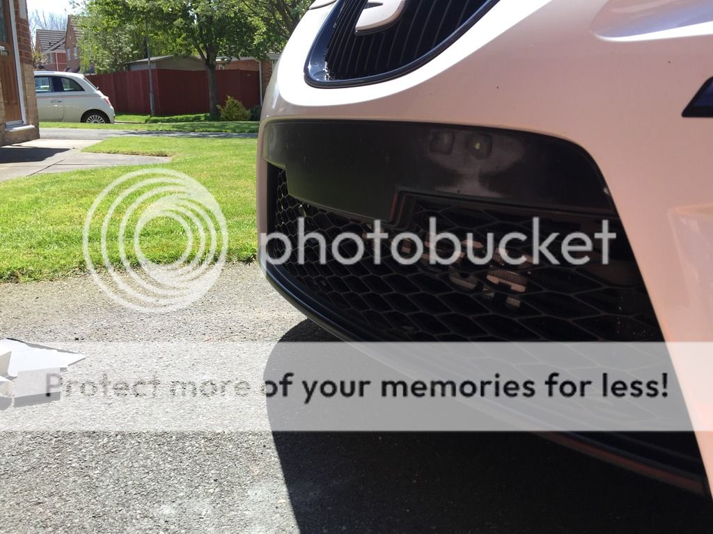

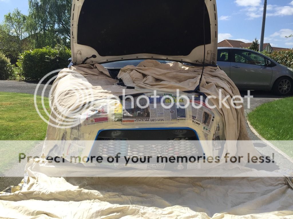

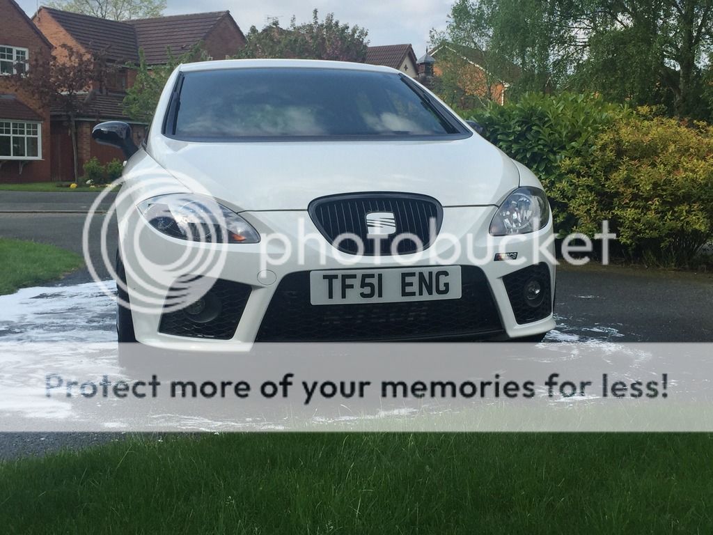

First off i decided to freshen up the front grills and fit my smaller plate.
Before:

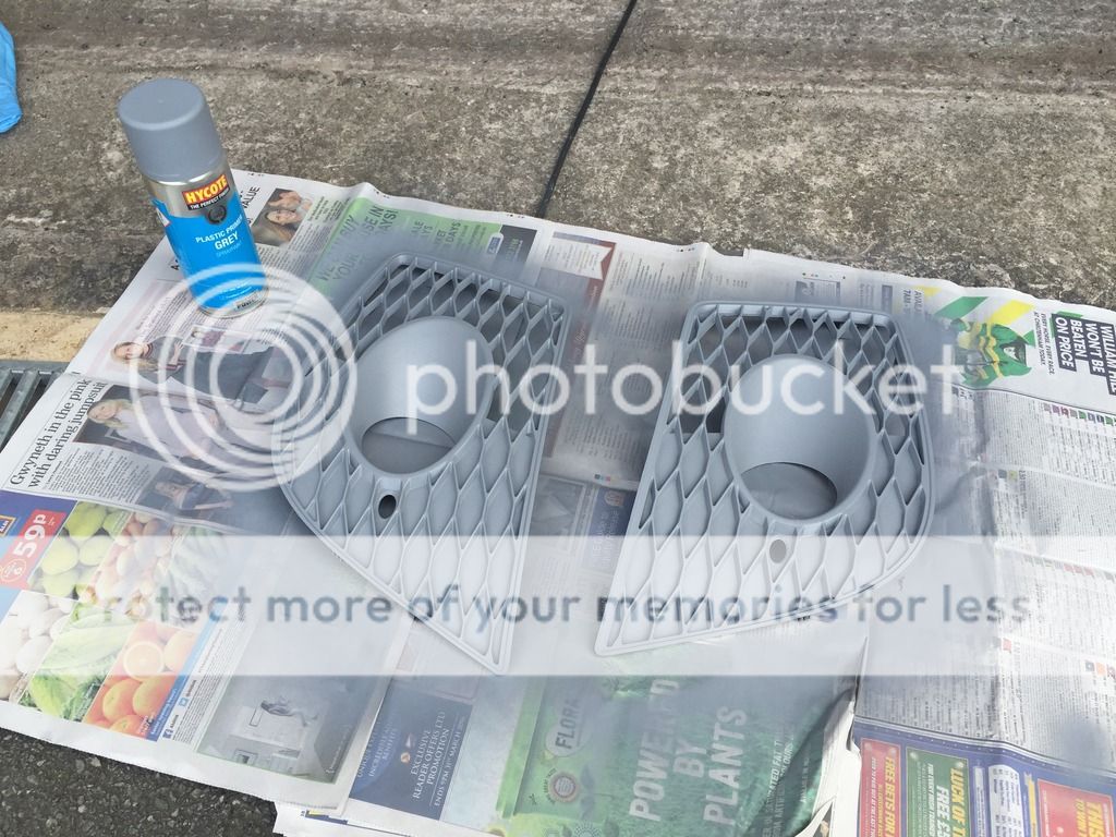

Removed the fog light grills and masked up the main grill
Before any paint I had to fill the original number plate holes then flat them back.This you can see in the above and below pic.
Then I used some plastic primer to do the fog grills
Then gave them two coats of gloss black spray paint
Didn't take any pics doing the main grill but used the same process as before.
Here is the finished job : )
IMO it looks much better and another bonus of the smaller front plate is more flow to the wellycooler :happy:

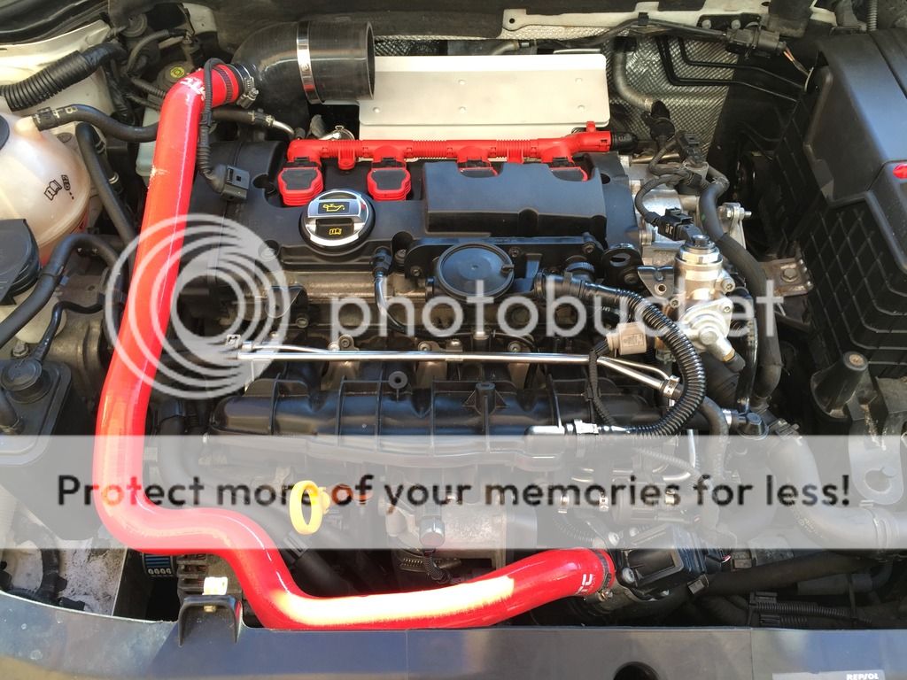

Next little mod was to fit the R-Tech twin plate heat shield
This works really well and has made a huge difference on the heat that the intake absorbs.

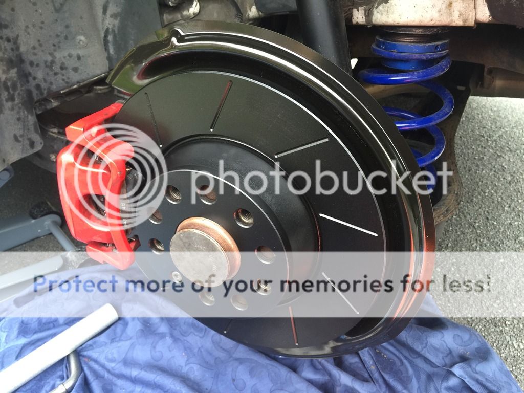

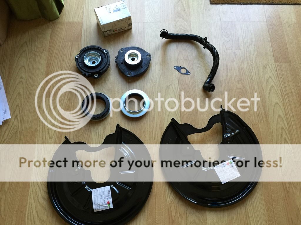

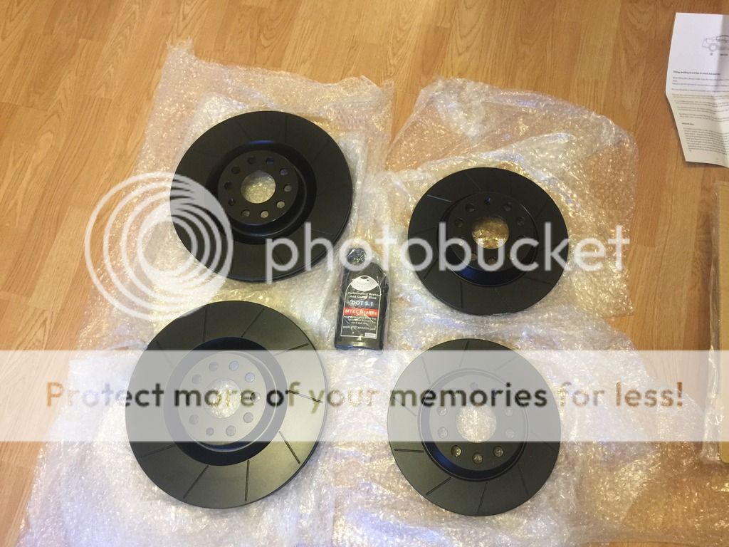

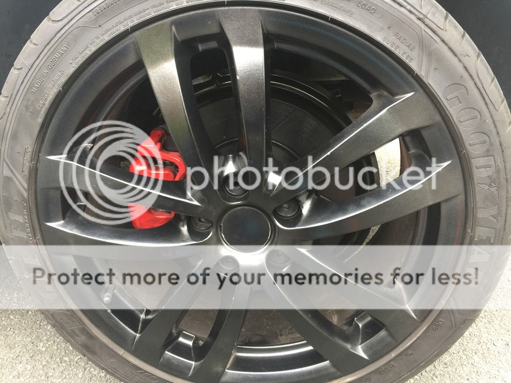

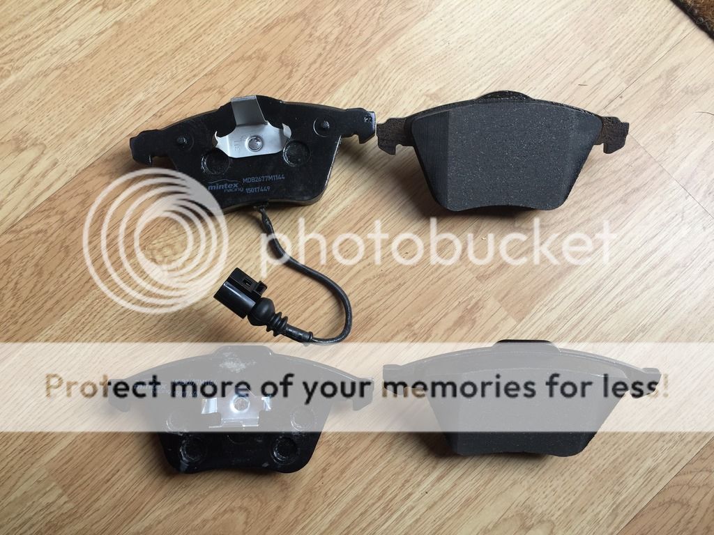

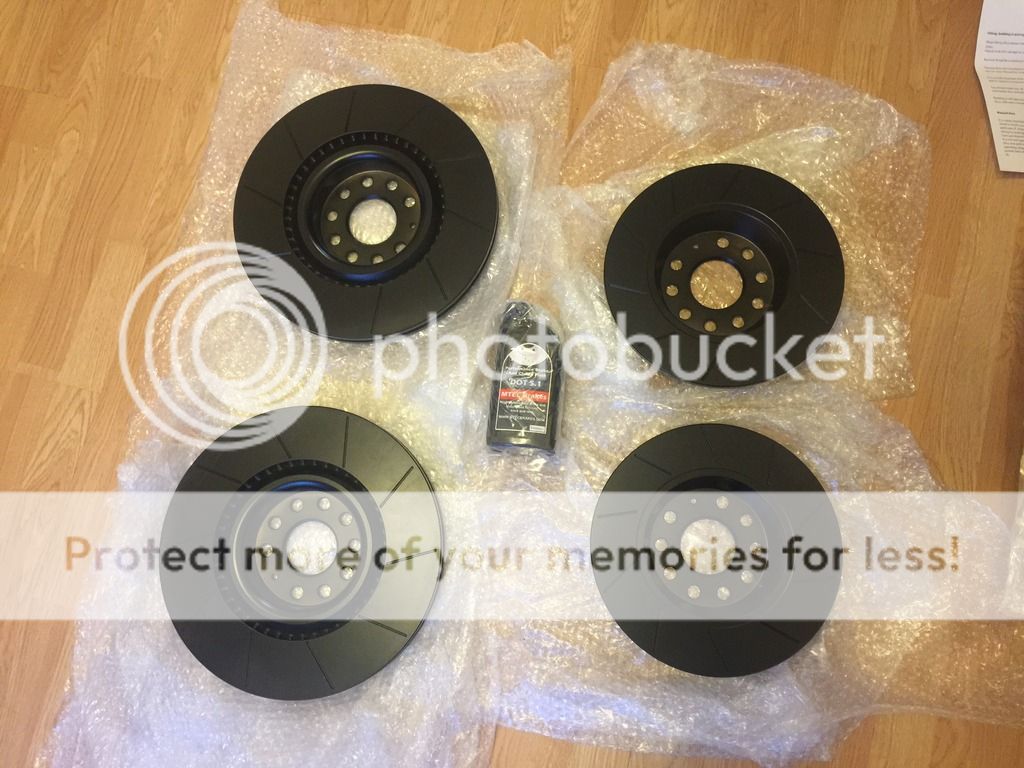

My next job was to replace all four discs and pads.Also fitted new rear dust shields.You can see in the pic I've also got new top mounts and bearings! These got fitted when I did the coilovers.
These are the discs I've fitted,they are M-tec grooved discs black edition.Very good quality and for the money they are bang on
For the rears I've fitted standard pads as that's ideal.For the fronts I've gone for Mintex M1144's
These are excellent pads and I'm very happy with the stopping power they offer and work really well with the new discs.

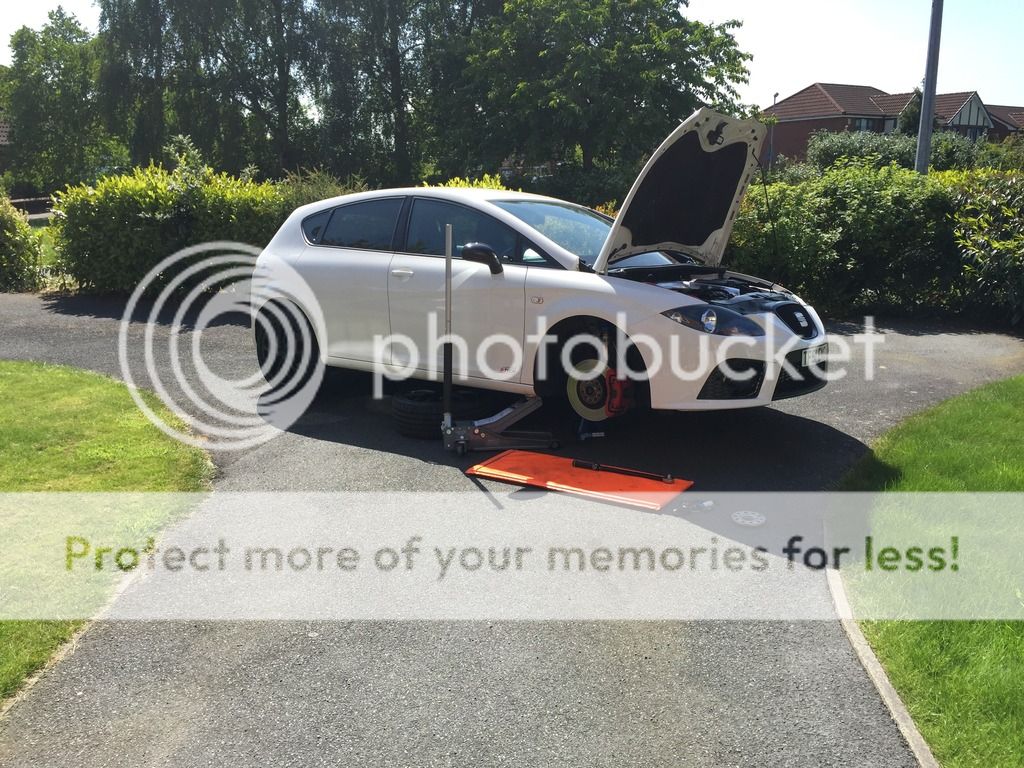

So some pics of fitting them all : )
The fronts were an easy job to do and didn't take long at all.Rears however were a nightmare due to poor access.

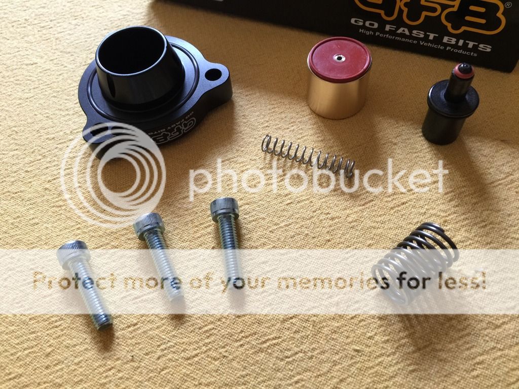

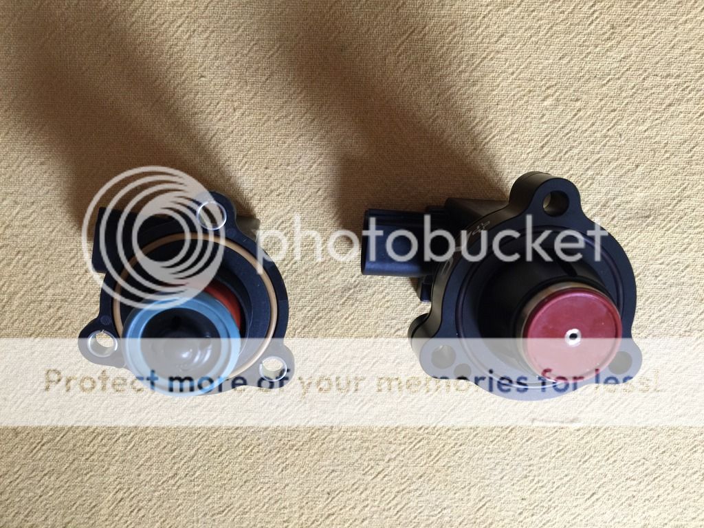

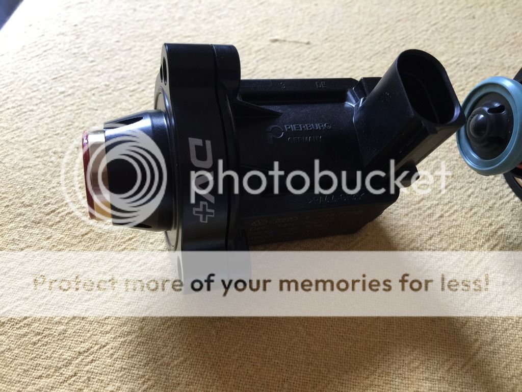

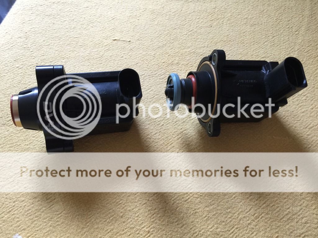

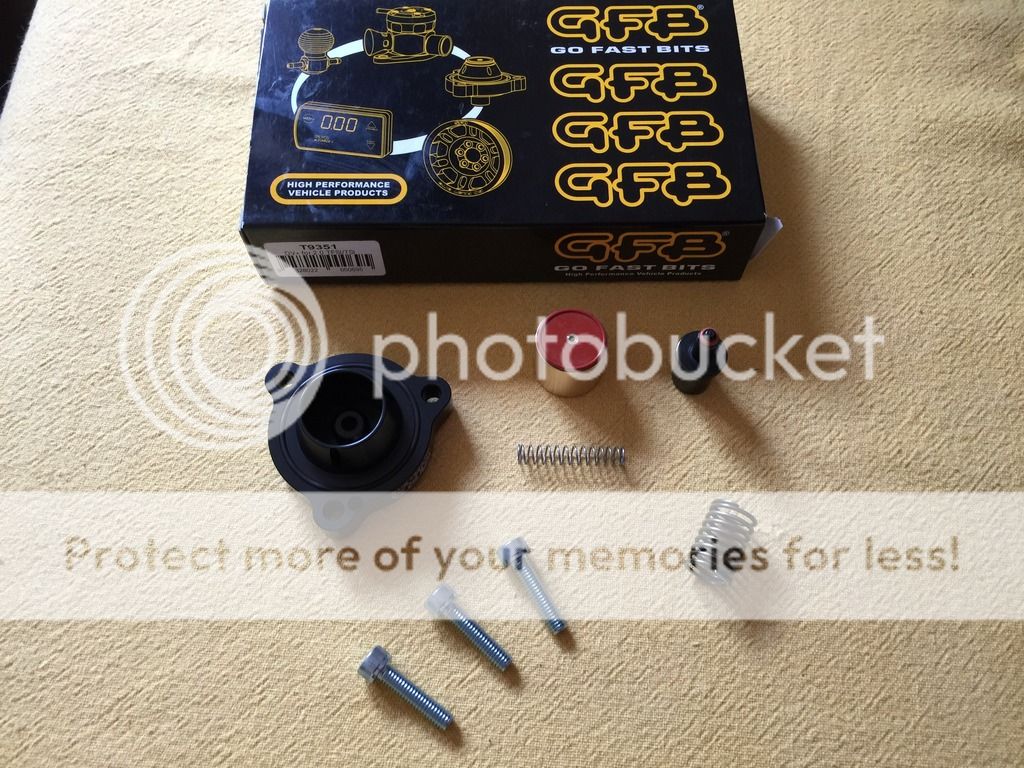

Next up I've purchased A GFB DV+
Very easy job to swap the relative bits over from the Rev G
Some comparison pics side by side with a spare Rev G I've got.
And a close up of the DV+
First impressions are very good the throttle response is instant in all conditions so happy I've done it.As time goes by I'll see what it's really like.

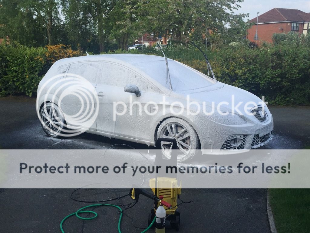

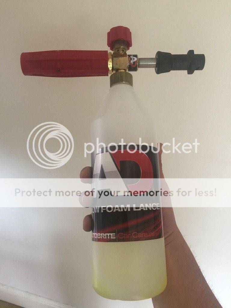

A little purchase I've done is a autobrite snow foam lance as the one I had(eBay special) wasn't up to the job if I'm honest.
The difference this one make is brilliant and gives much better results compared to the other one
For the mix I use no more than one inch off solution in the bottle and top up with water.
This was after over five mins of dwelling and it's still clearly visible
You can see the discs have bedded in nicely now too : )

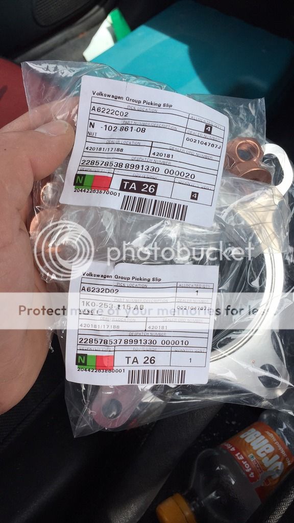

Purchased a new set of turbo nuts and a gasket as the ones i had were the originals so for the small cost I got the new ones
In the next pic you can see the new turbo gasket matched up with the downpipe and it's a perfect transition so will flow as good as it possible once fitted

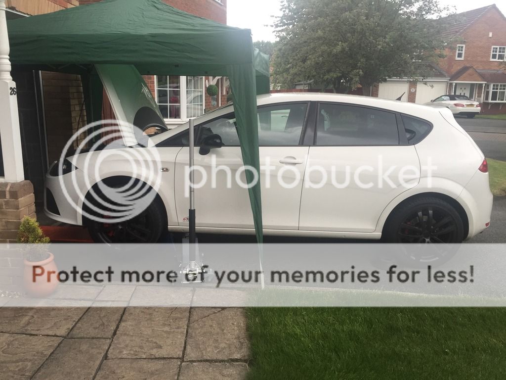

Fitted it last weekend. Lol it hammered it down with rain but as I'm not one to be beaten my solution is obvious.
These pics were taken just before the heavens opened : )
Stupidly I didn't take any decent pics of it fitted but it's all done now.Straight away she seems to be much better mid range and the sound is apocalyptic lmao.

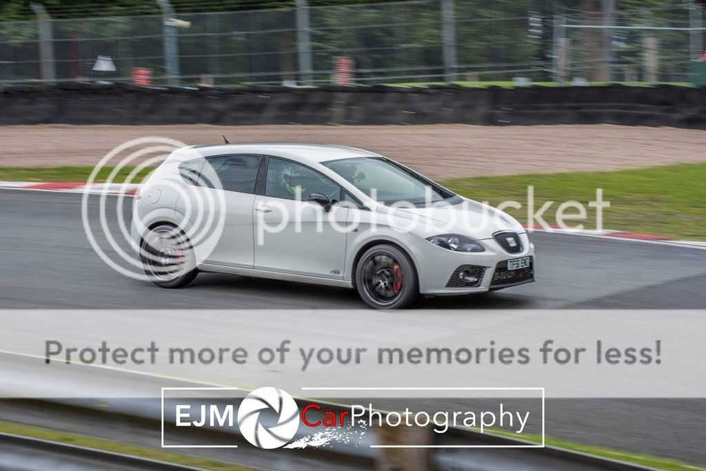

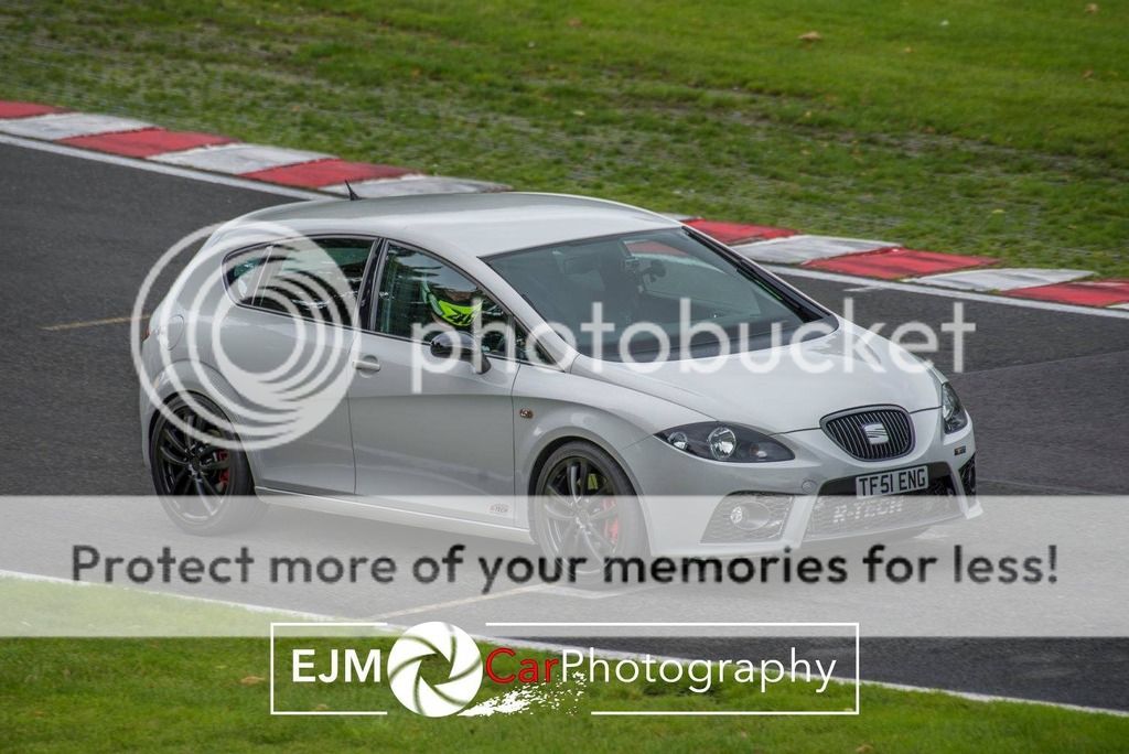

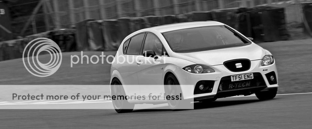

Last weekend was two days of petrol head fun.She attended two shows first on Saturday at tunerfest North Oulton Park and the Sunday at Vagtuner live Donnington Park.
More importantly she's popped her track time cherry.
Couple of pics from Oulton.
Had a great time it was epic and she was absolutely faultless.
Here are a couple of vids from track side
But the best video is from onboard :p
https://www.youtube.com/watch?v=uVoStcny6Vs
Considering it's the first time on track with her I've not done bad.More important though is I had great fun,didn't crash and or hurt myself or anyone else.
