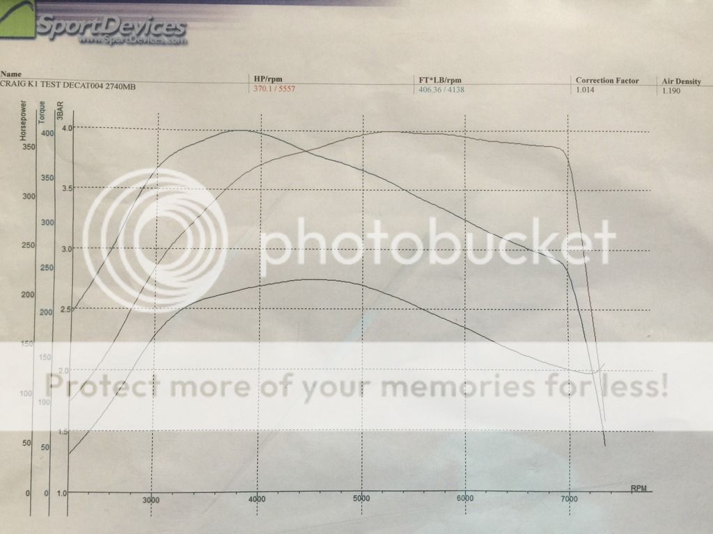

Here are the two graphs side by side.
One thing to note though on the day of the tweak it was warmer compared to the original 2+ mapping session.
How much if at all that's going to affect things I can't really say.

The torque you have seen was at stage 1 :)
I've actually lost a touch but only 1ftlb so I'm pleased with that as lots of people were saying I'll go under 400ftlb with a 3.5" de cat.

Peak numbers don't tell the whole story. Gains across the rest of the RPM range make up for a few lbft less at a particular engine speed

As mentioned the reasons behind going decat is to enable gains across the whole rev range and not just peak power.
If you compare the two graphs you can see the difference.Also it's achieving this with less effort than before mainly by the reduced duty cycle so that's a great result.
As Kev said its all about the efficiency of flow and a 200cell is a restriction regardless of it being a high flow cat.

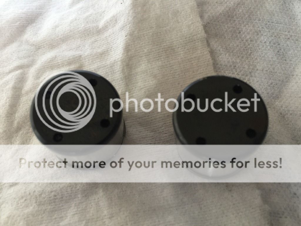

I'll start with the little bits first, as you know I keep on top of general service/maintenance of the Cupra.
This is a recent follower change that has done just over 2.5k at 2+ getting its head kicked in in a regular basis.
Old on the left:

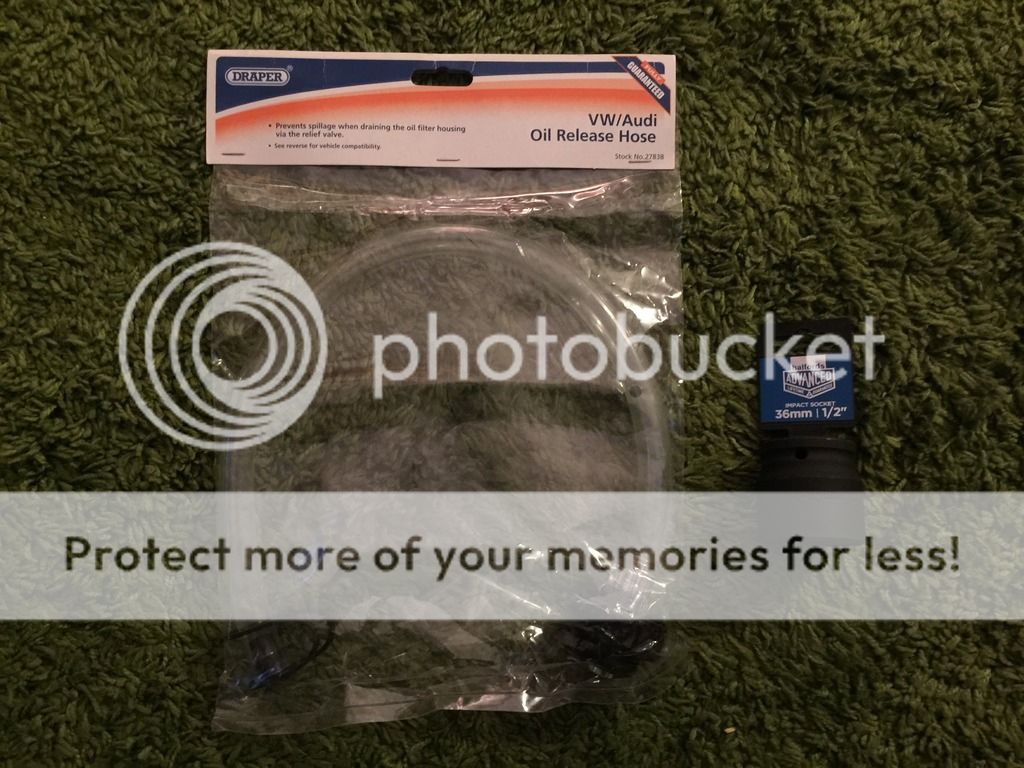

As you can see the old one is practically brand new with no wear so very happy with that.Done it's regular 2k oil change and to help I purchased an oil filter drain.This is great as it stops me getting covered every time I remove the filter housing :happy:

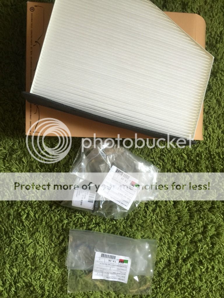

Also put a new pollen filter in whilst I was at it as it's not been done for a while

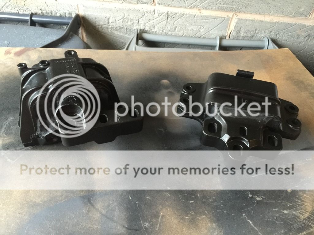

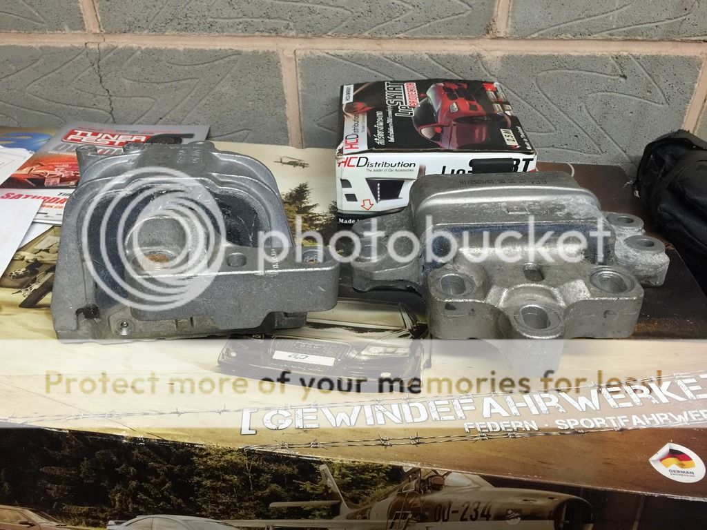

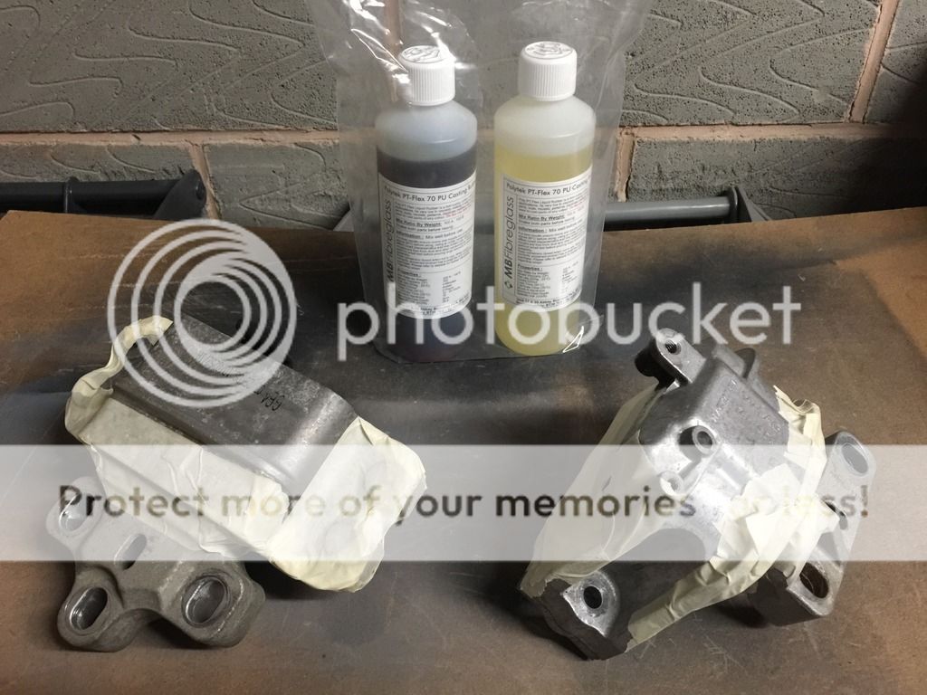

Wanted to fit uprated engine mounts but rather than pay silly money for them I decided to polytek some standard mounts.
Pic of a spare set of mounts masked off ready to pour the mix in.You can see in the pic the polytek I've used it's basically a track density grade so pretty stiff.
This pic is once cured and masking tape removed
Then before fitting I decided to spray them Matt black.They don't look bad at all for a diy job so very happy with them and for the cost it was well worth the effort.
I've not got any pics of them during the process of me fitting them as I didn't want to mess around whilst doing the job especially as at points the engine/gearbox is supported by my trolley jack.
Obviously at first I got a little cabin vibrations and you can hear the cars mechanical sounds more.After doing around 1k miles these have settled considerably and I'm very happy with the way the car feels with them fitted. Much crisper throttle response and surprisingly it's changed the way she sounds but in a good way.

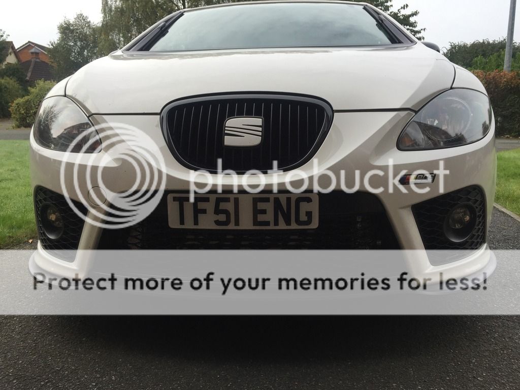

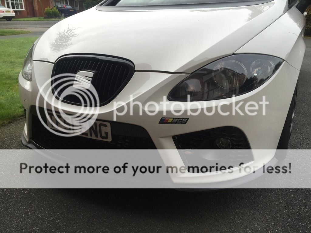

Next up I put the little rubber splitter on to make the front a bit better.For the money I'm happy with it for now but will get a proper one at some point in the year.

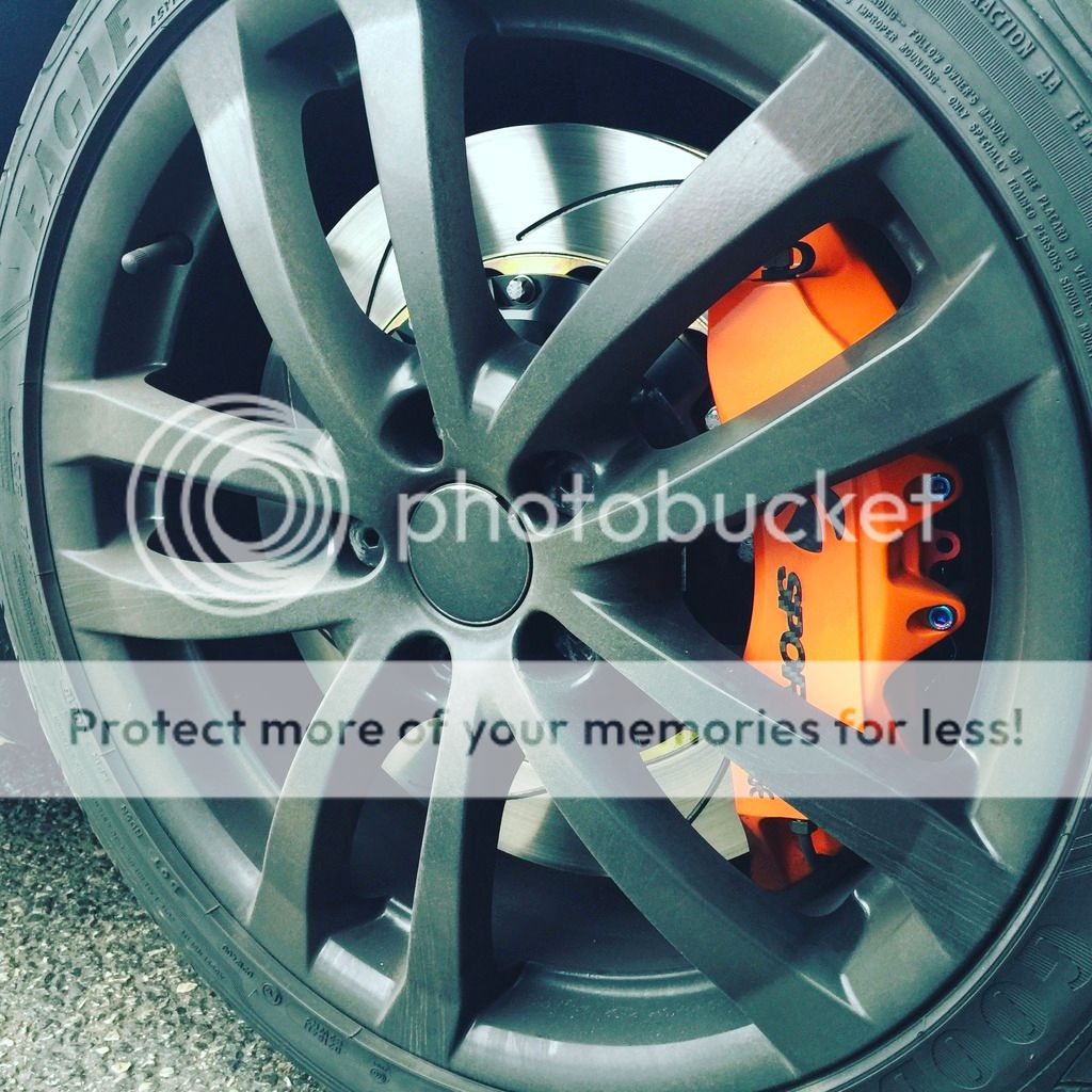

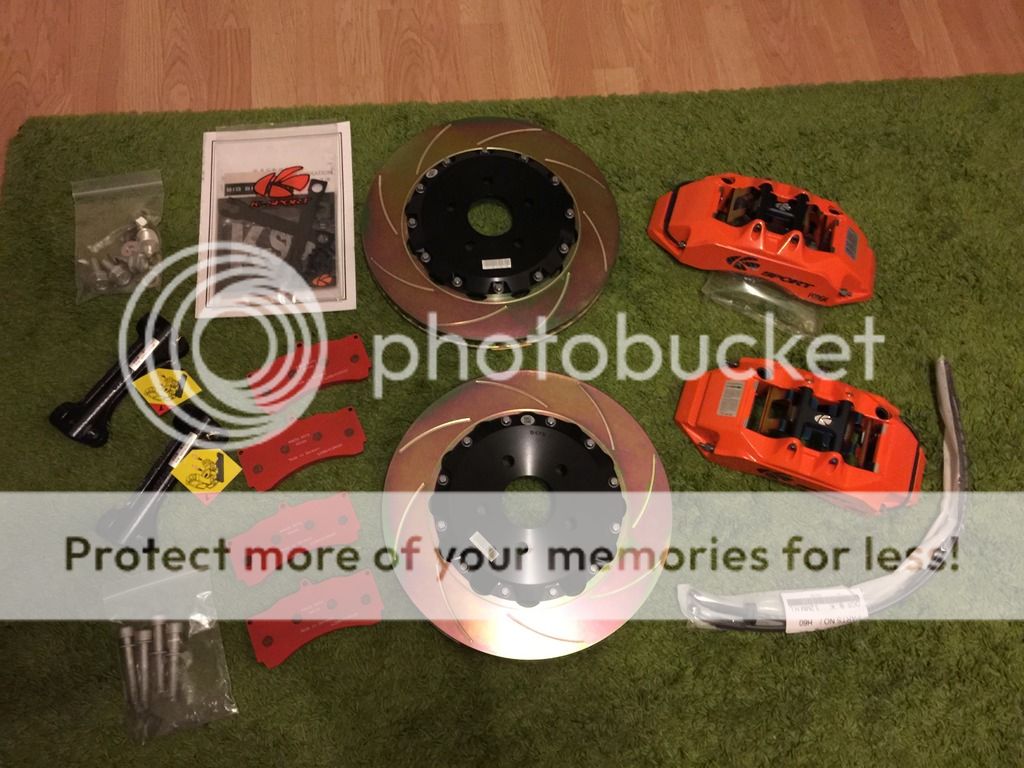

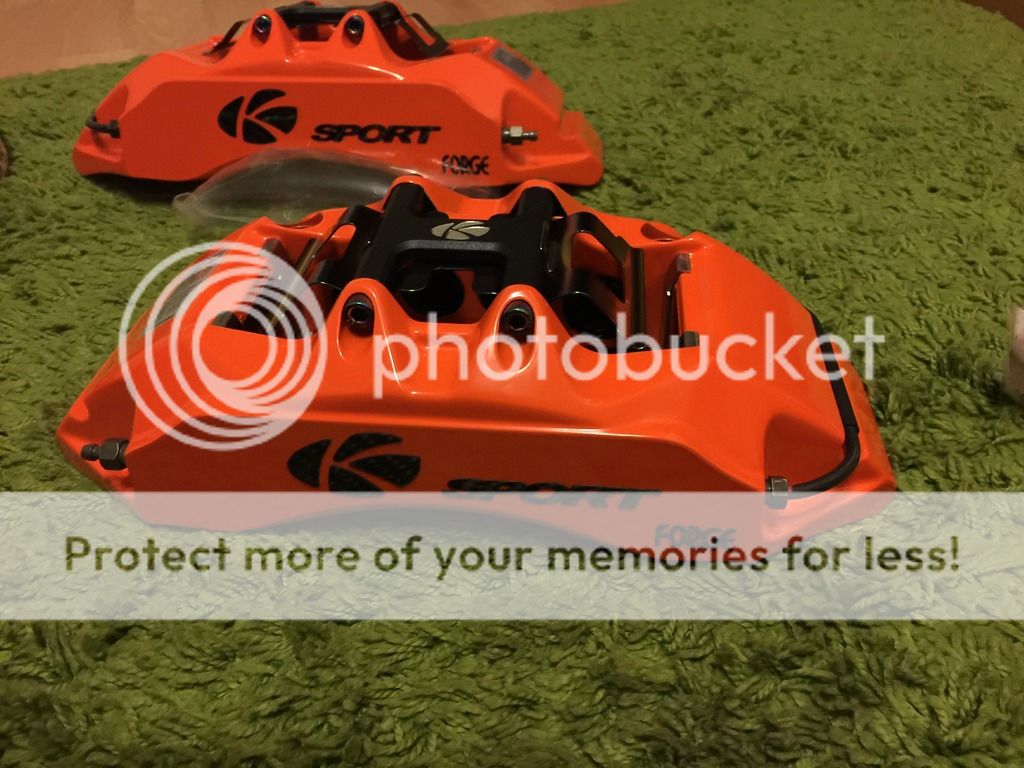

Some of you will remember me saying after her last track sessions the brake setup I was running simply didn't stand up to the hammering she gets and was holding me back. With this in mind I've purchased a Ksport big brake kit in the form of 356mm two piece discs,Braided lines,race fluid,Pagid rat-3 pads and these epic 8pot calipers :funk:

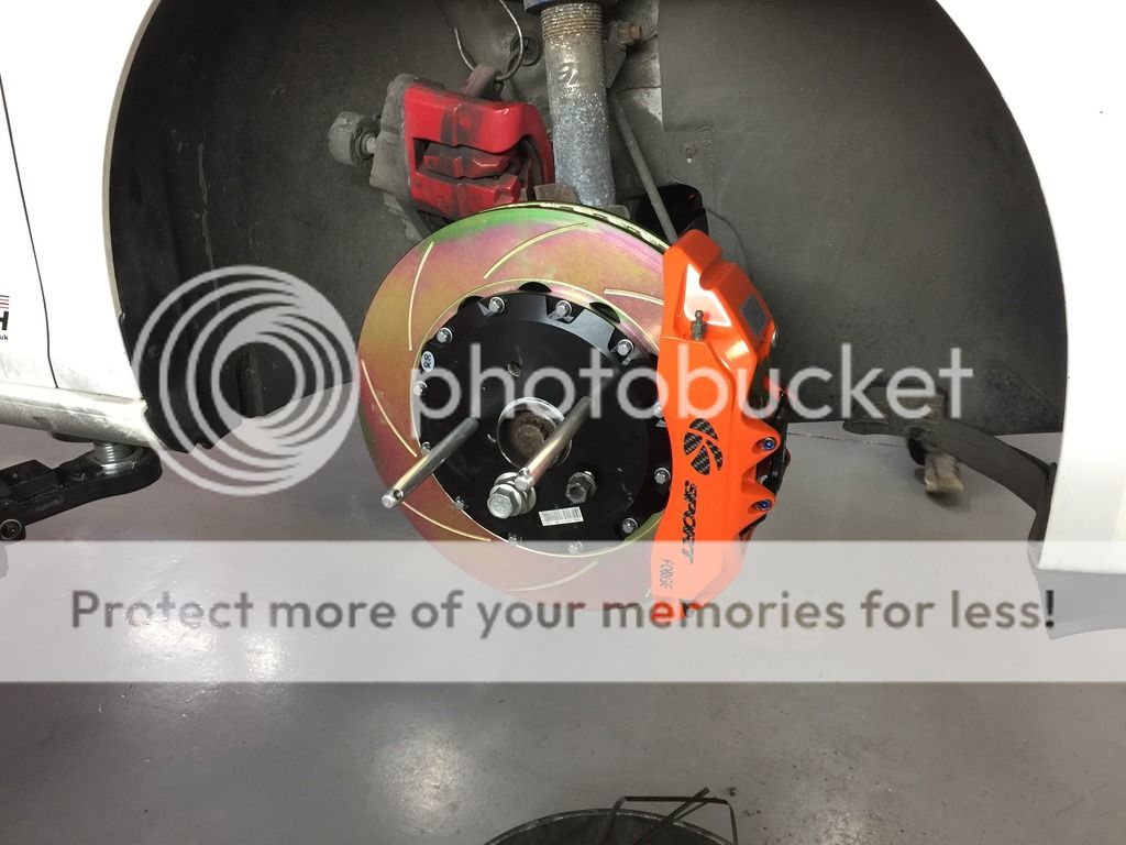

Got them fitted at AKS tuning
And a pic of them behind the wheels
First impressions are simply WOW!!! what a difference a big brake kit makes. Considering they aren't even bedded in yet and I'm probably using 30-40% of the capability until such time they are truly epic on how good they are. Just the slightest touch of the pedal once warmed up and they are better than my old setup.So once fully bedded in they will be awesome.

Just epic. The front end is really completed with that splitter. I did not think orange would work behind the wheel on a CW LC. But it does and it looks epic! :D
I've thought about getting stiffer mounts for the motor, but as you mentioned, I am not too keen on the extra vibrations that will result in it. You say its settled down - is it now as quite as the original mounts or not so much ?

She's getting near to how I want it but still a good amount to be done haha.You do get vibrations still but nothing like when I first fitted them.For example on pull off in first gear,if you get the revs spot on I get next to no vibration.
All in all though I can live with it all day long.Suppose it's personal preference really some wouldn't like it but I love it if I'm honest should have done it a long time ago.
