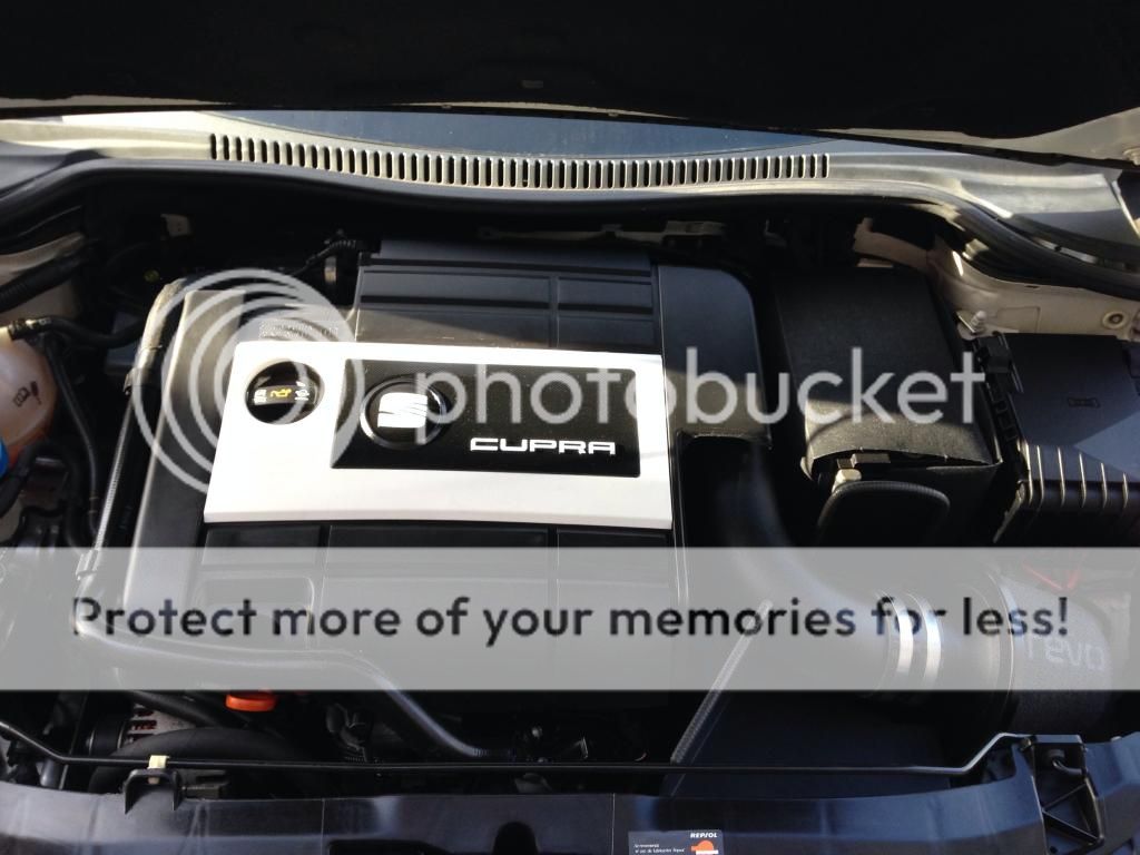

Your plans sound good mate will get some pics up soon of the new look engine bay.Had a battle fitting the intake but worth it :D just need to trim a little more off the engine cover to clear the MAF.
Yeah so much of the cover needs trimming. A little tip I found, the holes in the cover where the rubber grommets locate - cut a section of the hole away, that way the cover will locate onto the studs much more easily - and more importantly come away a lot easier next time you need to take it off.
The rigidity of the cover isnt too good once its trimmed so it really helps. Ill dig out a photo to show you what I mean
So after a bit of a battle my CAI and cover are fitted. Removing the original pipe off the turbo was a nightmare(poor access). My cover needed a little bit of a trim to allow clearance for the MAF so out came the Dremel lol.
To get the cover on was a little tight but got it on after a nice brew and chill out :D
Here is a couple of images

Loving the strut fella makes life very easy whilst working under the bonnet, fitted it before the intake and afterwards I thought that would have been a pain in the arse without it.

Anyway these are the little segments I cut out the holes where the rubber grommets locate. They could be a bit smaller but there is still enough lip there to stop the rubber pushing through when mounting the cover, but it allows a little more give in the rubber for the metal mounts to push through the rubber.
I was finding it impossible before I made the cuts, the increased flexibility especially at the back 2 was just pushing the lower portion of the cover upwards.

Looking at the image you put up on another thread of the battery cover install it looks like my cover needs to go down more.As your cover seems to be closer to the intake on the battery side compared to mine :shrug:
Will have a play with it tomorrow but it feels solid and I was able to get my hand down near the back mounts to push and again it felt solid.
