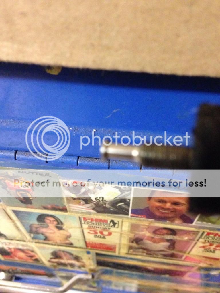

It's screwed on mate but also has an anti theft device at the tip of the thread you can see it in the image.What I did was unscrew it as far as it will go then placed one hand on the aerial base and gripped the aerial with other hand and pushed the base down and pulled the aerial up simultaneously. It does take a lot of force but it will have it.Also helped moving the aerial side to side whilst pulling up.

Cheers bud, I take it the piece that looks "ridged" in your picture doesn't prevent the replacement going on?

No mate just screw new one straight in :D
