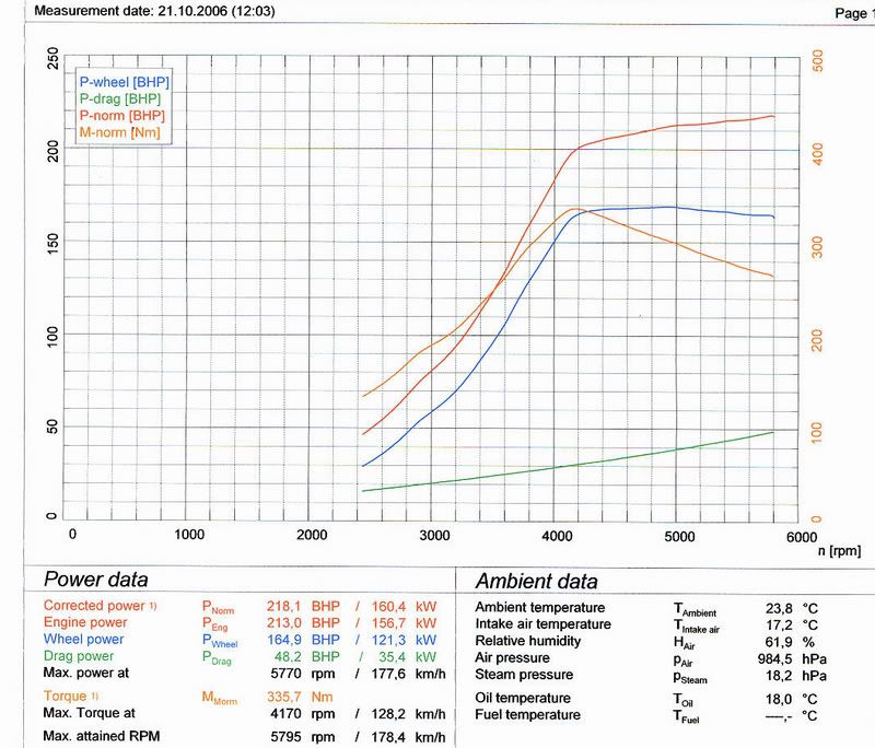

My graph from Jabba

You will have to load big so its clear!
Very low compared to yours?
164.9bhp @ the wheels against your 232bhp@ the wheels

what spec is yours? it's not K03s is it?
I have:-
Ko3s Turbo
Miltek DP, 100Cell race cat
Supersprint Full Race system 2.5" all the way on both
4Bar FPR
Forge Intercooler
Dynatwist
Revo Stage 2 on boost 7 timing 6
Thats the engine anyway!
THere is obviously a transmission loss of 64bhp though! Quite High?

Why did they run your car to only 5800?
Actually i didn't notice that! its still rising!
I would really like peak power by 5000rpm though becuase otherwise i'm redlining it all the time to get full power... I don't get much of a chance to drive fast as i only use the car for work!
May 2, 2006
2,758
fly power might be climbing but the power your putting down at the wheels is tailing....
My wheels power is higher at 5000prm but the fly wheel figure is still on the climbat 5800rpm???? Does that make sense?? Surely they should both decrease together?
