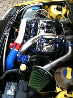

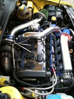

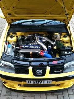

little update as i havnt updated any pics for a while and ive been doing a few little mods over the last couple of months
1st /i made a turbo/manifold bracket to stop the manifold from moving and cracking as the turbo is top mounted and is holding quite a bit of weight
2nd / was to replace the very restricted twin 2.1/4" back box with a high flow custom 3"entry twin 3" exit
3rd/ replaced the intake pipe to the turbo with stainless steel 3" this was due to silicone pipe work kept on calapsing
4th/ i replaced the hks ssq dump valve spring with a more heavier duty one this was leaking boost slightly
5th re-routed some of the boost pipe work to intercooler to shortin it
6th set up the "wot box" launch and flat shift controller
7th painted rear lights in clear coat red

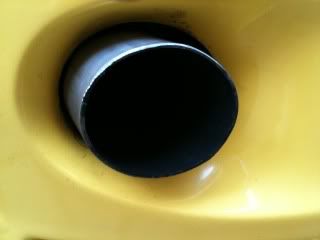

8th re-routed the dump tube ( SCREAMER PIPE ) to exit out of the front driver side fog light hole just for amusment and to scare the public
9th removed alot of weight behind door cards and rear quarter cards a/c and few other parts what the car didnt want to carry any more lol
10th finally gave the car my own detail , wet and dry full machine polish finished with lambswool polish and a few coats of wax ,paint protection , anti traffic film gaurd
i have got a few more mods when the nice weather arrives then some crazy 1's for when i take it off the road for winter he's some pics
Just a thought - your screamer pipe - won't it just end up chucking shite down the side of the car?
Nop ive had it there for about amonth now and the bumper dont get any dirtier strange i know i did think of it before putting it there you carnt describe the noise when the car is coming towards you its weird obviously the noise of a car is from the rear and sounds good when going off in the distance but where this is when its coming towards you is where it sounds good :-D a few mates say it sounds like a fighter jet taking off haha
