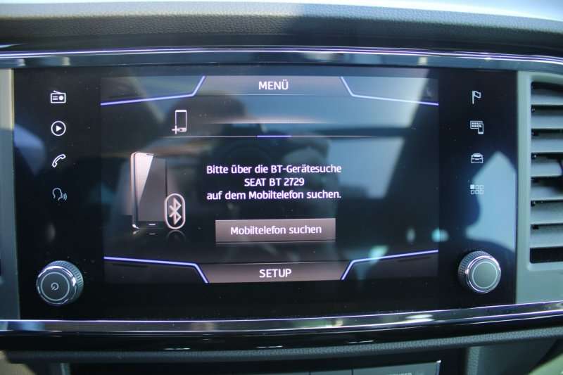

The good thing about it is the bigger display thats not loaded with physical buttons. Maybe i should just change the display to the all glass one
This one. Whats the part number of it? Is it plug and play?
You'll need a new trim piece otherwise you'll have 5mm gaps either side
Display PN 5FJ 919 606
Thanks! But that part number is for MIB 3 screen, not the one in the photo. Im thinking of changing the screen and trim only and keep MIB2. Do you have the PN of the MIB2 screen in the photo and trims (given that my ateca is LHS)
They're the same screen. I fitted one to my partner's old ateca. The display you posted does actually have a sticker on the back for MIB3 however MIB2 & MIB3 use the same display format so the displays are interchangeable
The part number I gave you is for the picture you posted. The newer MIB3 display is the same PN with an A on the end this is what my partners 2021 Tarraco has.
Reactions: hamst
Thanks for this explanation. Would you know the trim and airvent part numbers aswell? For LHS cars please ?
