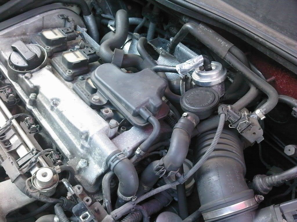

In the case of the Leon Cupra, the N249 solenoid is located under the black metal vac hose carrier assembly that your dipstick sticks through. You need to remove the small plastic cover that goes round the front and right/front of the engine.

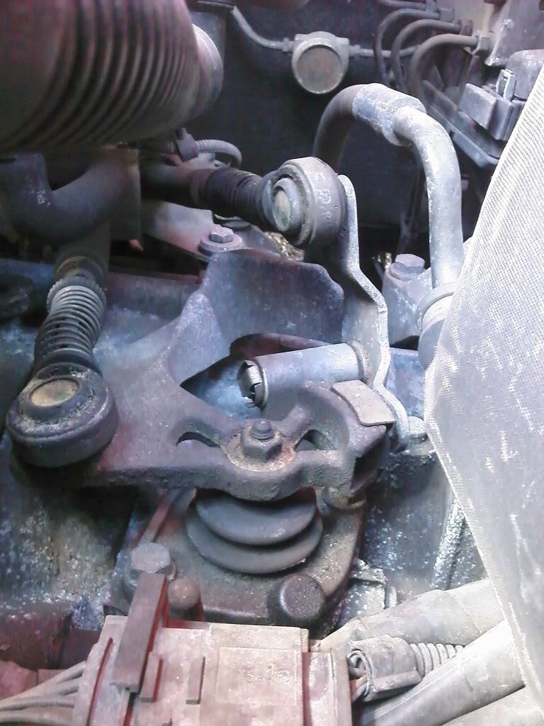

APP is not cable throttle, it is Drive By Wire the same as any other Leon Cupra. As far as I know its exactly the same arrangement as my photos. The only differences between APP and AUQ are the turbo and APP doesn't have Variable Valve Timing.

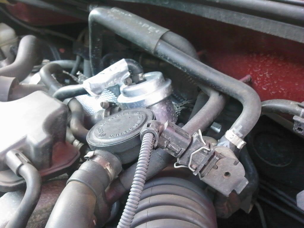

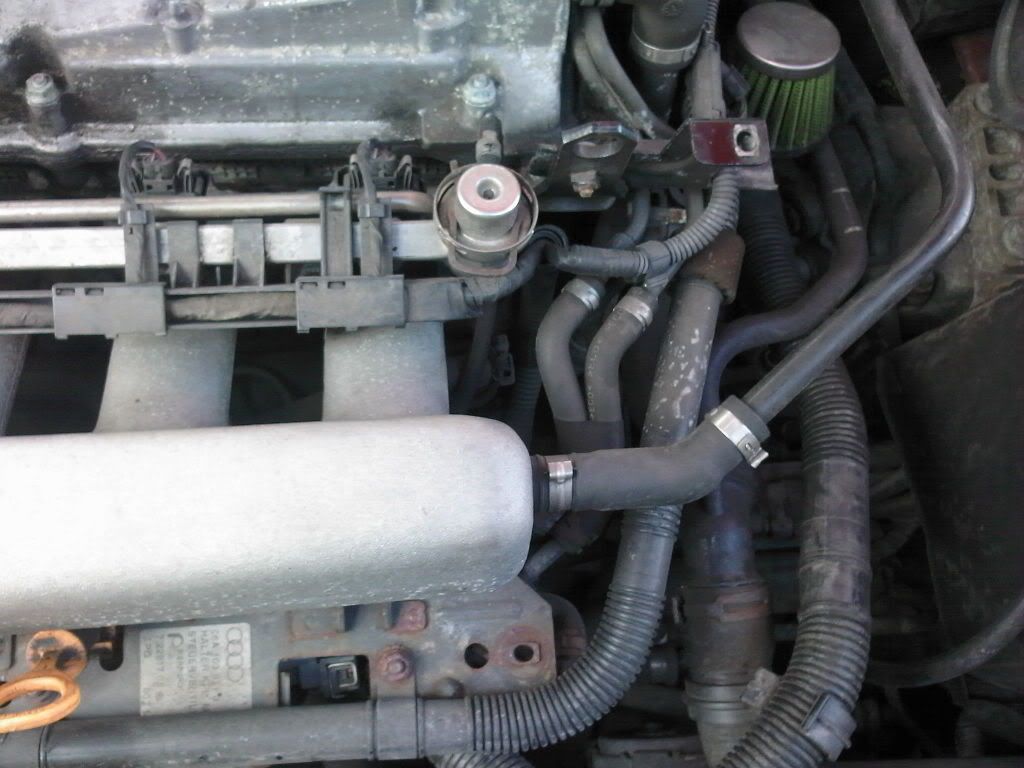

in response to previous post, engine bay pics (sorry about size/quality done on mobile phone)
the one below is what i thought could have been the throttle cable after a quick look then realised its the top of the gearbox :doh: i'll just go and hit myself with something big and heavy :blink:
please feel free to do drawings on my pics to show what gets binned, what gets blocked, what gets re-hosed and what gets left alone
many thanks for your help and patience with my lack of mechanical knowledge:blink::confused:
