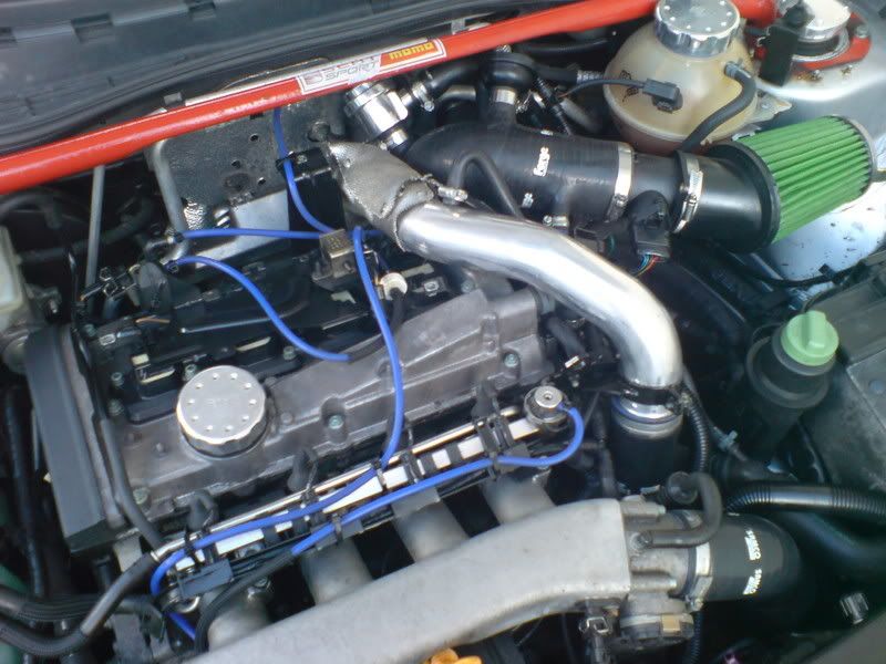

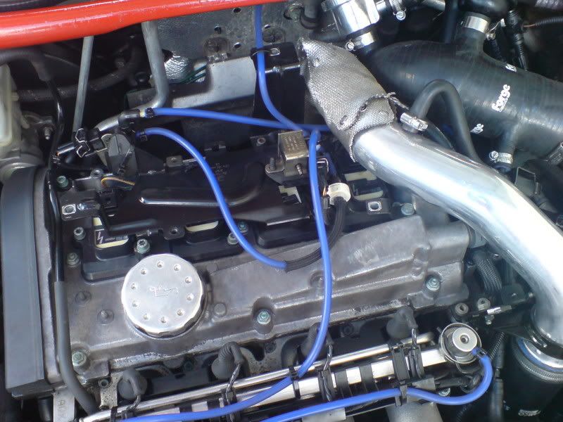

Right i actually got a question on this.
Its not about my car as i've removed the entire system, but on the N112 valve, the one which is actually used is the third port which isnt being used capped off?
You can see in this pic that theres a cap over the third port shown at the very bottom of the pic.
I've noticed some people havent got theirs blanked off, would this effect the running?
You got any more pics phil cant really understand i did notice on mine beacause i had the ko3s conversion there was a pipe blanked off
it looks to me that its plumbed in wrong i dont know mate
my N249 valve is disconted apart from the electrical plug
the other valve has only 2 connections and they are wired up i have no blanking plugs any where
on partial throttle it chatters a bit but when it hits full boost its a really quick woosh when i let off no chatter
its still peaking at 1.7 bar then fades to a 1 bar still on standard jabba map maybe wrong spring in forge recerc valve
really going well though
sounds like your dump valve spring is too stiff if its chattering only on partial throttle but ok at full boost/throttle
