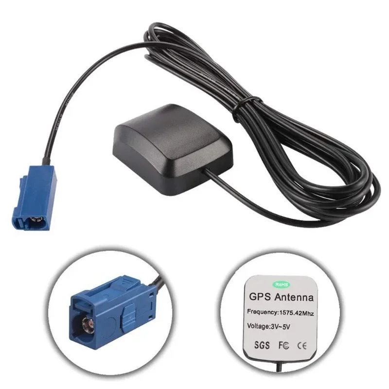

Get a cheap GPS receiver with a Fakra connector, like this one, just to see if the problem is in your existing receiver.
Disconnect the original from the back of the infotainment unit and connect the new one.
If it does the job, you may keep it or consider replacing the faulty original, if you're a genuine-parts-maniac like me.
