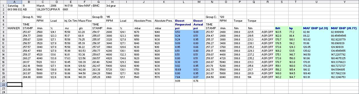

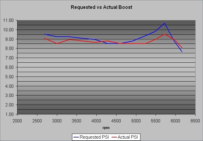

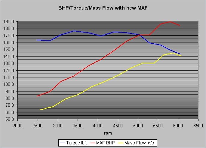

Did some logging after I fitted the new MAF this weekend. Does everything look ok?? Any ideas what the boost spike is at 5500rpm??
Car is standard bar a BMC CDA and Forge 007p - 180bhp Ibiza Cupra-R

fingers crossed, dont think its DV, unless its the spring, getting springs and possibly n75 tomorrow :) would consider still doing the n249 anyway as iv heard people say they get smoother sometimes more boost
