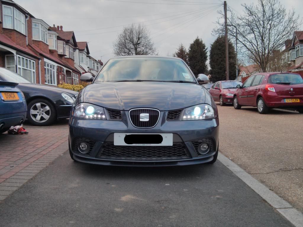

I like the lights very much :). Seen them earlier in the year but quite pricey!
That isn't too bad for the discs! Are they 312? Wonder how much it would be for a set of 4!!
Cheers matey. The lights aint that pricey when you consider how much the OEM ones are...
My discs are standard size but grooved :) you upgrade your rears to the same as fronts??? My rears are still standard as well but won't bother goin grooved on them as the car's setup hardly uses them
Purely for the looks really :).

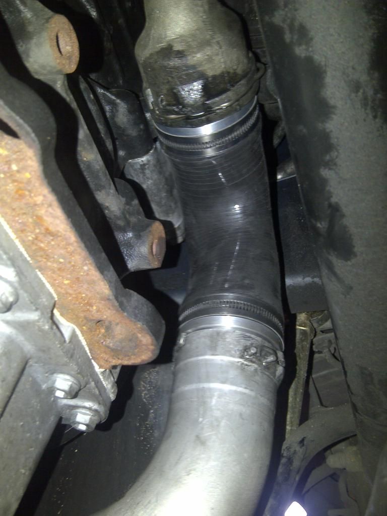

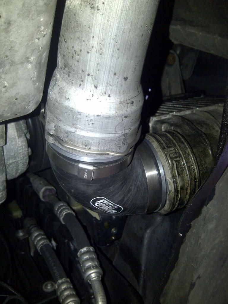

all lower boost pipes are now out, will take some pics of the assembly for the FR TDi's as not much info out there.
will be installing the upper boost pipe and lower 90 degree bend in the morning so hopefully it will help others in future
reluctantly I had to send back the upper 1-piece pipe to get one of the connectors spun round as the grooves didn't line up with the EGR inlet...but in the meantime i got busy fitting the lower replacement pipes :clap:
90 degree bend - metal centre pipe to SMIC (SAMCO PD130 kit)
turbo outlet, less restriction - turbo to metal centre pipe (SFS)
can't wait to get the upper pipe back and get it out on the road again to see whether top end rev performance is better and less smokey as it felt a tad low on power. Before fitting the new pipes i gave the inlets and outlets a good wipe down as were full of oil from the diesel fuel (from my pics you can see the residues from the old leaks)
will post again as soon as the top pipe arrives (i'm hoping before Christmas but not holding my breath...)
thanks for looking :)
NOTE: all replacement pipes were fitted using original VW o-ring seals and pipe clips (for the later mk4 Ibiza engines). I will post up the o-ring seal part numbers for people's reference tonight (not cheap but at least they're original and fit)

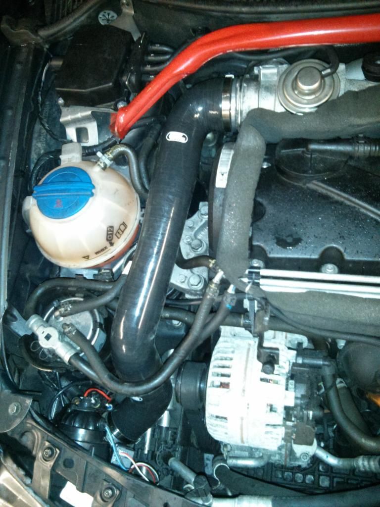

finally fitted the top boost pipe after some problems with SAMCO...should have gone with SFS but was already done.
anyways here is the top pipe fitted:
pulls much better through the revs and no smoke!! :D
let's see how long it lasts me now but chuffed so far (after 2 months off the road)

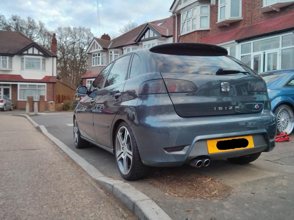

got the whip washed and polished on the bank holiday weekend just before it started flurrying. Took some up to date snaps as I also changed my front indicator bulbs to chromed versions, getting rid of the orange indicator look. You can't really notice the lowered stance as I had it parked in front of my mates drive but at least I have some recent shots now
will hopefully have some nicer shots this Sunday at AMD
