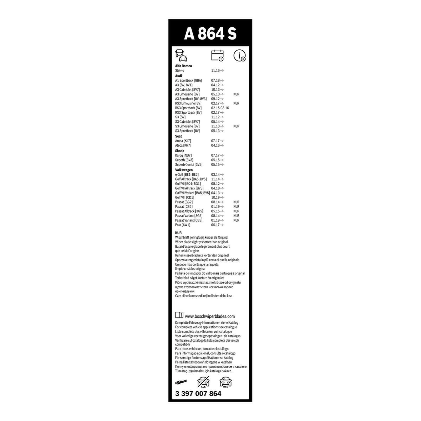

Are these the ones you bought? They look different to those on my 2020 Ateca.
cupraatecastu
Jun 29, 2020
17
14
Reactions: Loadmaster748
Tell
Full Member
Rafletcher has the pre face lifted Cupra Ateca unless they have changed it... research has shown they are the same Bosch blades after FL. A864S fitted on 2020- facelifted as pre facelifted. The Bosch site is a bit useless on this at the minute but Europarts site has same.
Had a thread.😉.
Covers front and rear serial number. Note for LHD it's A863S
RHD A864S <- (UK, Ireland, Australia and NZ)
Rear A282H <-
