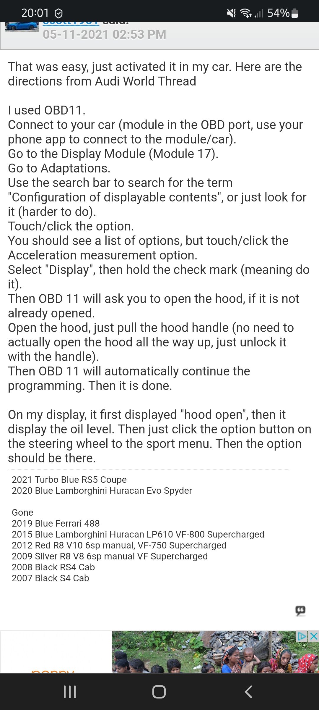

Hi ,
Anyone tried to activate acceleration measure on display yet? I've tried to through this but can't see any added display on the dash? Just wondering if someone had tried it

Hi ,

I took a look and found the "Acceleration measurement" option and added it to the dash, along with power and torque.
But can't find it when scrolling through the dashboard contents and options :( only found power and torque, but torque is bugged for me and always stay a 0.
Might be one of those suppressed menu screens you get on mib2 where you need coding on the infotainment screen to put up another menu option. You then save it on Obdeleven, reboot the infotainment then it gives you an additional menu on the infotainment screen if I haven't got hold of the wrong end of the stick. E.g.. You have it on the virtual cockpit but not the infotainment screen... Think that's what you are saying.
I think I get what you're saying. I'm still a bit new to this. But yes, it seems the infotainment screen just isn't setup to use the acceleration input as is.
What I did was just set the measurement to "Active" in OBDeleven, but some more work seems to be necessary. Would be an awesome gadget to have on the dash.
