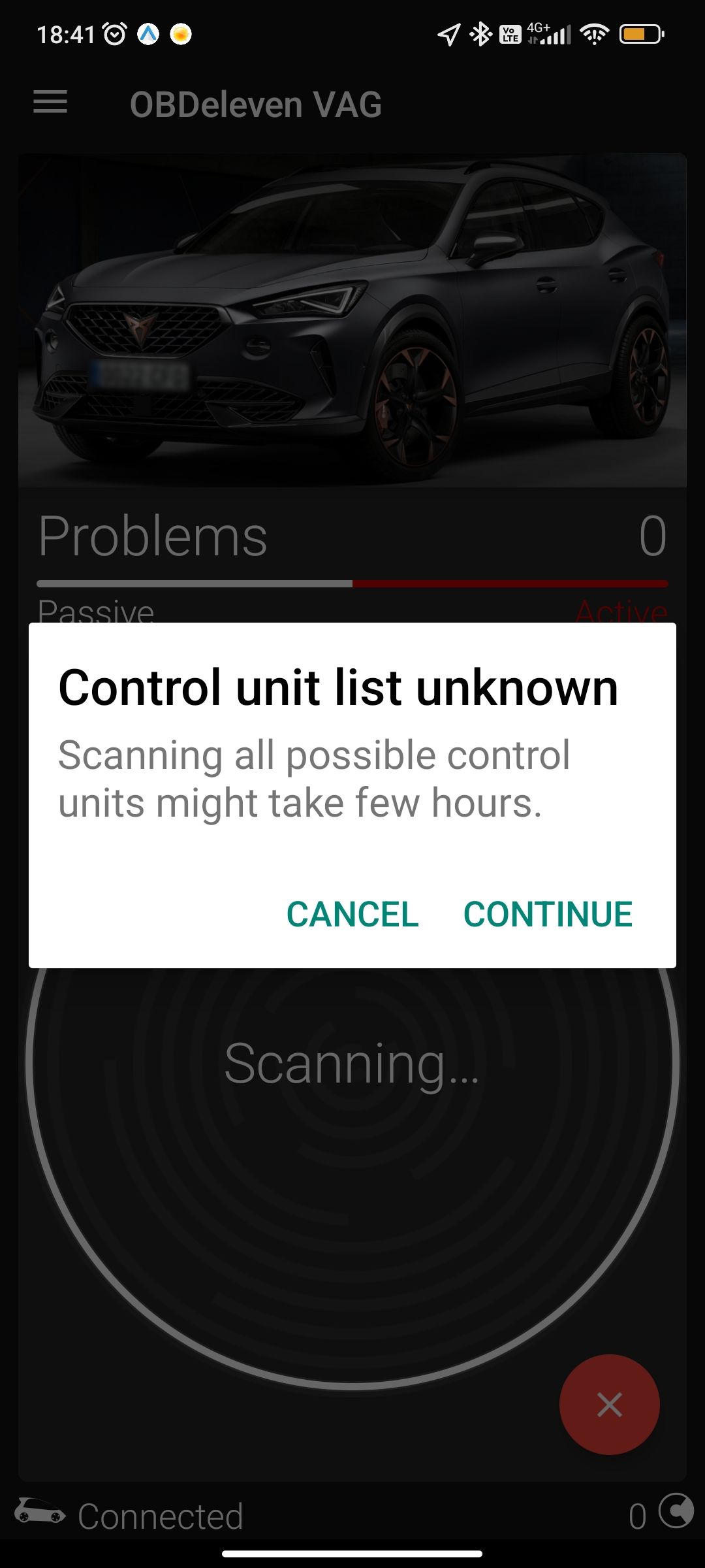

Hmmm take hours to scan ??
Might be their servers at the time or your network connection. It forms a link between your phone / tablet, Bluetooth to the dongle. Wi-Fi or 4g etc to the servers. So the pace of their servers can slow it down. Normally about two minutes or so for me on a scan. Ofcourse the Formentor tech might have been slowing things down is another variable on the day. I get a few false starts on the connect button. On the white device you see the Led lights flashing in it. Flashing good. You are getting connected. Sometimes it does a dongle update over the air. Generally 100% reliable.
