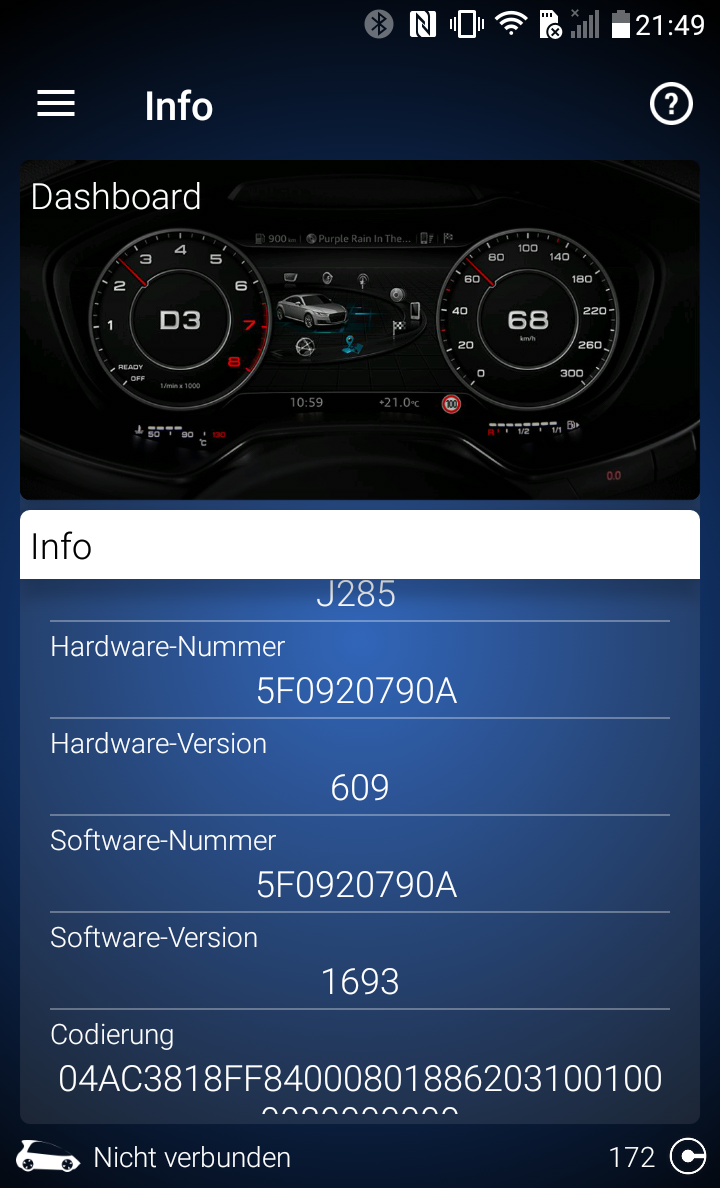

Does anyone know if OBDEleven is able to give the hardware number when going into a module to play about with settings.
Just be interested to find out if there is a genuine part difference between the Digital Cockpits of MY2018 and MY2019.
Thanks.

Looks like it damo. Here's a screenshot of my engine module showing hardware number

Awesome! @Titchy does this match the information that VCDS shows?
Next favour is to ask anyone with a MY 2019 Cupra 290/ST 300 to check the details of their Digital Dash/Digital Cockpit/Virtual Cockpit. I'll ask @paddy6789 to check mine as I'm sadly with iPhone and Carista.
Hopefully that way we can confirm the difference in the details between 2018 and 2019.
