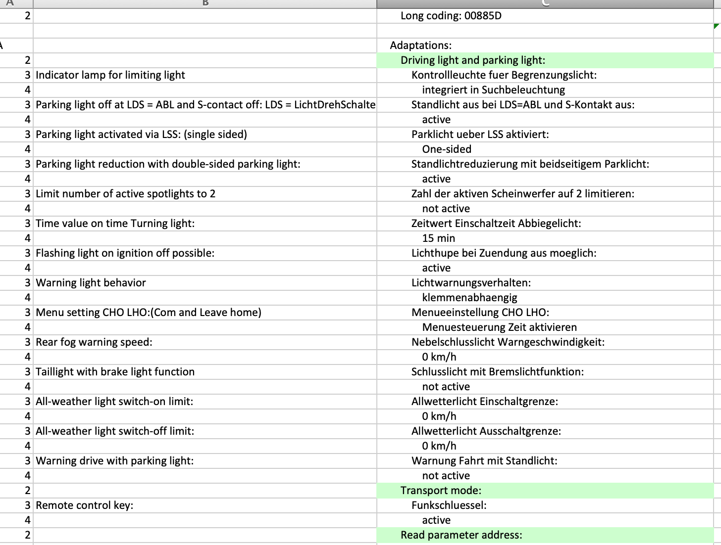

I've tried this and the other settings and it's still very quiet and intermittent on mine.
...if only I could read German!
Do a backup of your control unit and then start converting to English in your Excel Control Spreadsheet.
