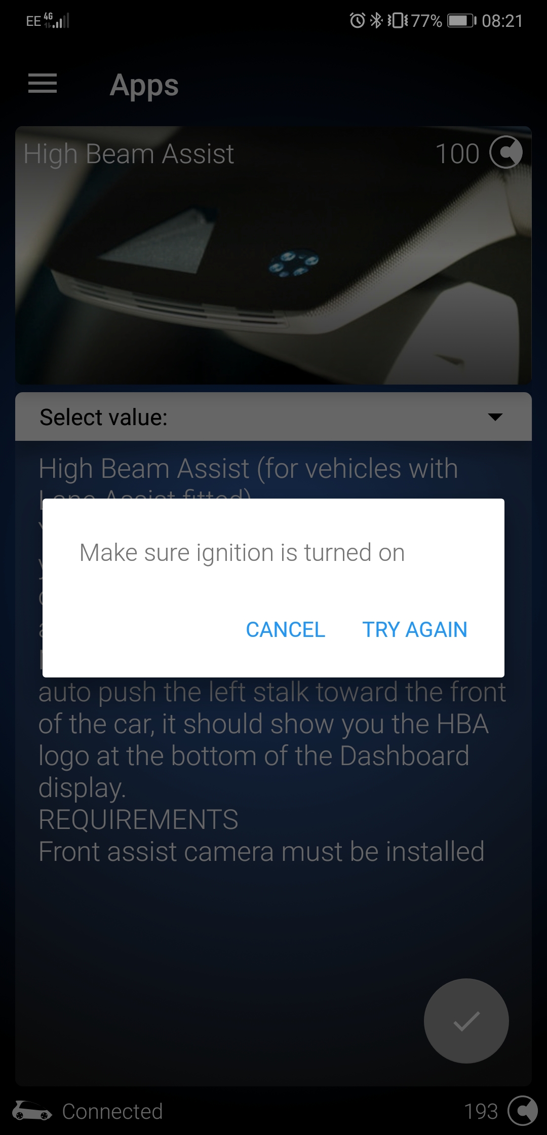

Hi all, I had another dabble with the obdeleven and activated a few more apps, but I clicked on some that refused to work with the following message

Hi all, I had another dabble with the obdeleven and activated a few more apps, but I clicked on some that refused to work with the following message View attachment 3377
Some of them don't work on all cars, sometimes because your car isn't fitted with the necessary hardware to turn a feature on. For example you can turn sign recognition on but your car doesn't have the camera to read the signs.

If you check in your control units look for
Control unit: A9 Actuator For Structure-Borne Sound
If you dont have it thats why the app dont work, if you do then you can adjust or turn it off yourself.
