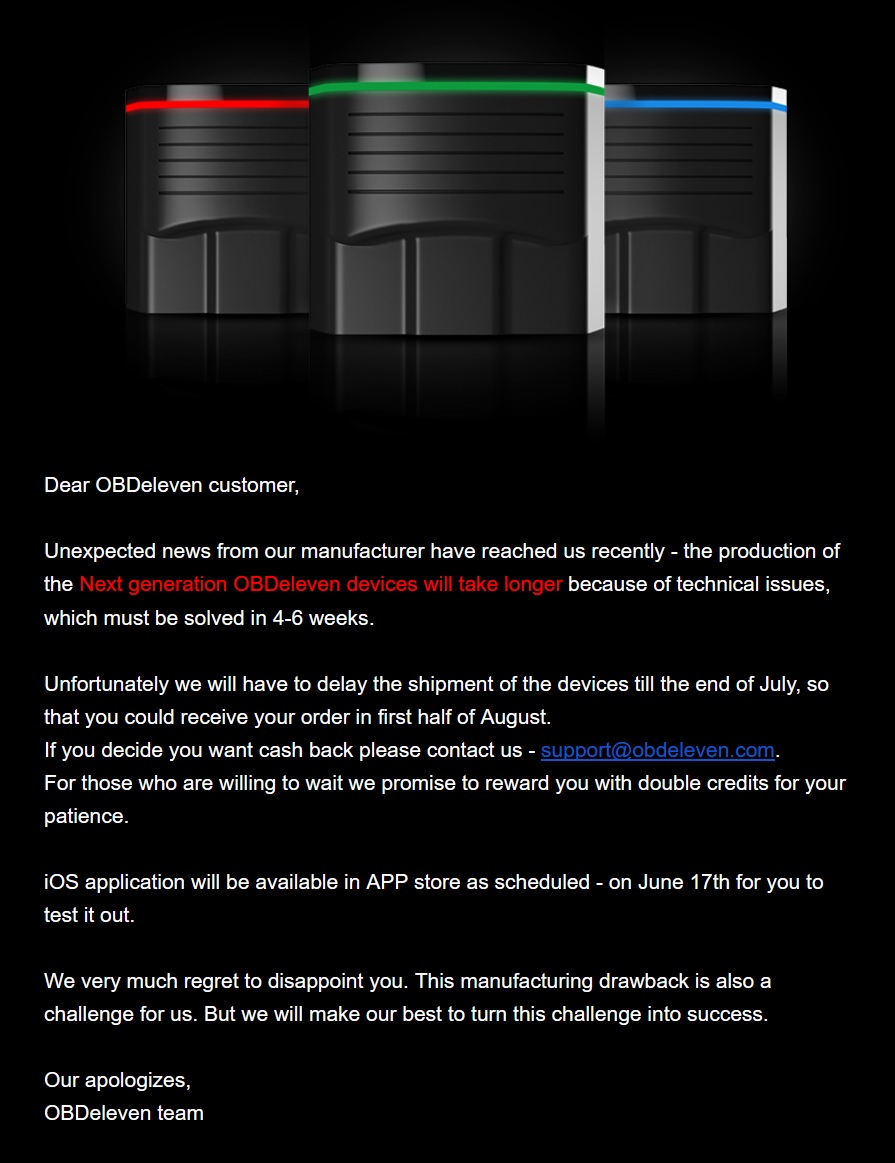

Anyone thinking of getting the new OBDEleven. I'm on the first batch for delivery, so anyone thinking of ordering now may have to wait alot longer
Gutted to receive this email today :(

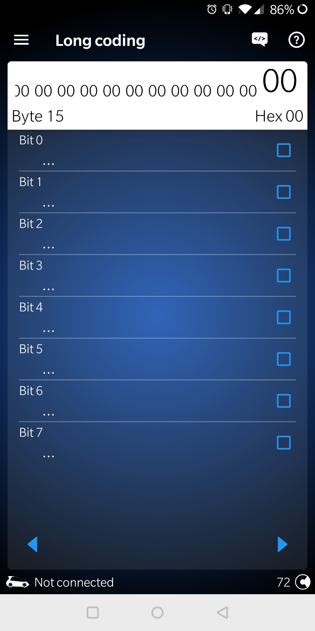

Has anyone got the following to work, to disable the yellow mode light.....
Module 9
Long coding
Byte 15
Activate bit 7
The light stays yellow for me. Only goes off in normal mode.
I selected module 9 and then long coding. Then scrolled along to byte 15, ticked bit 7 and then saved the change. I assume that is correct.
Deleted member 103408
Module 9
Long coding
Byte 15
Activate bit 7
Yes this worked fine on my Pre Facelift car, do you have the same description for Bit7
Last obvious question (as we all do it) did you tick the green box to save the change
Then you cant use this coding, the great burgers at VW Removed all the long coding from about 2016 (on the BCM Control unit) so this code does not work for you I am afraid.
Reactions: Don1961
No problem, have a look in the adaptation most of the stuff that was in Long Coding got moved across but I dont pay much attention to facelift cars I am afraid.
