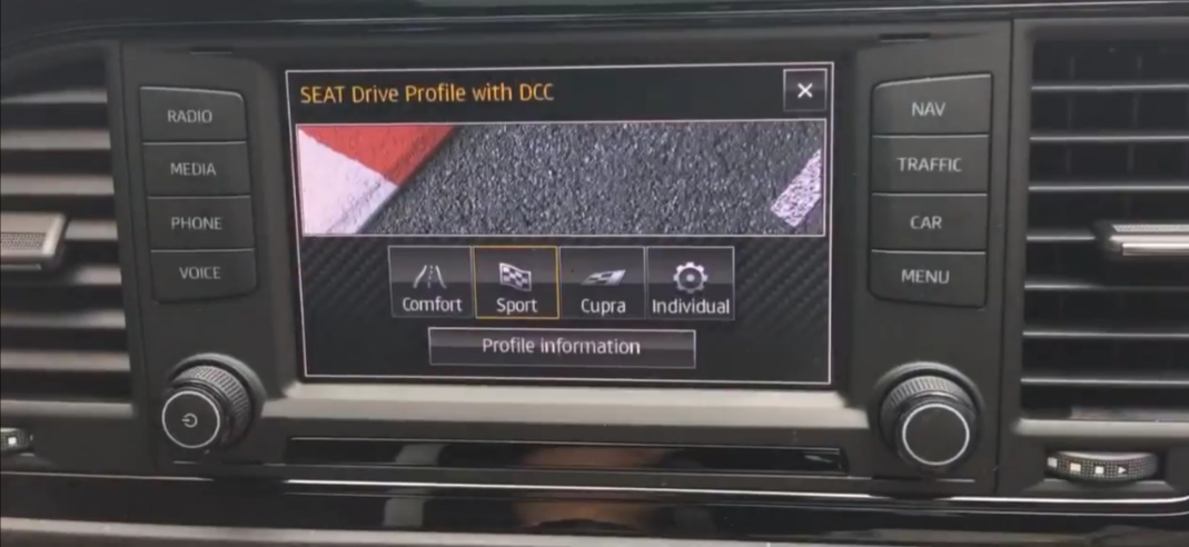

Any ideas how I can this screen on my MIB2 high? Is it under skins or version? Or not even possible? 66 plate cupra 290.

Not possible I believe. My 67 plate CUPRA has it and I believe it’s not able to be applied to pre-facelift models. (Unless someone disputed this )
I've seen 16-66 plate Cupra's having them so confused.com lol
I did put a disclaimer in lol
It may depend on the MIB2 firmware then. Or maybe when the car was released. We do know that same models across a year do have different sat nav maps etc so I’d expect different firmware across the production year too.
I'm sure they must have different skins built-in to the MIB2 units but I can't find it on the obdeleven
I'll keep searching lol
Btw anyone got into green mode too?
I did do it via obdeleven but didn't do jack? Just showed service mode not development mode
