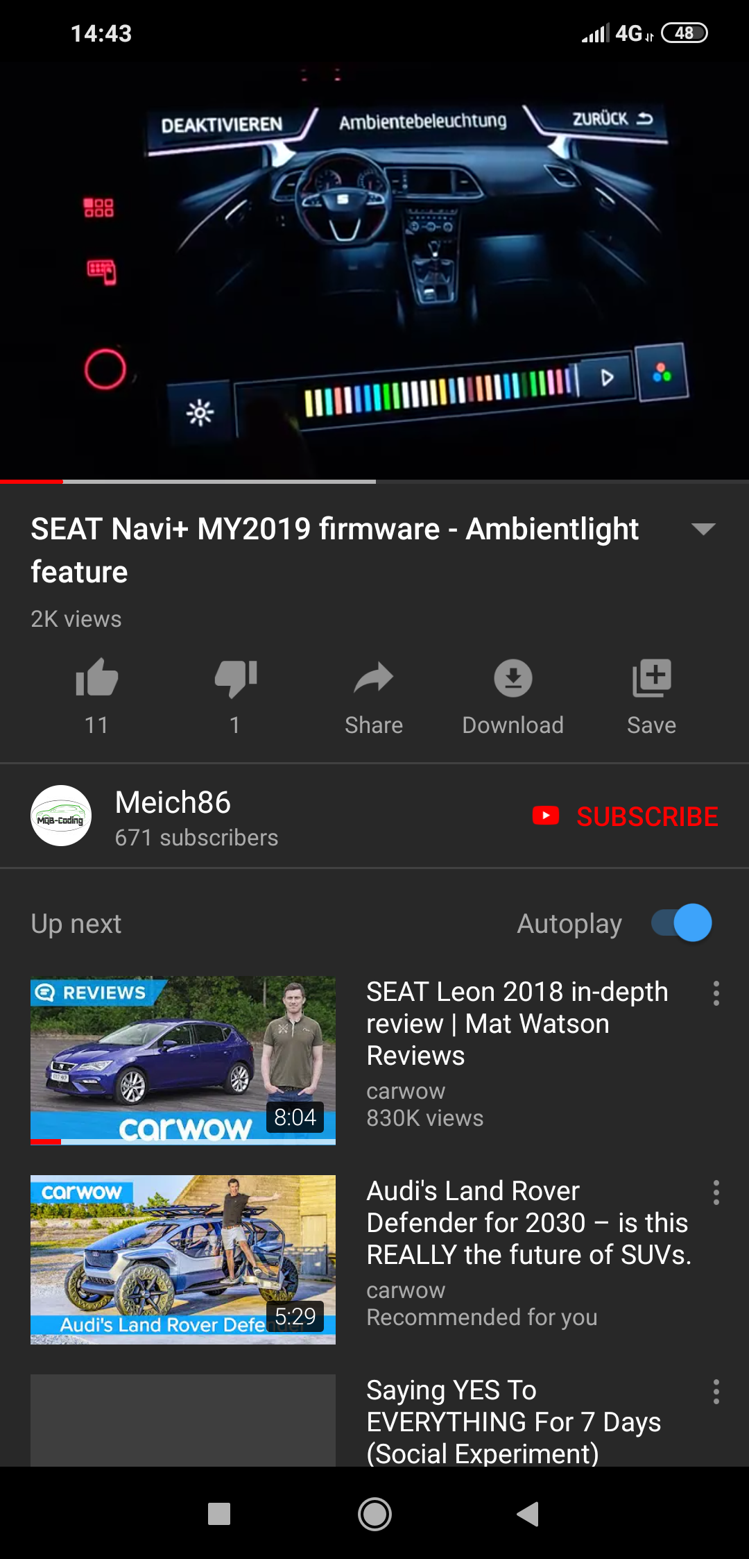

I have carista and have added two additional ambient light colours (green and purple) which are now options on the system. It allows me to select the colour but it only changes the outline colours on the digital dash and central screen. The ambient lights in the doors remain the same colour as the previous selected colour (red,blue, white,yellow etc). It appears carista hasn't worked out the fulll coding to get the doors to change in line with the new colour selections.
My question is, does obd11 allow ambient light amendments that actually allow the door card ambient lights to change as well? I saw a video on YouTube of a Leon with about 25 different colour options.
My car is a 2019 Cupra not sure if anyone has got it working on the newer cars yet?

I’ve changed the Ambient colours on the door cards on my wife’s 2017 Leon Xcellence and when selected the colour does change in them.
The car doesn’t have a digital dash though and I did use OBDEleven.
I would think that it’s a coding issues. I altered the coding manually by adding in the new RGB codes.
