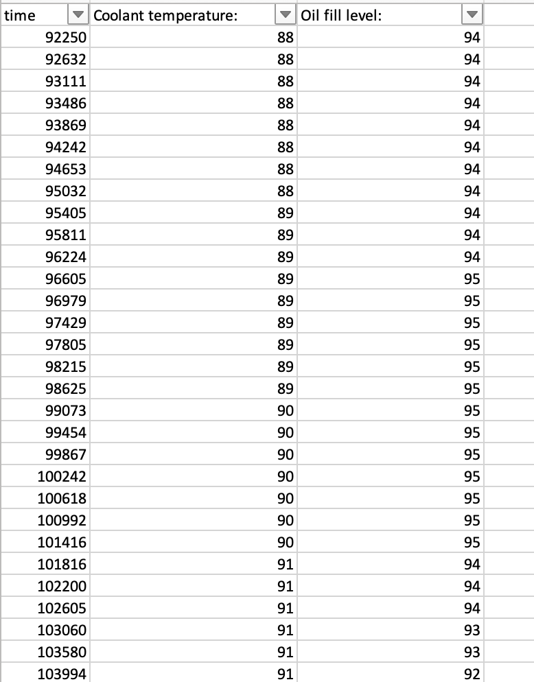

Following on from a thread the other day where @Damo H was talking about engine temps.
The analogue dials on my car go from zero to 90 very quickly and just stay there never move.
Looking through Live Data on OBD11 And i noticed a value called Coolant Temperature, this shows a much better value and does fluctuate so gives a better idea of what is going on.
I also discovered (and this I had not seen before) Oil Fill Level which appears to show how much oil is in the sump there are also values for min and max. I did some recording and the oil level changed a bit as I was throwing car round the corning or accelerating hard so another one I will add to my regular watches.
Reactions: Damo H
@LouG this is what i was referring to
Deleted member 103408
Example output
