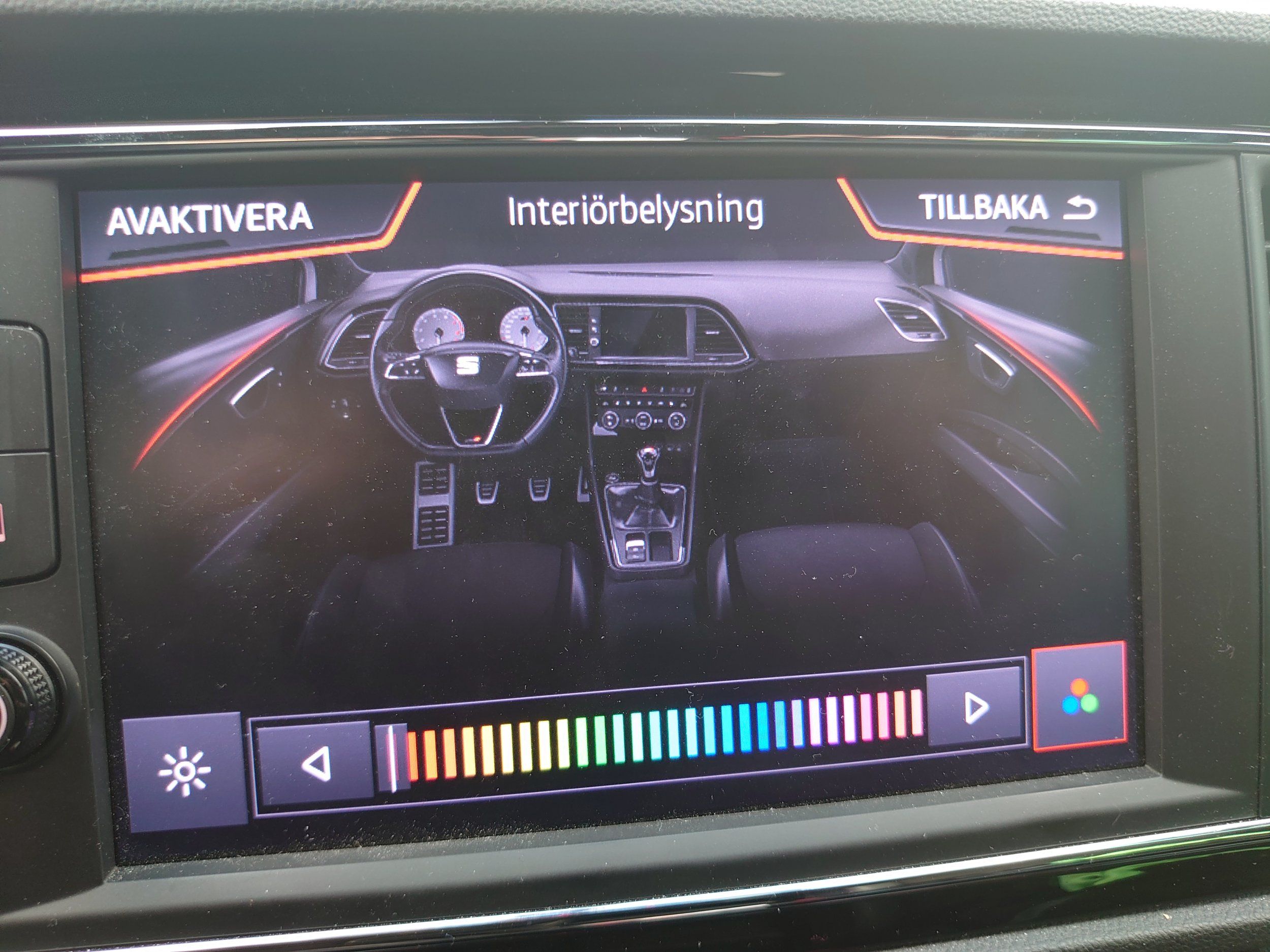

The colour is suppose to key into the ambient lighting if you have it on the newer firmware. If you cant change the ambient light colour and it's fixed then the colour matches the fixed ambient light and the ambient light matches the paint work. That's the general rule.
Mine had ambient lighting on my 2016 Ateca but the original firmware in the high unit didn't key the infotainments screen box colour to the ambient light, after a firmware update it took on the 2018 way of working.

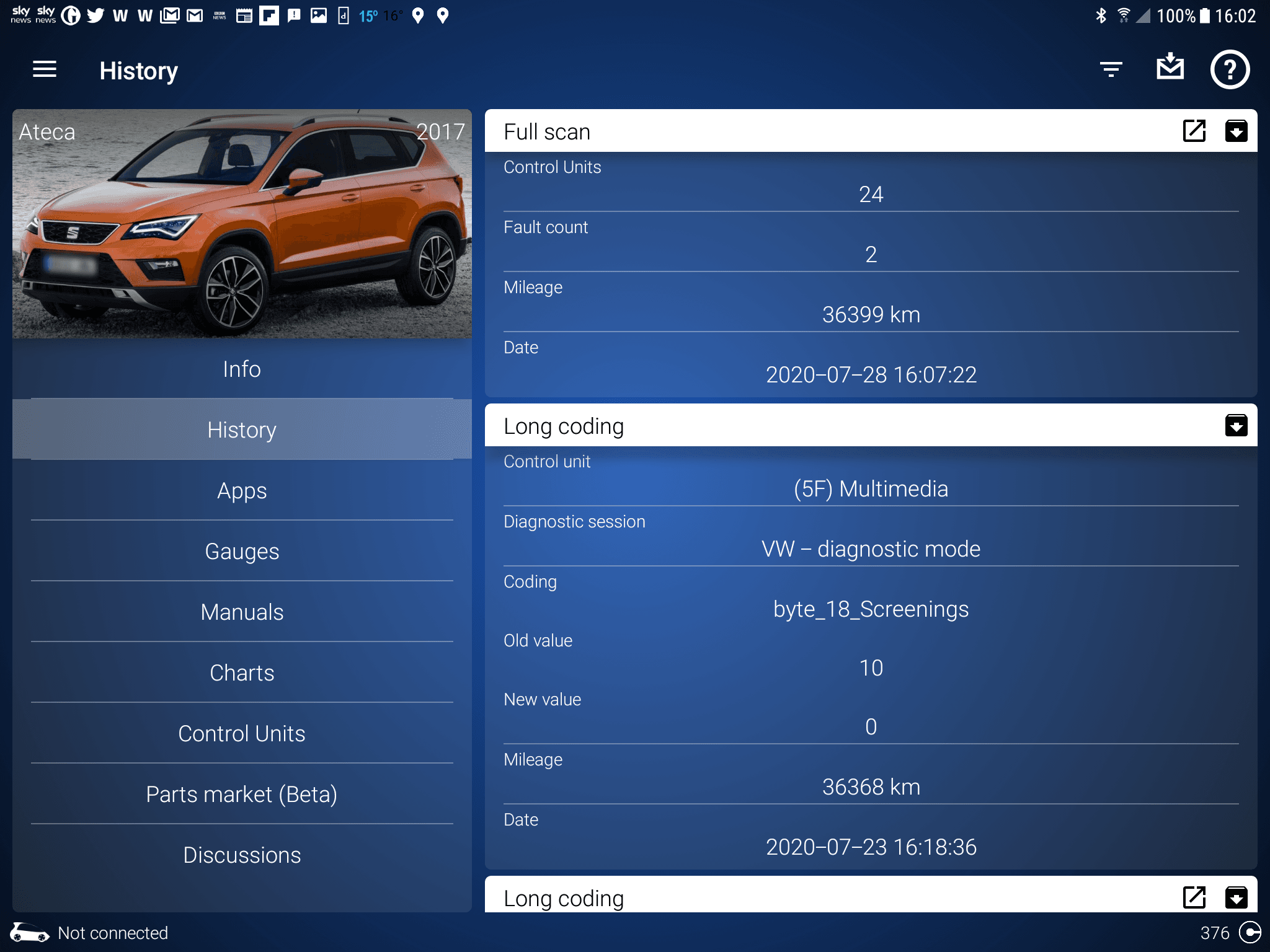

It's this one you do a full scan and then email to yourself (top icon area) the scan which shows original and all changes. That goes across the control unit. Do the same within the control unit and you just see the control unit.
A useful thing about Obdeleven is you can also study the screens without the dongle in, like this :love: . Gives you a complete log or you can pick elements out.
Shhh that top one is when I turned by Ateca into an Ateca Cupra... reverted it back thou to help resolve why standard infotainment units where not getting the correct Cupra car pictures. Plus unit I have. Gives the nice Cupra logo but to save myself looking like a smart charlie in the dealership reverted it back. 10 Cupra, 0 standard Ateca atleast in newer infotainment firmware. Will be the same for Leons I reckon.

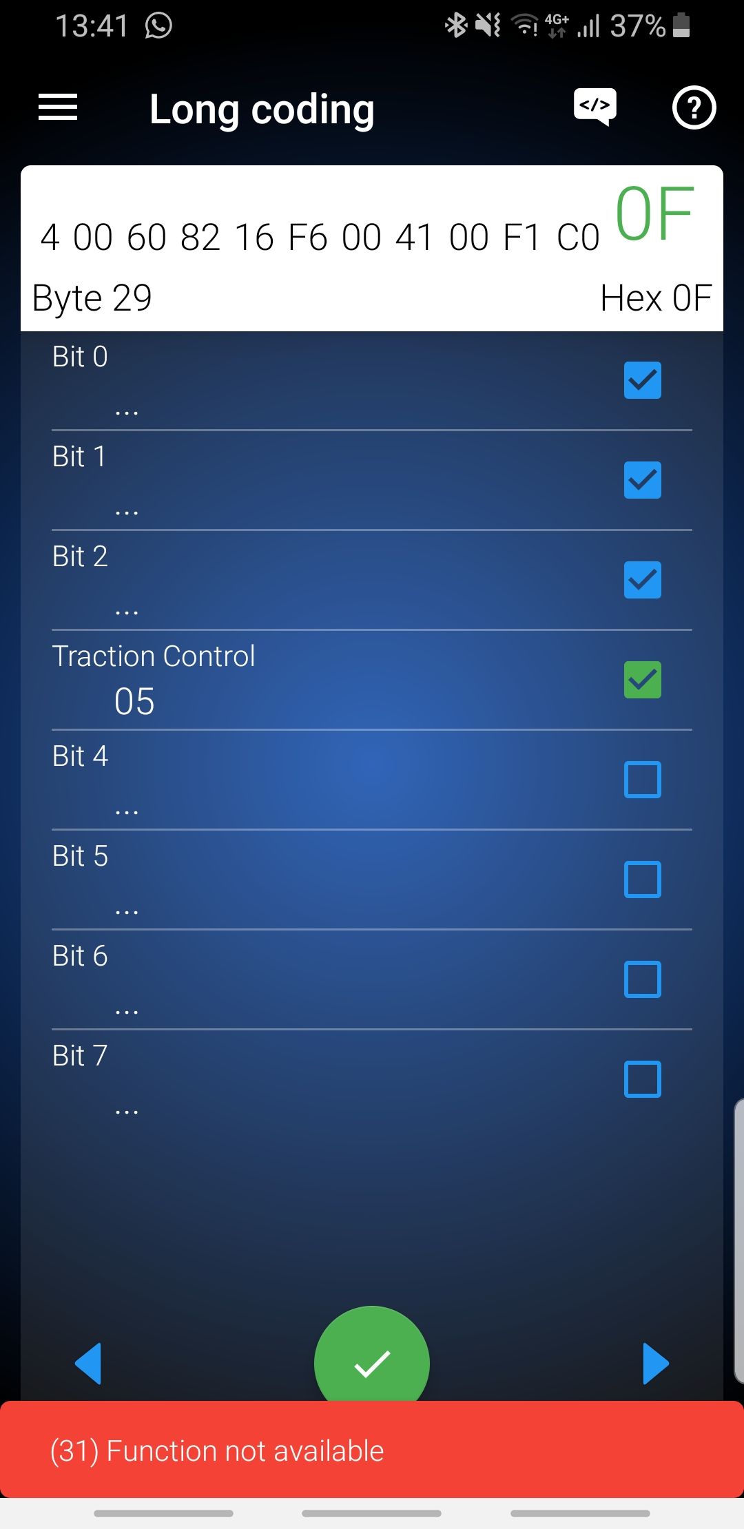

Hi guy and girls,
Been trying to work on the annoying power cutting, from the ESC / ASP. I've tried the app on obdeleven and I didnt notice any differences. Also still had the flashing warning sign and power cuts. I've now checked the below byte 29, and I cant seem to click traction control from 6 to 5. Wwhich I believe would turn it off. When I do this, it gives me error you can see in the picture. Any ideas how I can turn it off completely? Tia

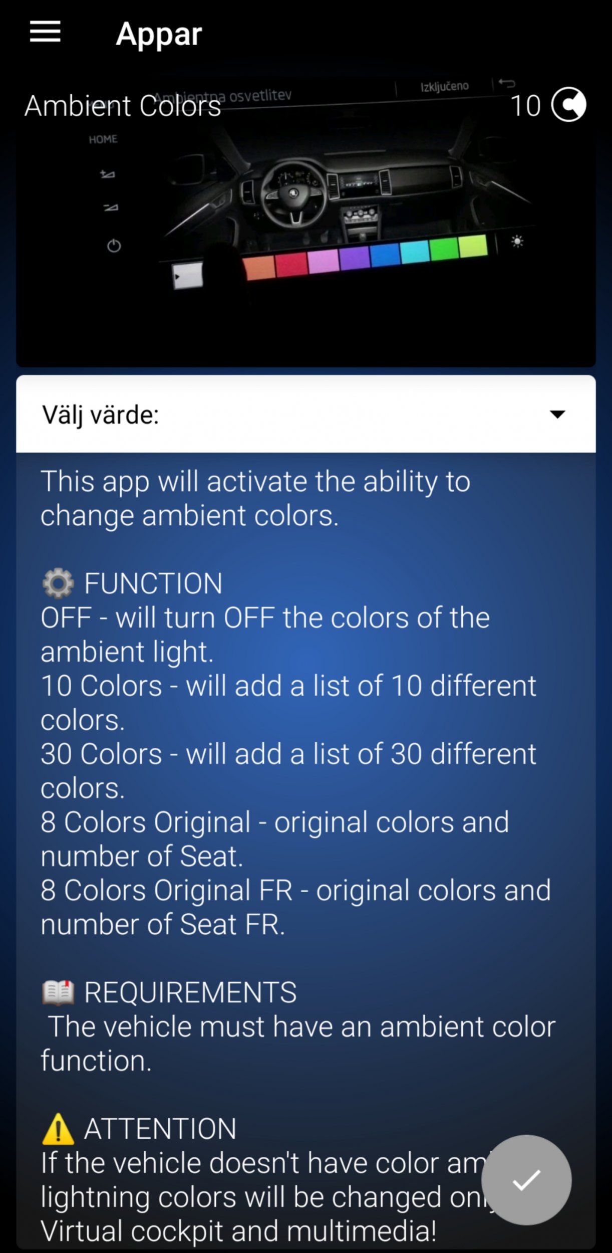

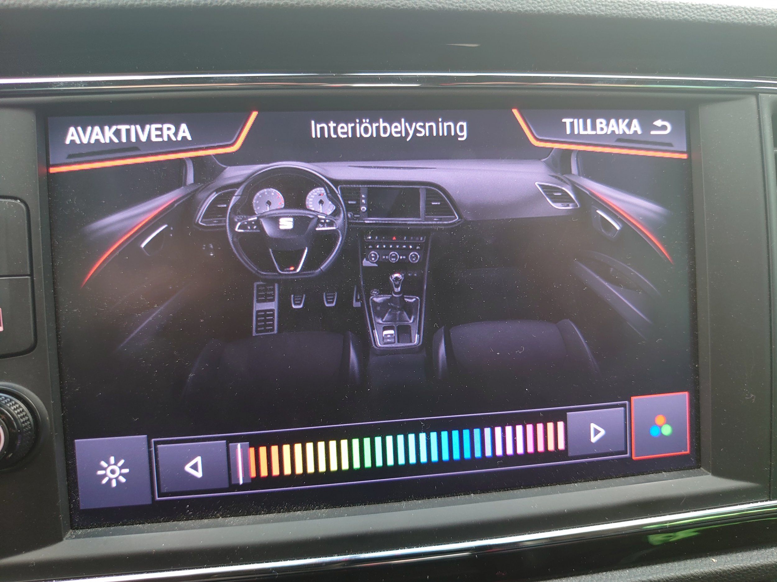

Hey just got my OBDEleven device. Sorry if this has been covered before, I did read back a few pages.
On my late 2019 Cupra it says "not supported" when trying to unlock more Ambient Colours. Is this normal? And if so, can more colours be unlocked using long coding with this device instead? Thanks!
It does say on that screen a requirement is to have the ambient colour function which I read to mean coloured ambient lighting. That is Ateca build code QQ9.
QQ9 VWGROUPLCP Interior ambient lighting, type 2
Type 1 is the non variable colour ambient light unit.
You need to check your build codes to see whether you have type 2.
If you have that type 2 unit it's not unheard of for the some of the built in apps not working. These apps will have been programmed from user identified mods. So that's a Google to find them. I must admit I've never had the urge to change from blue which I set mine too from the default palette in the car. Pretty sure you would have the type 2... just just want to change you pallet.
Google

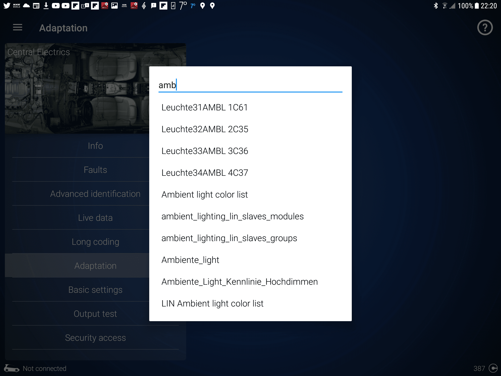

I see on the Obdeleven you also have some adaptions listed under central electrics. See attached. You might not need long coding if it's been brought out as an adaption defined by the menu settings:
Suggest you look at that in relation to what Google's throw up. Ambient light colour list sounds interesting. I'm off line so can't look at it, dongle not in. So whatever you find on the subject it can probably be adjusted on the ambient key word list, but be careful!.

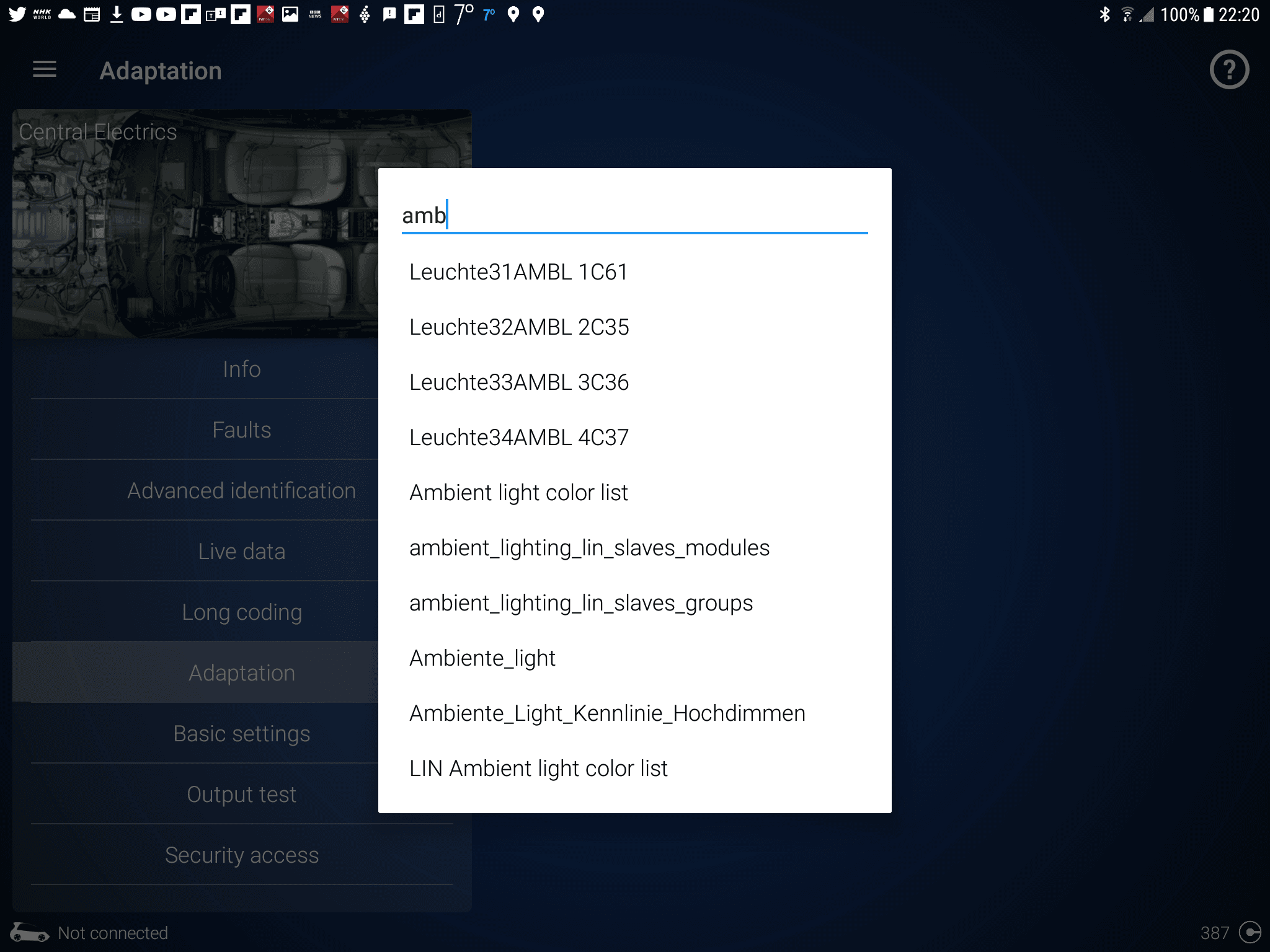

I'll check tomorrow, thanks :)
It worked now! I don't know if it was for this reason but I did a full scan first and cleared error codes then tried to code it and it worked on the second try.
Kids will be happy now. Thanks for your help :)
Reactions: bigbadjay and Tell
They like a full scan before edits. Recently the dongle likes to do an update as well. The original white one... so you get a period when it doesn't connect. Then get the dongle software update, then all is fine.
