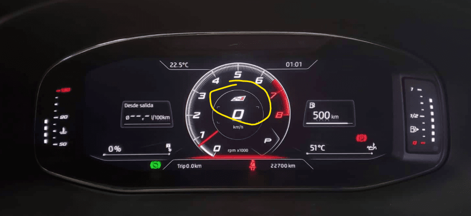

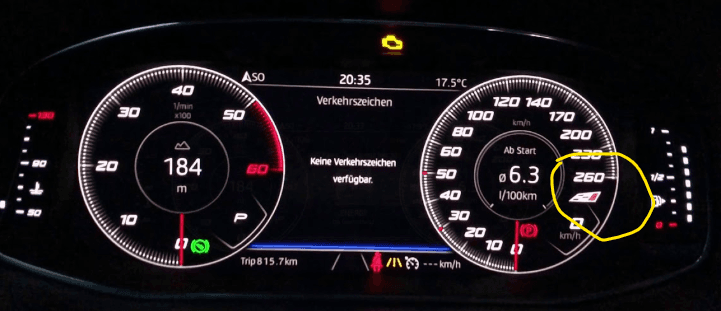

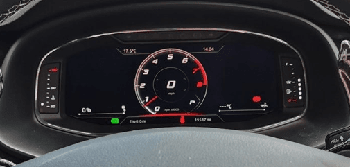

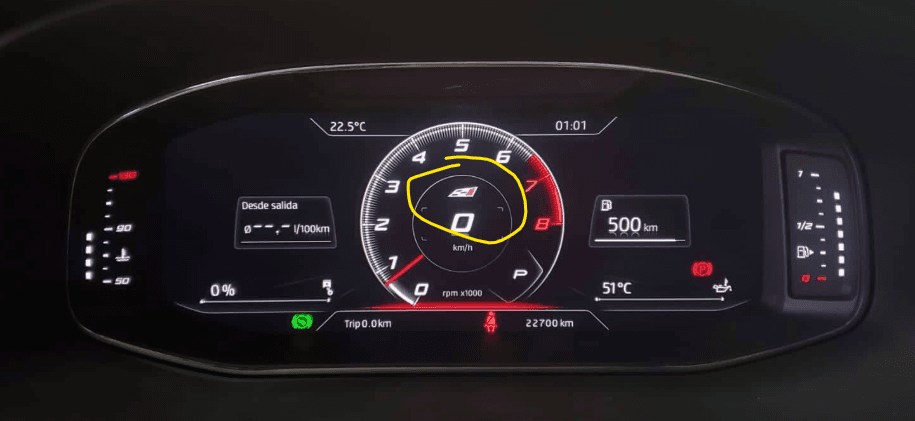

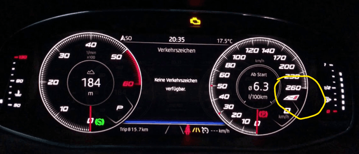

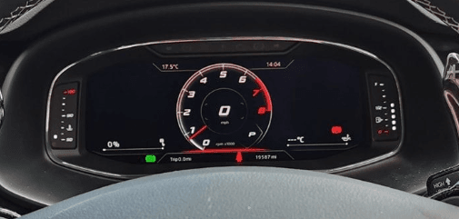

Asked this in the VCDS thread, but at the risk of post duplication it just as well be asked here instead...
Has anyone with VCDS looked at the enabling the sport mode on the Virtual Cockpit and added the Cupra Flag?
Recently got my VC updated to the newer Rev A unit, but the Cupra flag was missing. Wondering if anyone knows a way of adding it:
Original:
My new Rev A unit now, only photo I have, but missing from all the views.
Other VC:
Actual Cupra:
FR Diesel:
So I'm assuming there must be a way of adding it, its whether its in VCDS/OBD11 or buried somewhere in ODIS.

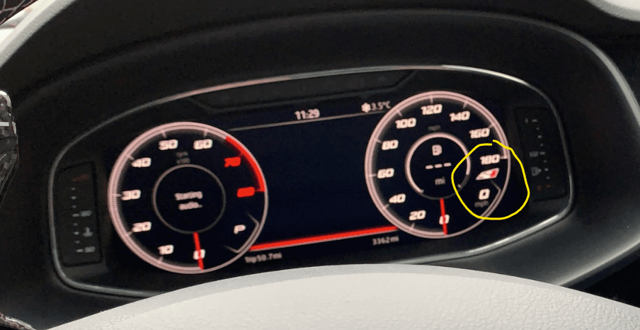

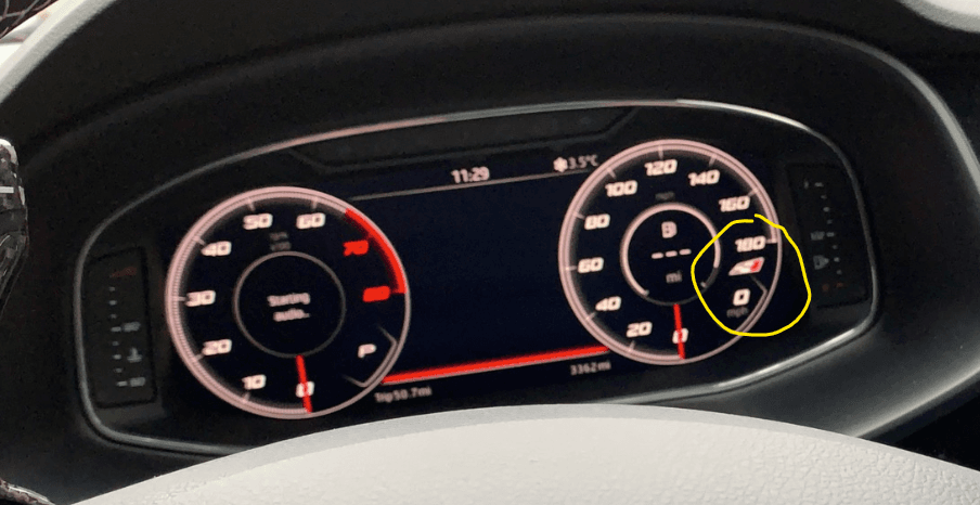

Not sure if I’m going insane, as I can’t find it.
But didn’t someone work out how to change the VC to show the 300kph/180mph speedo. My previous VC showed 300kph/180mph, but my new Rev A unit is only showing 160mph. Not that bothered as never doing that speed anyway, but wondering if it may solve the missing Cupra flag too.
Mr Pig
Jun 17, 2015
2,910
1,089
You could try looking here. Mind you this is for the pre-facelift cars.
I can confirm that this works on the facelift car as well. Thank you.
I also noticed that you have the option to check a box saying stop/start not installed. That might be another option?
