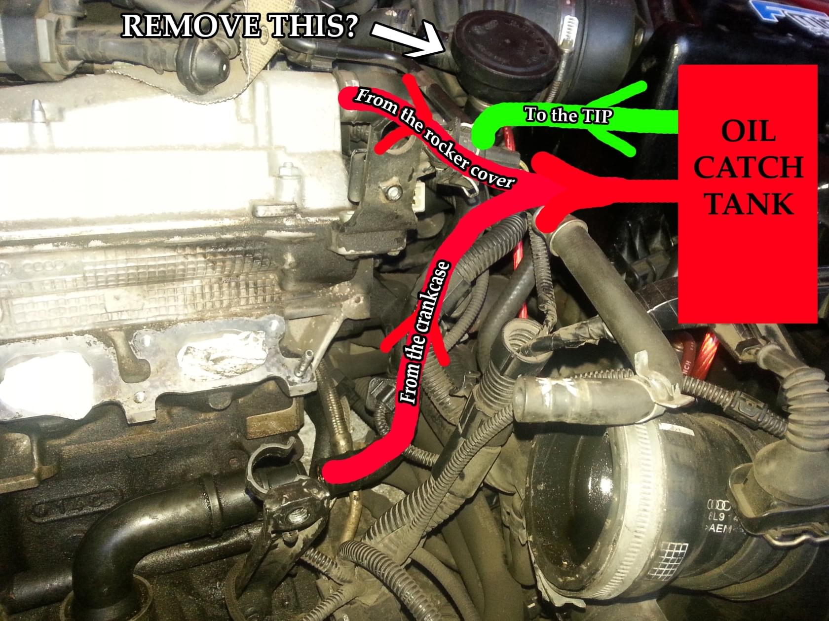

Excuse me, but I have a problem. Everything is on the picture below:
Is that will be a proper installation of a catch tank? Must I remove this "mushroom-shape", black part?

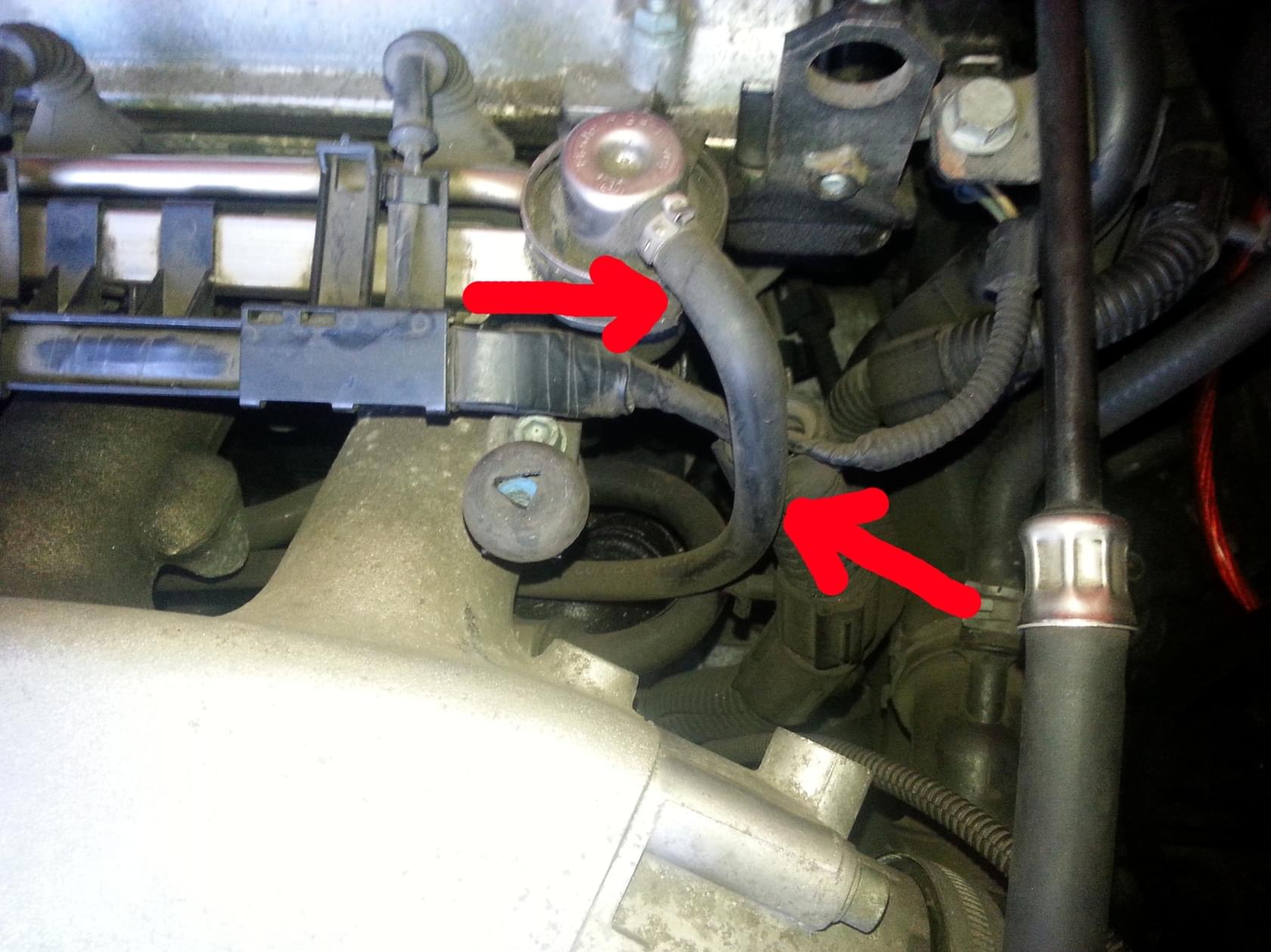

And secont question: is the hose in the picture below is the vacuum hose? Can it be replaced by a standard, silicon vacuum hose?

Yea you can remove the vacume hose, I ended up replacing it for silicone hose when I done the n249 bypass,
As for the breather pipes,, Iv gone closed circuit, and connected my catch tank outlet pipe back in the intake via the hockey puc/ mushroom,,
The mushroom is still on my engine as it has a fine mesh filter inside to catch all the crap going back in the engine, I replace the mushroom every year when servicing,
