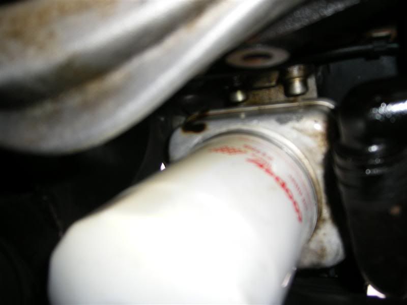

Only place I could see oil coming from is the housing where the oil filter attaches

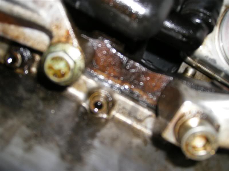

from further inspection think i've found the route the oil has been taking
Oil in the car is full, and its the only place that I could see any signs of a leak.
Can it really be coming from here??

Yeah can see the top of the filter housing but can't see anything untoward. The housing is in two pieces, and it seems that its leaking from between the two parts.
Am I missing a seal, causing the leak.

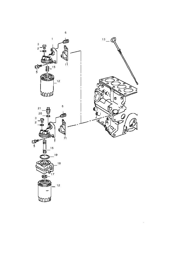

After poncing about for the best part of 2 hours have found that I have a leak at the seal (no 19 on the diagram) and I do actually have a leak at the oil pressure sender (number 21 - thanks for the heads up jenk). Can't understand why I hadn't spotted it before, but the more I ran the car the worse it has become.
