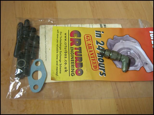

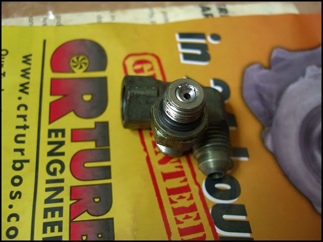

thanks Bill, I called them earlier, but they were struglling to understand what size restrictor I would need as they said they need the turbo in hand....
just searched the house and car from top to bottom, but can't find it anywhere:cry::(
going to send them these pics tomorrow, and hopefully they might be able to help out a little more
