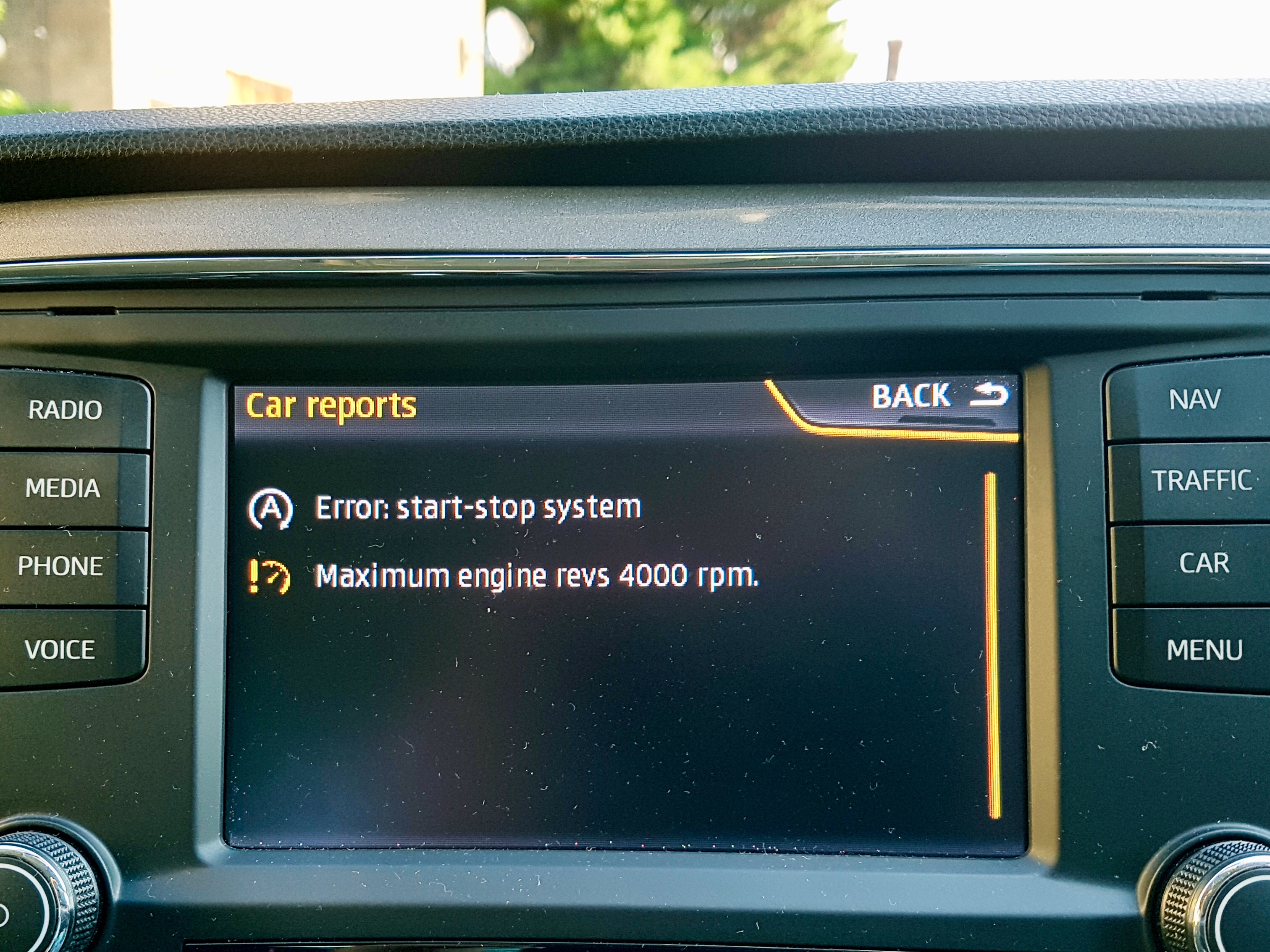

My 2013 Leon 1.8 FR engine light came on within 100m from a cold start one morning. When checking the codes it had the following single code.
15462 - Control Circuit for Coolant Bypass Valve
P2681 00 [175] - Open Circuit
After checking for a loose connector and clearing the fault it didn't return on a later test drive. I put this down to VAG cars being fussy as all VAG cars I've had have random sensor circuit glitches. The next day we tentatively drove 330 miles on holiday. No problem at all.
The following day the engine light came on again on start. Assuming it to be the same glitch, we drove a short distance. Not in limp mode and engine running fine. We stopped for a short walk and then restarting the car the engine light still on but accompanied by the EPC light and a warning on the display saying engine performance limited to 4000rpm. I took this to be proper limp mode and decided as in the middle of nowhere to limp back to the holiday house to read the codes/find a garage etc. However by the time we had reached the bottom of the hill after coasting down the engine temp was above 1/2 way which is not normal.
