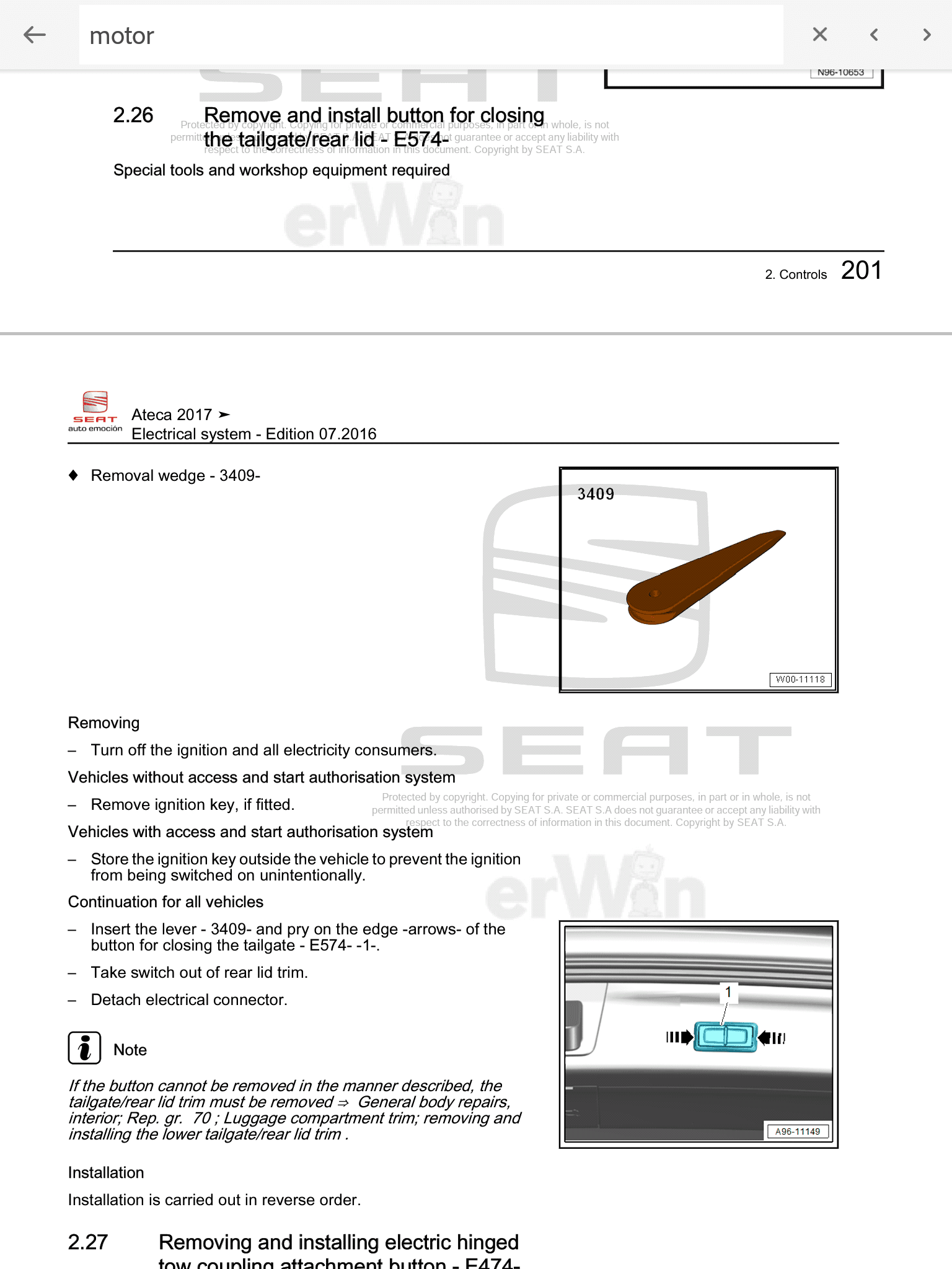

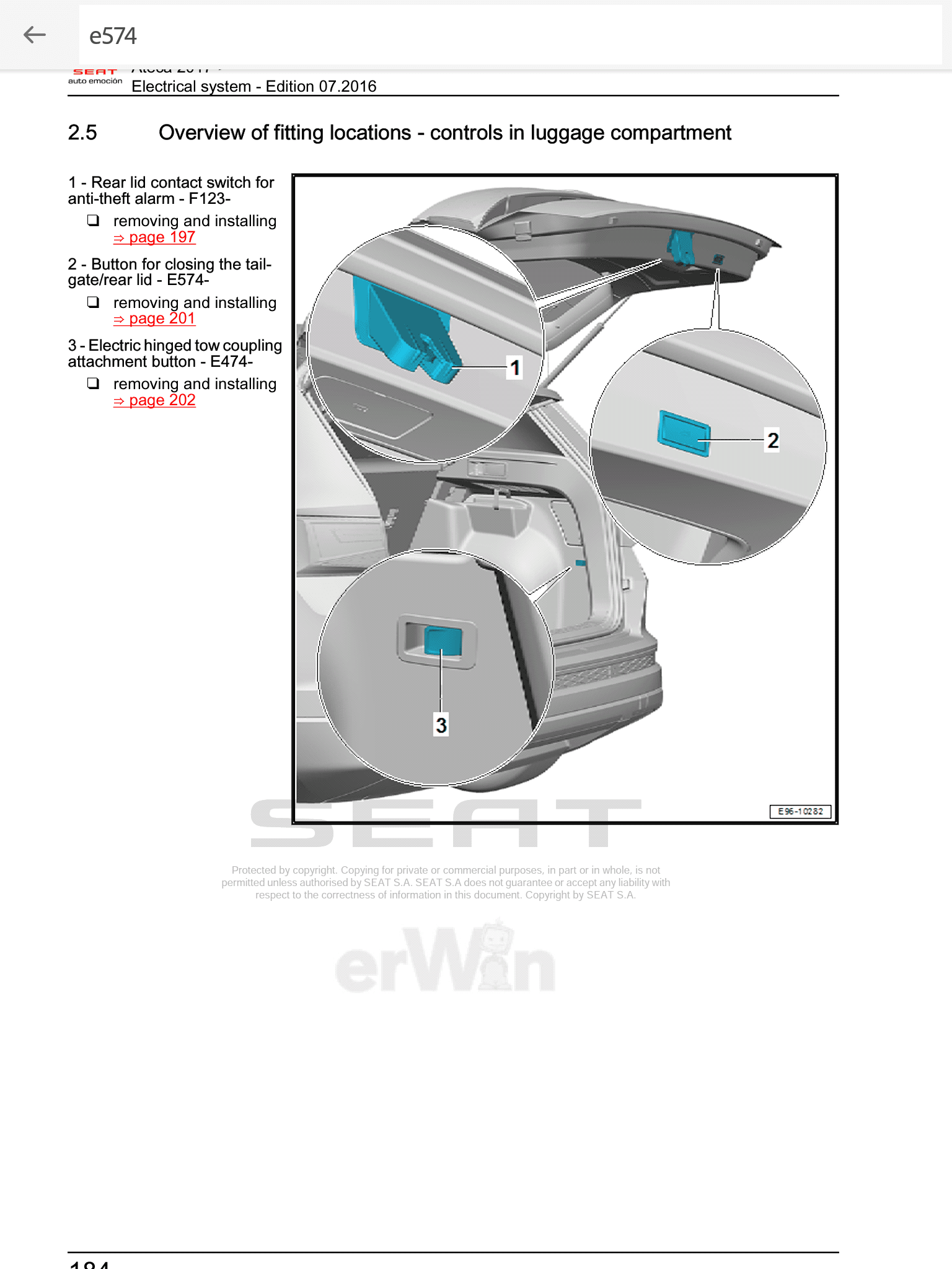

There is indeed on the right if you prefer not to wiggle your foot if you have the virtual peddle / don't have your keys on you. That button must be just a standard part between the Karoq etc.

"E574" for your Google's. Presume that's the switch designation. Pages from the Erwin Ateca electrical system manual.
