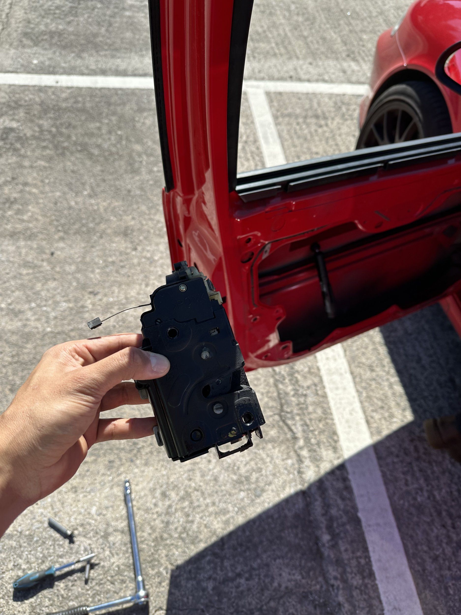

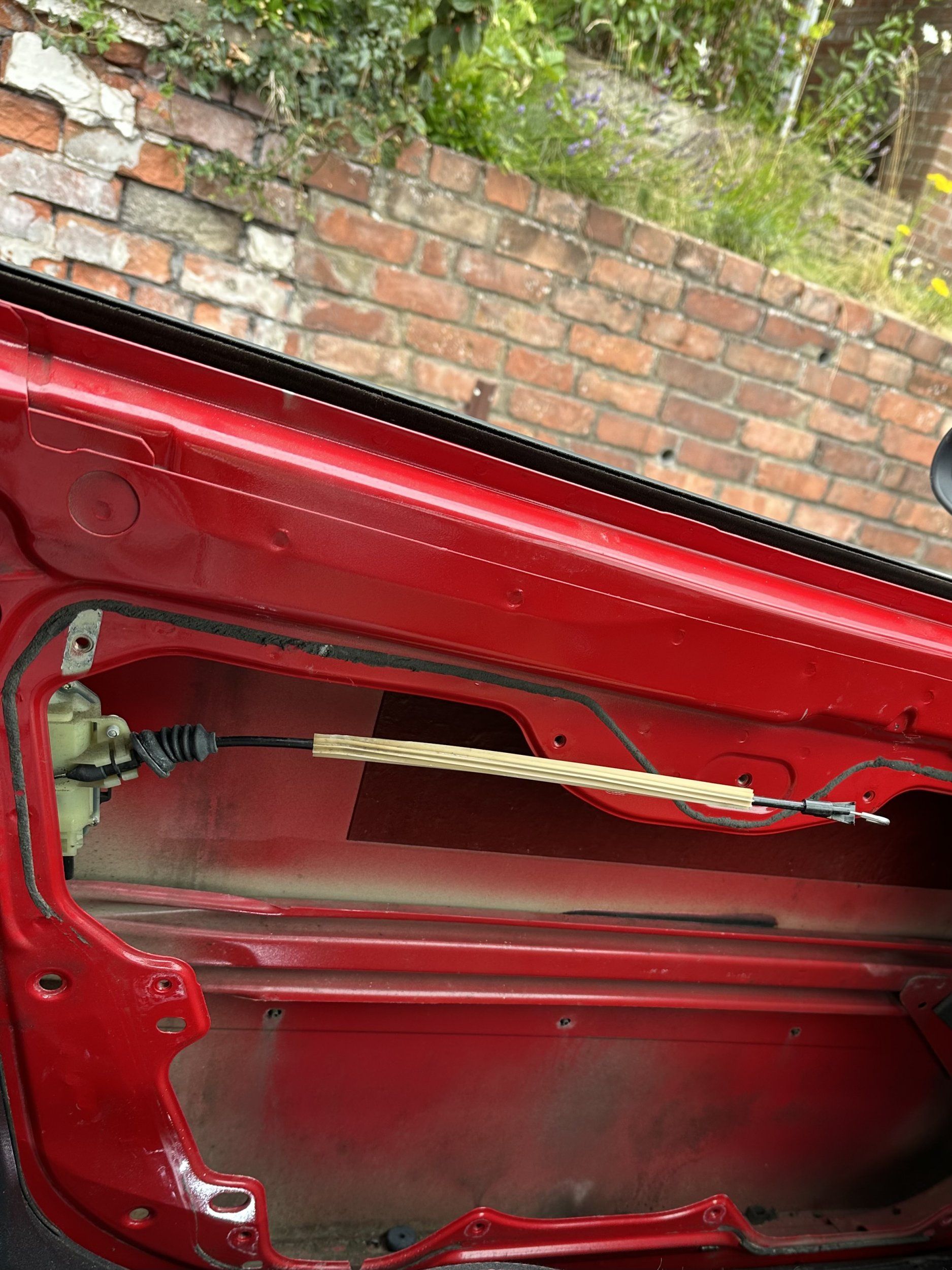

After much grief and searching forums on how to open my door with the locking mechanism unreactive to anything I try, how in the case I am in would I get my door open?
I have removed basically everything (see pictures) from the door and now the only things attached are literally the locking mech and the actual door. I have tried penetrant spray to see if there was moisture trapped as this has worked on other electrical items before but no luck.
The door does not open when the cable is pulled from the inside and handle from the outside simultaneously, and pushing the tabs that the cable push on to beyond the fully open position does nothing.
Short of destroying the door I have no clue what comes next in terms of attempts to open it. Apart from paying a real man to do it ofcourse.

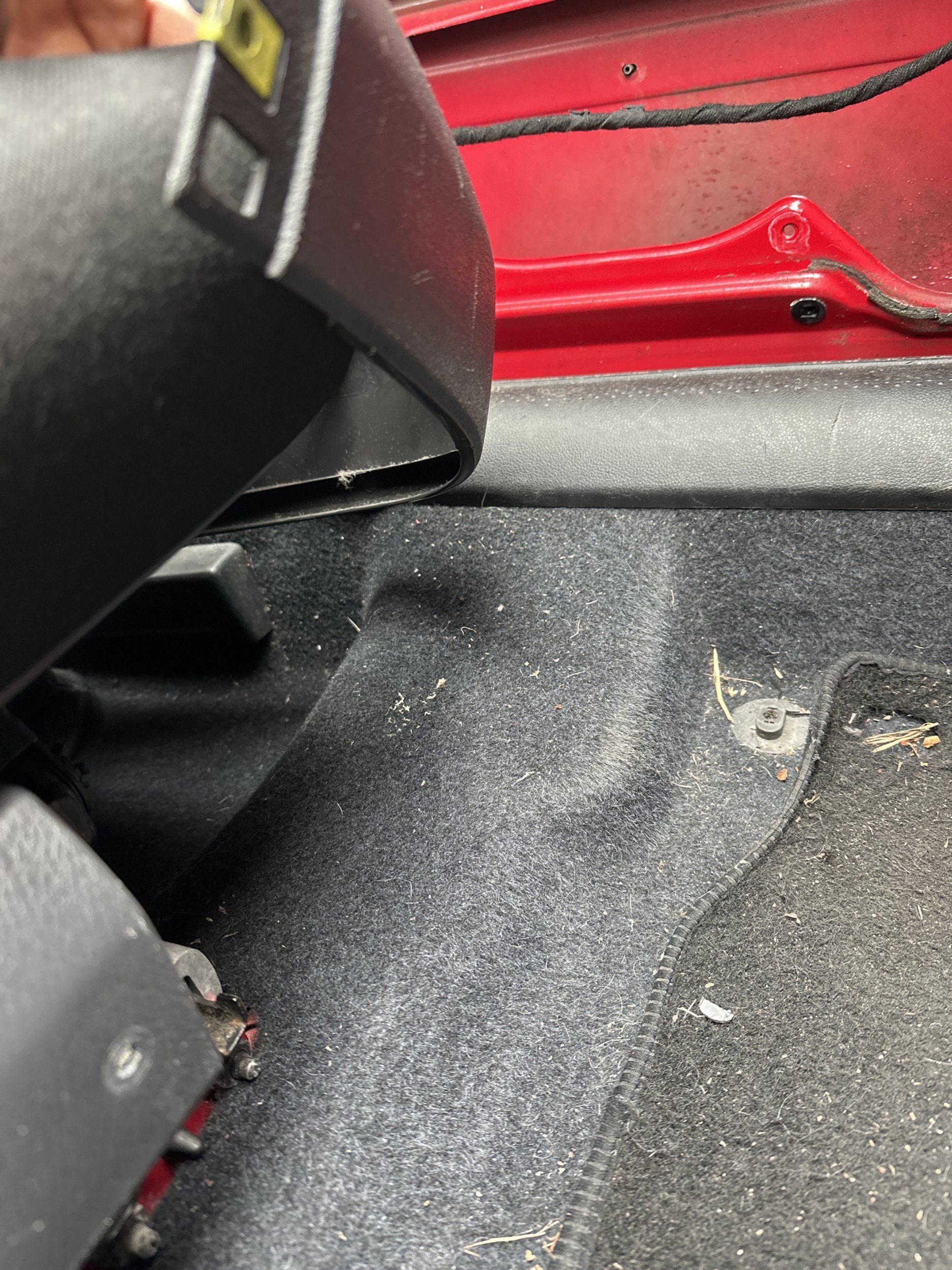

No, mine is the front too. I used a torx bit on a little screwdriver extention. See pics and you’ll see I removed the plastic and bent it up allowing space to get to the second torx screw
I can't even make sense of what you have done here haha ? grinder it is
Haha I figured it out lol took the trim bit off the bottom yeah, how many screws need taking out I can feel 2 lol?
Yeah it’s two, you can see them if you shine a light, bare in mind I put the seat back all the way and reclined it all the way, led upside down so I could get my head as close to the floor as possible

So the lock wouldn’t move with any of this pushing and pulling, and it wouldn’t unlock or lock or even make a sound when plugged in.
After spraying it with water displacer it started moving with the key lock and open buttons while plugged in so then after much pulling and pushing and button mashing managed to finally open the door! Buzzing!
So I replaced the lock mech and closed the door expecting it to open again, then stuck back to square 1. The door is jammed shut again, luckily this new lock was in better condition so didn’t take as long to pull/push/button mash open.

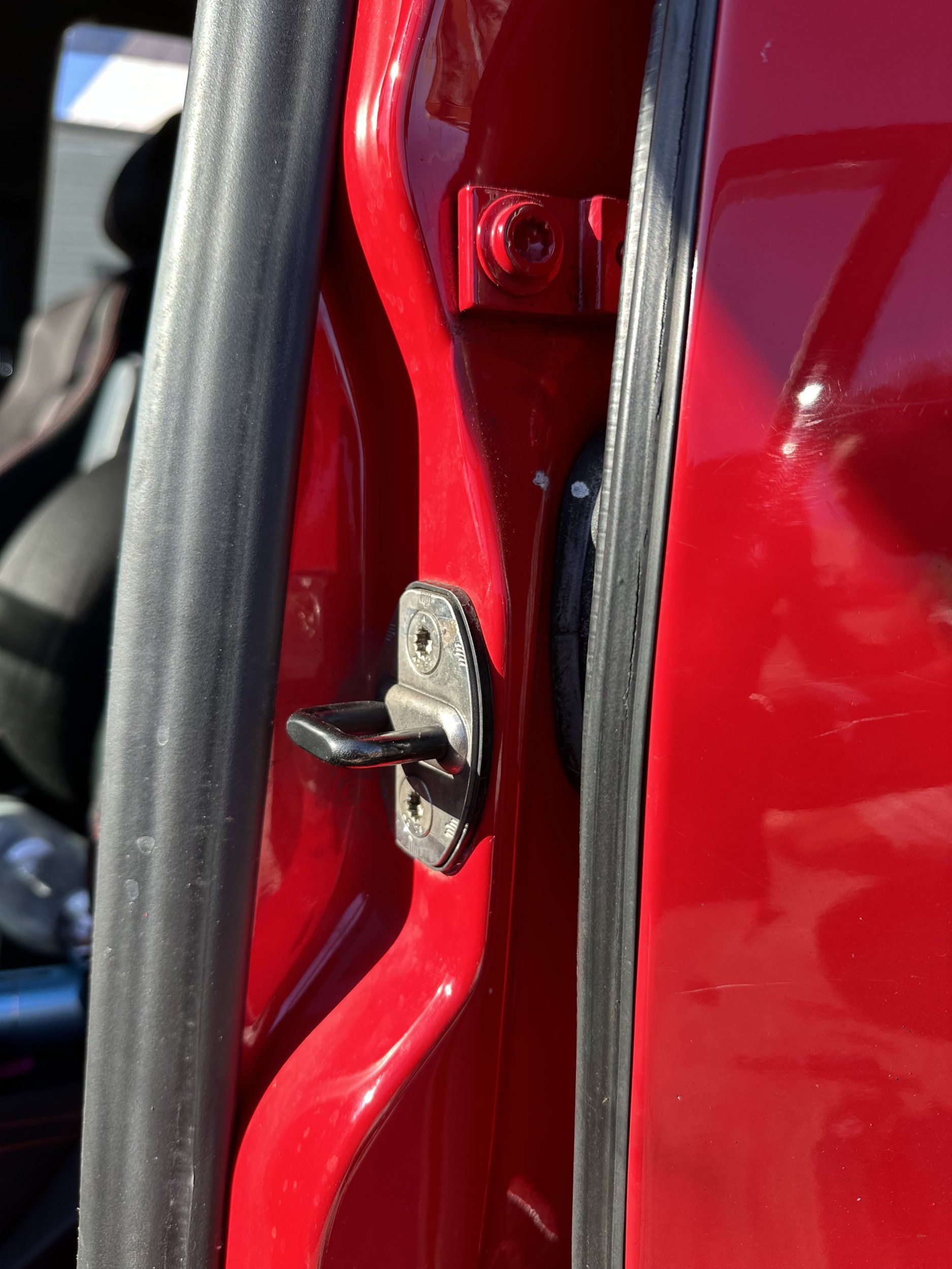

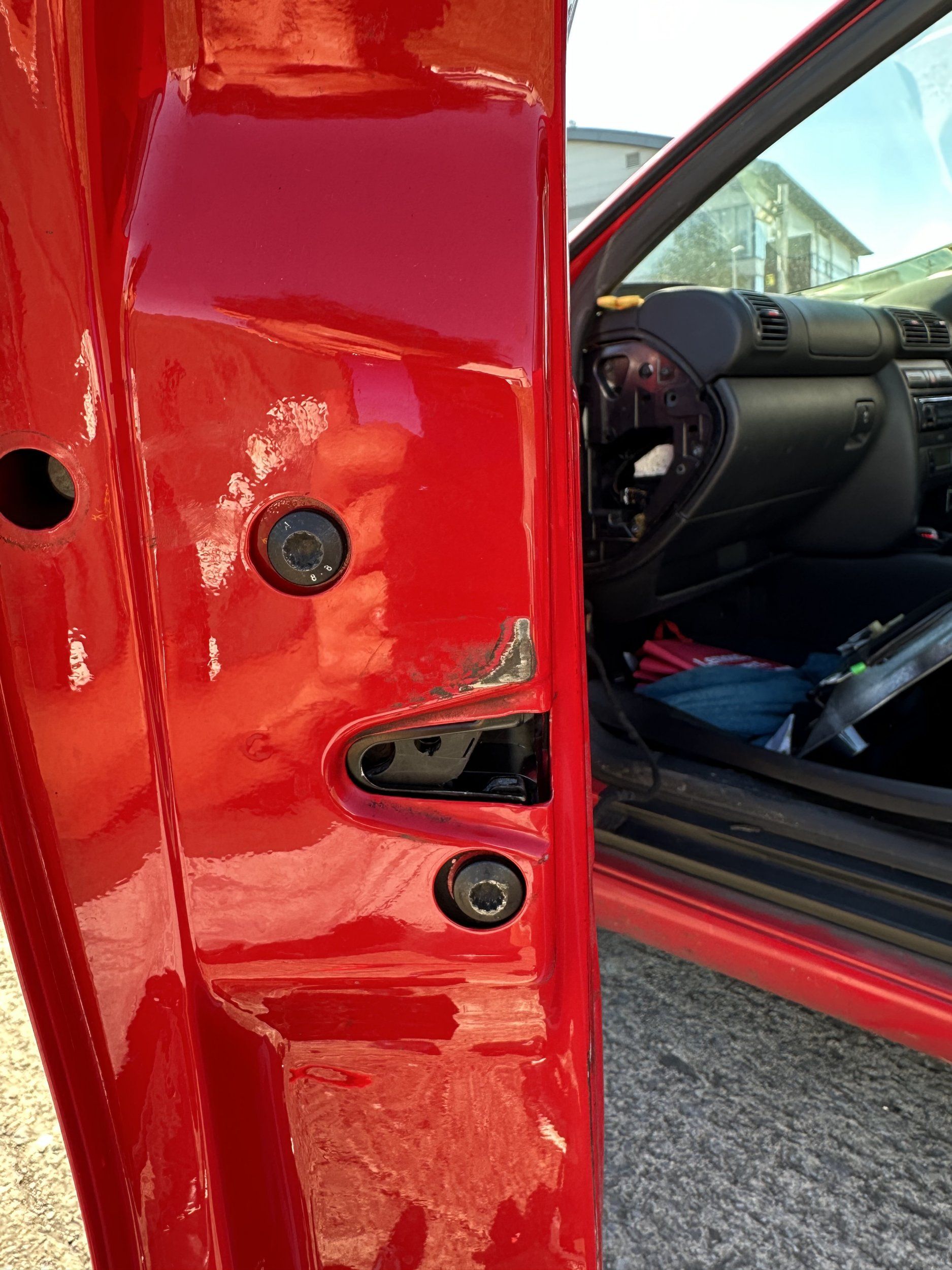

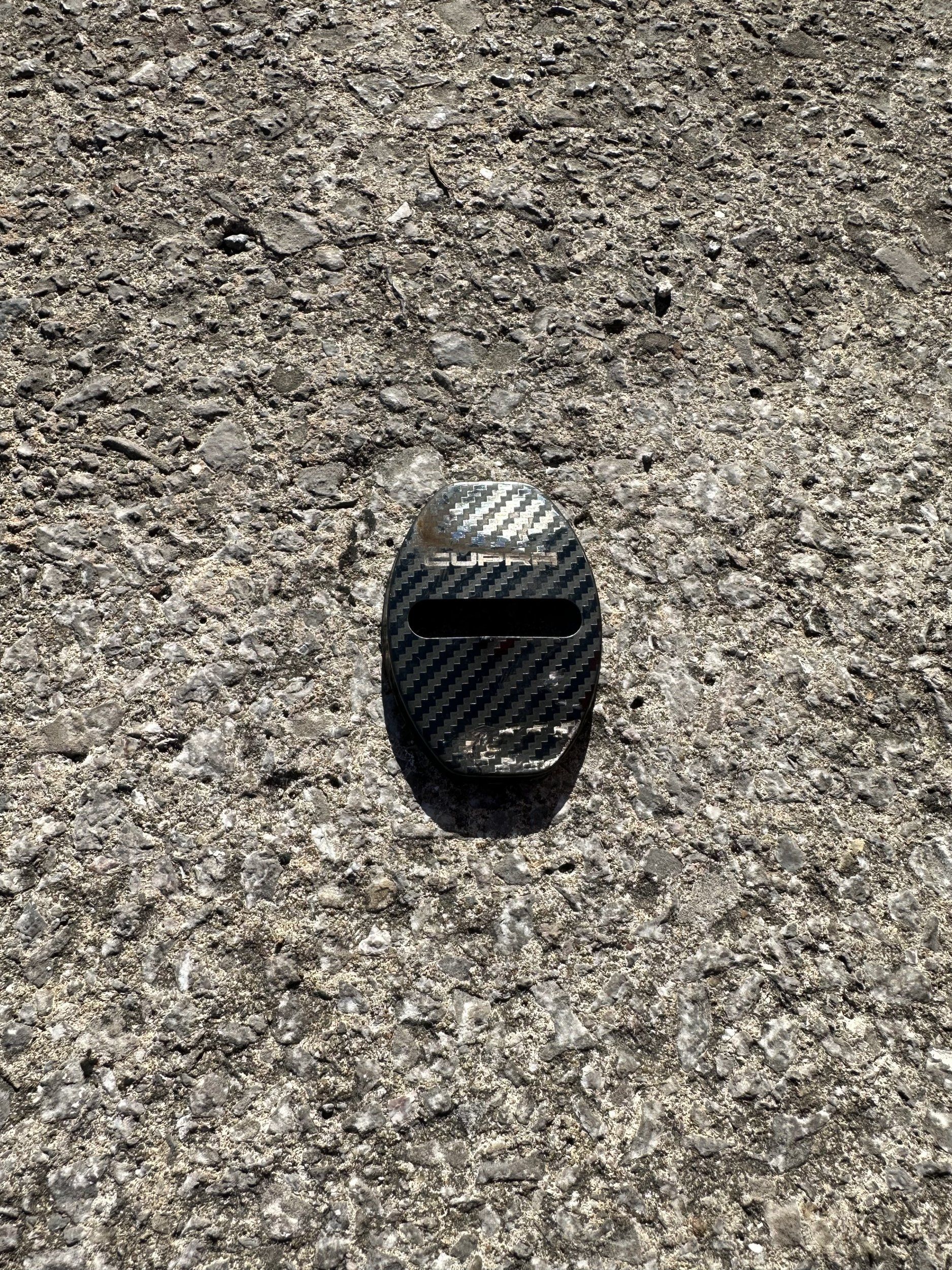

Turns out the door was being restricted by a small metal plate over the ring that the mech latches onto, rubbing against the door and stopping the mech from operating correctly -
So after removing this metal plate all was well, opened and closed like a dream! I am frustrated but happy that it costed only £24 in parts I didn’t really need, instead of £500.
