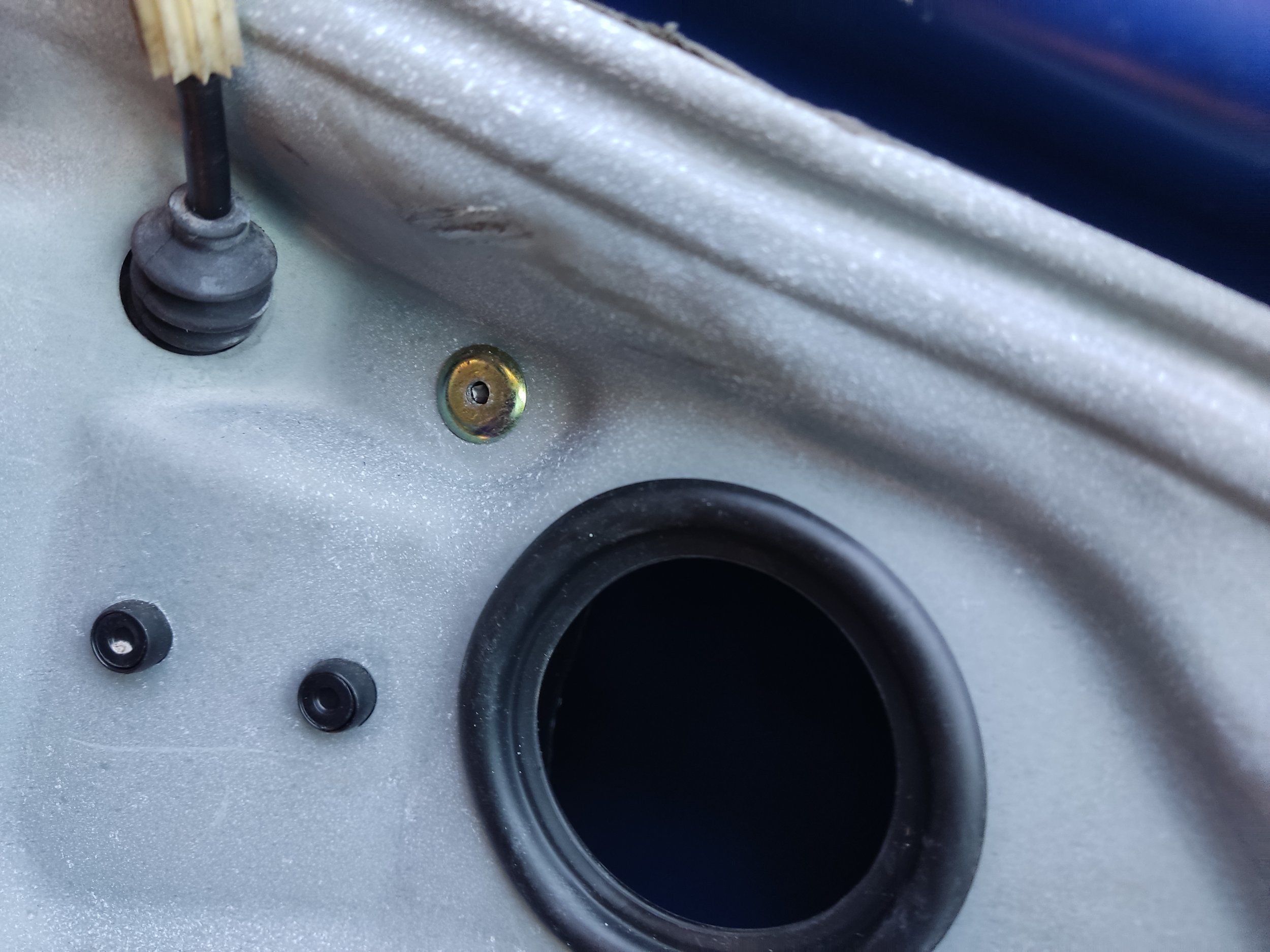

Cannot seem to disconnect this gold pin that is holding the panel on to something behind...
I also sealed around the door edge due to leaks and flooded footwell which has made it a little more annoying a job...

I got it out didn't need to detach it was the sticky stuff all around the panel that was the problem will have to reseal again once I'm done

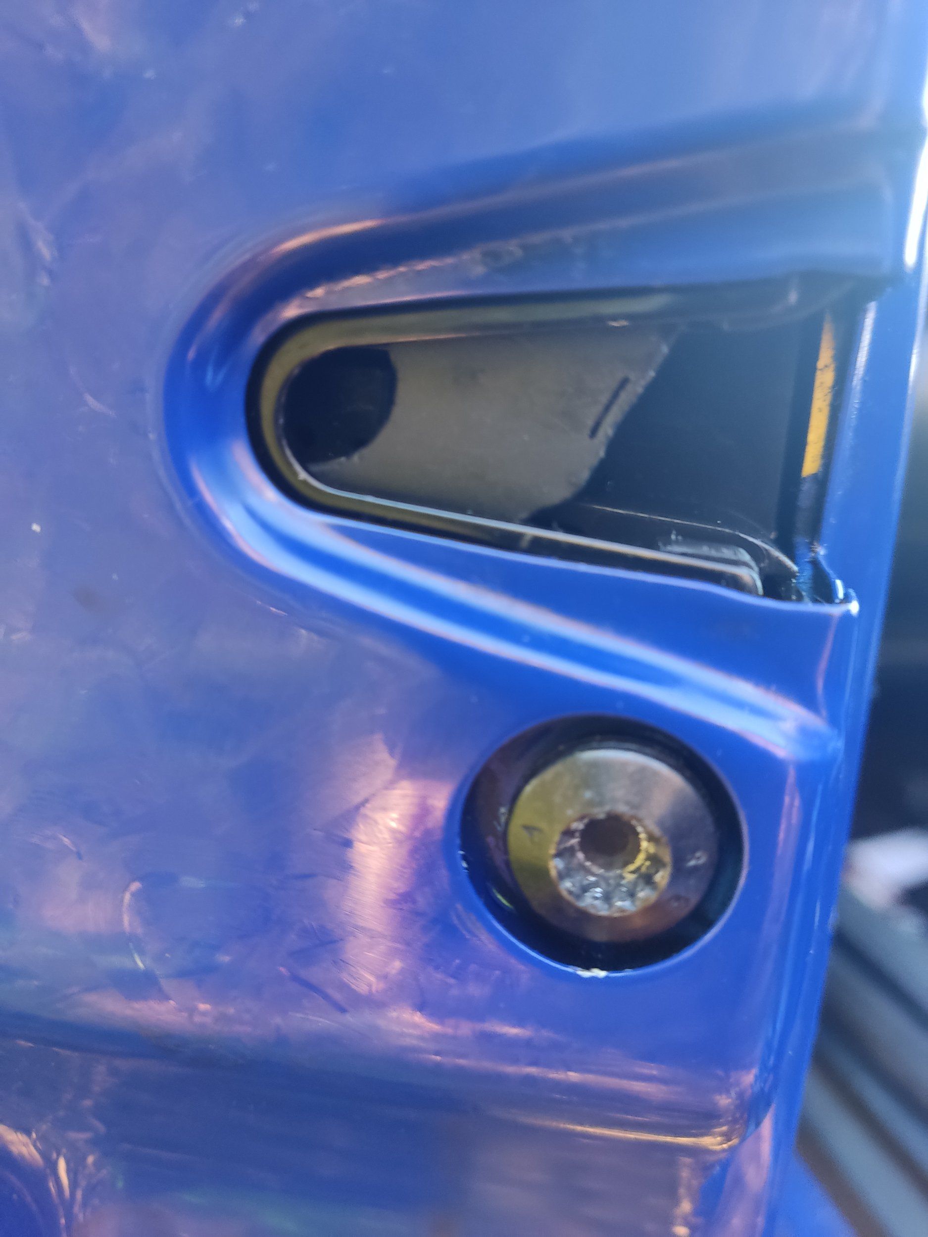

So I have replaced the actuator and now I have the opposite problem the car door won't close unless I fiddle with the catch a bit and slam it a few times...
This is how it looks I have to slam and hold it a few times to get it to shut it seems looser than the other doors and the latch seems to sit lower than the others, not sure how I can change the alignment? Do I have to get it all out again (please no!) Could it be a fault actuator? Could i stick something in there to stiffen it up and make it stay shut?
have u tightened the bolt back up that holds in the door lock blank, (its on the edge of the door skin) i forgot this part and it was fowling on actuator mechanism and the door would just bounce back..
I tightened as much as would go but just seemed to spin at the same torque
does it look like the bolt is fully in
I think we may be talking about different bolts? Not sure what you mean by edge of door skin I was talking about the small Torx bolt you access from under the cap (not shown in the picture?) If we are then given the amount of torque necessary it is definitely in just strange that it never stops turning...
