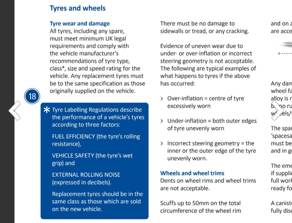

It's with VWFS who apparently use the BVRLA guide. This is the wording - it says "to the same specification" so I think so long as I could get some with the same rating etc. as the Bridgestones which come on it, I'd be good??

Yes, I’d assume that if the tyres have to be of the same class as those originally on the vehicle and have the same (or better?) Fuel Efficiency rating, Vehicle Safety (wet grip) rating and External Noise rating as the Bridgestones on your car you should be OK. However, you may find budget tyres are rated lower for grip as many economy (Chinese manufactured) tyres are referred to as ‘ditchfinders’ and that’s not without good reason (Autogreen is Chinese tyre brand). So you may find you’ll need to spend more than £140 for two replacement tyres to meet VWFS tyre rating requirements.

Yeah that's a good point - it all depends on whether I can get a new car from stock or not - if I can avoid a factory order then I'll get rid immediately. The annoying doesn't say what it means by "class" unfortunately ?. I'm assuming it's efficiency, grip and noise.
