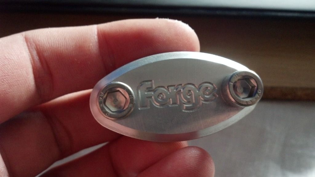

In preparation for this weekend's removal if the SAI
Pew.
Mar 23, 2012
1,436
138
Scotland
When i start my car from cold and the secondary air pump kicks in (during choke) it sounds like a Dyson hoover, i've tried re-sealing the pump but it didnt work and im not buying a new one at a £300 cost.
No benefit of removing it except the noise goes away when i start it from cold. I believe the pump is simply there to heat the cat up quicker during choke to reduce emissions or something.
