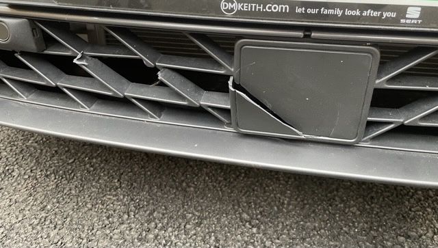

Hey Guys - unfortunately I hit a pheasant yesterday, the bloody thing just ran out in front of me leaving me with no time to react! It has cracked the lower grill and plastic square box, which presumably houses the 'front assist' sensor. Gutted, as the car isn't even a month old yet! Fortunately the damage appears isolated to the picture - no body / paint work damage, I am getting warning signs on the dash for 'impaired front assist sensor' and also now 'proactive occupant protection system restricted'. I will phone my local dealer tomorrow and see if I can get it looked and the grill replaced...
Has anyone experienced a similar issue / has any thoughts on what this could cost? It does appear that the plastic grill can be separated from the bumper so I am hoping it won't set me back too much...

Just to note that I think as mentioned in another similar post, it's not just a case of getting the part replaced; it needs to be recalibrated

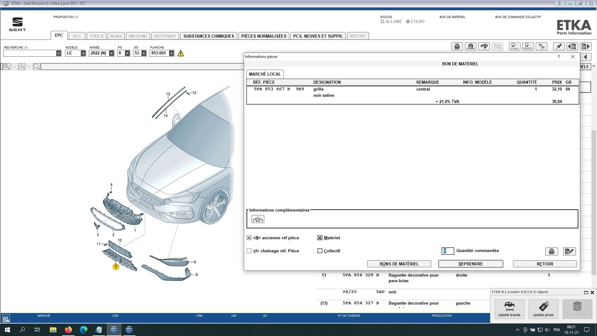

Update - took it to the dealer today; unfortunately the radar sensor needs replacing and therefore would need calibrating, costs ~£350 +VAT, also a small crack to a section of the bumper under the number plate (I didn't even notice it), which apparently comes pre painted and is £99, then the actual plastic grill is only £25! All in all, with labour costs looking at £900...
