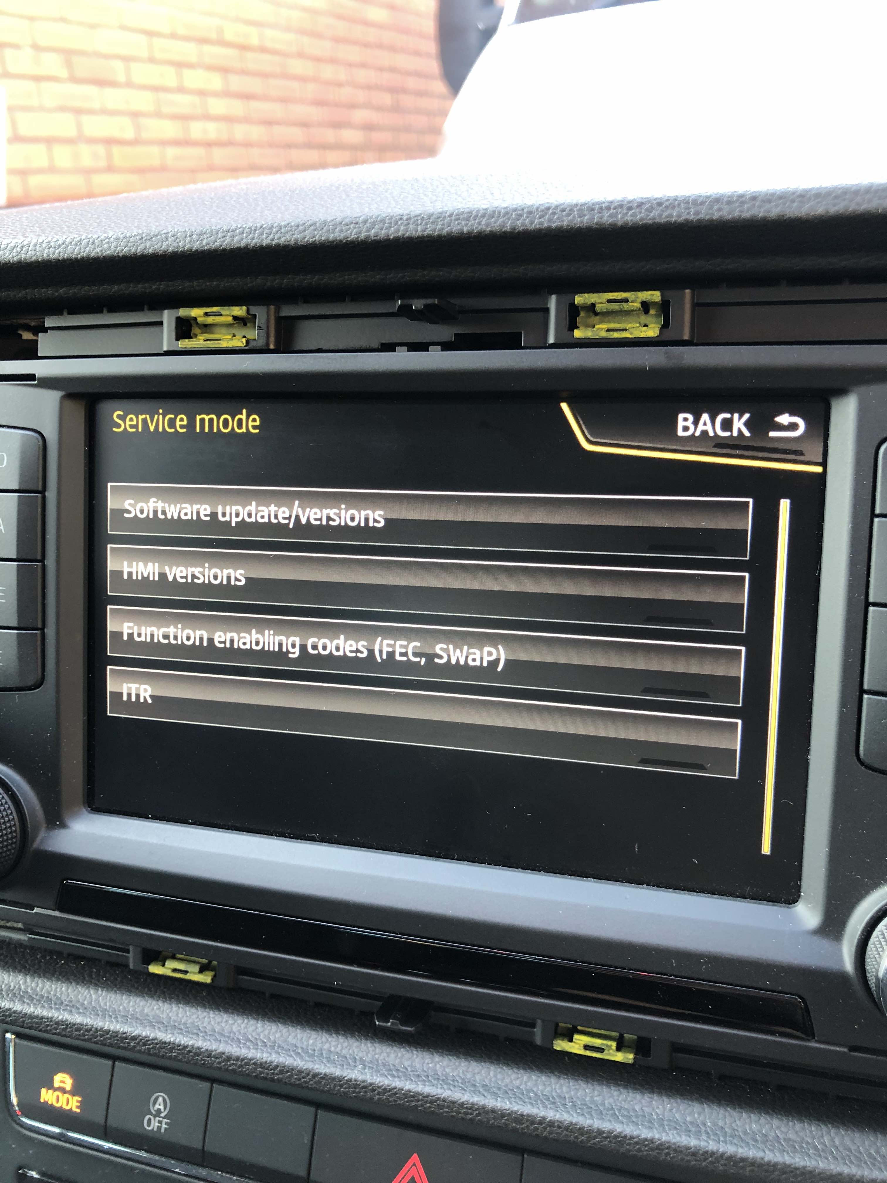

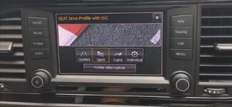

If you looooonnnngggggg!!! press menu button what options do you get ? Take a pic and post
Sent from my SM-G975F using Tapatalk
Pitch590
May 5, 2018
17

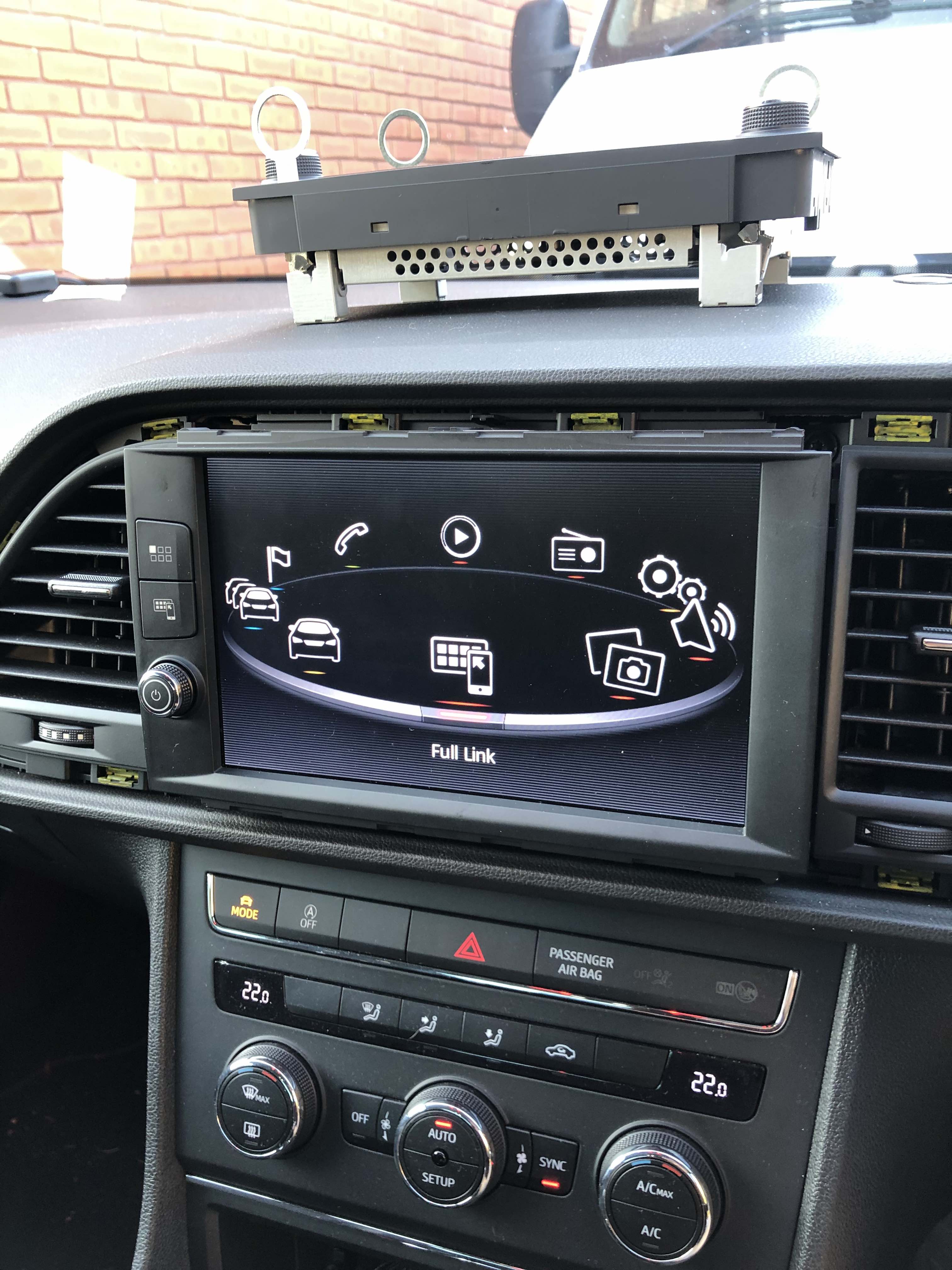

I'll be cutting up around my air vents tomorrow as shown in other threads.
Seems to all be working, but now with the lack of buttons, the carousel menu style isn't ideal!
But it will do until I can find this update!

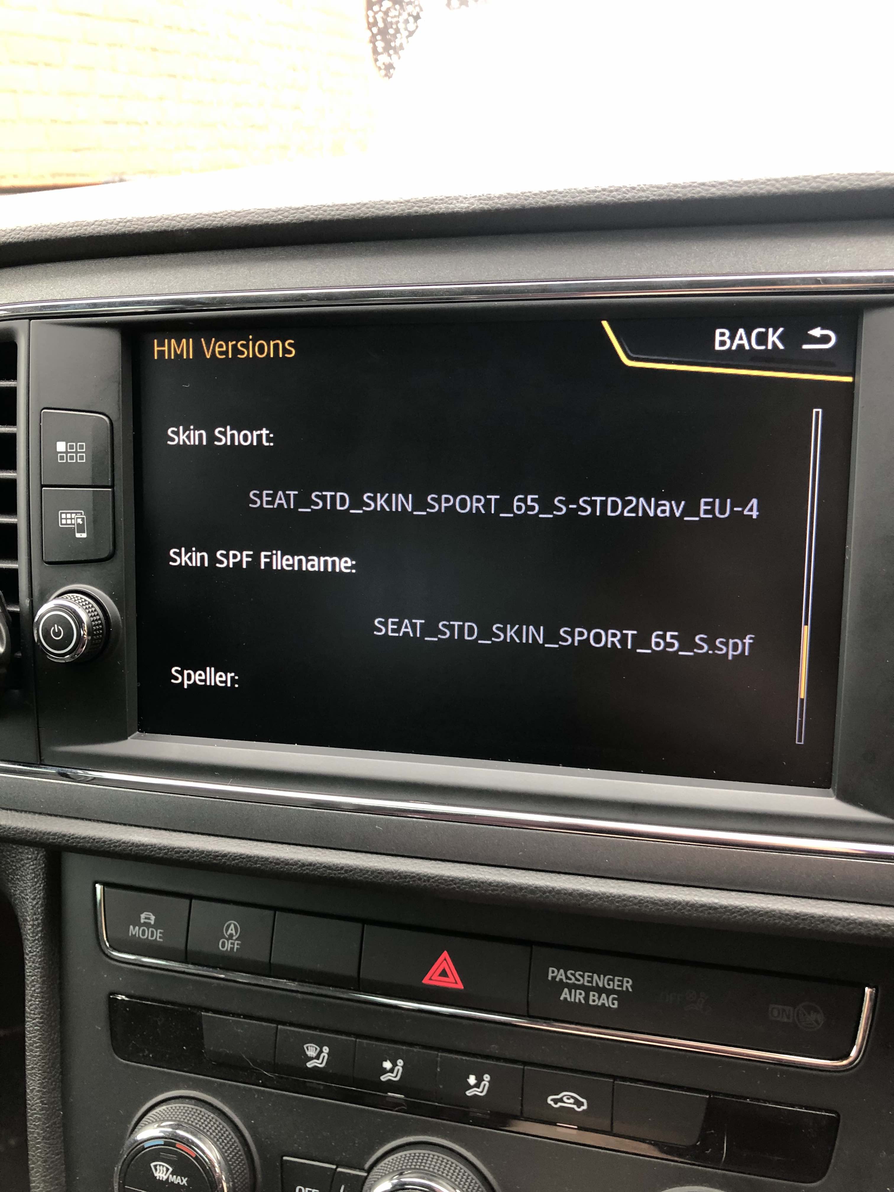

If you click on HMI versions does it bring up some different skins. Some have 65 in title and I think 1 has 80

Sadly has everything on this page blanked out.
I was hoping there might be a way for obd11 to change the skin after this, but still can’t find anything :-(

You need to press and hold longer. There should be another menu afterwards that's says test mode menu.
Well there is on mine.

Ah ok, well yeh that's ideally what I need to get the tiles and update the resolution. So it's all in this test menu is it?
I've held down the menu button for over two minutes and it won't go past the service menu. It makes a bong noise after 30 seconds but nothing happens

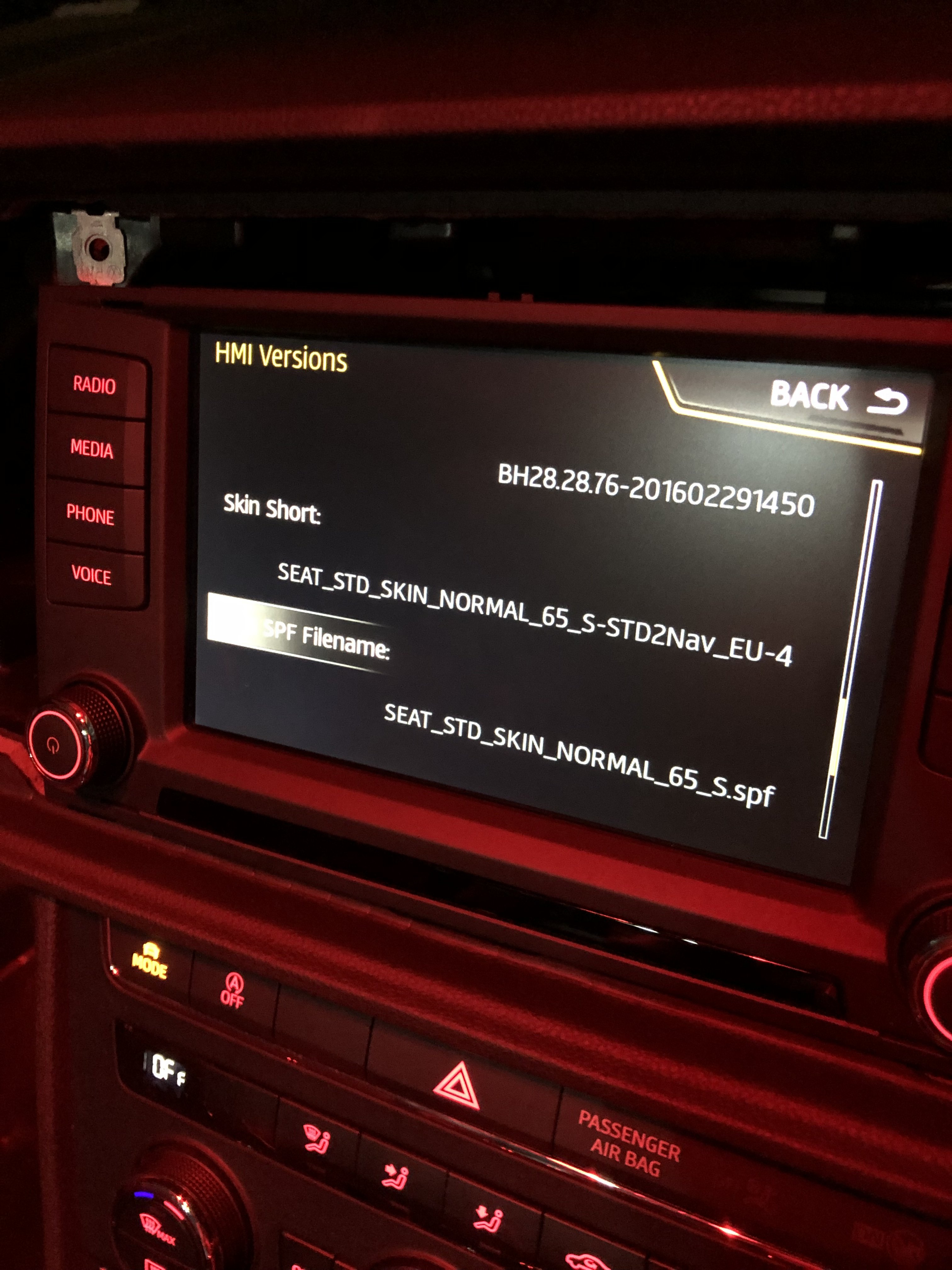

The tile settings can be found in the normal settings, been thinking its possible seeing as you have a newer mib2 to me it might automatically detect the 8inch screen and change resolution automatically.
1 way to check is once 8inch screen is plugged in long press top button and check hmi again. Should end in 80

Haha, unbelievable. Had it there the entire time.
Spent hours looking on my obdeleven trying to change it and it's been there the whole time (now I feel stupid!)
@wolverine_uk sadly hasn't automatically changed the resolution.
Do you know how I do it? I remember watching a video with someone changing it in developer mode, but my obd was struggling to activate that last night when I was stupidly having a look for a skin change on there.

After trying to figure that out myself as it wasn't available to me at first, to get to the test menu I had to use my OBD Eleven, use 10 credits to unlock the green engineering mode. Then the test menu was available after long pressing the menu button.
Then you can change the skin to 80 if that's what you're going to do.
If you don't have obd eleven I don't know how else this is unlocked.

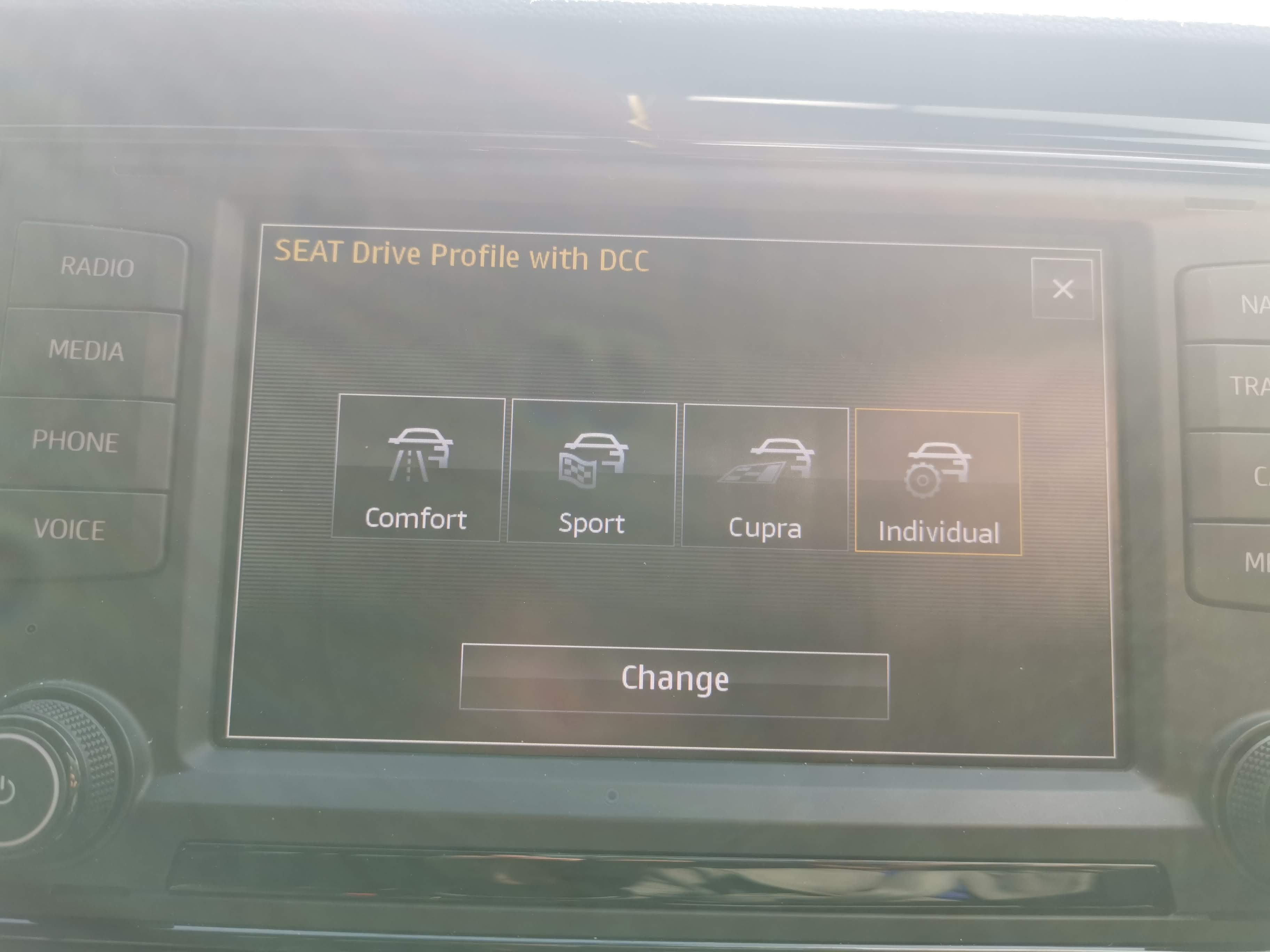

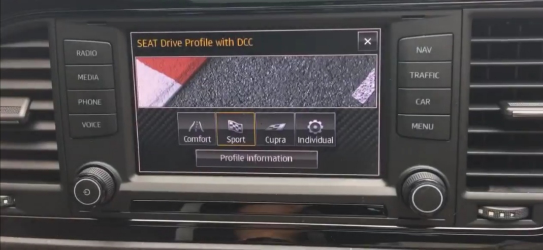

Thanks I want the first screen not the second one if possible ?
What other skins can you get?
