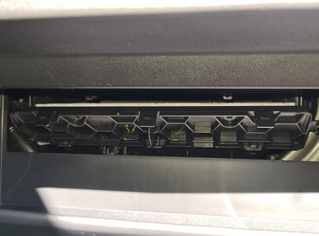

Does anybody know how to access the pollen filter on MK4 Leon? I was looking behind the glove box but is all sealed with a plastic enclosure so not sure if that all needs to come out for pollen filter change? That would require probably all glove box take a apart
I have contacted mann filter for advise on this. A quick visual check underneath the glove boxes revealed a fan motor so in theory AC unit is same as mk3 Leon. Due to space completely sealed behind the glove box in mk4 i can only see one option to change the filter and to take the glove box apart gaining access behind for filter assembly

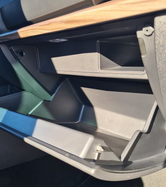

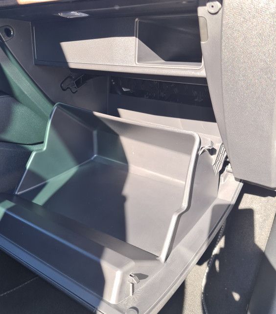

I usually replace the filter every year. Dremel will be needed i just have to figure it out why this hasn't been done from factory
EDIT: not possible to cut hole the back side plastic of glove box will colaps

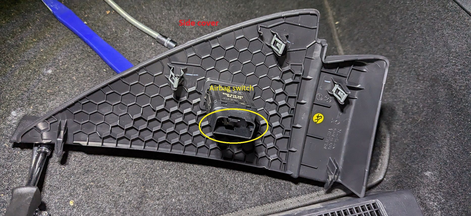

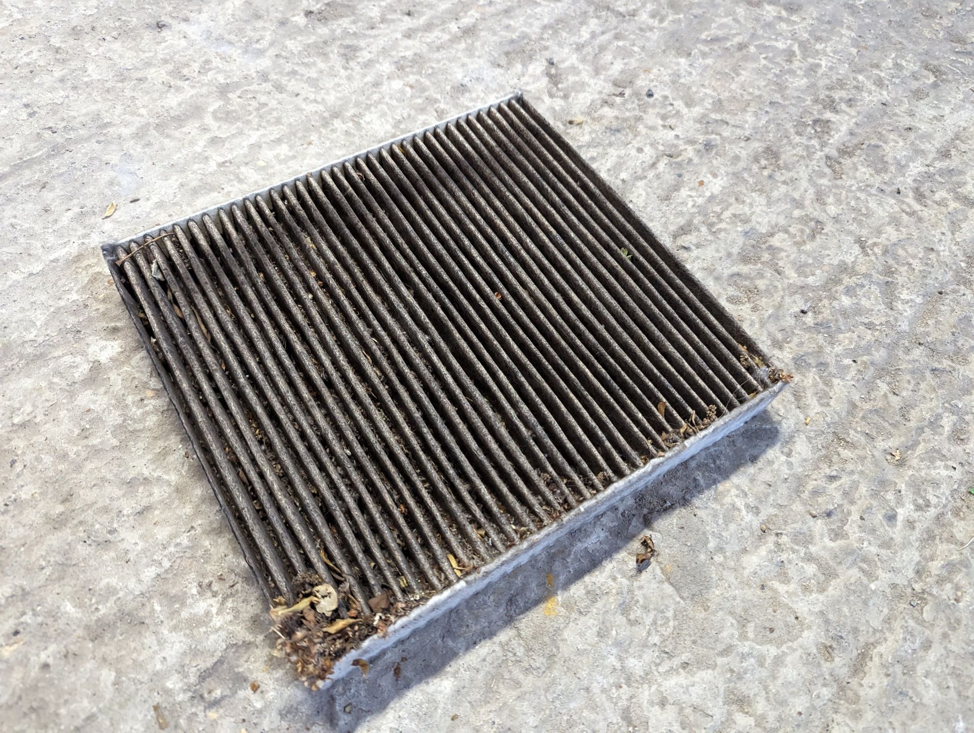

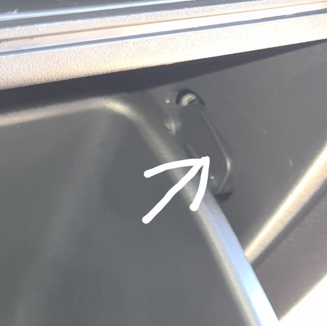

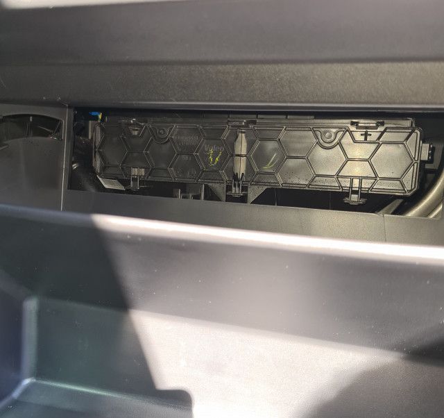

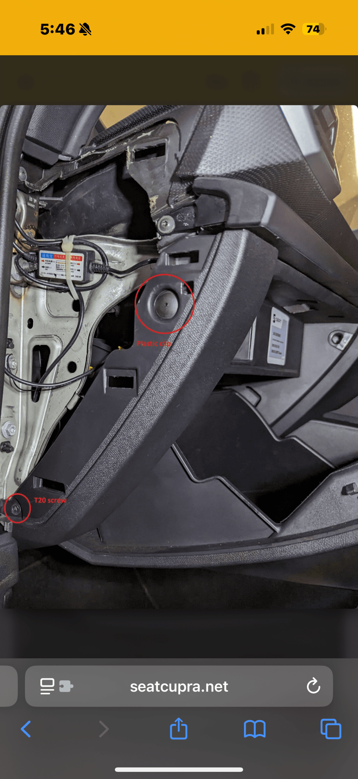

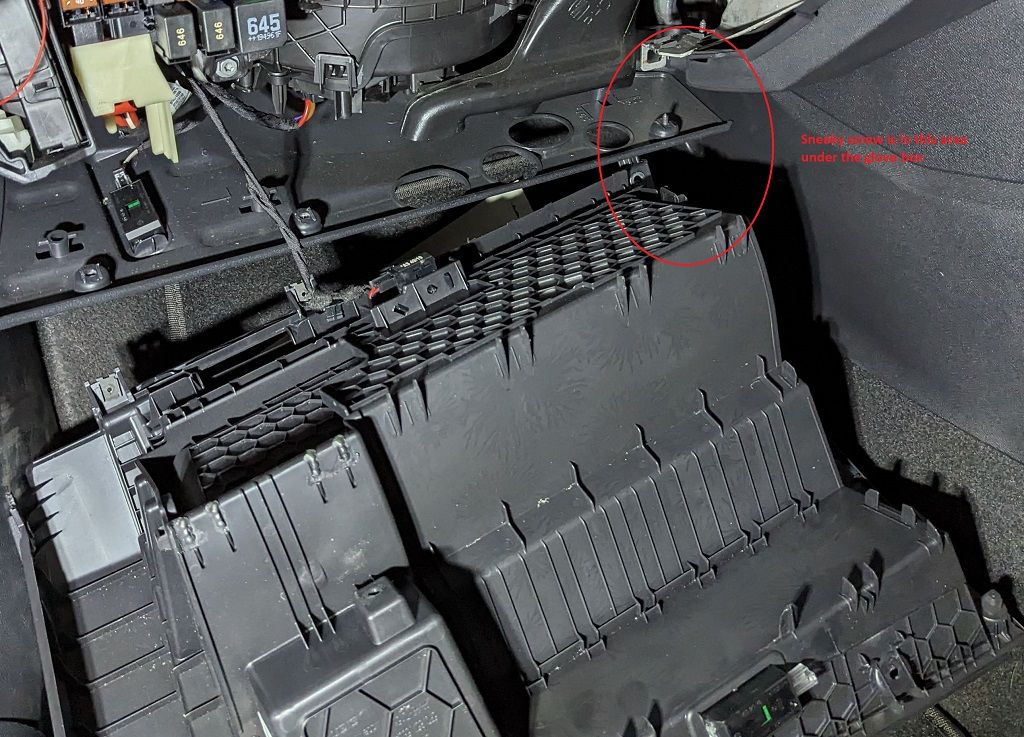

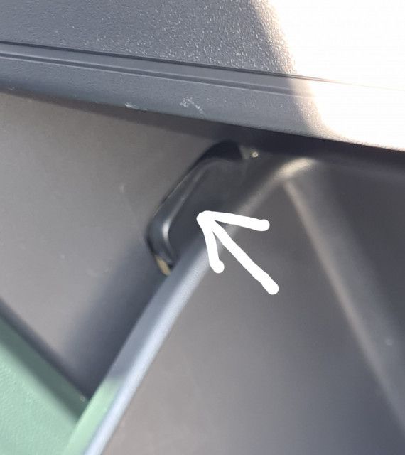

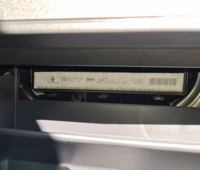

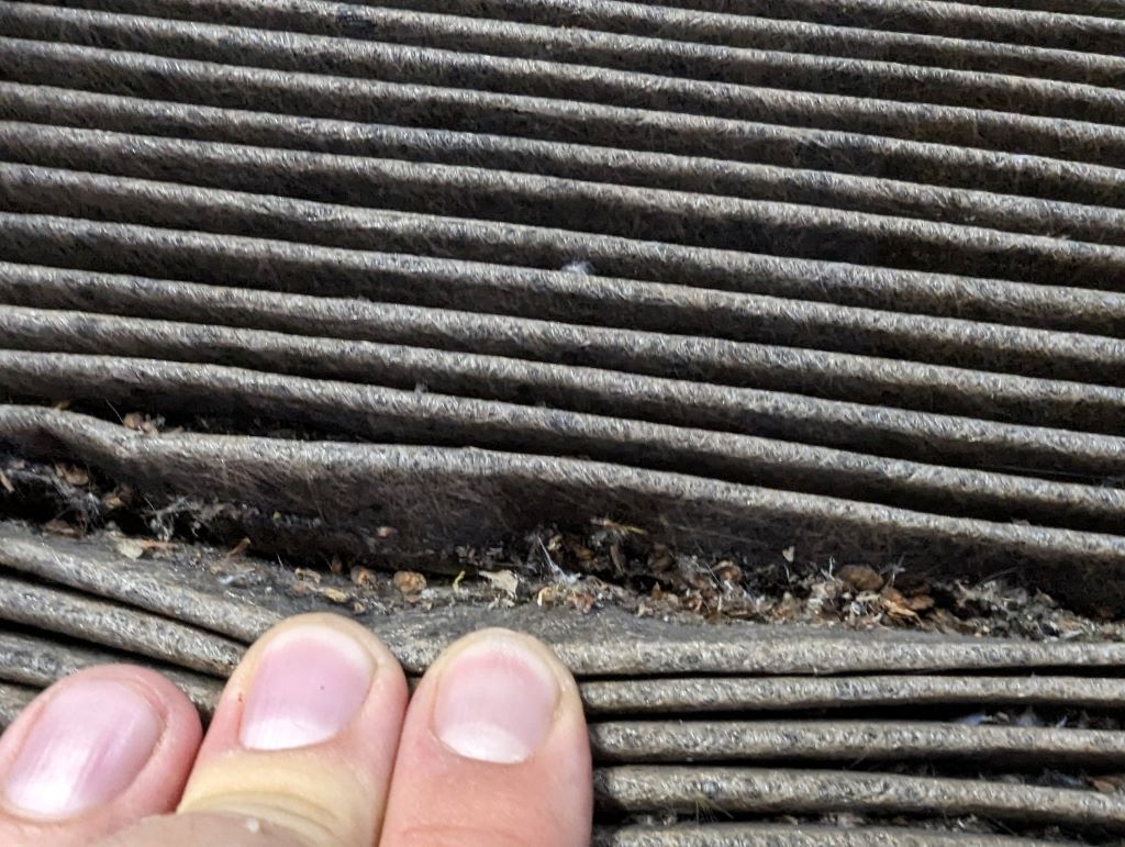

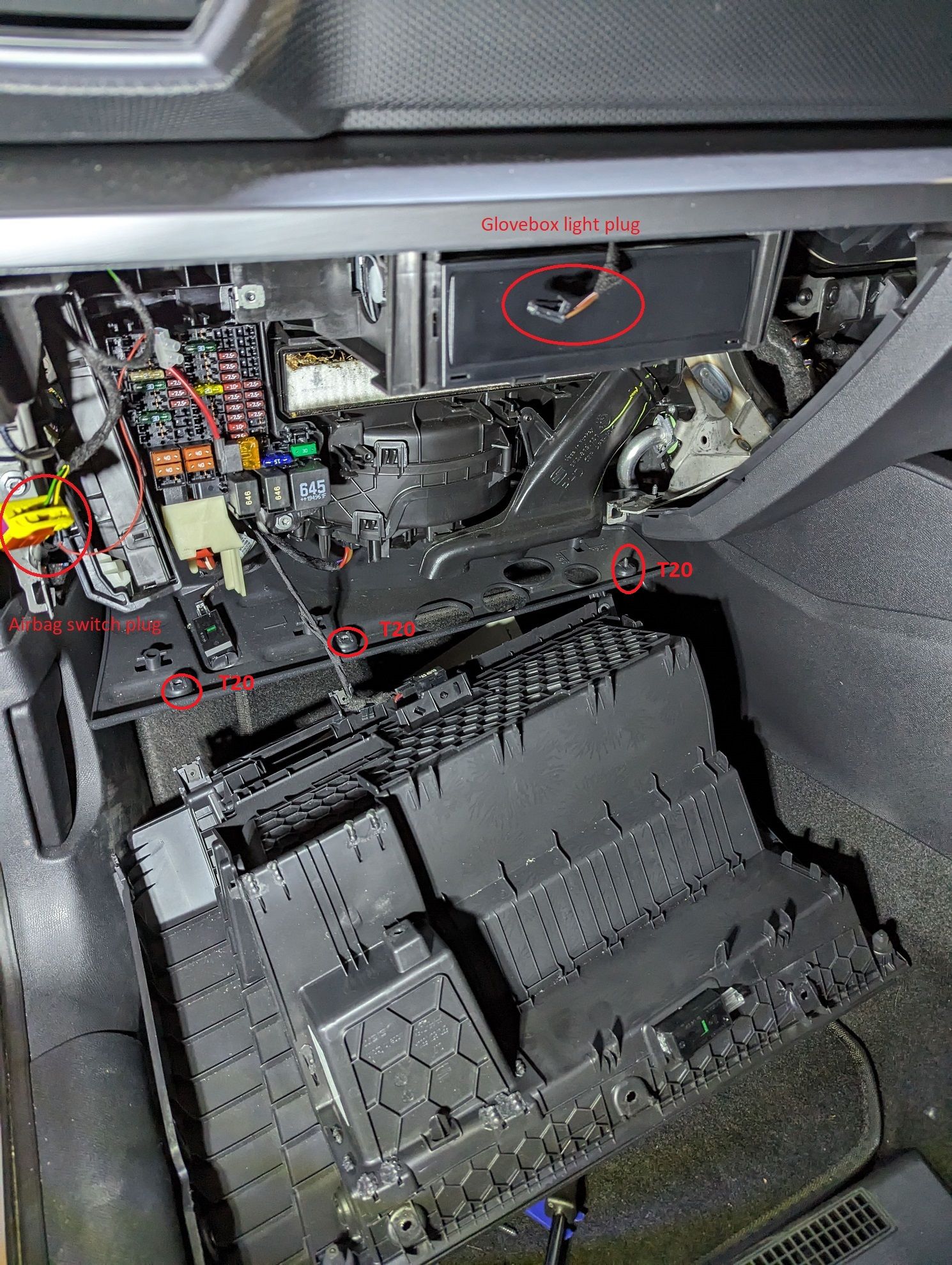

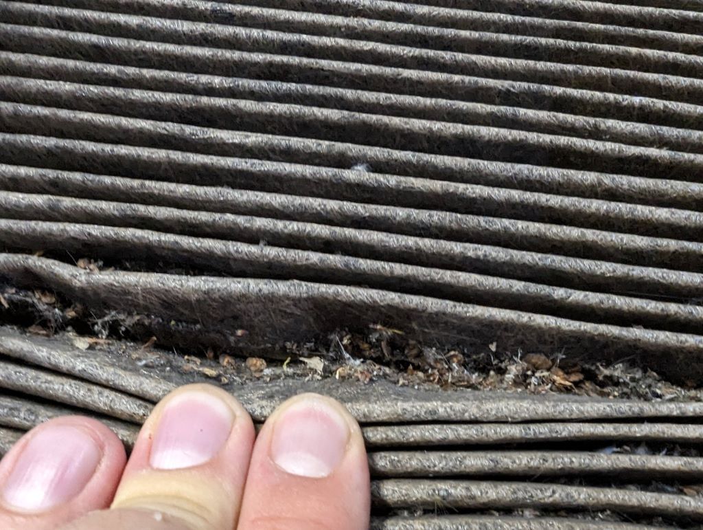

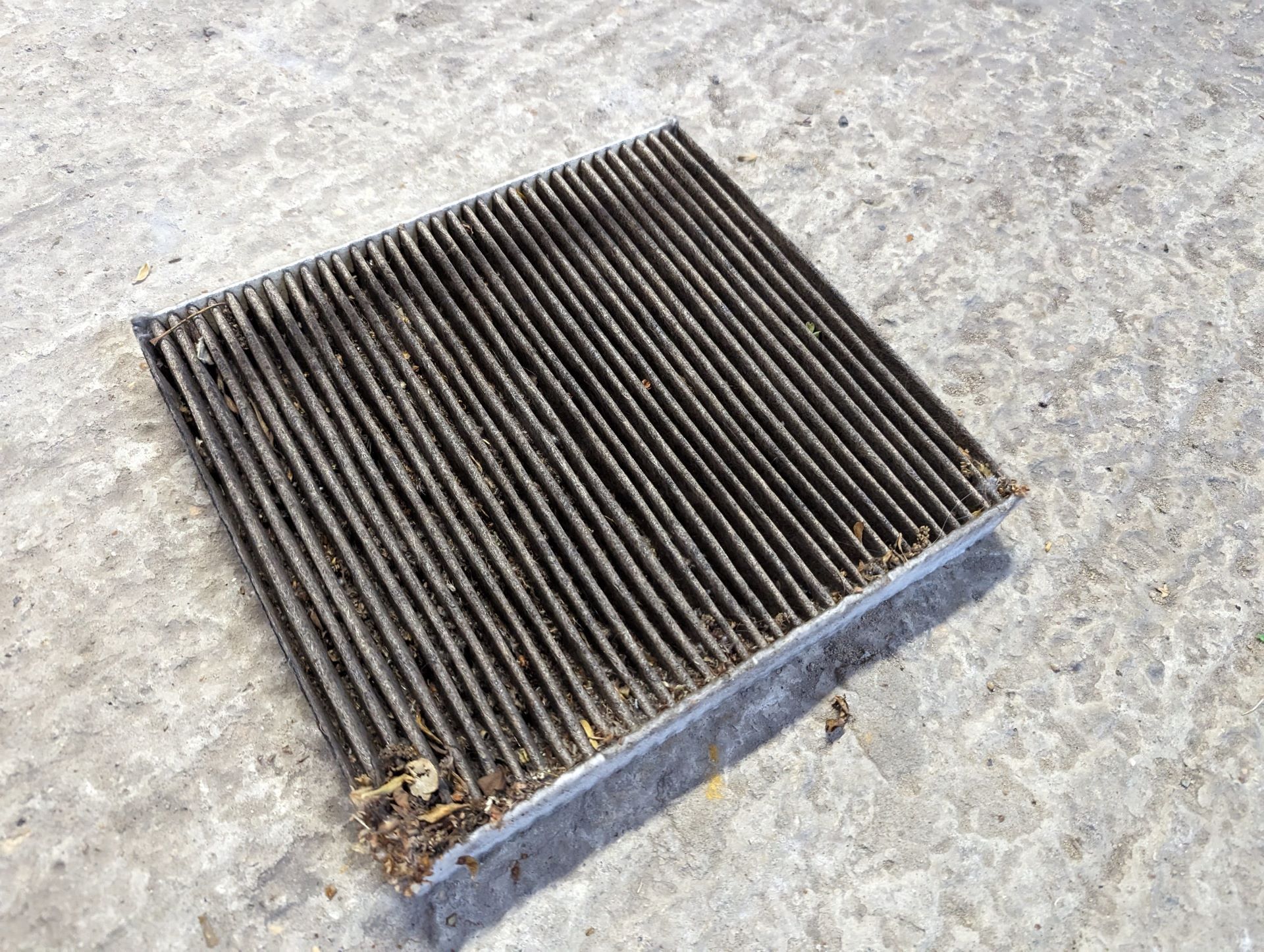

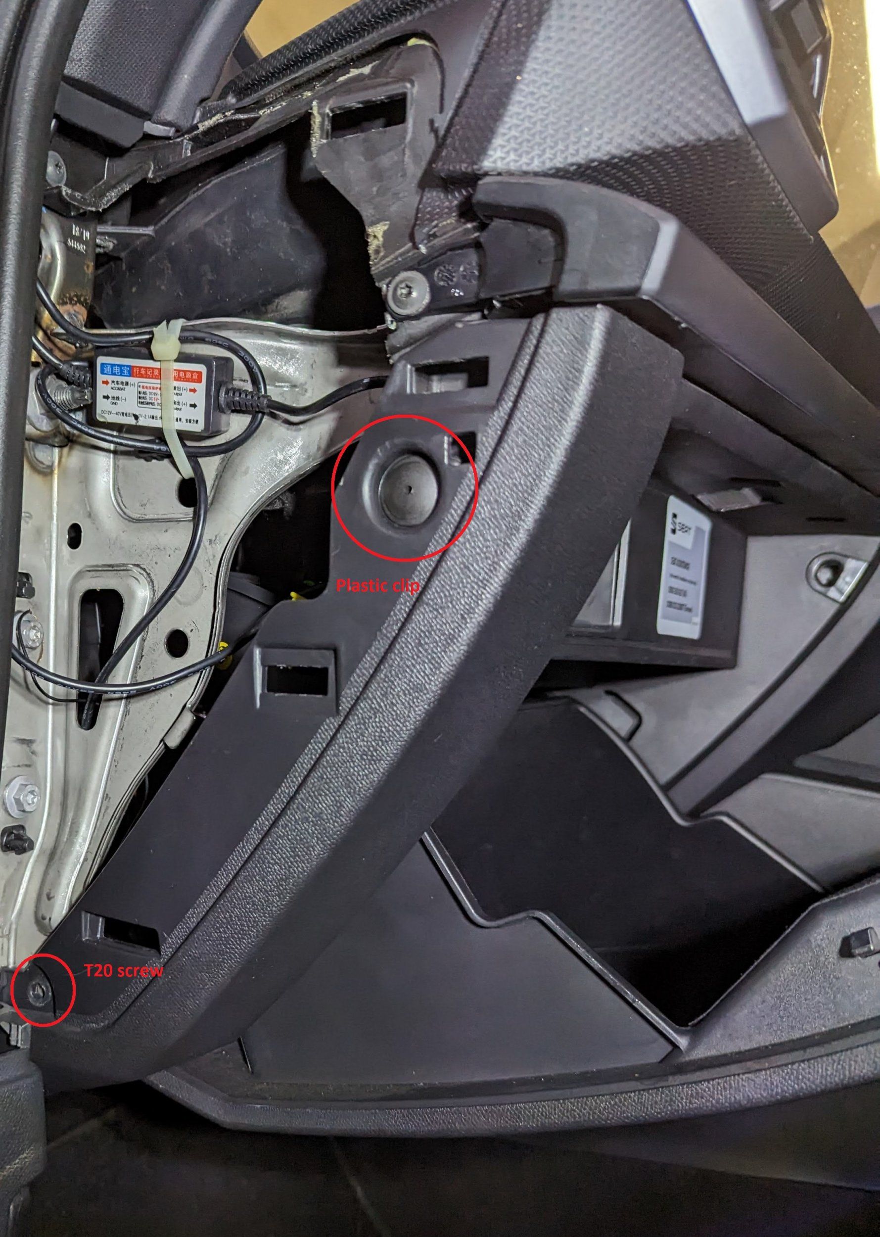

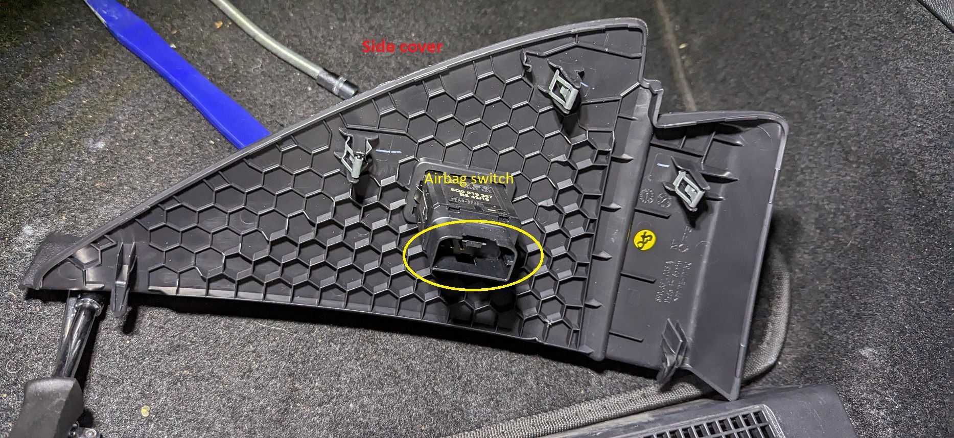

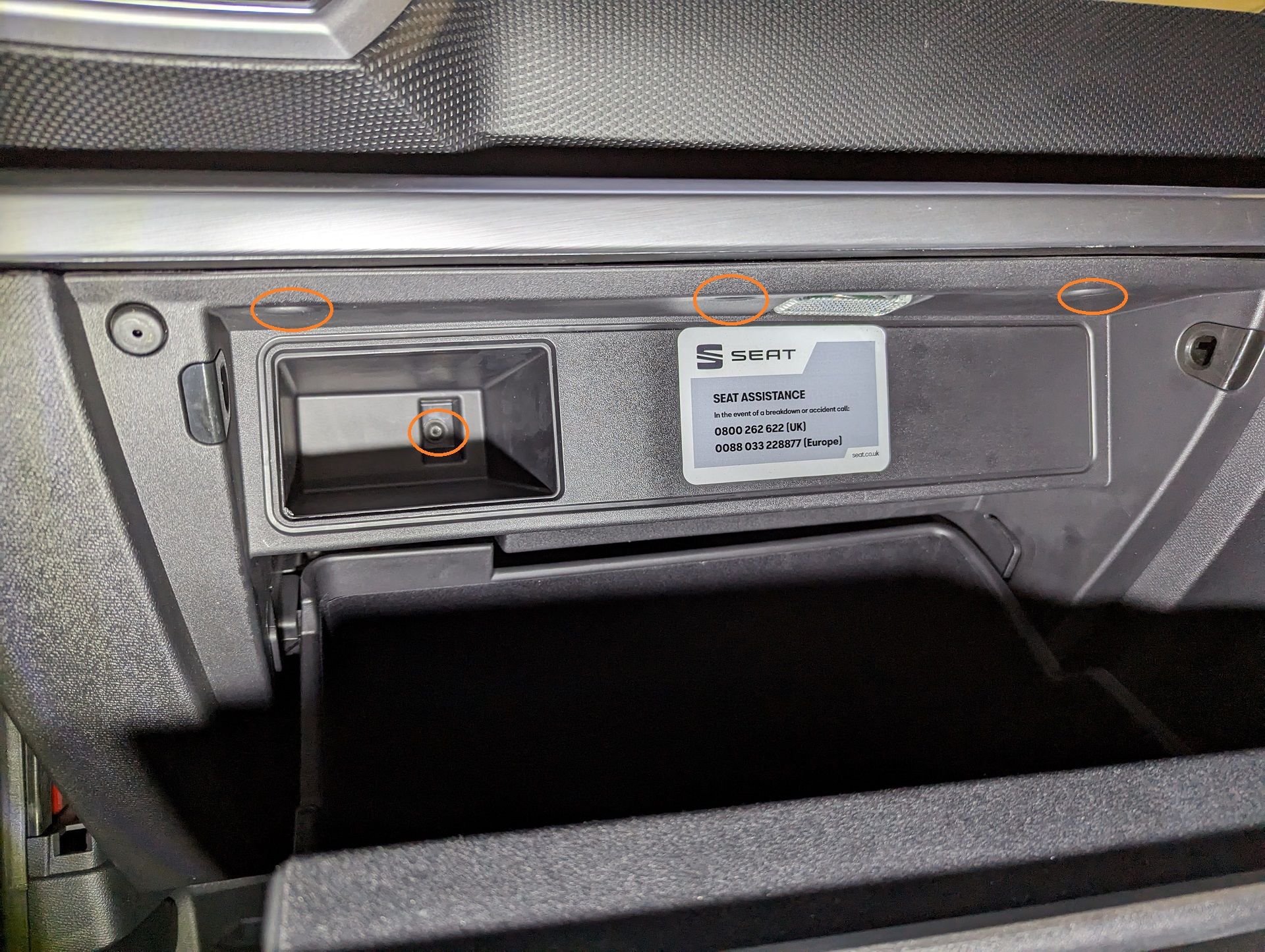

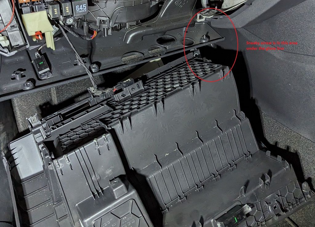

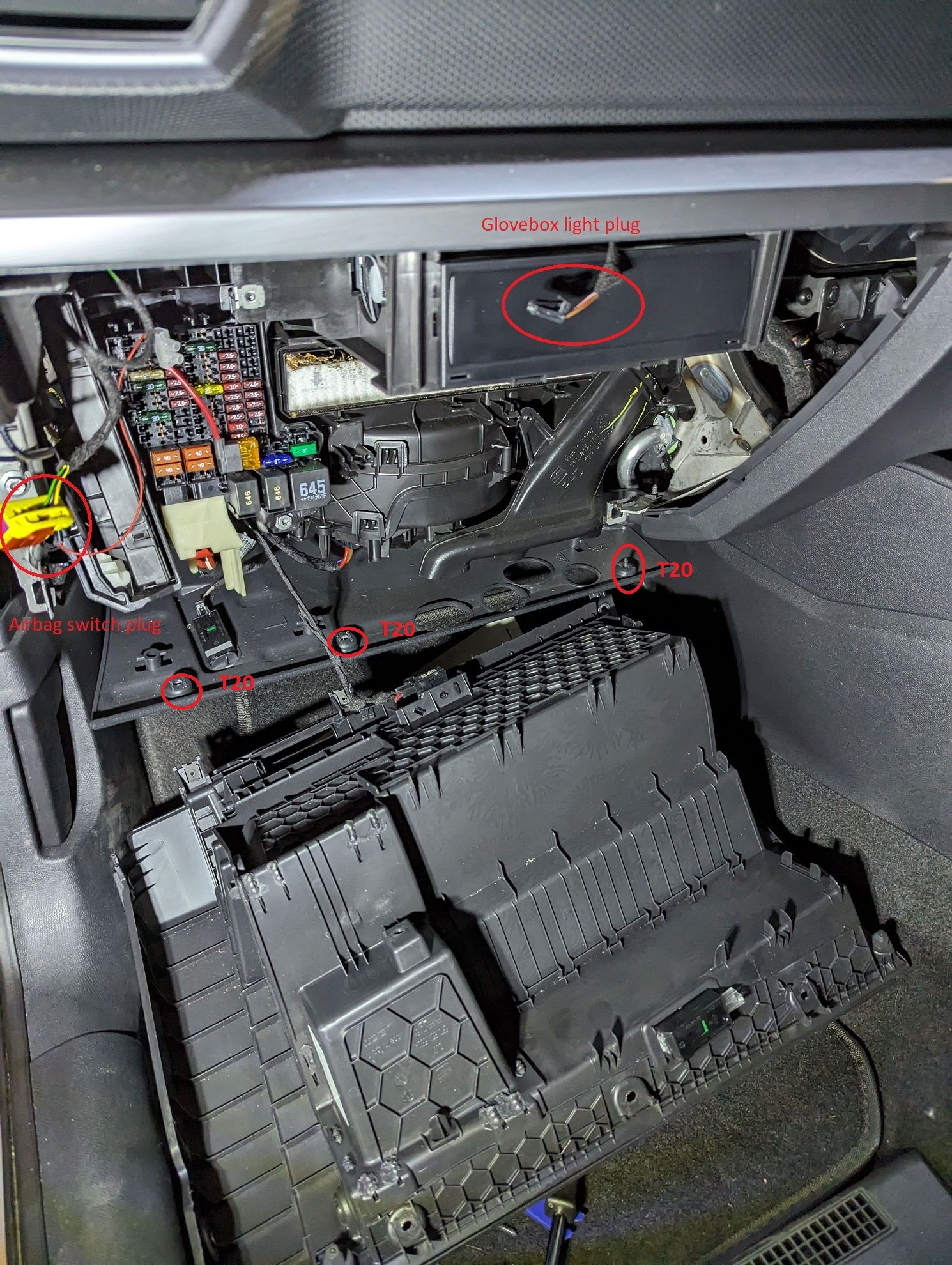

Just finished my one RHD replacement. It's a bit challenging but doable. No need to remove (lower) the glovebox shelf. There are 4x T20 screws inside the glovebox, a plastic clip and 1x T20 screw on the left side under the side cover and one sneaky T20 screw hidden on the bottom right side of the end. You also have to drop the bottom cover 3x T20 screw under the glovebox for better access. Don't unplug the Airbag switch if you dont have the diagnostic to reset the fault afterwards. And dont forget to unplug the glovebox light, the cable is rather short. Picture attached. My filter was pretty stuffed with all sort of sh.t. :rolleyes:

Just finished my one RHD replacement. It's a bit challenging but durable. No need to remove (lower) the glovebox shelf. There are 4x T20 screws inside the glovebox, a plastic clip and 1x T20 screw on the left side under the side cover and one sneaky T20 screw hidden on the bottom right side of the end. You have to also drop the bottom cover 3x T20 screw under the glovebox for better access. Don't, unplug the Airbag switch if you dont have the diagnostic to reset the fault afterwards. And dont forget to unplud the glovebox light the cable is rather short. Picture attached. My filter was pretty stuffed with all sort of sh.t. :rolleyes:
View attachment 37315View attachment 37319

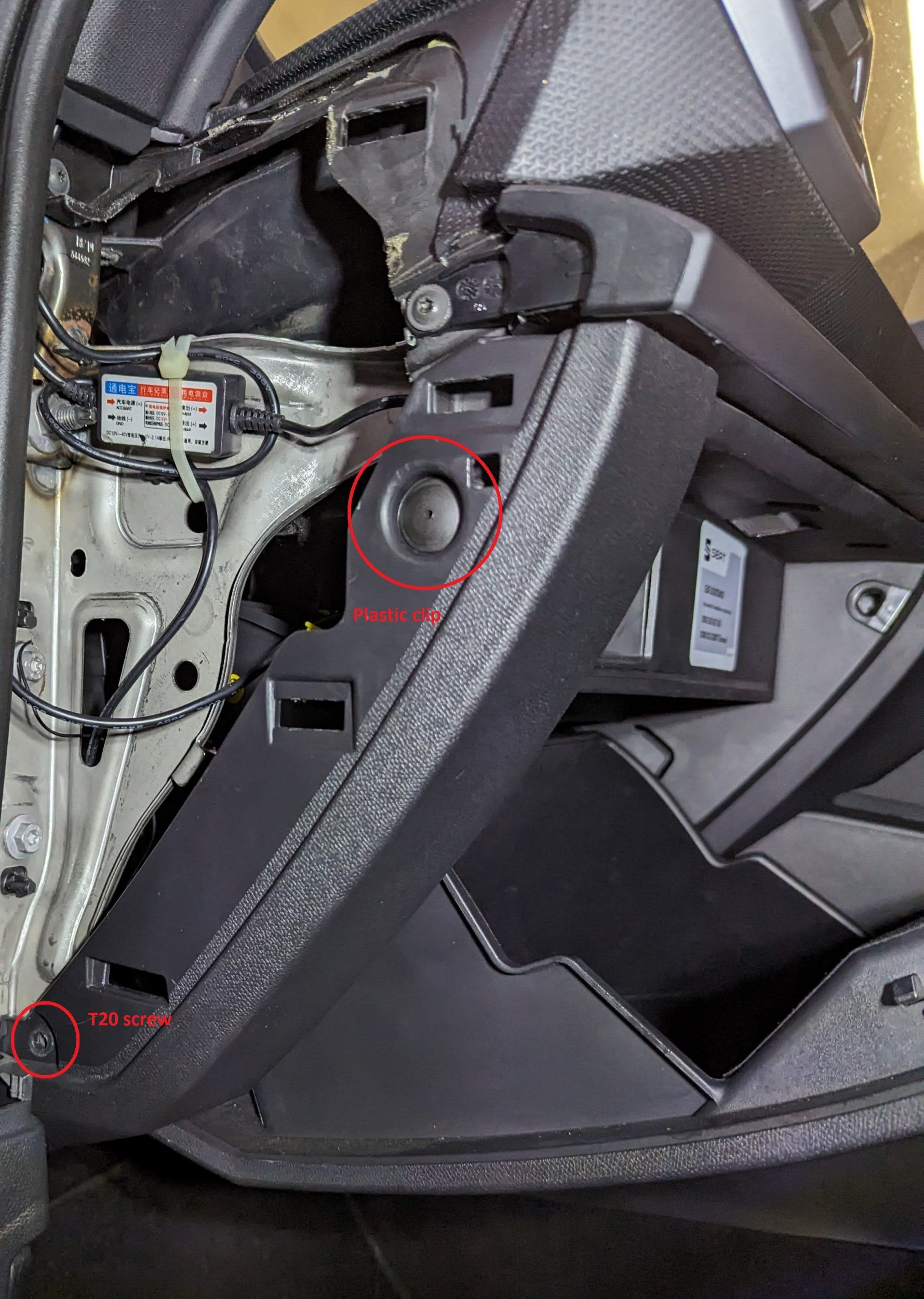

I know it’s an old post if you’re still receiving notifications? The top photo with the T20 & plastic clip how did you manage to get the T20 out as it’s really close to the door trim?

What a fantastic guide, first time doing anything to a car, this was the only thing available online for rhd, I splashed out and fitted the bosch filter+pro, old filter almost like yours after 3yrs and 15k, thank you so much
