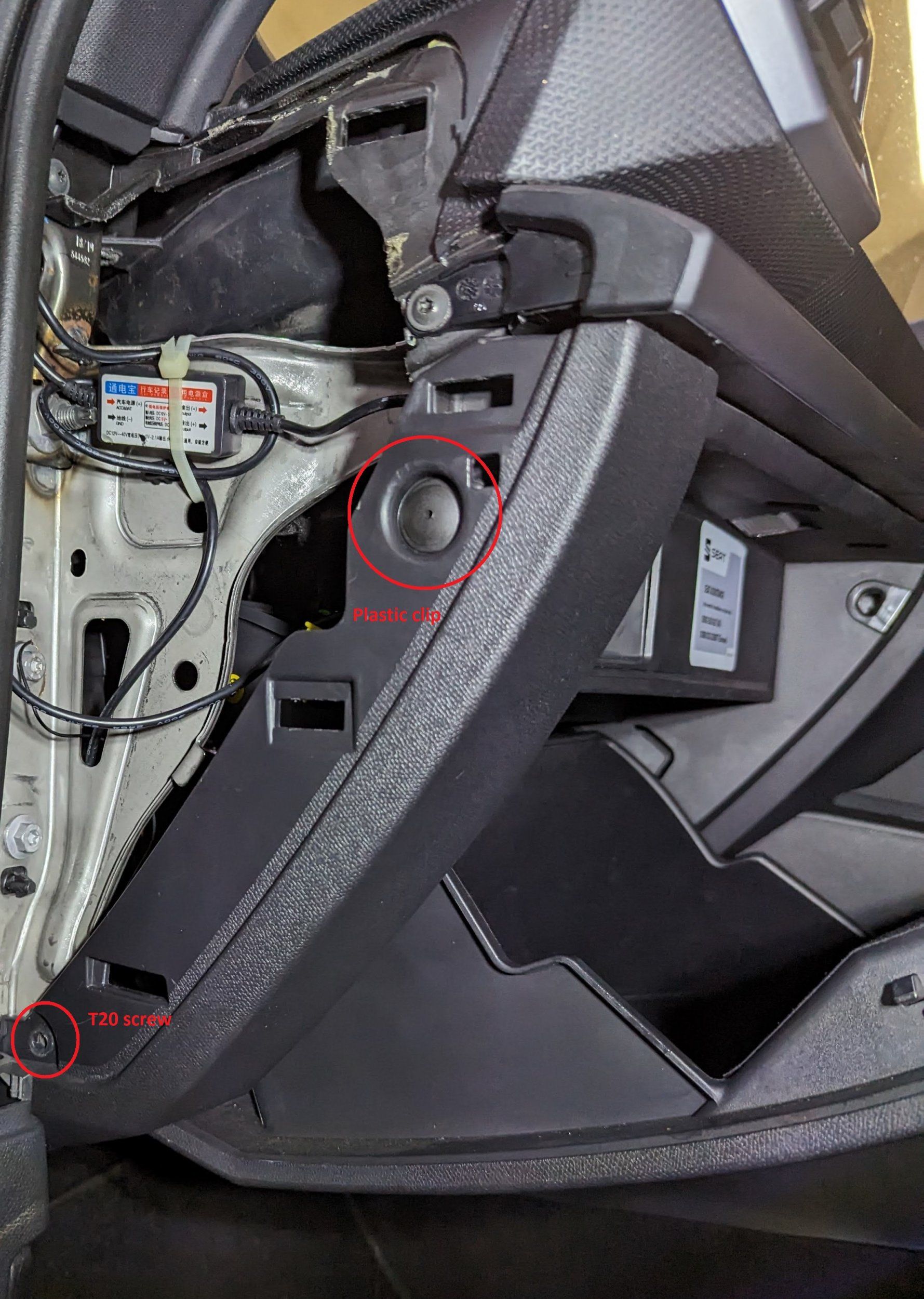

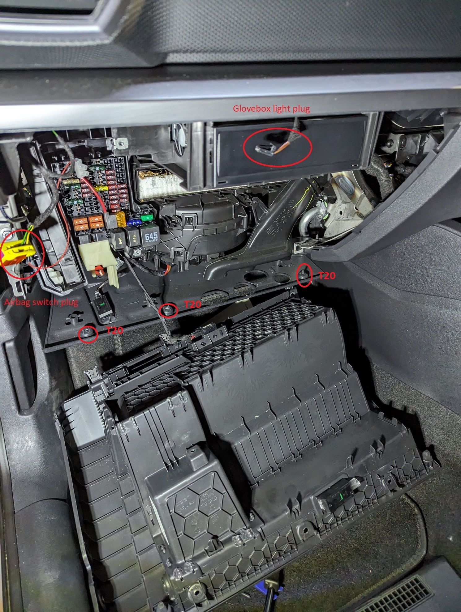

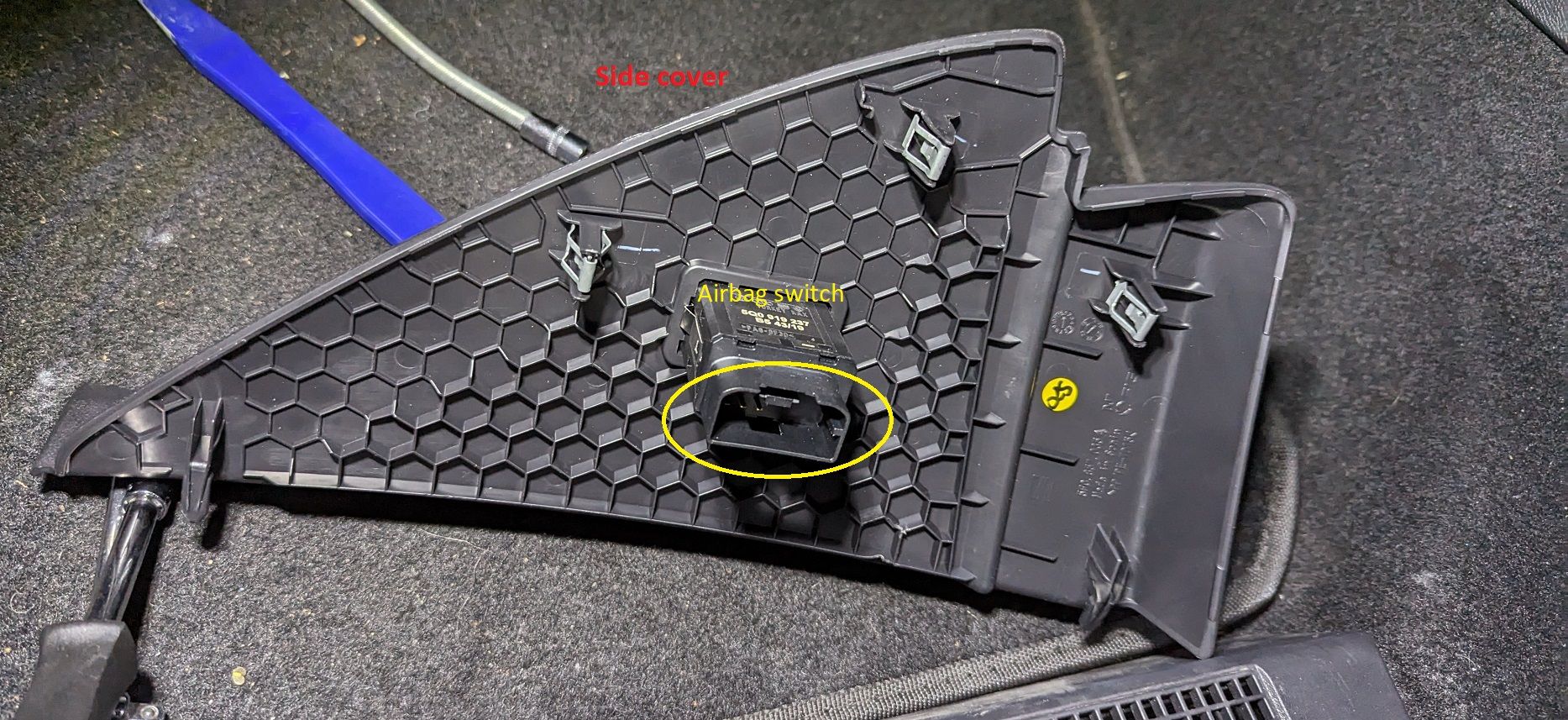

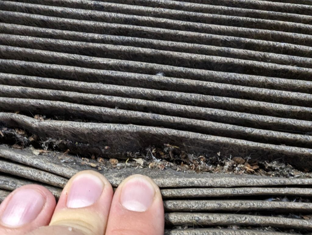

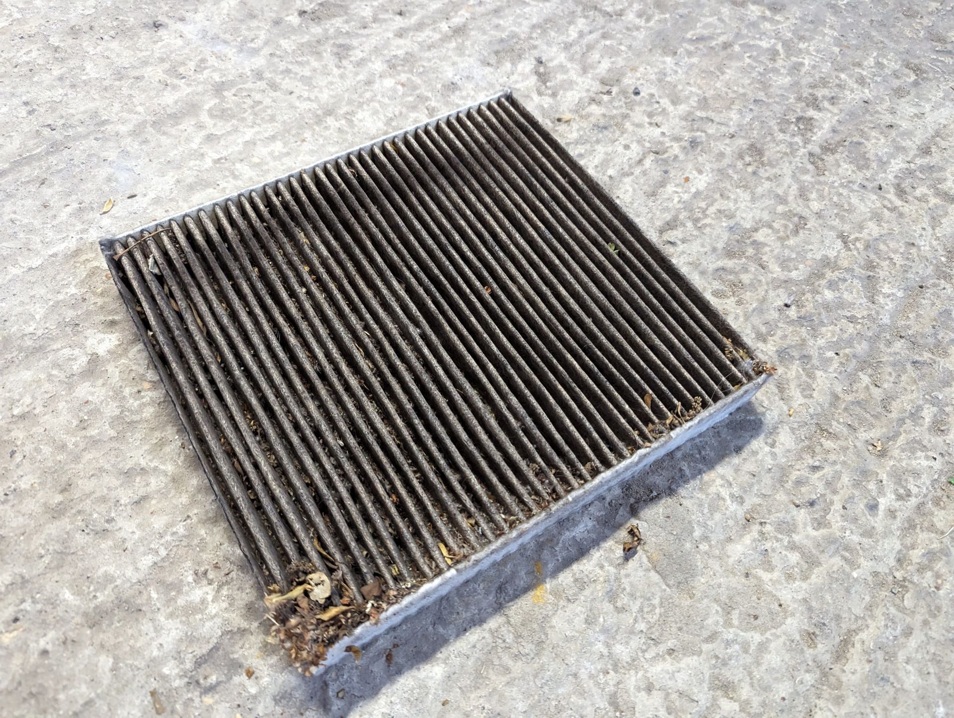

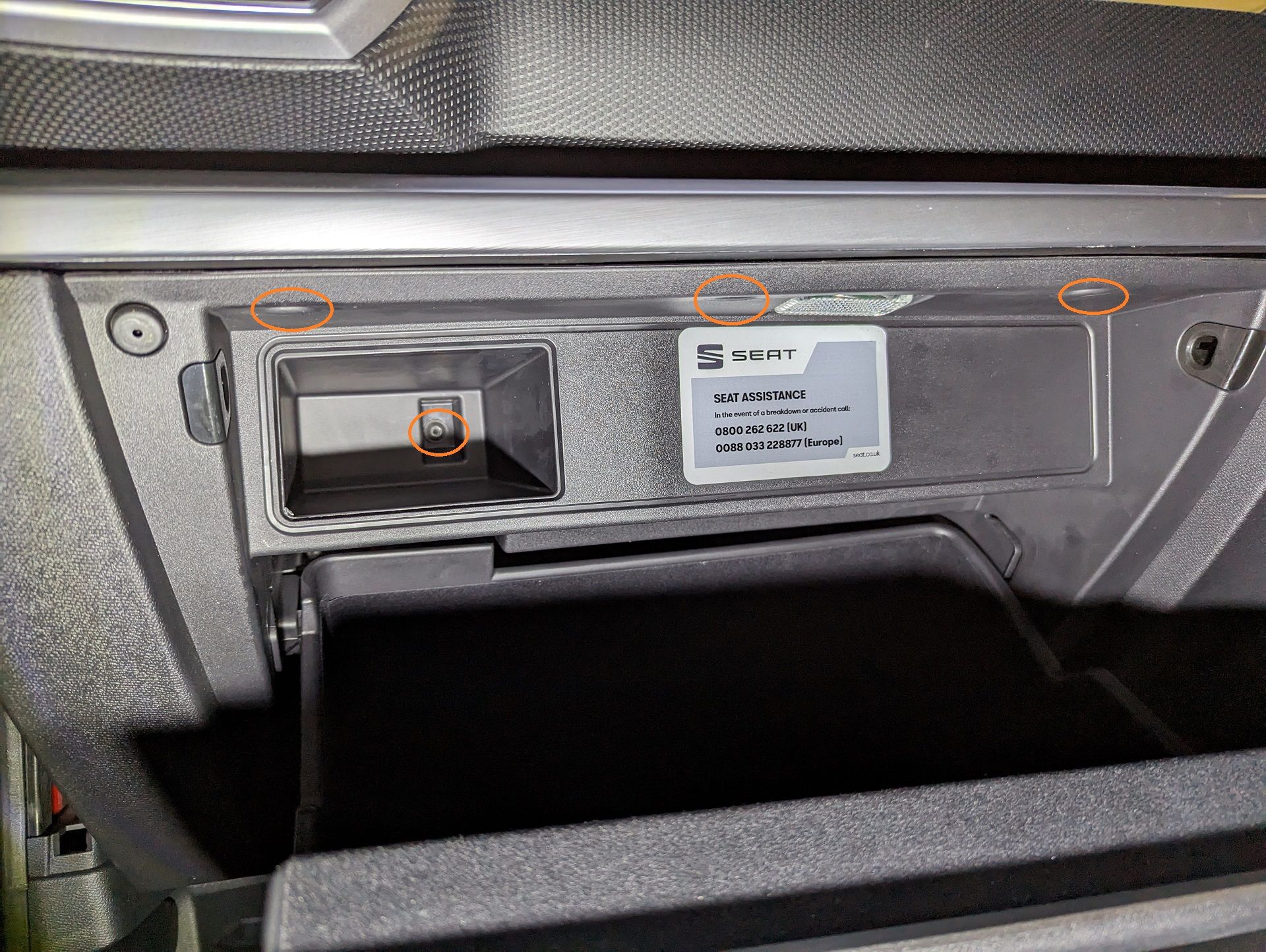

Just finished my one RHD replacement. It's a bit challenging but durable. No need to remove (lower) the glovebox shelf. There are 4x T20 screws inside the glovebox, a plastic clip and 1x T20 screw on the left side under the side cover and one sneaky T20 screw hidden on the bottom right side of the end. You have to also drop the bottom cover 3x T20 screw under the glovebox for better access. Don't, unplug the Airbag switch if you dont have the diagnostic to reset the fault afterwards. And dont forget to unplud the glovebox light the cable is rather short. Picture attached. My filter was pretty stuffed with all sort of sh.t. :rolleyes:
